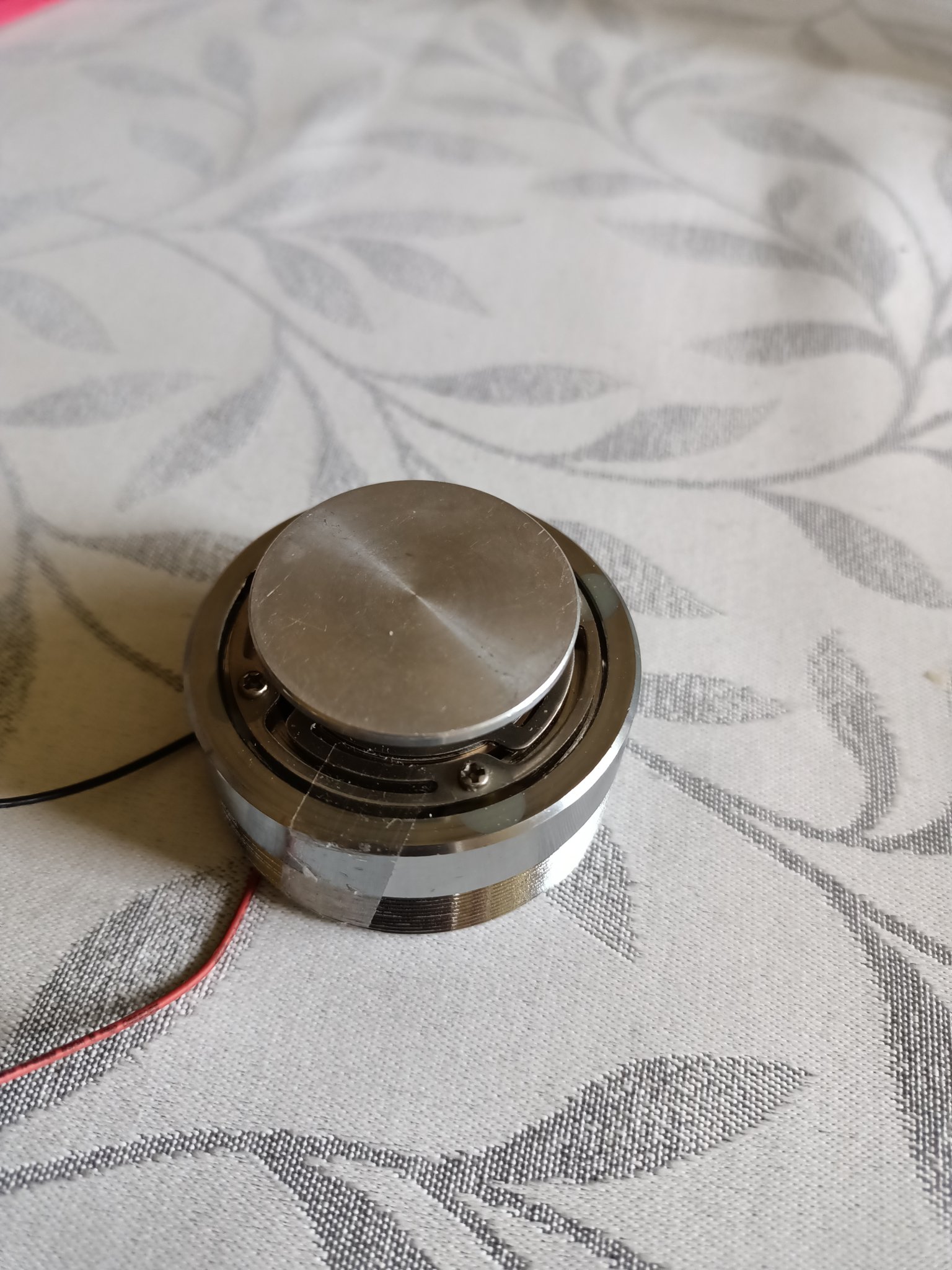

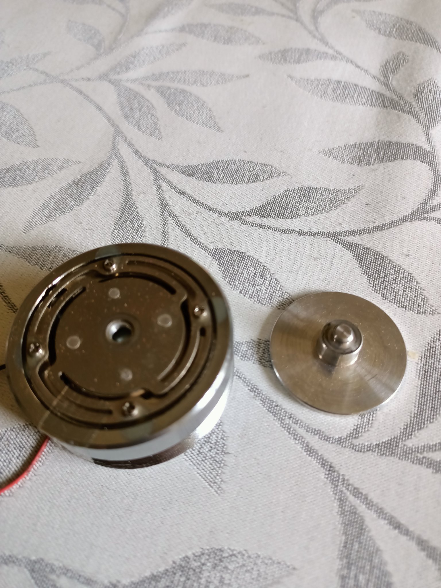

Sometime ago, I bought these transducers from China. They were just lying in the drawers since then, after the first try listening how they sound on tightened cloth, cardboard, EPS, ceramic tiles, table top etc. Since I saw that video, I'm looking for spikes to test them on framed picture that's done on cardboard (HDF). The image is fixed to the frame with small nails. The transducer is quite heavy, 275g, so won't hold by itself on glue.The idea behind the spike is interesting but the way it is shown a bit strange. We know it is possible to make DML by pushing on a diameter of 25 or even 32mm or more. This doesn't transform the panel in pistonic speaker. Where the idea of a spike becomes interesting (in my current opinion) is to avoid to have 2 regions : inner and outer the voice coil diameter; 2 regions that have a different behavior in high frequency. Here the DML was cut at 2k. Why? One hypothesis might be the low pass effect between the membrane mechanical impedance and the mobile mass. Is there a reference to the membrane material?
