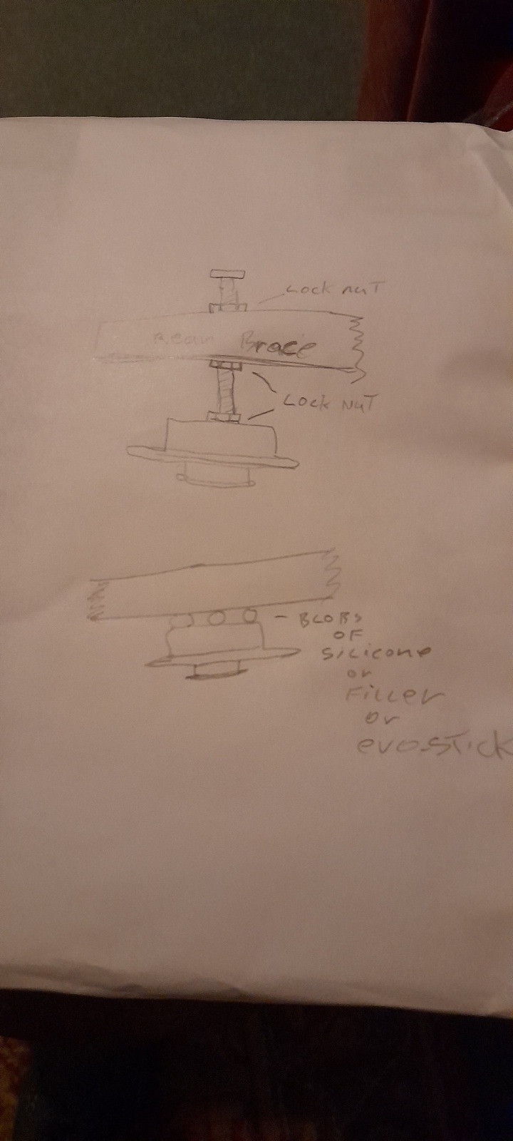

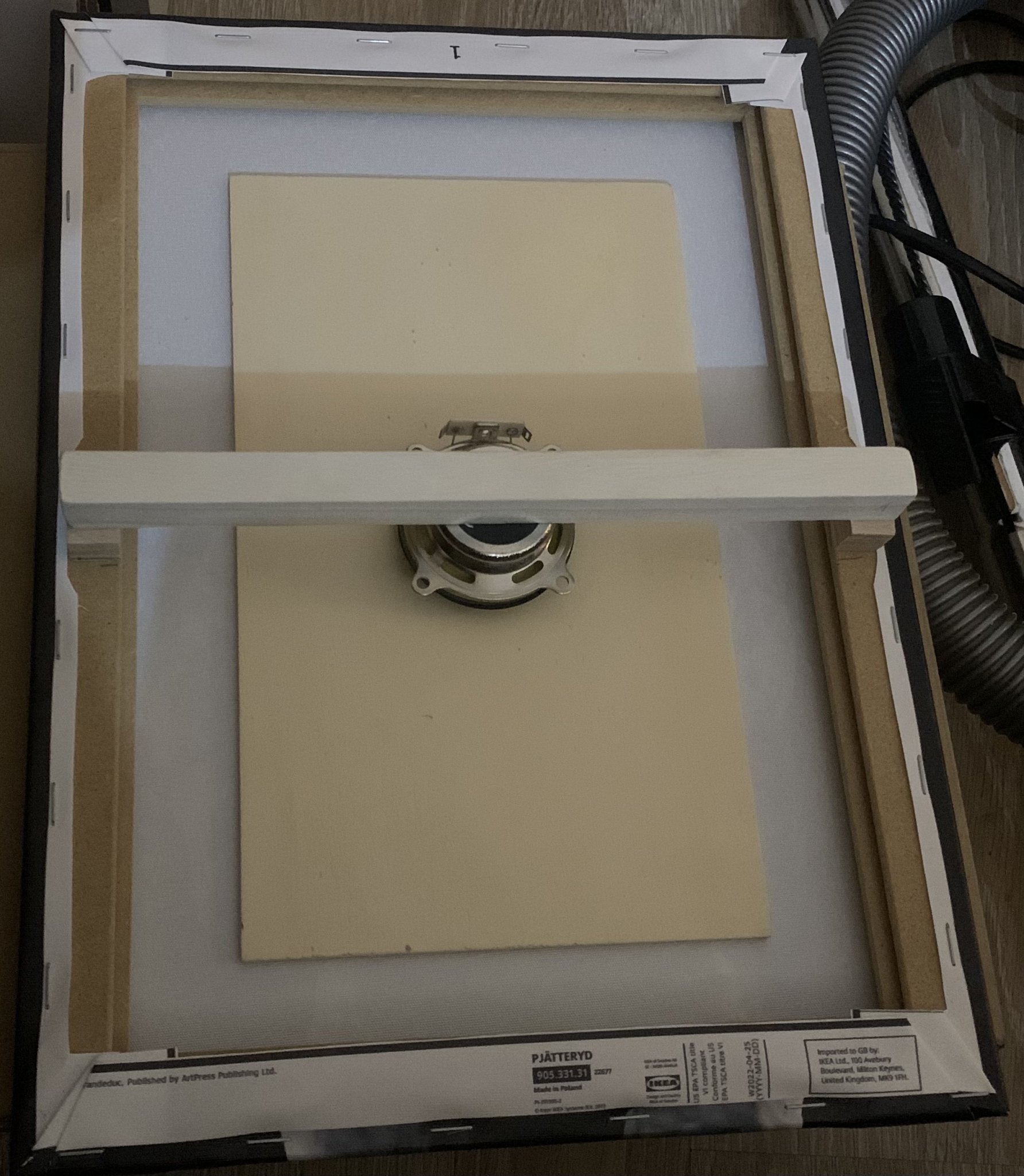

Sorry for my quick bad drawing.That is what I call dedicationI slowly continue with the Ikea canvases, yesterday I glued 160 x 270 x 4mm poplar plywood panels to them. The back side of the panels was pre-coated with 50/50 PVA/water mixture just to provide some basic protection.
I have a question about mounting the daex30hesf-4 to the spine - can I use the M6 thread/screw with a neoprene or rubber washer between the exciter and spine? I would also put on some Loctite to the thread, so that it does not get loose.
The quickest and easiest way would be the silicone blobs.
Just leave a small gap in between the spine and the exciter, with the canvas on a flat surface.
Then just squirt the filler into the gap , when it's dry the exciter will be positioned perfectly.
You can use different fillers that dry harder if desired.
If you use the bolt method you could use nuts to lock the bolt into position without loctite .
This would also allow you to adjust the exciter position if necessary.
Steve.

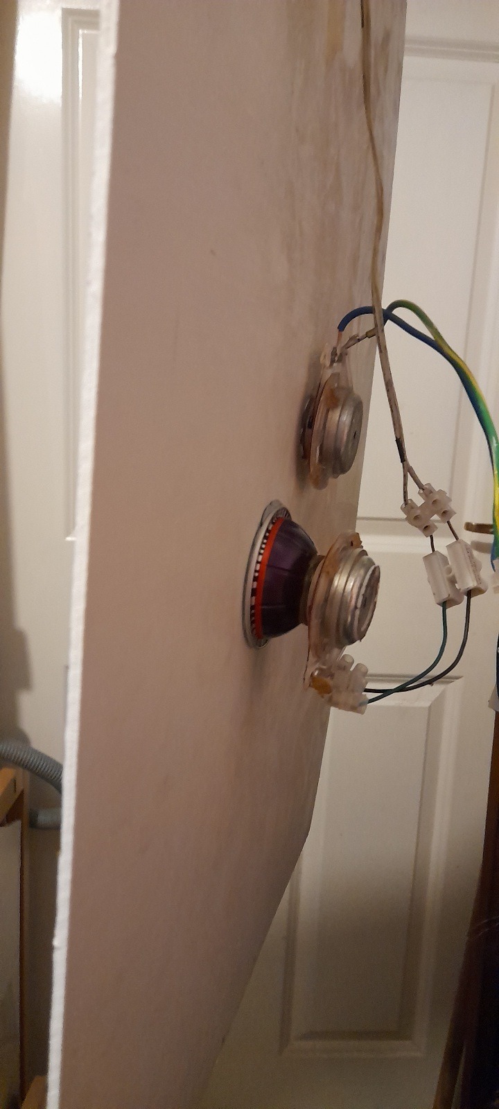

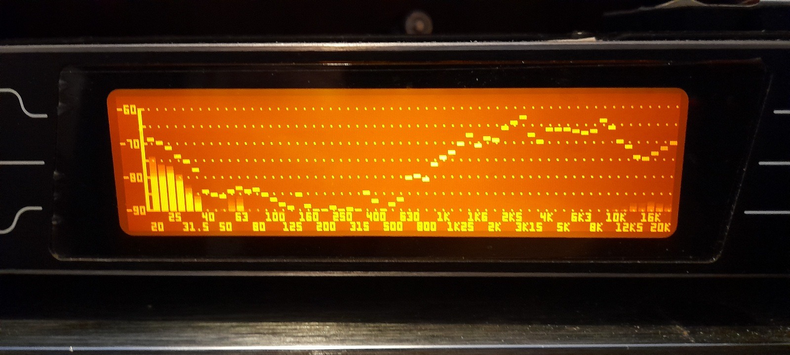

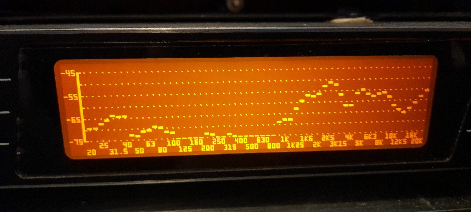

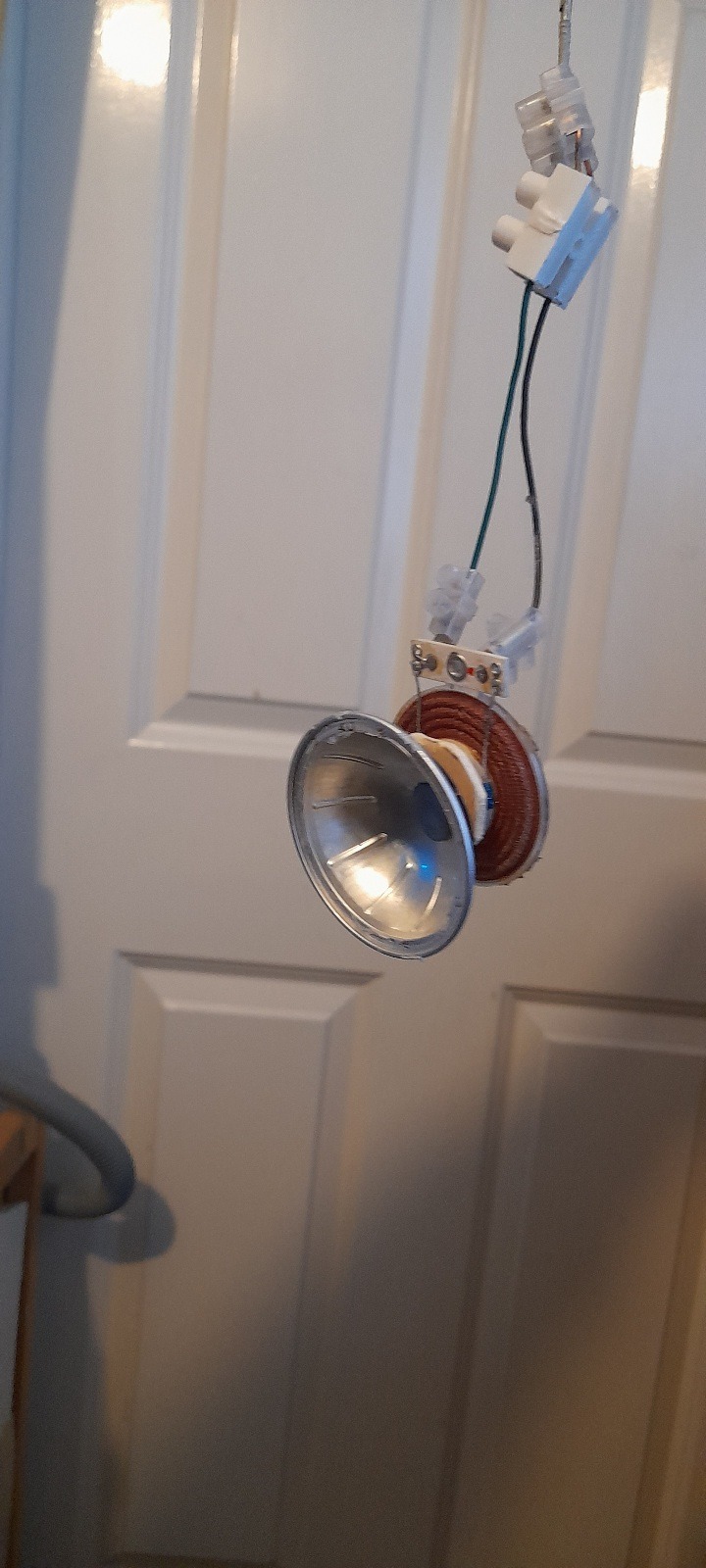

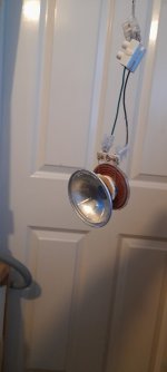

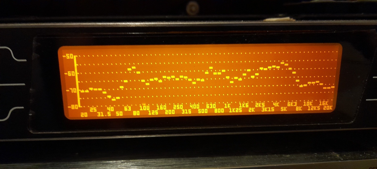

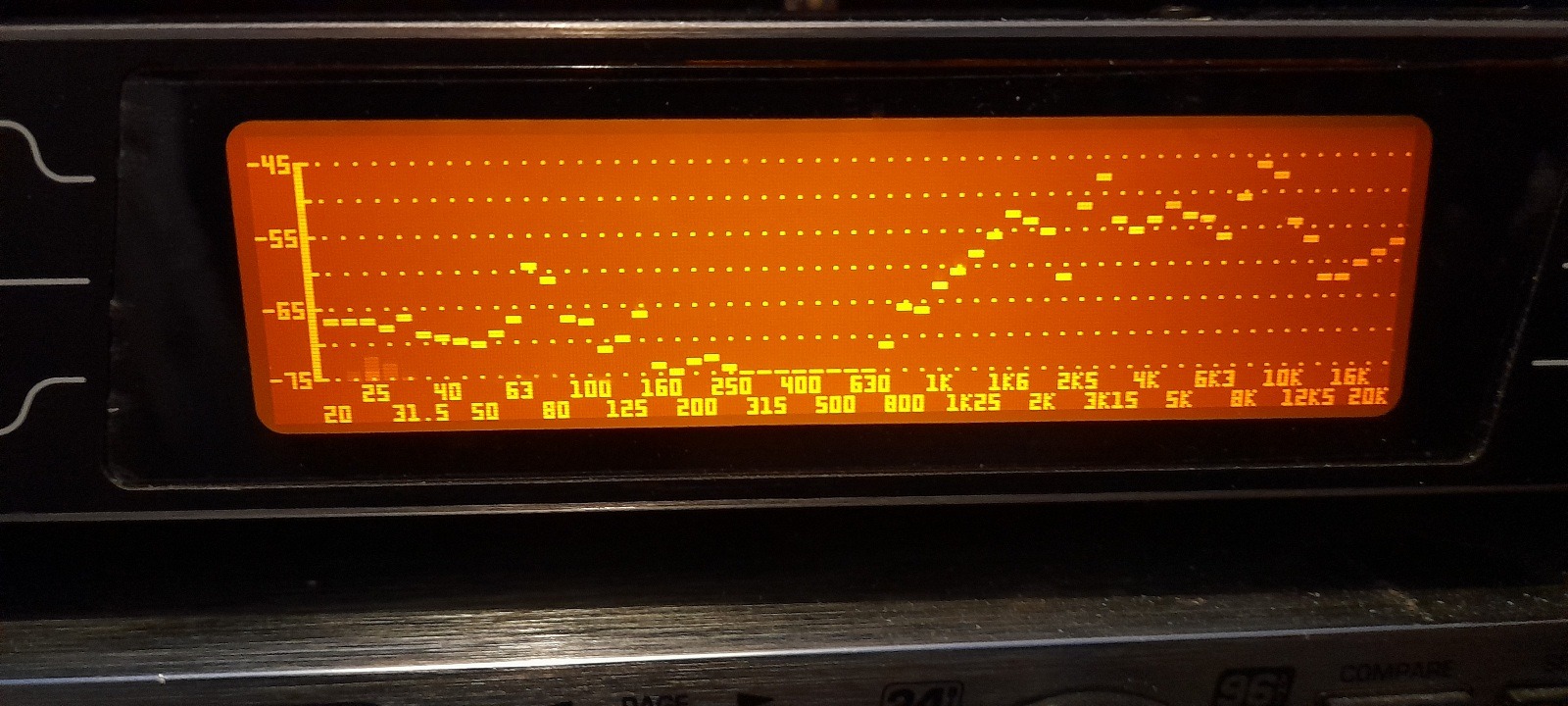

I have done a few crazy things with this whizzer idea, but here is 2.
Pic1
I glued the exciter to the whizzer then bluetacked the whizzer to the back of the panel.
Pic2
Is the measurement at 1m.
Pic3
Is the whizzer measurement at 3m ,the XO was at 770hz to match my TLs(not shown) , only with small blob of bluetack holding it on to wooden insert glued to the coil foot , this sounded best to me, so far?
Pic4
Is the whizzer.
Pic5.
Is the response at 1ft peaks that need fixing showing.
Pic6
The whizzer 1ft from the side , peaks reduced , still with good output from the side.
The main problem is matching it to a panel that needs it and is at the same volume level as the panel.
To be continued.
Steve.
Pic1
Pic2
Pic3

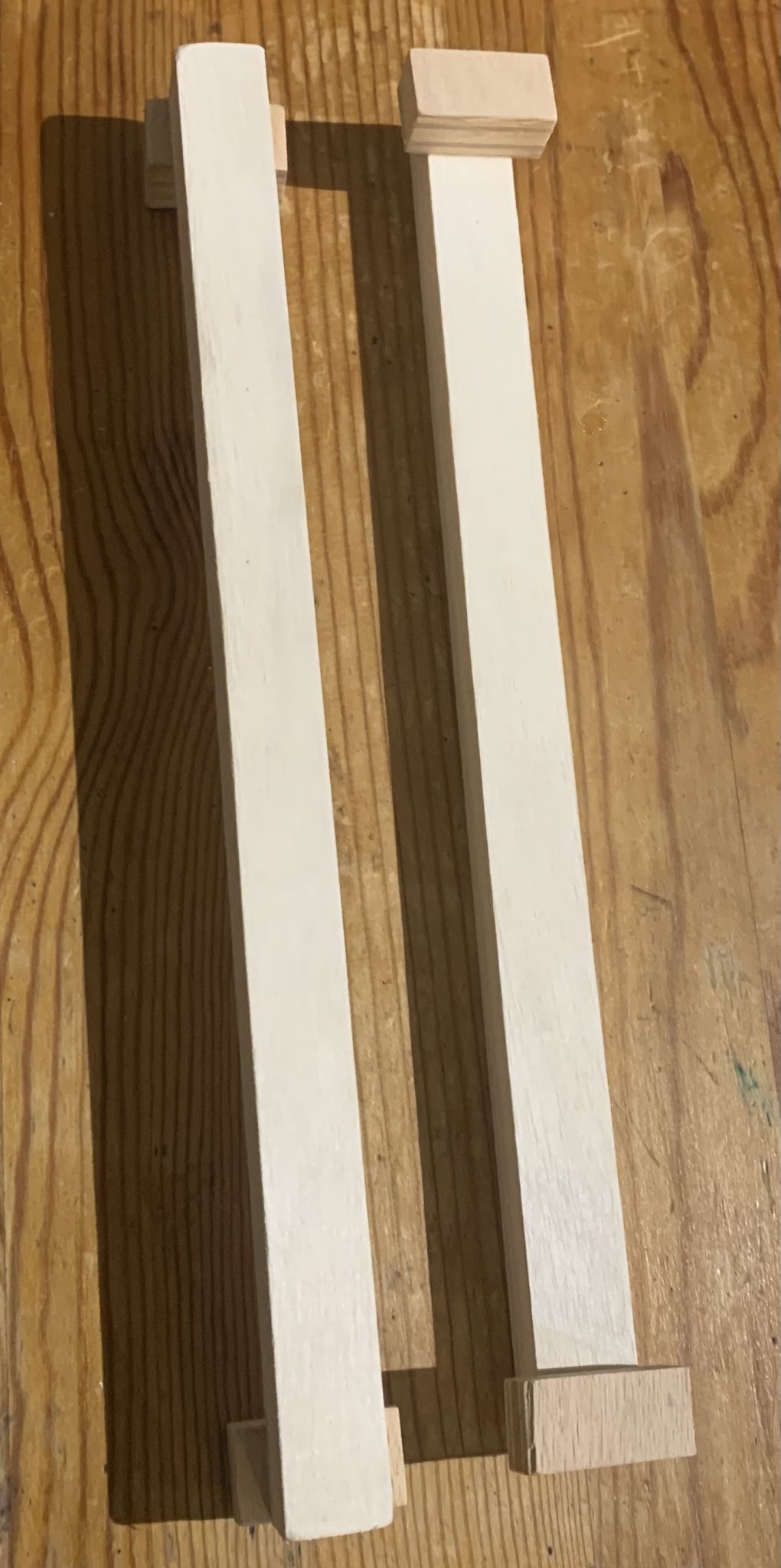

The spines are ready. Some scrap pieces of 18 mm paulownia wood and beech plywood were a perfect match. Now just a coat or two of clear lacquer and glue everything together. To keep the profile slim, I will use construction glue between the exciter and spine - it will be possible to remove if I ever needed to.

The cantilever approach would be worth a try I think, with the hinge at the top and a beefy exciter at the bottom for base, and to get floor gain. Another exciter in the top half for mids & highs. Should be able to put a baffle around it bc the hinge prevents much lateral movement, although the movement may be audible.
Pelanj.
That looks good, I can't see much of a gap between the exciter and spine but that could just be the angle ?
as long as there is a slight gap that can be filled with glue or filler of some sort that does not put pressure on the exciter.
although the fabric will still have a little play in it and allow for warping and movement.
hopefully the ply will not show from the front.
Steve.
