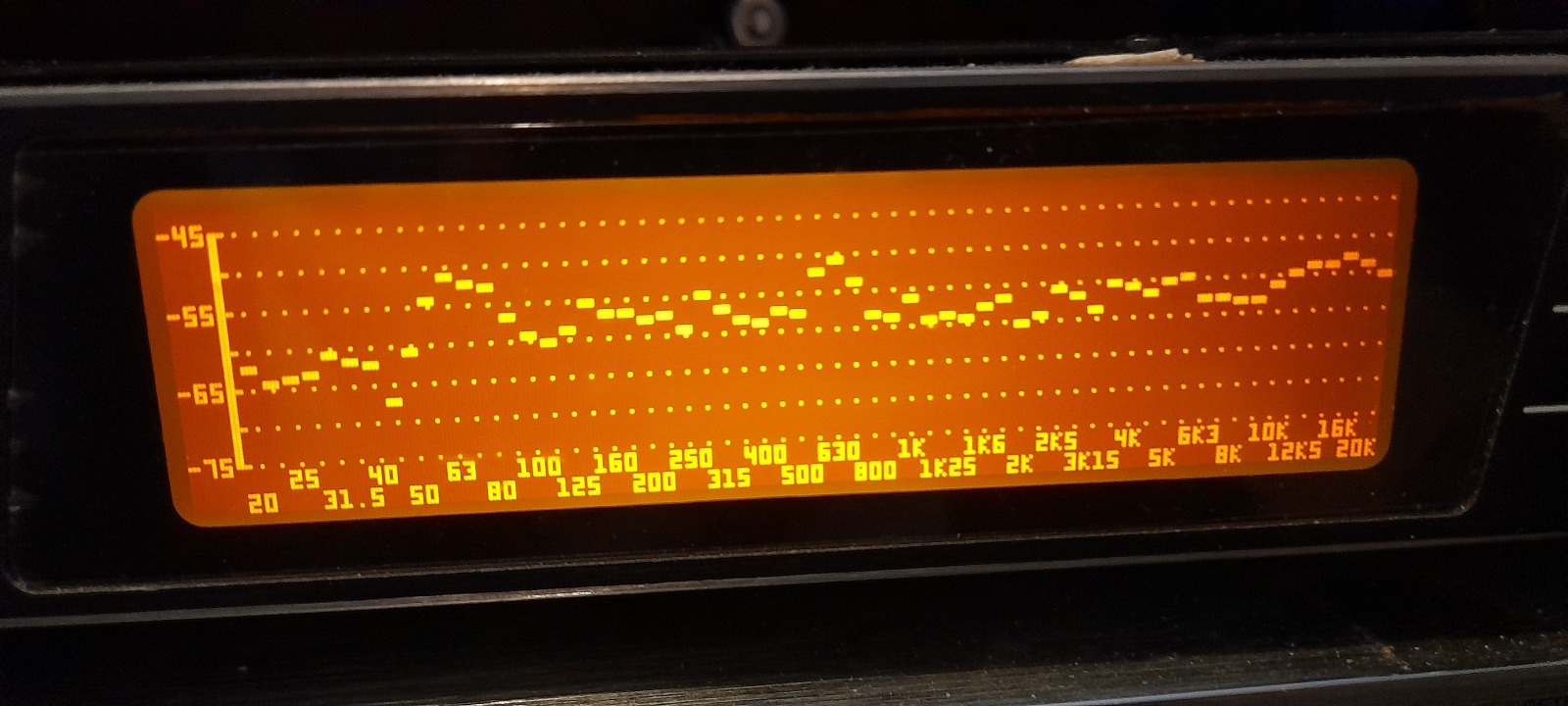

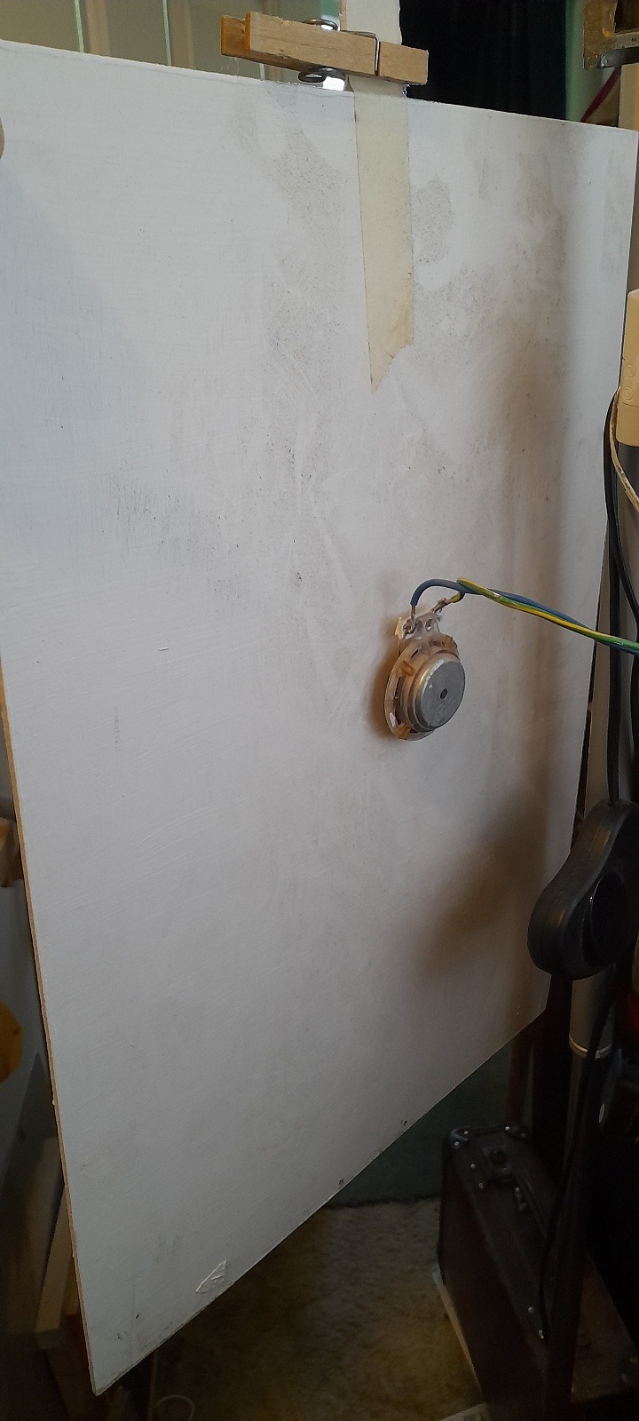

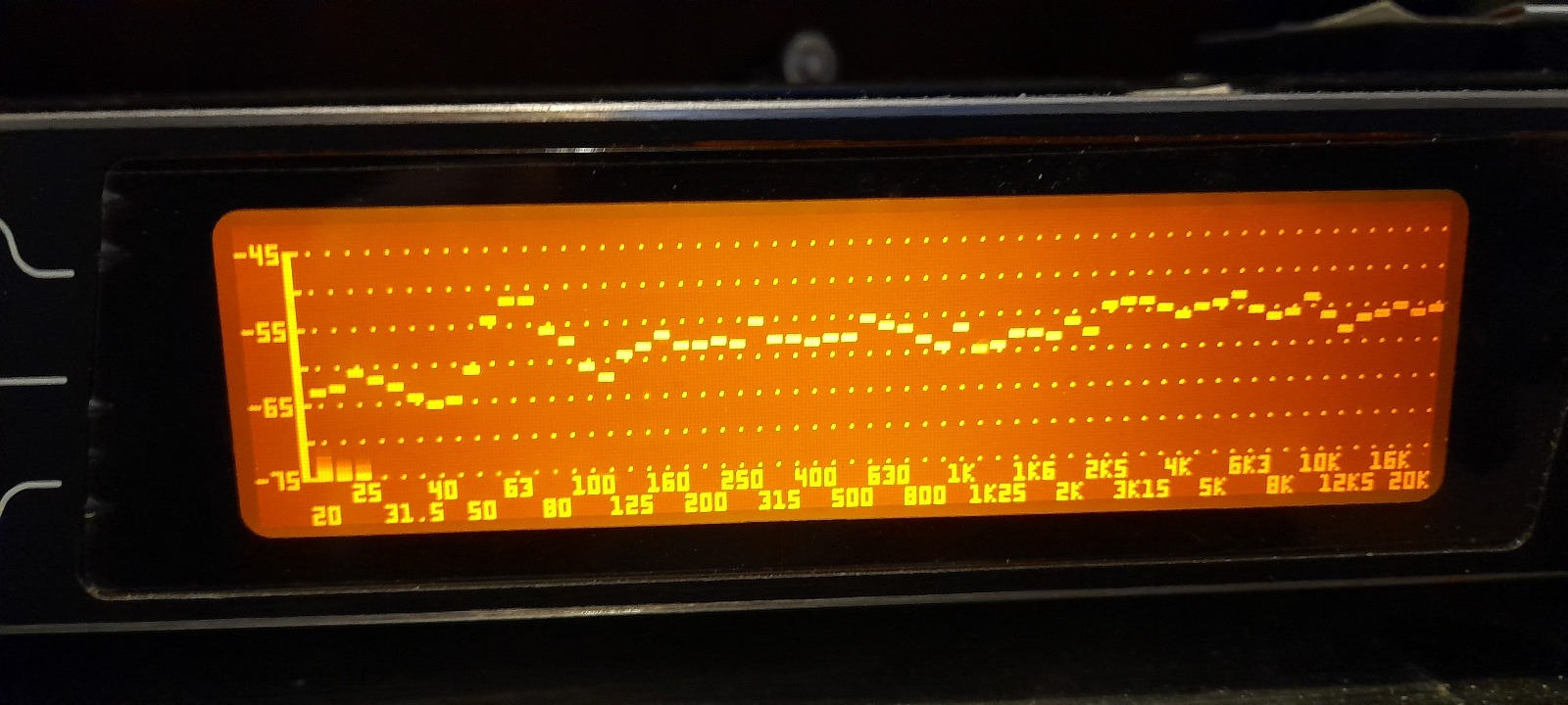

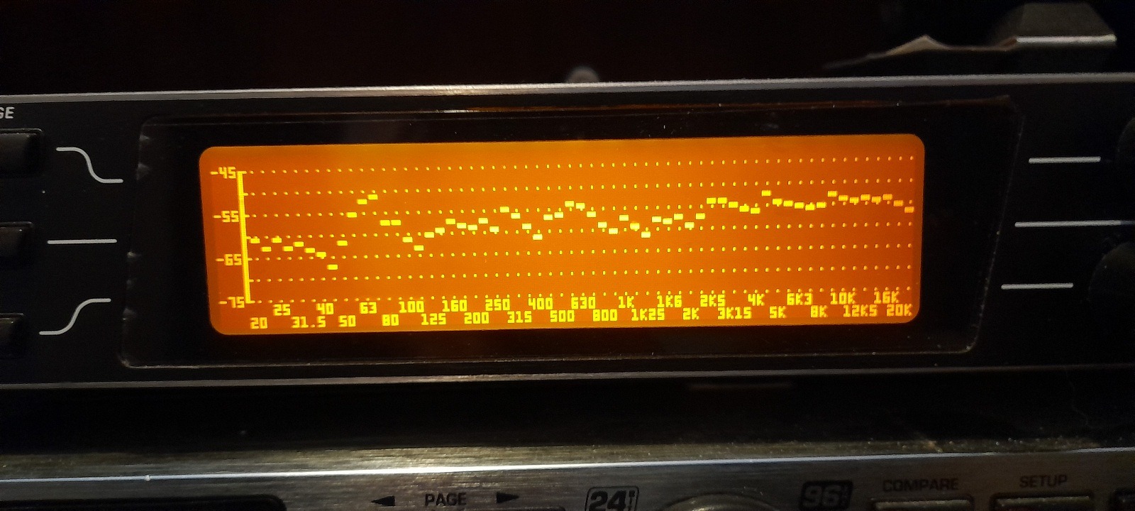

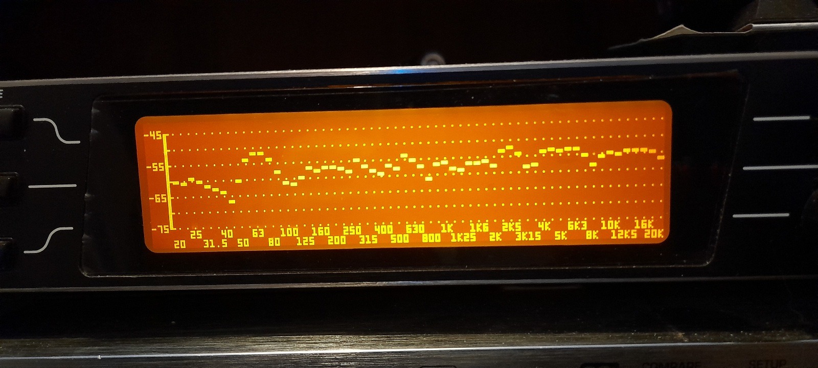

I found this old ply painted panel , it is covered in dust and cobwebs, I had been using it to stop drafts from the chimney.
Anyway, I made some measurements on it with the coffee ☕ whizzer .
Very interesting , to me anyway.
Pic1 the panel
Pic2 panel only measurement
Pic3 with 2cm cw good increase in response above 2k.
Pic4 with 3cm cw , surprisingly not as bad as expected, I think the bluetack is helping to damp the lower frequencies as well.
Pic5 I removed some of the bluetack from the 2cm cw and measured again.
The response not only seems smoother above 2k but also below?
I will have another listen tonight to see if I can hear any nasty colourations and such.
But nothing bad stands out so far?
I only have one 2 cm cw at the moment, I could cut a 3cm down a little to match, but the rim might be helping the sound?
Steve.
Ps , I should have mentioned the measurements were taken a 12inches distance.
Steve.
