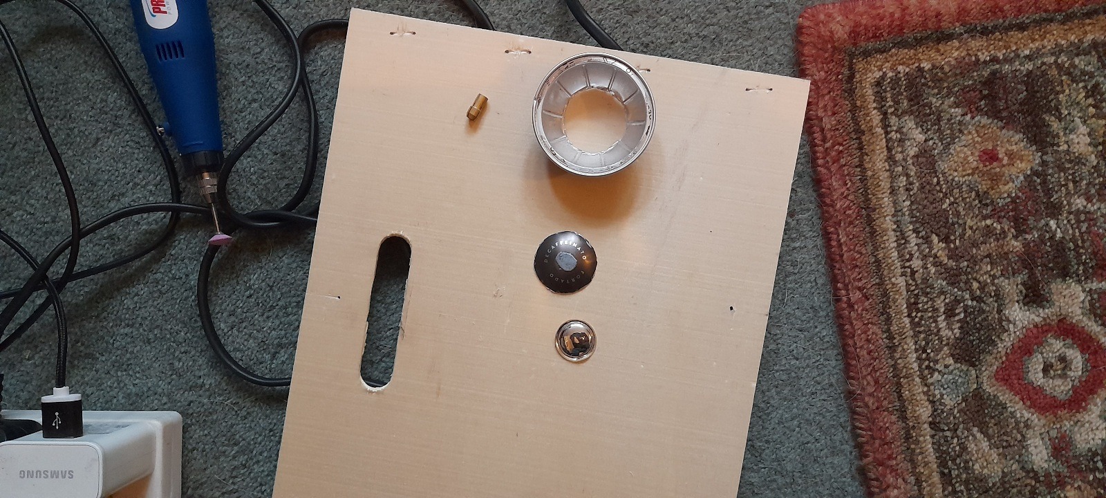

I forgot I had this panel and a cutter, couldn't find the cutter so used the grinder.
Two minute job.
The silver dust cover dome on the panel was from a small cone driver.
Steve.

Steve, if you don't mind,
Please explain why you're using whizzers and domes and dust covers etc to boost certain frequencies. I suspect that such solutions will produce pistonic action and hence beaming and directivity.
What am I missing?

Whizzer and domes do not produce pistonic motion and beaming , they already exist in the exciter area.
I mainly use my soft fabric dome to try and prevent the problems that I have mentioned in the exciter area before.
But not to boost frequencies.
But if it also helps the sound a little I am very grateful.
This does not work with all panel types.
Many years ago I noticed that DML is not 100% DML.
DML has pistonic action in the exciter area which produces bendingwaves, these bendingwaves reflecting back from the edges causing distributed modes.
How much pistonic action that is in the exciter area depends on the flexibility of the panel and lightness , and size.
One of the problems levelled at DML is that the sound on some panels is coming from behind.
There are ways to get over this problem and a whizzer is one method.
On eps I used to thin the material in front of the exciter.
On ply I used thin strips of paper.
I don't usually use whizzers , but I must admit that this morning I did play around with some and will post some pics and measurements after doing some more testing.
If a panel is lacking some top end for some reason , something like a whizzer can help ,it can also help the midrange a little as well if done well.
I think my best sounding panels sound so good because I encourage pistonic action ?
Even shelley katz of podium fame believes DML should be used with pistonic drivers for best performance.
I hope this has answered your question ?
Steve.

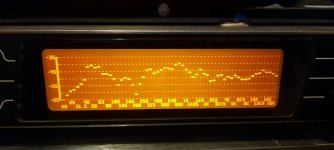

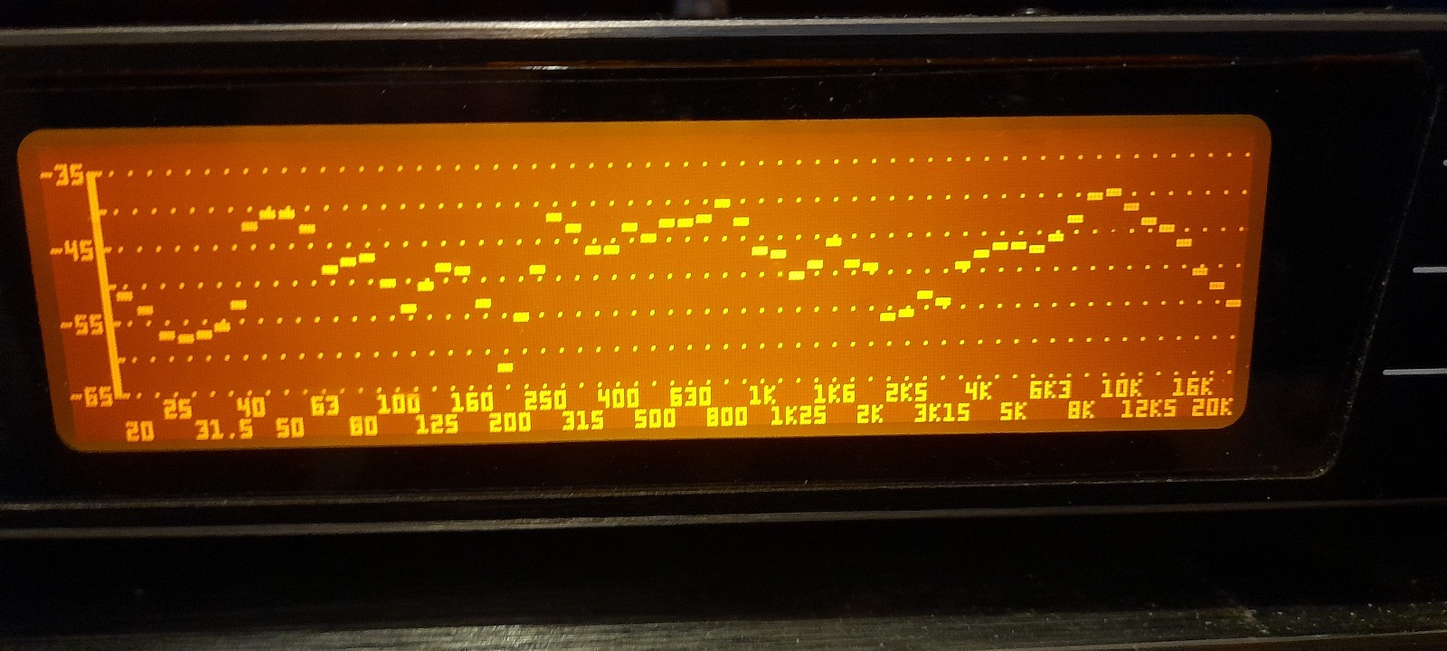

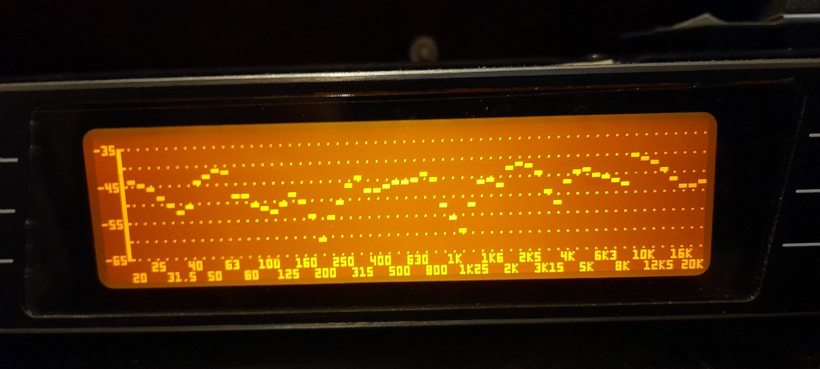

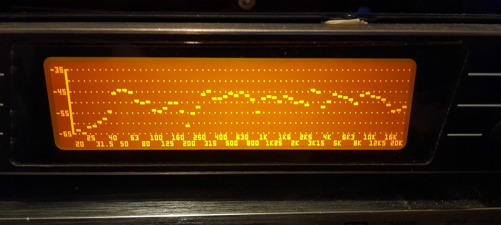

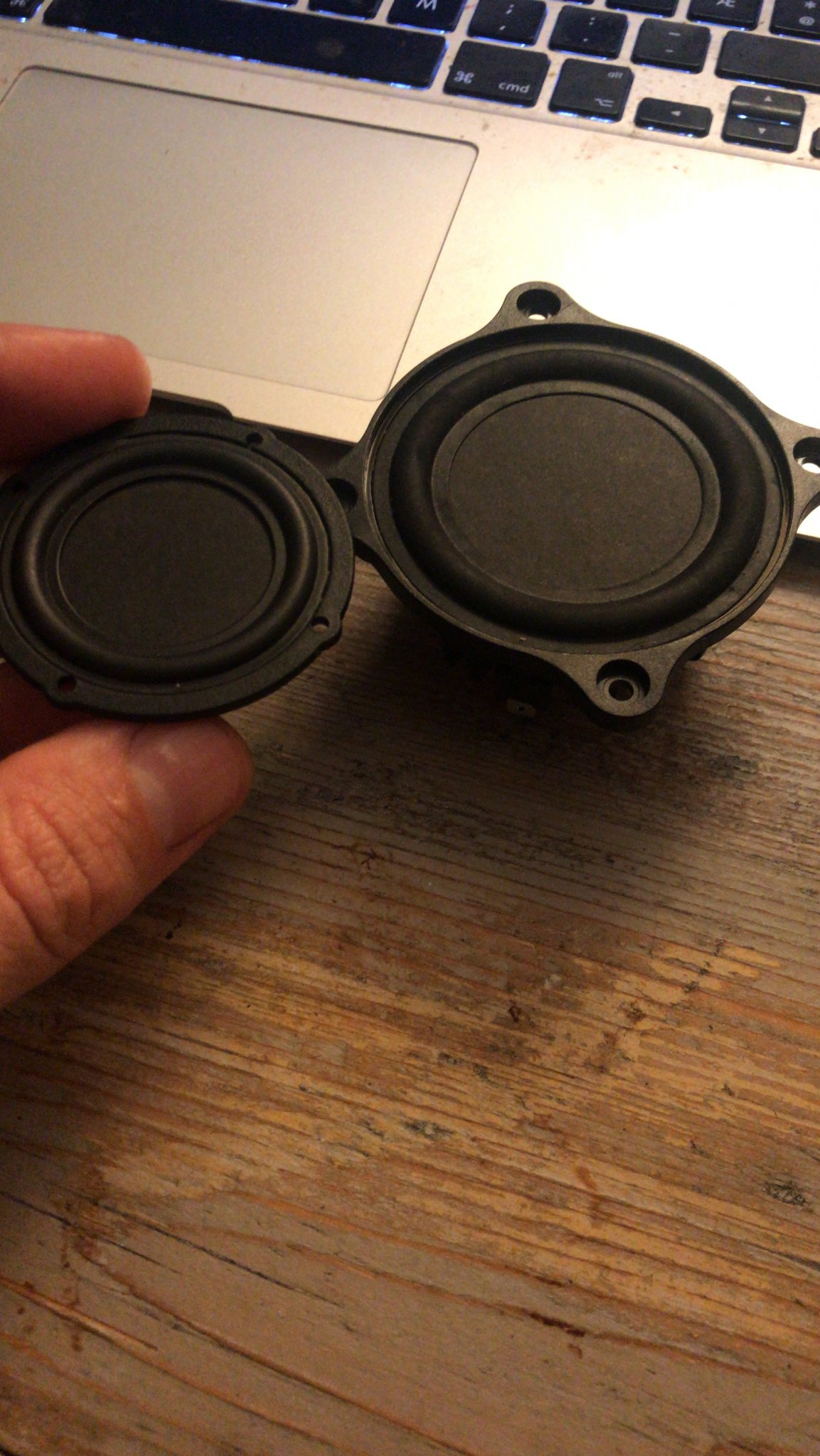

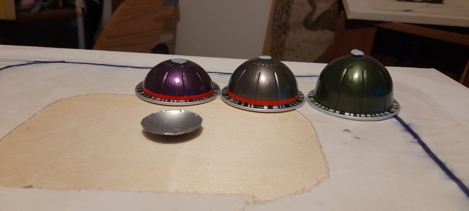

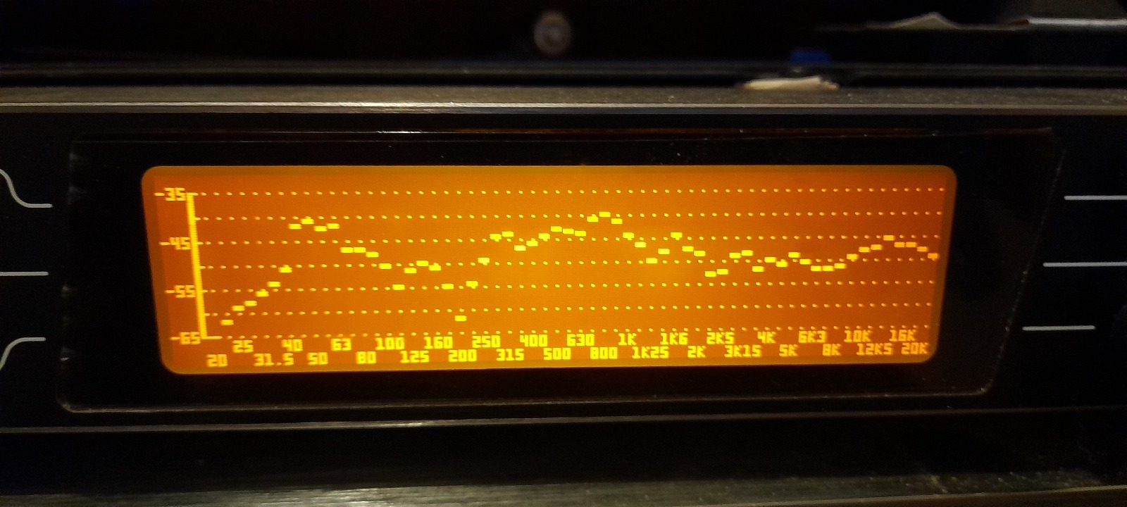

I just took some measurements of using different size coffee whizzers 😃
The coffee whizzers were in 4 sizes .
Pic 2 is the largest, far to deep.
Pic 3 was the smallest still not very good ?
Pic4 was without any whizzer.
Pic5 was the smallest of the uncut coffee whizzers on the left in pic 1.
This whizzer increased the output in the 1k to 10k area, and sounds good,so far , more listening needed.
The three sizes were 2cm, 2.5cm and 3cm.
I didn't bother showing the 2.5cm measurement ,as it too was not good enough either.
This panel by the way, was the crate ply on a canvas panel.
I did try it on the crate ply , but that panel already had plenty of HF and had a pretty flat response.
So was hard to compare.
The canvas is probably over damping the crate ply ,so a little boost from the coffee whizzer seems to work quite well.
The whizzer Gives the panel a little more sparkle and life.
I will have to pop around to my friends house and have another cup of his lovely coffee ☕️
I wonder what he will say when he asks me what coffee I would like, and I say , a 2cm please 🤣
Steve.

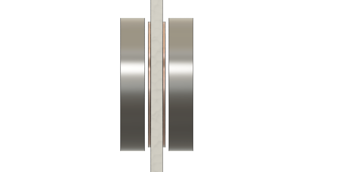

Can you please make a drawing of your idea?
Actually, now you've forced me to think about it, I realise the idea won't work. I was thinking of a bar magnet with a solenoid around it. But forces on bar magnets only occur because the magnet has ends, which are attracted or repelled by the N or S ends of a solenoid. Once completely immersed in a uniform field, there is no resultant force on the bar magnet.
You could, for example, put a hole through the panel, glue the coil & former inside that, and pass a soft iron core clear through the hole, with neodymium magnets on both sides. Of course it does need to be supported on both sides, but the higher field strength & better geometry should mean that the tolerances are less important. Maybe you could also think about eliminating the coil wiring altogether by using induction coils, at least for low frequency.
I've actually been working on this. There are many significant advantages.
But the problem is the alignment of the VC onto the core, and keeping it aligned under rough handling.
Reactions: lenta and BurntCoil
Interesting discussion about the possibility of DIY exciters. I raised this some time ago on the forum too.
I think it's probably very difficult to build a better exciter by competing in terms of manufacturing techniques. However there may be some low-hanging fruit stemming from the fact that we don't have to build a saleable exciter product, but a complete system.
For example, exciters have to compromise on field strength because one side of the exciter has to be open, with resulting field leakage. But we have a good deal of flexibility in the geometry of the panel, and are not limited by size because we can separate the moving parts from the heavy parts carrying the magnetic flux. You could, for example, put a hole through the panel, glue the coil & former inside that, and pass a soft iron core clear through the hole, with neodymium magnets on both sides. Of course it does need to be supported on both sides, but the higher field strength & better geometry should mean that the tolerances are less important. Maybe you could also think about eliminating the coil wiring altogether by using induction coils, at least for low frequency.
The attached pdf describes one variation of the coil-within-the-panel concept, and the design keeps the VC and magnet assembly nicely aligned.
However, the shortcoming is that the VC does not sit within a pole gap: There's a core magnet, but there's no surrounding pole for the VC to cut the magnetic field.
The BL would therefore probably be a lot less than half of what it could or should be.

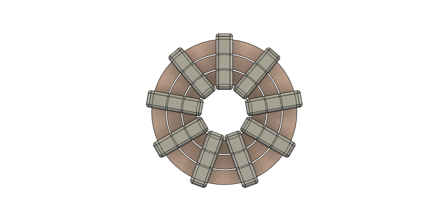

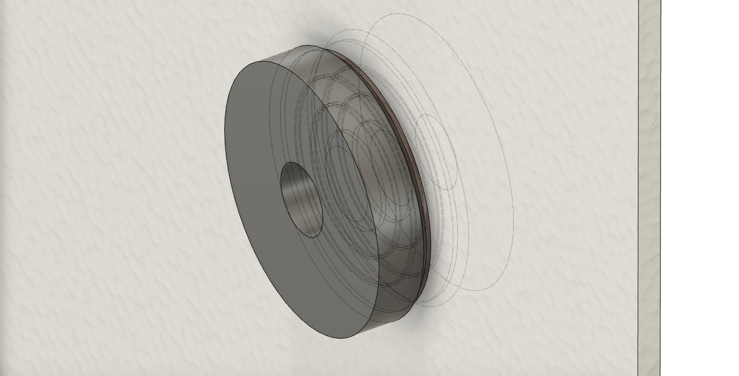

Radial Thoughts
@Andre Bellwood, I had some thoughts in the same direction, mounting coils directly on the panels, but I came out in a different place. You can use flat coils mounted directly to the surface if you use radially magnetised ring magnets. To max out the field strength you can use two sets of coils and magnets on opposite sides which would flatten and intensify the magnetic field. You would have to invert the phase on one set of coils obvs. A manufacturer would be able to get custom ring magnets made up which is too expensive for DIY but you can sort off simulate the same effect using a radial array of bar magnets. Images attached.
I thought there were a number of benefits in that you can split the flat coils into several concentric coils allowing you to control inductance by summing in parallel/series to get the inductance you need which might help the top end performance. Coil heating would also be reduced as the coils are in open air and free to radiate and conduct away heat helping to extend performance limits. As my preference would be to use neodymium magnets there is also the benefit of getting iron out of the circuit reducing eddy current effects, although I am not sure if this is significant. Robustness and alignment tolerance will be much better as the displacement of coil to magnets by a few millimetre is no long a disaster, just a mild drop in performance.
One of the interesting questions for me is how you would treat the voice coil mass now it is directly attached to the panels and the effect this has on mechanical impedance and impulse transmission. This is all very theoretical at the moment, and predicated on being able to get a high enough B. Increasing L will be trivial. I expect there is something I have not thought of that will kill the idea, there usually is, but if I get anywhere I will report back to the group.

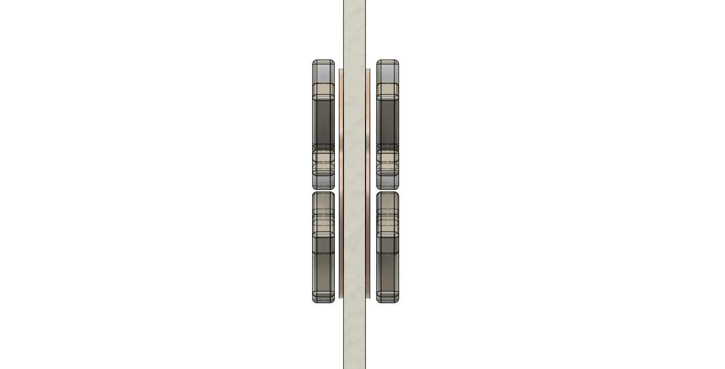

It solves the problem of no net force by having a two magnets with the same poles facing outwards. But I think it would be quite non-linear because it's depending on the interaction of the edges of the magnetic field of the magnet and (because the coil is short) also the edges of the solenoid field as well. And also, as you say, lots of field leakage.

This setup is very similar to fig 5a in the parent Andre just posted.
I did mention some years back , bolting two exciters on opposite sides of my ply panels.
I never managed to get around to doing it, but thought it could be good for pro use.
Steve.

Radial Thoughts
Burnt
If I understand the design it also suffers from dramatic field leakage, and is even more non-linear because the force increases as the coil approaches the magnet. So it risks colliding.
