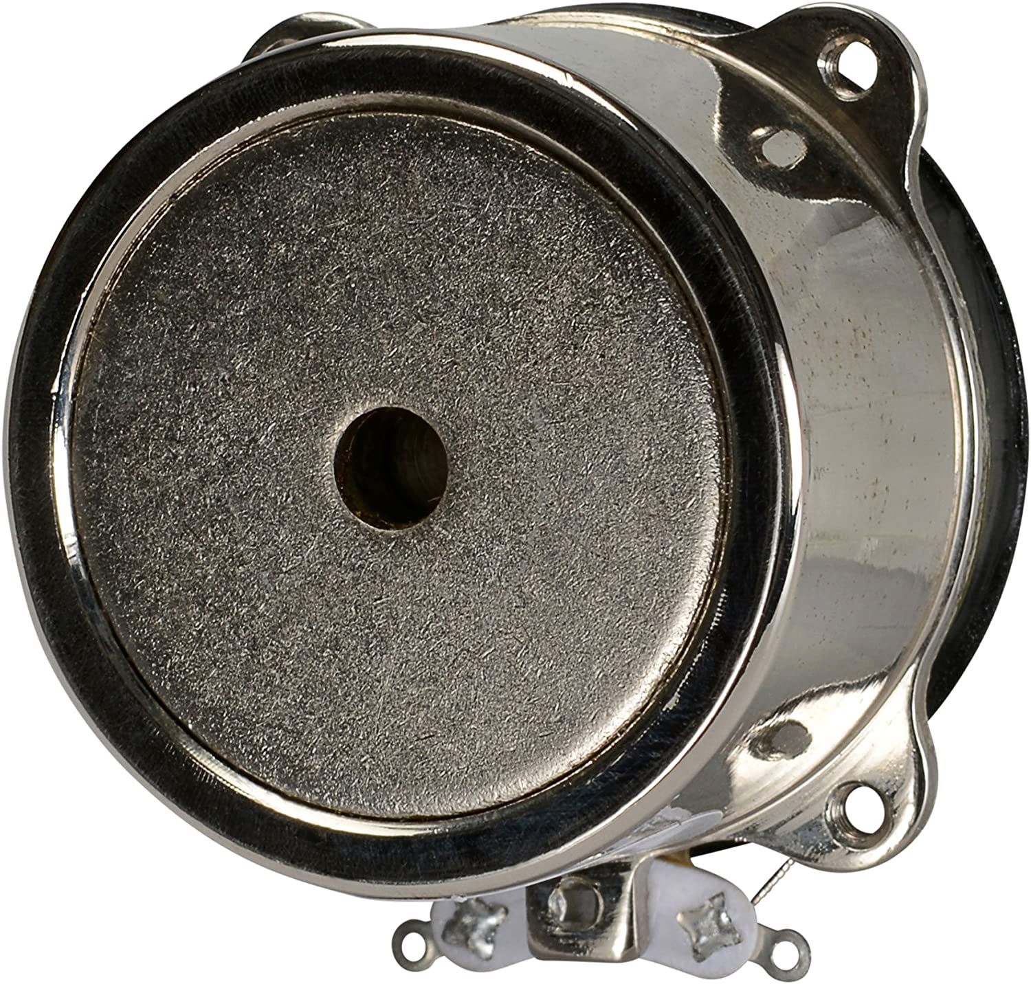

Am I correct in thinking that this new EX series is simply a few of the popular DAEX exciters in a different jacket?

Essentially yes they are existing exciters with a revised connection method. In principle it’s a good idea but they may have got their thread design wrong. Please note I have only had one experience of this happening so it may be a manufacturing tolerance issue. Time will tell.Oh now – that’s no good if they are prone to loosen grip and release under vibration. Using adhesive once the mounting disc is finally fixed to the panel makes sense but negates the whole objective of easily replacing a faulty exciter. So, these mounting discs are great for experimenting with different positions and even multiple exciters on a panel, but why on earth are they sold in packs of 5? Surely an even number in the world of stereo makes more sense?

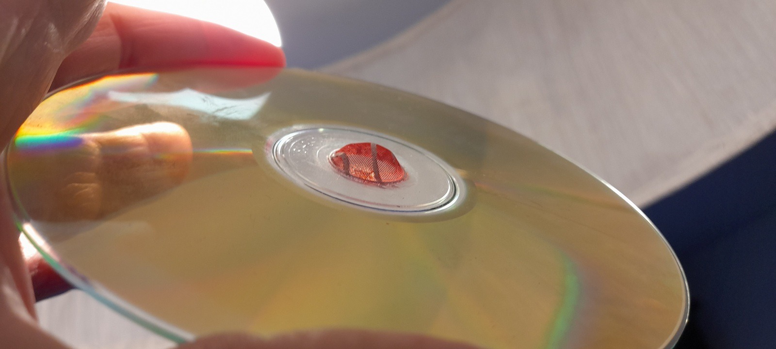

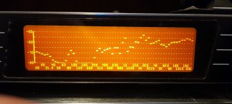

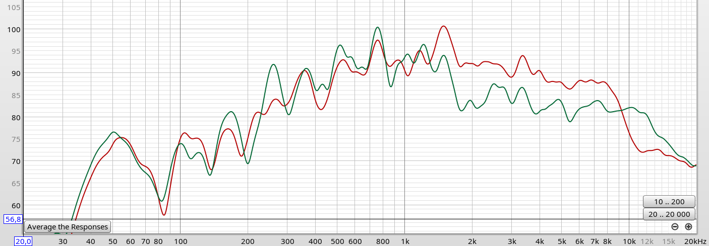

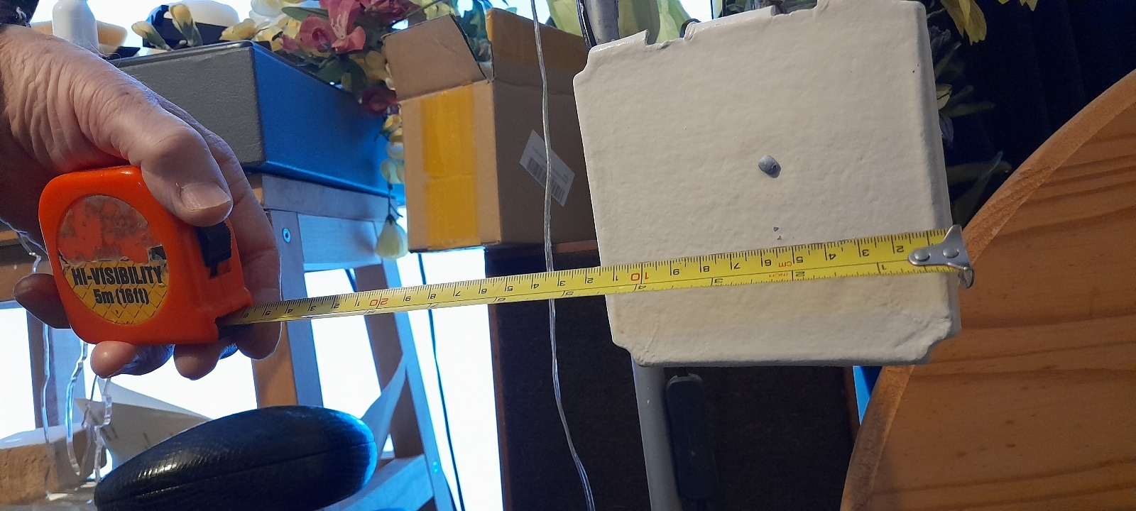

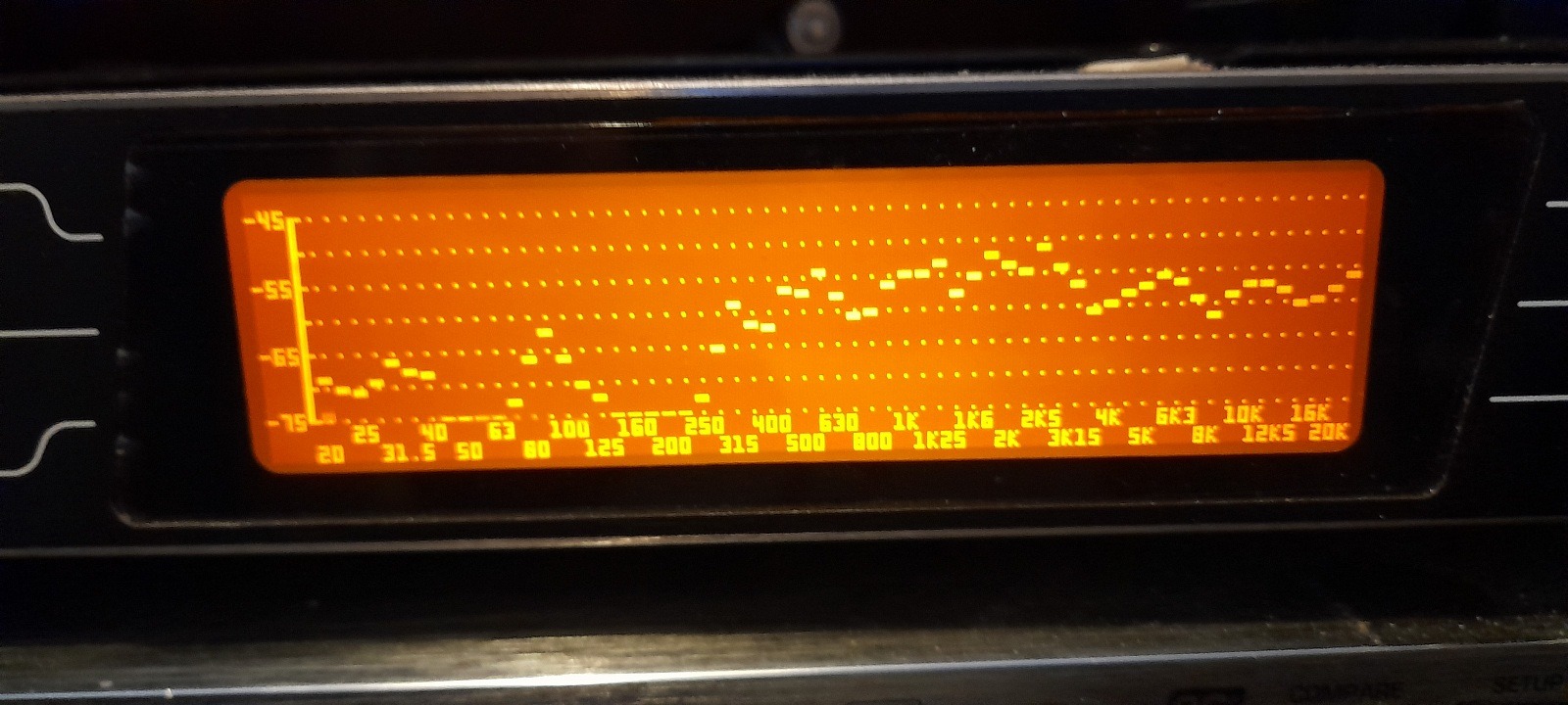

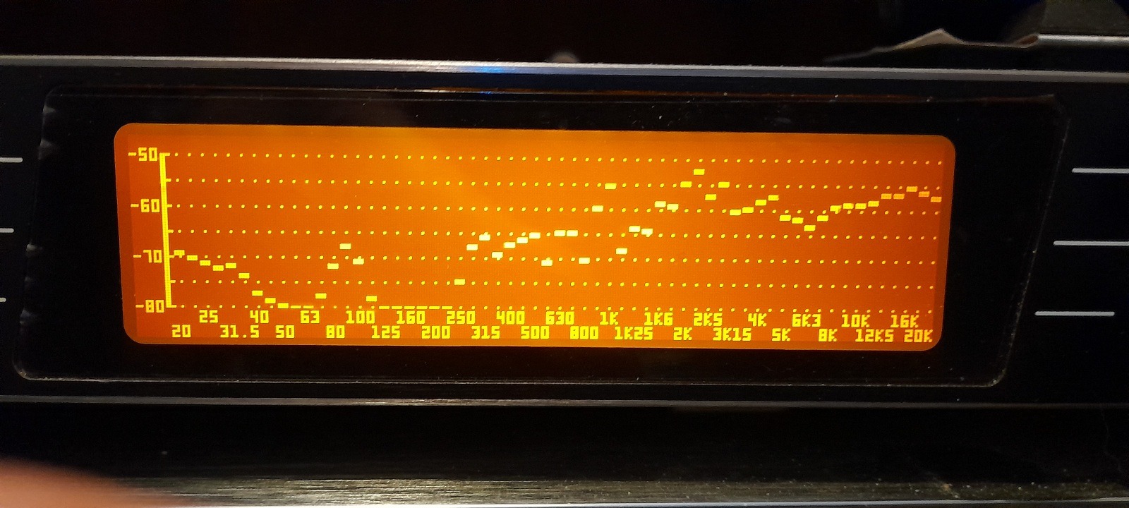

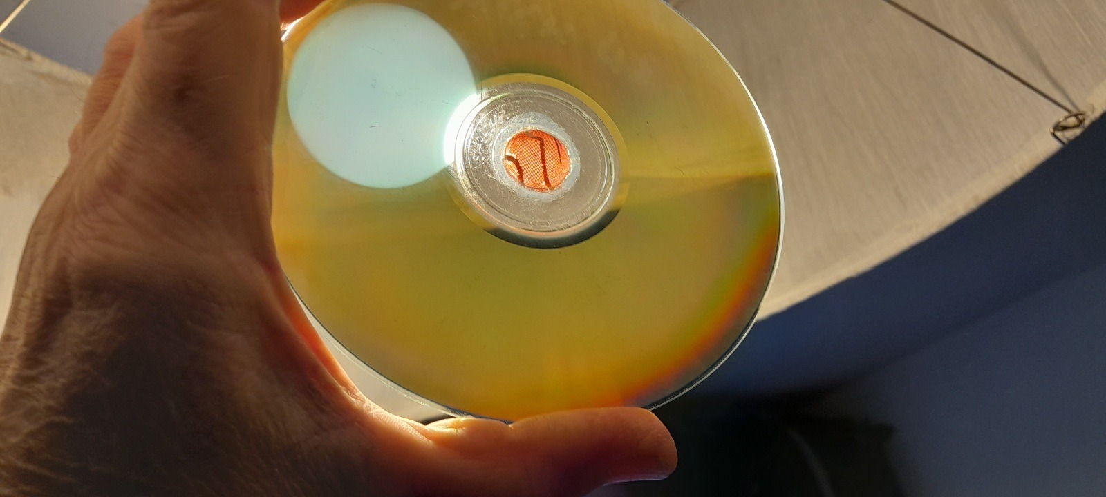

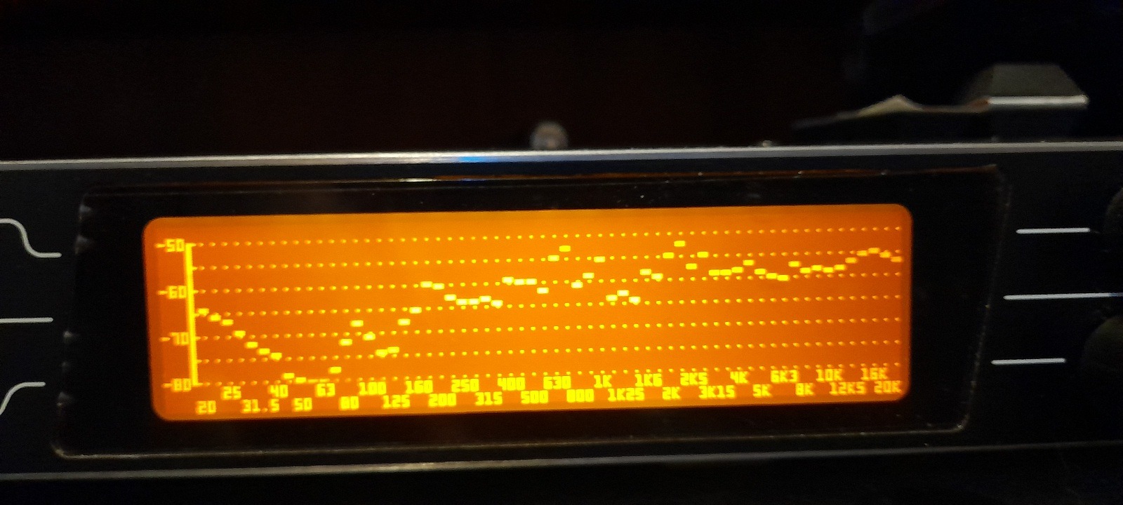

Hopefully if the pics are in the right order, the first two are of another CD with a small fabric dome.
As an experiment, This dome does not have any pva coating .
The third picture is the measurements of another CD with the small dome plus pva coating .
It goes down to 250hz.
The fourth pic is the small pva dome CD with me holding the CD in my hands to mimic a firm mounting.
This goes down to 160hz.
The fifth pic is an old painted paper mache egg box top ,about 5.5 inches in size, that I had left in a draw, unmounted.
The last pic is its frequency response, which goes down to 250hz unmounted.
Although it's turned more into being about domes , the lower frequencies are interesting.
Steve.

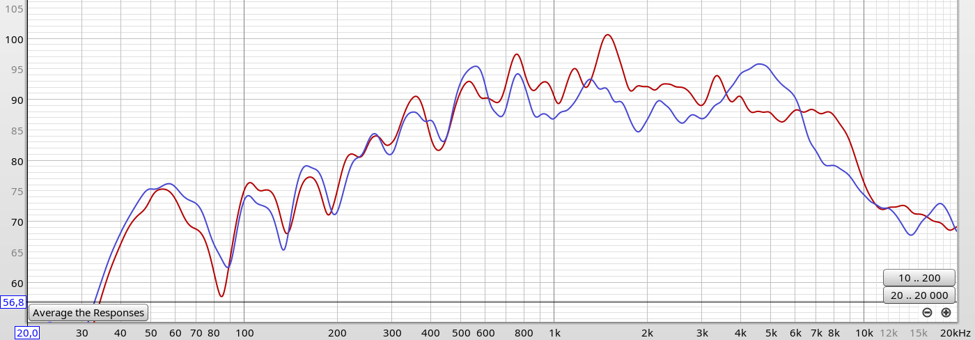

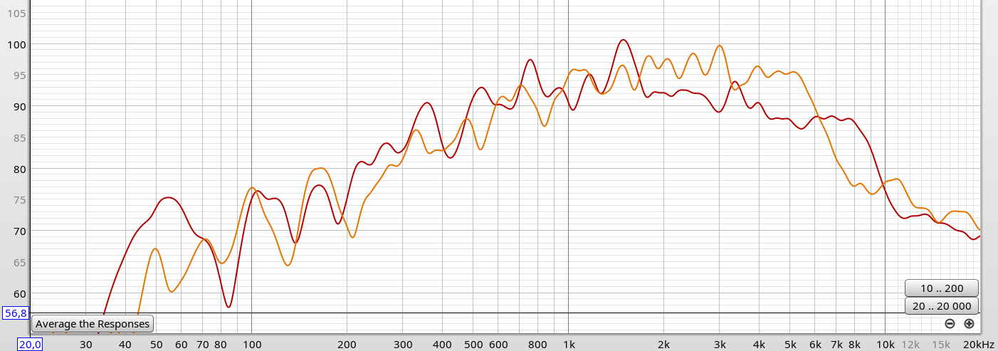

I had the possibility to make some tests this week. One of the target was to measure the effect of a coupling part. As you will see, it is not full conclusive on that point but interesting on another (at least to my point of view) and related to your list.
Here is a picture of the tested panels.
All the panels are 20x30cm XPS 9mm (depron)... I had a stock of this. In fact it is the second material I made panels which have never worked and I would like to understand why...
Left is a concentrator made of wood sticks, central is a bottom of soda can (44mm) to enlarge the contact diameter with the panel. Both are on the exciter side. Right is an Eucy's dome so in front of the panel.
Red is panel without accessory, green the concentrator (left on the picture above)
Red, the panel without accessory, blue with the 44mm dome as coupler
Red, the panel without accessory, orange with an Eucy's dome
What I understand from this test is the sensitivity of light membrane to additional mass - in better words, low mechanical impedance material.
