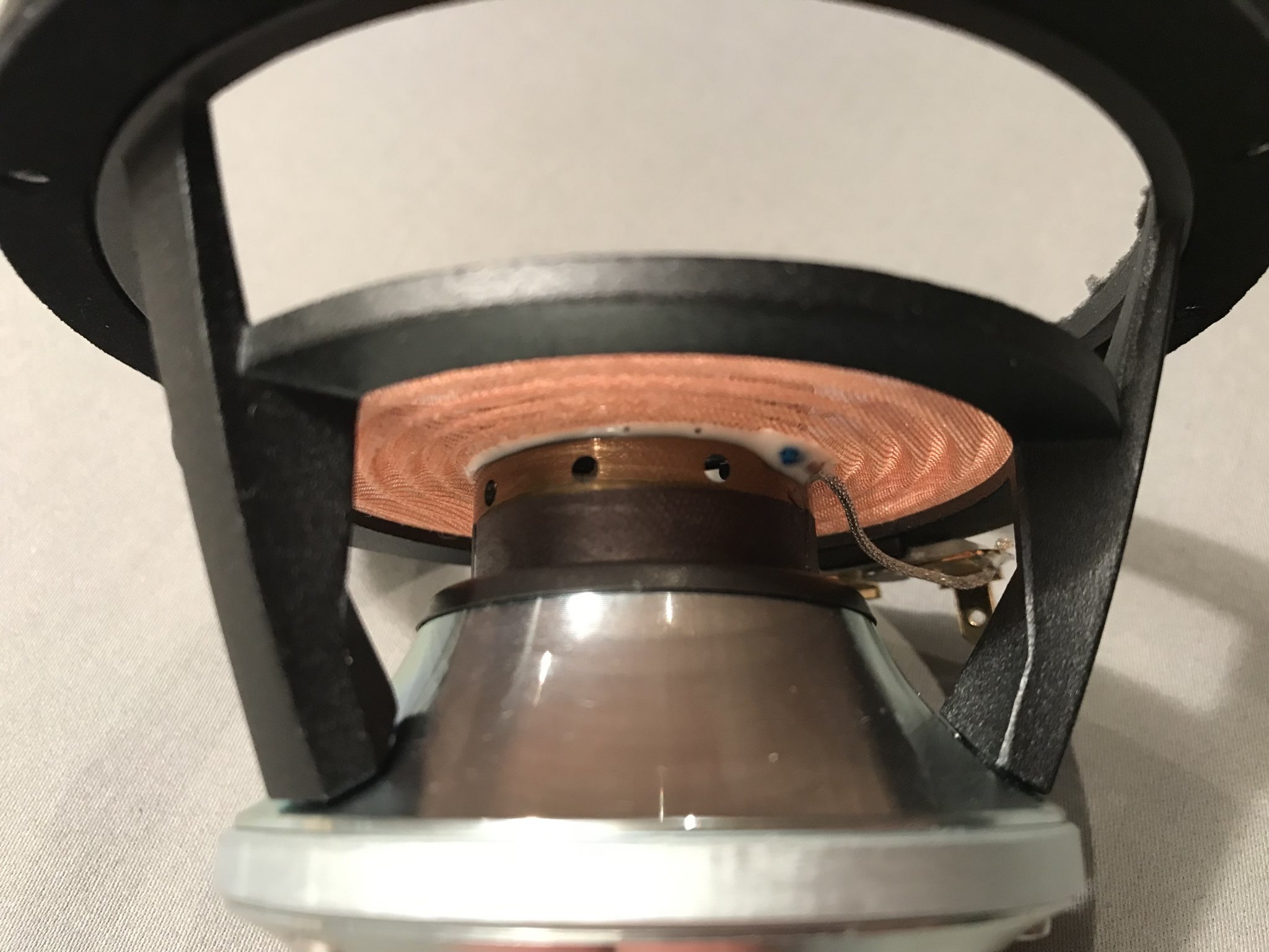

Tectonic in their dml panels uses exciters with copper winding on inside and outside of voice coil former. It is probably dificoult to manufacture, but gives several advantages, main are increased motor strenght(Bl) without increasing inductance.Perfect Impulse

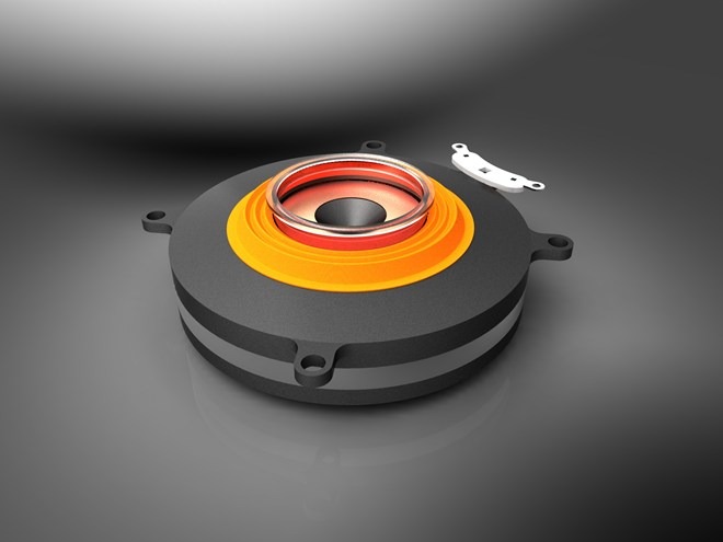

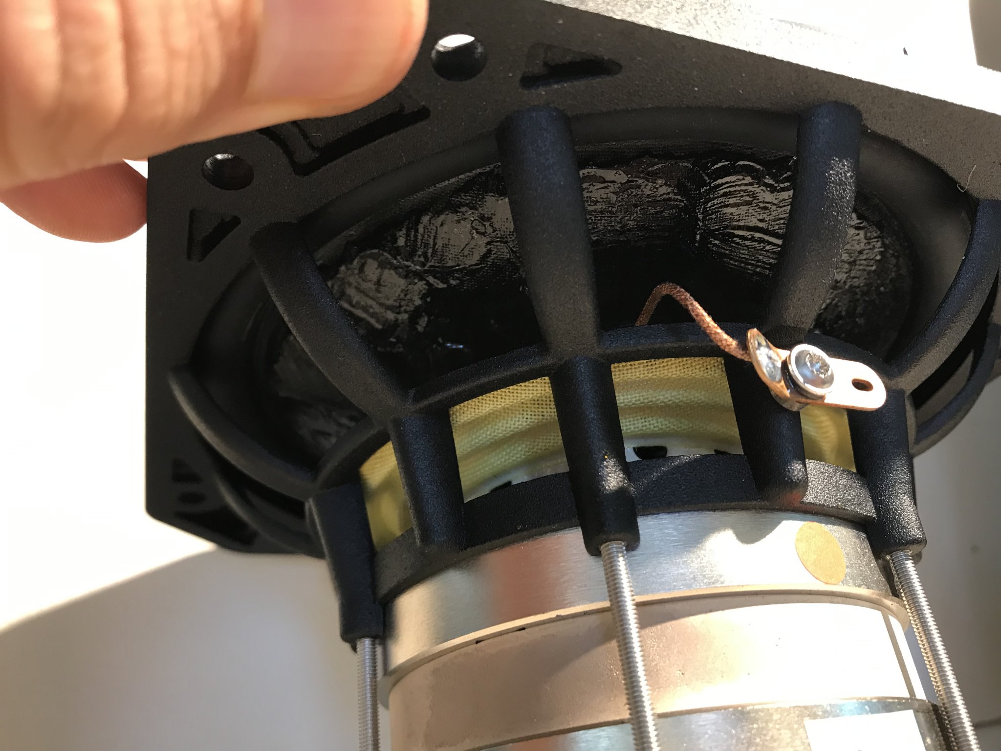

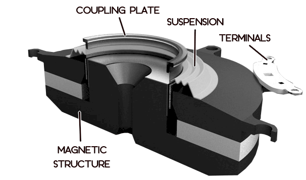

I have captured my initial thoughts below, but I would be very interested in any observations you might wish to make.
What are the areas of exciter design that may benefit?
- Panel/exciter interface- can we do better than double sided tape? Can we get a benefit by increasing the attachment area to increase adhesion, or is decreasing the attachment area as a force concentrator a better way to go?
- Voice coil design- 25mm diameter voice coils seem to suffer from less buckling strain than 32mm voice coils. But 25mm coils offer less coil length ( the L in F=BLI) and so, all other things being equal, less motor force. Can we either use better materials for 32mm coil formers- e.g Carbon fibre or Aluminium, or can we compensate for 25mm diameter coils reduced L by increasing B, the magnetising flux, or increasing I, the current delivered?
- Suspension design. From what I can see this part of exciter design has received a lot of focus and performs quite well, however there is plenty of evidence of noise from some metal suspensions. To gain a performance enhancement perhaps we rethink this area completely?
- Regarding the motor force F= BLI, current, the I in the motor force equation, is supplied by the user. For the manufacturer current is free, so it makes sense for the manufacturer to bias their motor design towards being a current user and, for a given F, reduce the magnet and amount of wide in the voice coil as these are a direct cost to the manufacturer. We can gain efficiency if we increase magnetic field intensity B and voice coil length L
- Demonstrating that all design is a mater of balancing opposing constraints, increasing L increases the inductance of the voice coil which rolls off the HF response. Can we improve HF response by reducing L and increasing B to compensate for the loss in efficiency?
- Newton tells us every force has an equal and opposite reaction. We usually absorb the reaction by mounting the exciter to a spline, or let the exciter mass provide a reaction mass which in my experience only works well at low to mid volume or where we limit the bandwidth of the exciter to omit bass frequencies. . Is it possible to harness the reaction force to drive a second panel?
- Exciters need to be shipped worldwide and mass is expensive to ship. Freed from this constraint can we gain performance improvements by using heavier materials, e.g. metal instead of plastic for the body?
- There are a lot elements in the panel/exciter system. Voice coil, voice coil suspension/spider, and sometimes two of them, voice coil drive plate, suspension frame or basket, the panel itself, which makes for a complex system. Each component alone is a potential source of distortion and there will be secondary effects cause by the interactions between the different components. Can we eliminate some components to simplify the system?
- Can we improve the performance by using techniques new to exciter design e.g. the use of ferrofluid may improve heat transfer from the voicemail and potentially damp any unwanted voicemail resonances?
- At this time I don’t know if the motor design uses a long coil/short magnet gap approach, but I suspect they probably do because magnets are much more expensive than copper wire so the manufacturer would want to reduce this cost. Displacement is not an issue for exciters as they are designed to impart an impulse to the panel to propagate surface waves rather than move the panels in a piston like mode, and so a short stroke for the voice coil is a given. But it is just possible that with such cheap components made in the millions there may be compromises here as well that could be removed. A long magnetising gap and short coil may offer a better balance?

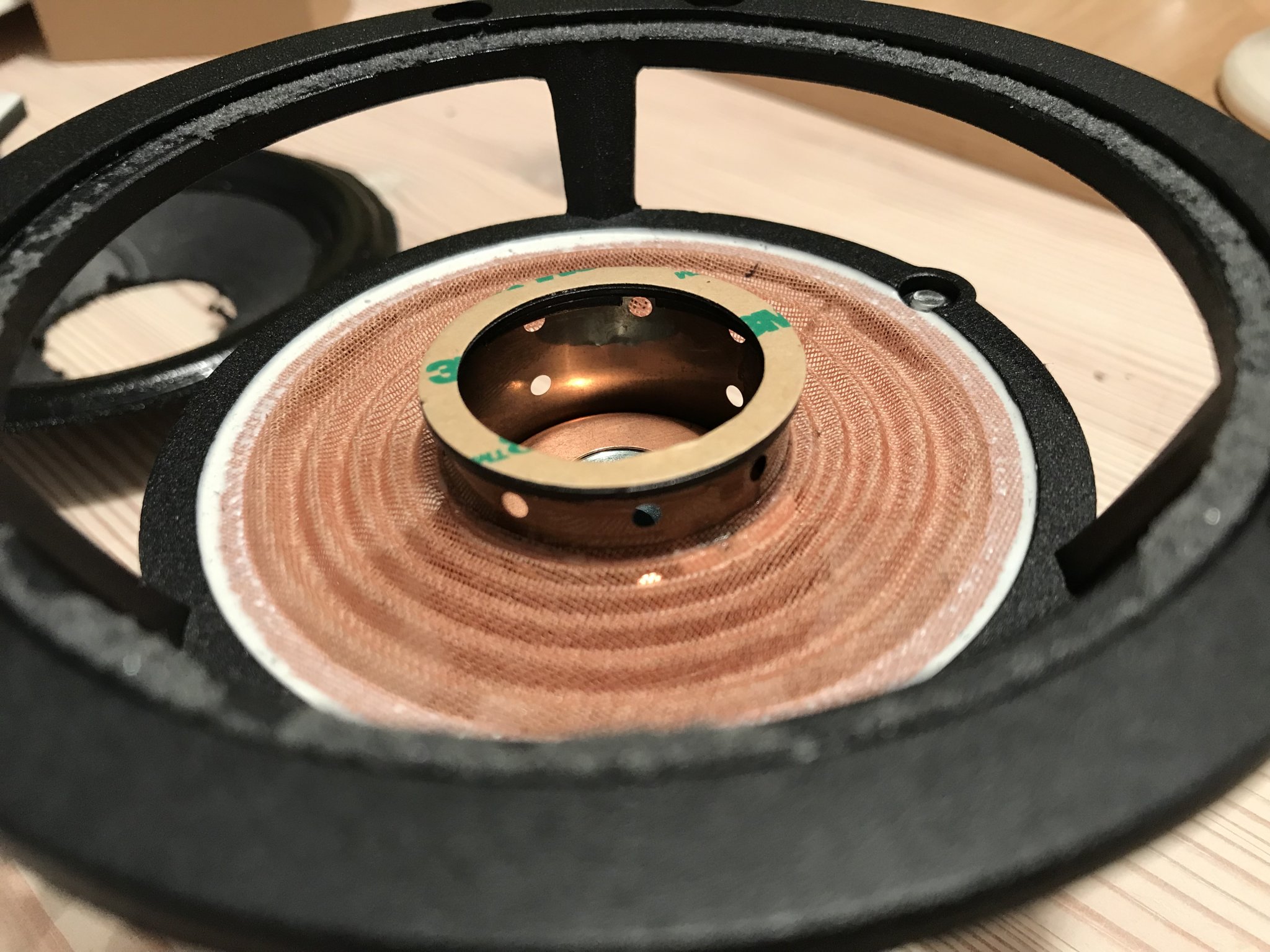

Some possible routes to investigate. Two exotic options first.
- Mounting the voice coil directly to the panel would eliminate the voice coil former which removes buckling strain noted in 2. above, removes the drive plate and provide a very stiff coupling between panel and voice coil. This would be a less efficient motor design than the conventional one and require a significantly stronger magnetic field to compensate.
- Assuming a more conventional exciter design, can we provide a rear mount to allow a second panel to be attached to and driven by the exciter. This second panel could be of a size, shape, and material to extend, or augment the main panel. I note that a second full size panel would introduce interesting challenges, e.g. the gap between the two panels produced by a typical exciter would reduce the size of the wave form than can form between the two panels , i.e., the output would be bandwidth constrained.
- Tapering the size of the drive plate to reduce the contact area could provide a force concentrator to improve the transmission of signal to the panel?
- Freed of the cost constraints we can certainly revisit the balance of magnet size, voice coil length and current that F=BLI requires, e.g. a bigger magnet and smaller coil to improve HF response for a given force
- Freed of the cost constraints we can consider stiffer materials for the voice coil former to reduce/eliminate voice coil buckling.

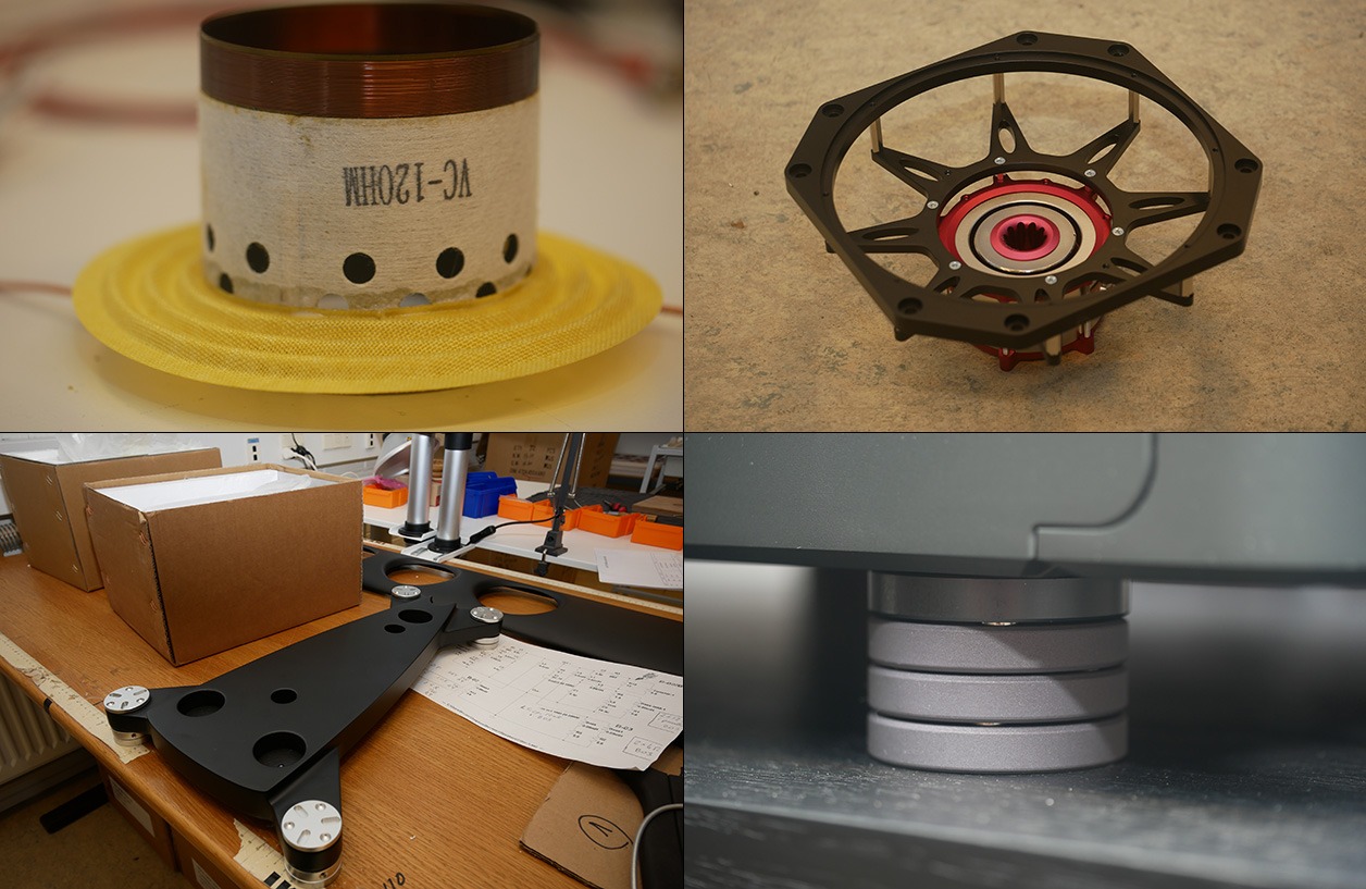

Practicalities.
Both speaker motor magnets and voice-coils can be bought online and motor cases and spiders can be printed using a 3D printer ( including carbon fibre filled materials) so experimentation is feasible, although it remains technically challenging. The biggest hurdles that I can see are more in the area of the motor design itself, simulating the magnetic circuit is a non-trivial exercise and measuring the results of each new design will be a challenge. However, all designs start off on a bench top somewhere so there must be a way. Also, some of the options can be tested by adapting existing exciters.
As usual all the above are shared with the DIY community under the copyleft principle used by the open source community. Anyone in the community is free to use the ideas discussed above and adapt them as they see fit. A small plea to the manufacturers that contribute to this website, please respect the copyleft principle and don’t be evil. Karma always wins in the end.

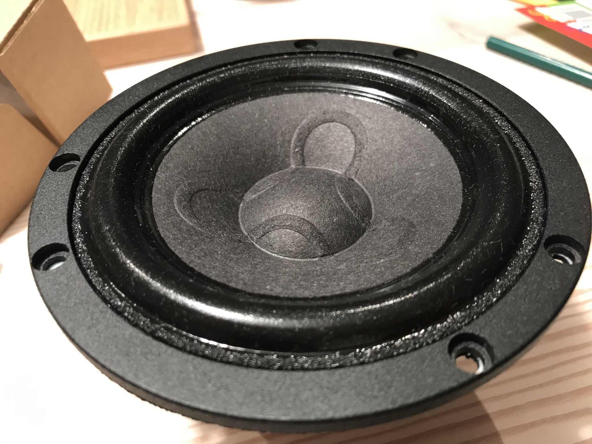

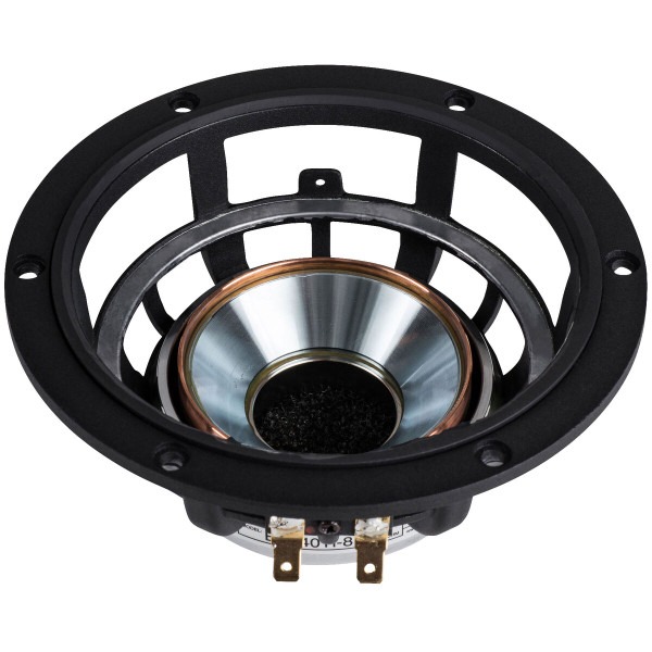

Borresen uses it aswell.
New Tectonic TEBB5430-8 has unusualy large Bl with very low inductance, it can be used as a exciter.
Scan speak illuminator 12mu has one of the best motors in the world.
Dayton audio ES140Ti has great motor.

Hi lenta,Tectonic in their dml panels uses exciters with copper winding on inside and outside of voice coil former. It is probably dificoult to manufacture, but gives several advantages, main are increased motor strenght(Bl) without increasing inductance.

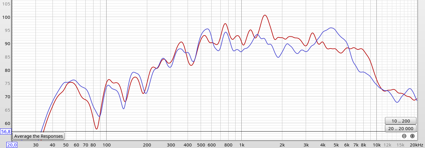

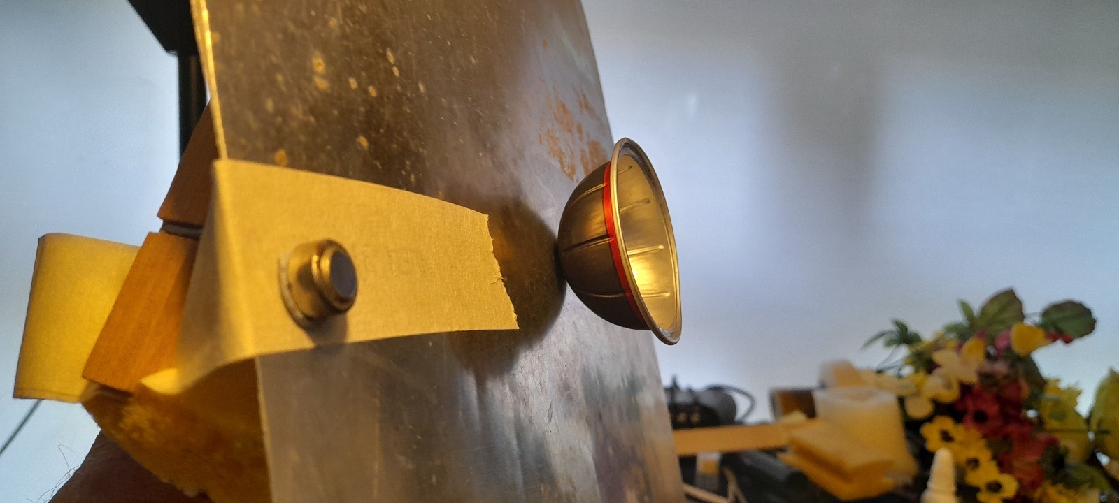

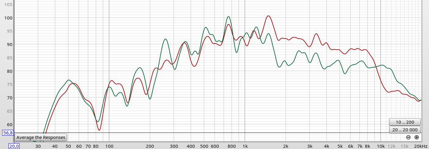

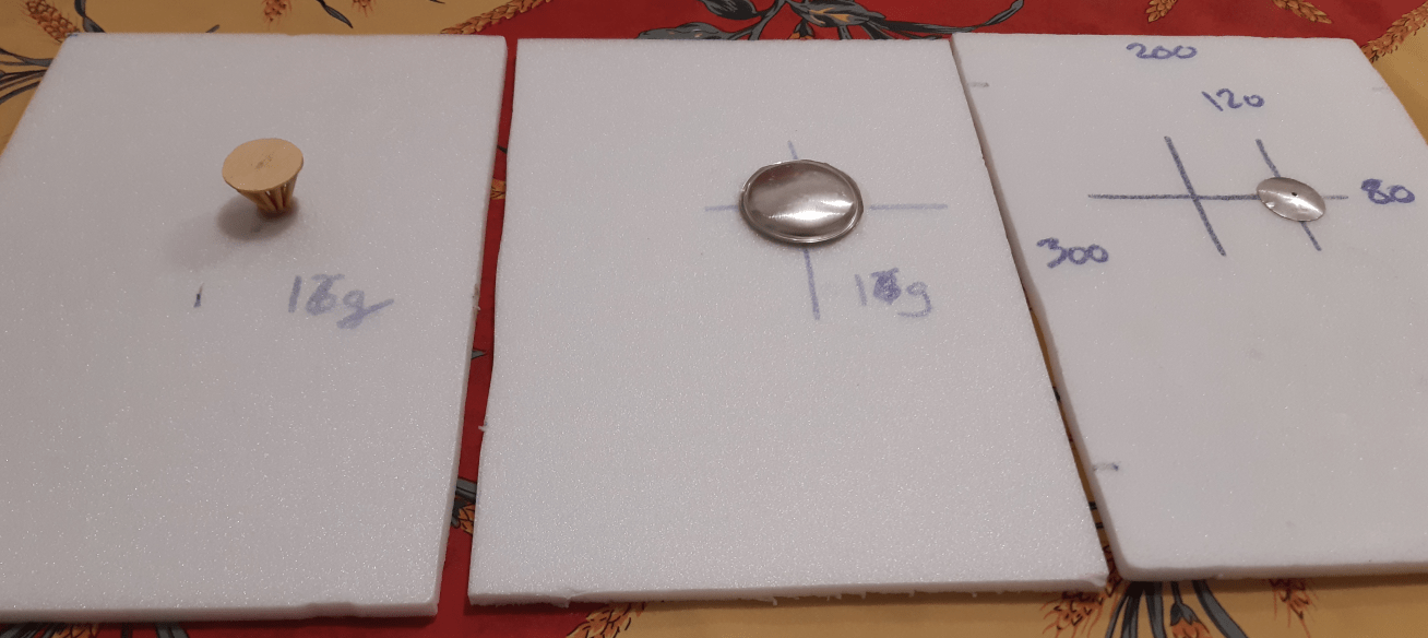

I had the possibility to make some tests this week. One of the target was to measure the effect of a coupling part. As you will see, it is not full conclusive on that point but interesting on another (at least to my point of view) and related to your list.
Here is a picture of the tested panels.
All the panels are 20x30cm XPS 9mm (depron)... I had a stock of this. In fact it is the second material I made panels which have never worked and I would like to understand why...
Left is a concentrator made of wood sticks, central is a bottom of soda can (44mm) to enlarge the contact diameter with the panel. Both are on the exciter side. Right is an Eucy's dome so in front of the panel.
View attachment 1104277 The results :

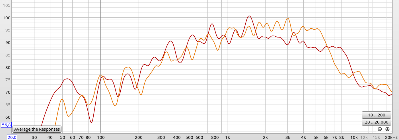

Red is panel without accessory, green the concentrator (left on the picture above)
Red, the panel without accessory, blue with the 44mm dome as coupler
Red, the panel without accessory, orange with an Eucy's dome
What I understand from this test is the sensitivity of light membrane to additional mass - in better words, low mechanical impedance material.
Higher mechanical impedance membrane allows more flexibility on the voice coil mass. Unfortunately this is also low efficiency material, like plywood.
The design solution for the exciter might be strongly linked to the membrane material.
Christian
Thanks for trying the dome
Seems like a significant boost in the 2k to 5k range?
But is that a hole I see in the centre or a black mark?

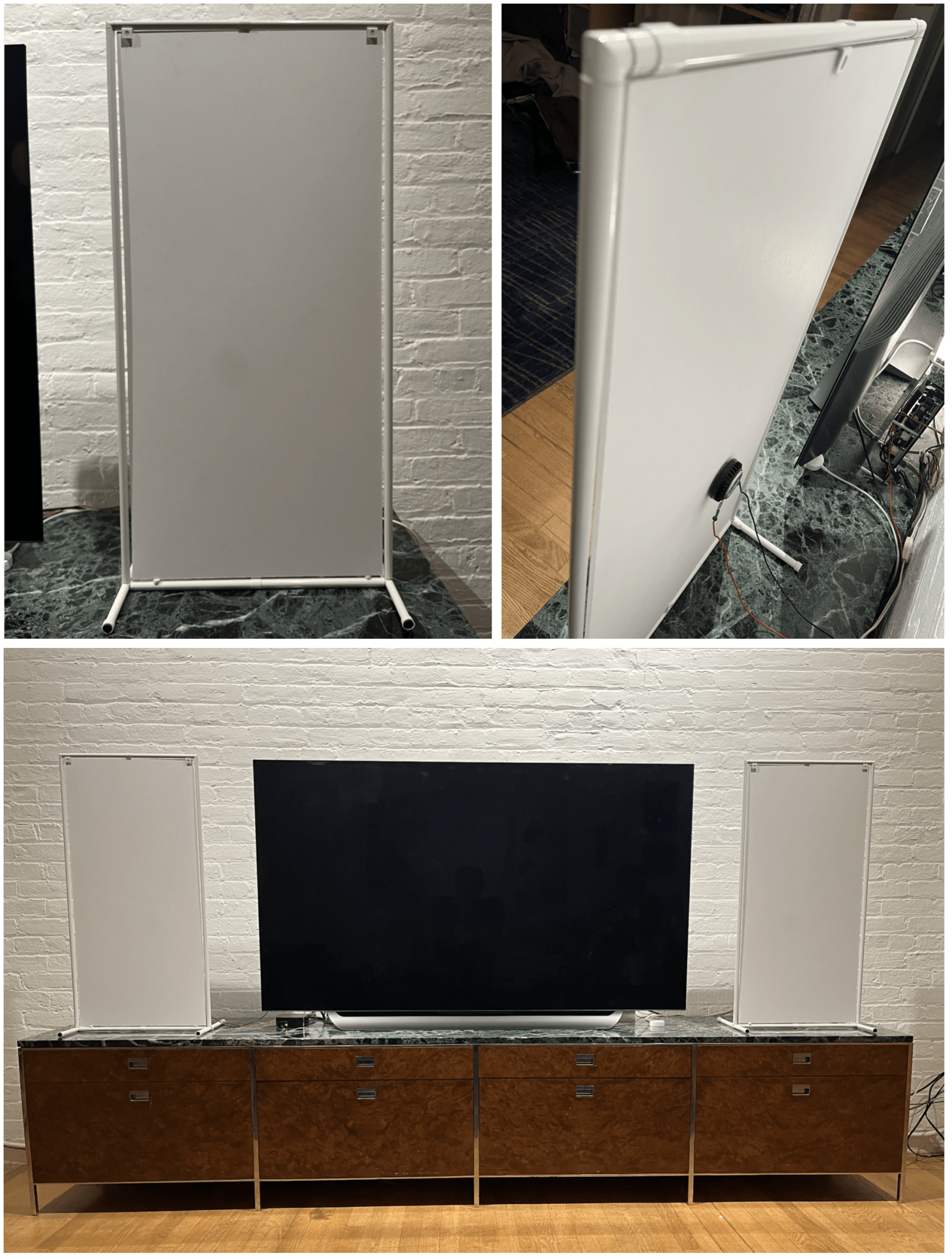

I had some things sitting around my workshop so I decided to put together another set of DMLs over the weekend to sit on either side of a TV.
See attached.
Dimensions
I just set the dimensions to fit with the TV rather than anything else.
The frames measure 16" w X 34 3/4" h
Frames
For the frames, I used bits of Abstracta modular framing system that I had from an earlier project.
Steel tubes (1/2" OD) and die-cast metal-alloy connectors.
You can cut the tubes to size with a small pipe cutter.
I considered filling the tubes with sand or spray foam. Probably overkill.
I suspend the DML panels within the frames; isolated on small felt pads.
Not very stable yet. I'll try and come up with something better. Suggestions appreciated.
I thought these frames could prove useful to easily try out other materials.
Panels
I used 3/8" Gatorboard for the panels and Thrusters as exciters (I had these sitting around too).
Amps
I hooked up an old pair of Hypex FA123s (only using one of the there channels from each amp) to drive the exciters.
Measurements to come...
No measurements yet, so no DSP tuning yet.
They could use some leveling up on the low end and will likely need some help elsewhere.
First listening session,
They have air and space. They have a convincing soundstage with width and depth and pretty precise placement of performers. Great imaging. They disappear sonically. Most importantly they engage one in the music.
They have all the volume capacity I'd ever need for this system.
More to come...
Eucy
It is a 2mm hole in the center. The way I made them is a bit different from yours. I made test on different samples of material I had : EPS, XPS, plywood, "homemade plywood".
In few words :
- Very easy to do. As I drilled also a 2mm hole in the panel and the exciter have also a 2mm hole, it was very easy to align them.
- For low density materials (EPS, XPS) there is the boost you mention but the FR stops a bit before then
- For the high density materails (plywood or similar)... The on axis FR was not changed in an obvious way like for the PS.
I have the intention to gather the pictures and the FR to share them. Sorry I put it in a second time compare to the influence of the additional mass those FR show.

Probably a daft question, but did you try to glue the dome upside-down to mimic a whizzer cone .
This might? Work better, especially on ply?
I just this second, stuck this coffee machine container to the front of my aluminium panel for demonstration purposes.
I did use it on other panels , it gave a much higher output, too much.
i might cut it down in size to reduce the output.
oh no, not another project 🤪
Steve.
