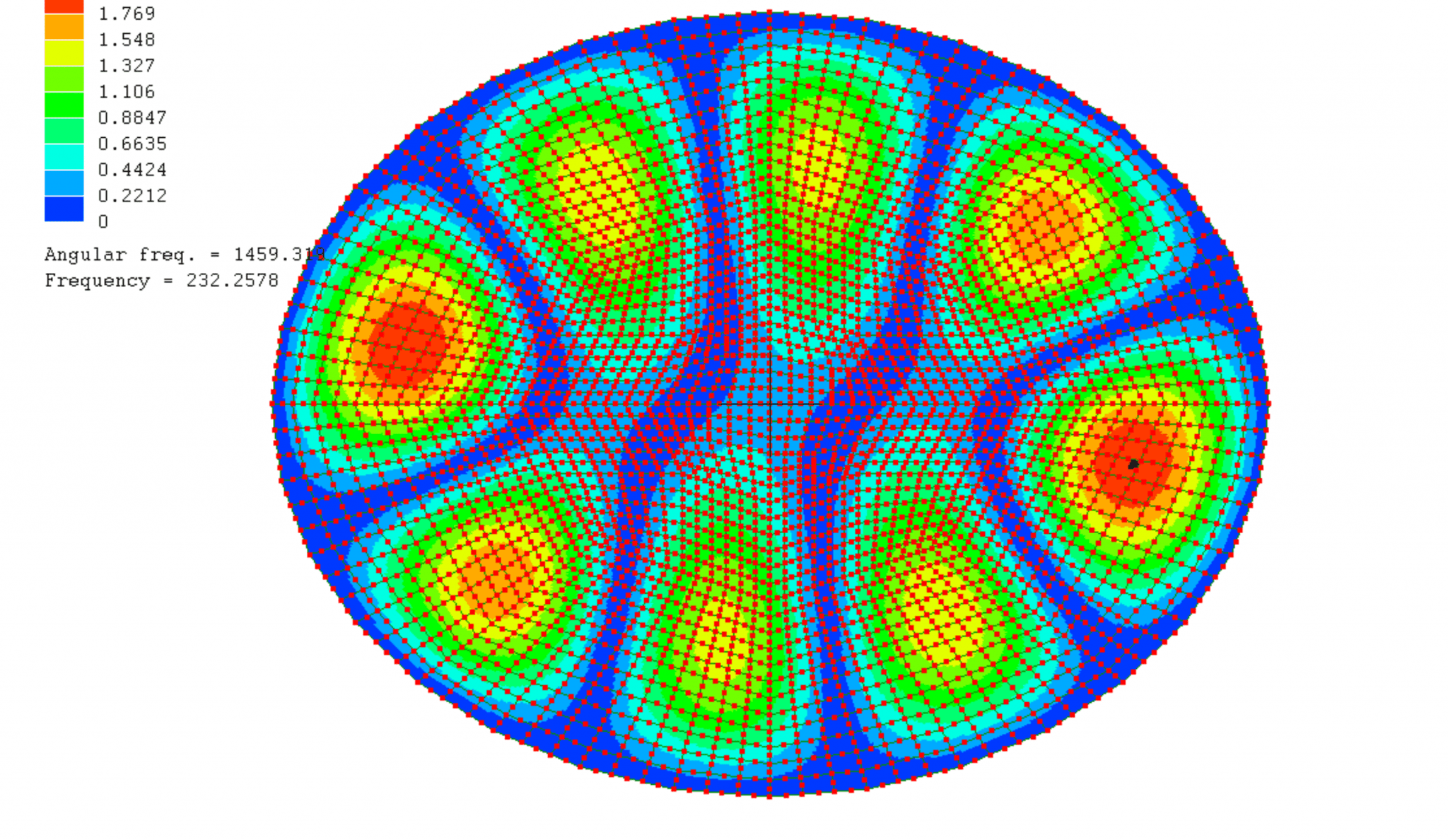

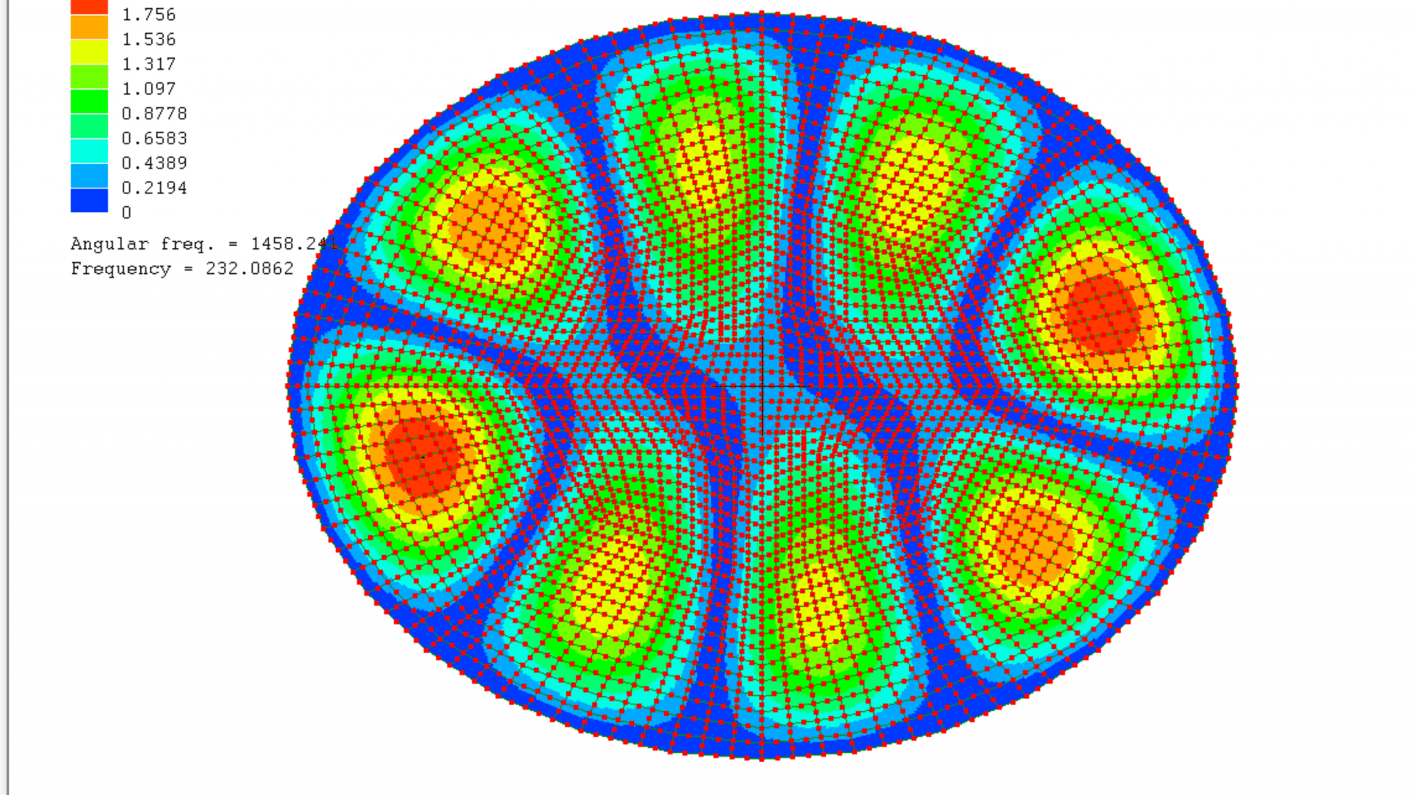

Okay, serious now: I never heard the concept of degenerate modes before but I think I have seen it in modelling, especially, with very symmetric dimensions.
Playing with ellipses the other day I got these two modes, at nearly the same frequency (of course).
I've seen similar things before with square or nearly square plates. I always assumed it was a modelling artifact. Is this what you are referring to?
Eric
View attachment 1108238 View attachment 1108239
Yes indeed that looks like a typical case. Degeneracy arises in situations of high symmetry where multiple mode shapes (or wave functions of quantum mechanics) can have the same energy, Introducing asymmetry removes the degeneracy. This is why you would never use a circle or square as a panel - the symmetry leads to very strong resonances at a few frequencies with big dips between. I wonder if there are degenerate modes arising from rectangular plates with integer multiple side lengths - that's the sort of thing we could test with fem.Paul,

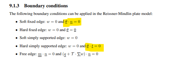

In the Elmer documentation, I found this description of the boundary conditions available. Do you know the physical meaning of the highlighted parameters? Do you know what the vectors n and t are referring to? I'm trying to figure out the difference between Hard and Soft Fixed, and between Hard and Soft Simple, but I'm not getting it. Have you figured that out?

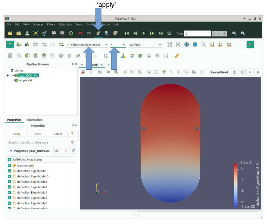

I made some tests. Thanks a lot for the files! See below the summary of the steps.
What is missing for me at the moment is how to see the geo file (if possible) and get the .msh file (I have problems with gmsh...)
From the .msh to the vtu it works "from the box", the 2D in paraview also. Some mystery remaining around the 3D view.
One question : about the axis in Paraview, is it a view from X to be used as the membrane is in the XY plan (see pic below)?
To be continued.
Here are the details is others want to test
My laptop is under Linux Manjaro (based on Arch)
Were installed from the repositories : Elmer (from AUR repo), Paraview
Then, the file stadium.zip from Paul was unzip in a directory stadiumdir
Content :
cantilever.geo cantilever.msh case.sif ELMERSOLVER_STARTINFO
In this directory, open a terminal then the command line :
* ElmerGrid 14 2 cantilever.msh -autoclean -out mesh
Rem : ElmerGrid not elmergrid (commands are case sensitive)
It generates the mesh in the Elmer format from the .msh file.
New content :
cantilever.geo cantilever.msh case.sif ELMERSOLVER_STARTINFO mesh
A mesh directory was created. Content :
entities.sif mesh.boundary mesh.elements mesh.header mesh.names mesh.nodes
Then the solver is launched (terminal in stadiumdir)
* ElmerSolver
New content :
cantilever.geo case.sif mesh simple.dat.names
cantilever.msh ELMERSOLVER_STARTINFO simple.dat
In mesh :
case_t0001.vtu mesh.boundary mesh.header mesh.nodes
entities.sif mesh.elements mesh.names
Then launch paraview and open case_t0001.vtu (in mesh directory).
H ChristianHello Paul,
To be continued.
Content :
New content :
* ElmerSolver
New content :
In mesh :

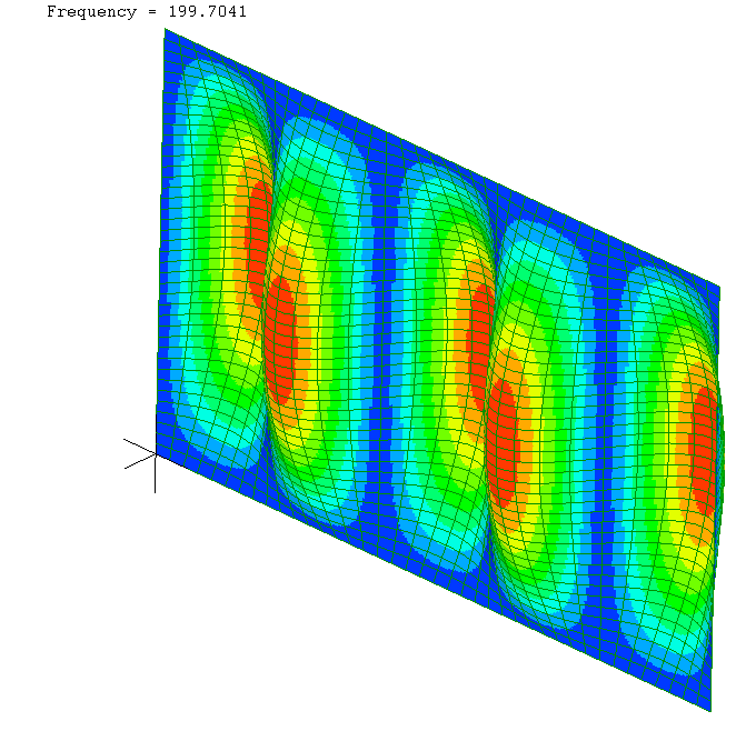

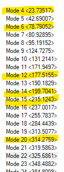

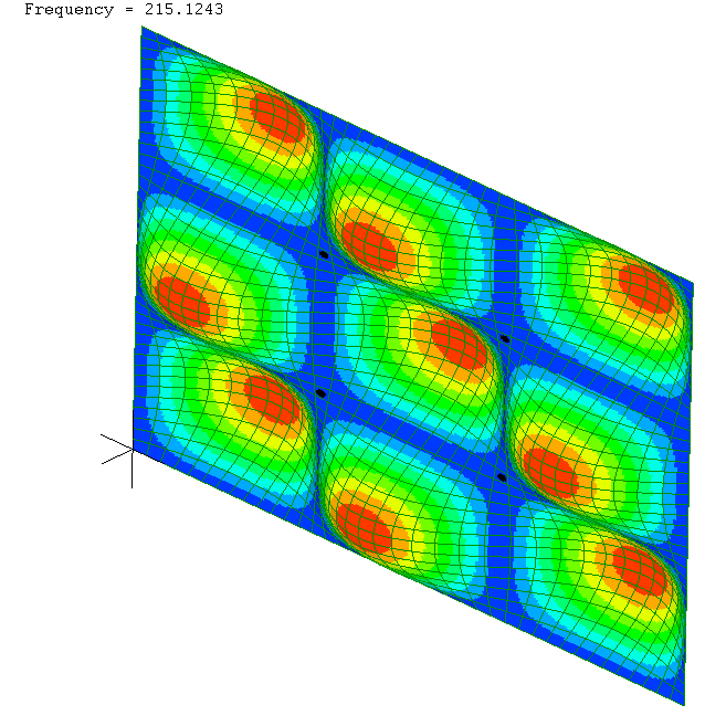

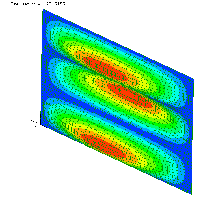

Not always, but in some simple situations, yes, I think the FEM gives a good idea of the FR response and where the peaks will be. For example, below is the FEM result for a hypothetical 4 mm thick plywood panel, 600 mm x 960 mm. The highlighted modes are the productive odd, odd modes as follows:
23 Hz, 1,1 Fundamental
78 Hz 1,3 Mode
177 Hz 3,1 Mode
199 Hz 5,1 Mode
215 Hz 3,3 Mode
314 Hz, 3,5 mode
I would expect the following: Possibly a small peak at the fundamental, but no significant output, as it's just too low. The first real SPL around 1,3 Mode at 78 Hz, then a big dip followed by a nasty spike or spikes around 200 Hz produced by the combination of the 3,1 and 5,1 and 3,3 modes peaking within a small band. Then another big dip until 300 Hz when the 3.5 kicks in.
Eric
Eric
Btw they confirmed that Y and Z results are the derivatives in X and Y direction.
I think there are some clues in the paper. https://iopscience.iop.org/article/10.1088/1757-899X/661/1/012002/pdf@pway
Paul,
Eric
The things I know of which might be controlled at a boundary include
- z position (allow/disallow motion perpendicular to plate at the edge)
- x and y position (allow/disallow motion in-plane. There is something called a 'sliding support').
- Allow/disallow rotation about an edge (or I think equivalently, whether or not the edge is allowed to support a moment about an axis along the edge)
- Allow/disallow shear stress, mentioned in the above paper
- Also the first and second derivative of displacement at the edge. I assumed allowing a first deriv was equivalent to allowing rotation, but Im probably wrong.
