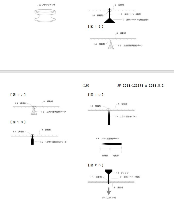

Here is the beginning of a track : inventor Toru Maruyama, JP2015136076A, JP2016063283A, JP2018125823A, JP2018121178A. No clue about the membrane for now.
Some translation by google patent
Thanks for the links. They give links to download pdfs in Japanese. The last link, JP2018121178A downloaded Japanese pdf gives some drawings to ponder about from page 7 onwards. JP2018121178A pdf. You've to read them side by side. I think the diaphragm can be anything. People here had been testing all kinds of material to get the best out of the transducer. Most probably, what we'd have to do is to cut out the legs of the Dayton "frog", or similar and stick a pencil or a nail in the middle of the transducer to check the point transfer of vibration (music) to the flat panel. There's a lot of ideas in the first few pages of this thread, by the way.
As the material of the diaphragm (8), wood, paper, foamed polyethylene, plastic plate, polystyrene plate, various buffer plates, thin metal plate, and the like can be selected.
If the area to be fixed is large, a portion that does not cause any vibration due to the area is present at the center of the diaphragm (8), which interferes with the vibration of the entire diaphragm (8). The speaker of the present application has the smallest possible area.
A point has no area in mathematical terms. However, when the dots are actually displayed, the area written for the thickness written with a pencil is the same as the area is present, and even with the point fixing of the present invention, there is an area of an adhesive part necessary to realize this. To do.

Looking at Toru Maruyama's vibration speaker patent, he too uses the now standard pistonic motion from a moving coil, only difference being that his moving coil (voice coil) moves a spike with a point, most probably a ball, at a fixed diaphragm - a flat panel, which is fixed at its edges. As he says in his patent,
same as we try to experiment with the very same materials. Only, he might be using a concave panel, more like the speaker cone.

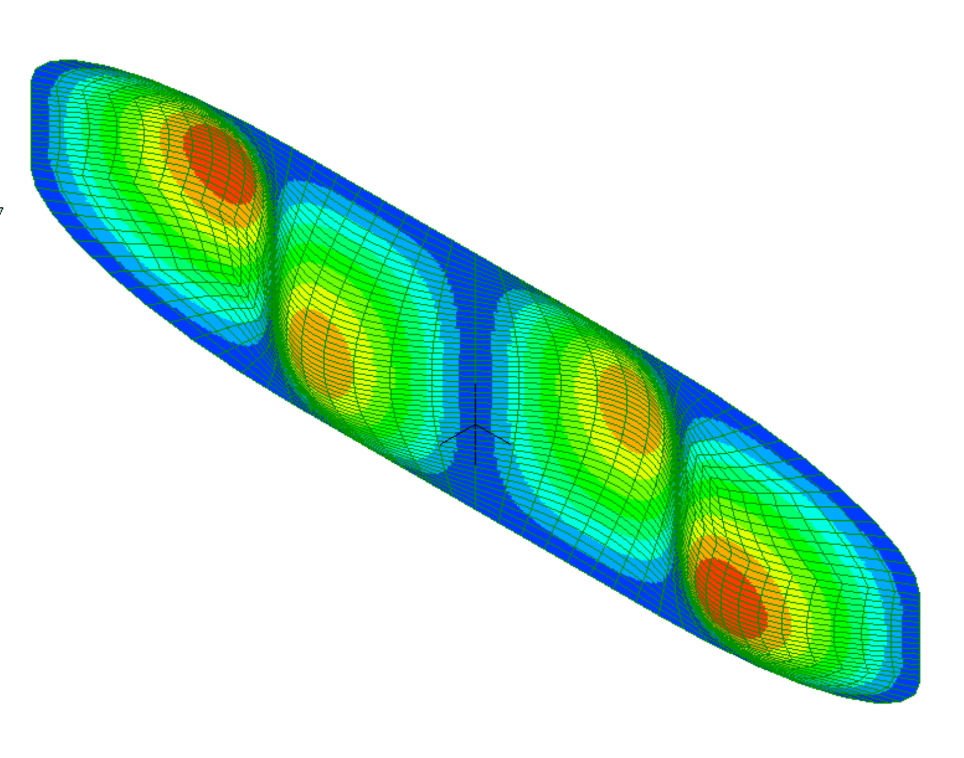

With your FEM simulations The modal patterns is of a particular sine wave excitation can you input other excitation waveforms?
What is the excitation power used to calculate the mode?
Are the modes the same amplitude across the surface?
How fast can the modes change on the surface?
Again many thanks in advance for your responses.

There are certainly various levels of sophistication in FEM models. Mine is probably among the most simple for this type of problem.
What it does is calculate the mode shapes and associated frequencies for free (unforced) vibrations for a plate with defined elastic properties, dimensions, and boundary conditions. So the model doesn't actually use a particular type of excitation (sine or other) or power of excitation.
I'm not exactly sure I know what you mean about the amplitudes, but I'll try to answer anyway. Here is one mode for a particular plate: The amplitude varies across the plate from zero (in the blue areas which are so called nodal lines) to a maximum at the center of the four red or orange circles (antinodes). Often the displacement amplitudes of each of the antinodes is similar, but it need not be so. In this particular case, the antinodes at the ends of the plate exhibit greater amplitude than the two closer to the center.
My model is doesn't tell me anything about how quickly modes can change.
Hope that helps.

This is my understanding of the physics and our reasons for spending way too long on a computer:
The modal analysis gives you a set of mode shapes, and the set of frequencies at which each mode shape occurs. The mode shapes depend upon the shape of the panel, and how it is supported (its boundary conditions). They are all of the ways that the panel can vibrate "of its own accord", in the absence of damping, or any applied force.
A sinusoidal excitation (force) applied to the panel at one of these modal frequencies will give you a peak in the dynamic response, which corresponds to the resonant peaks observed in a measured spectrum using REW, or in a tap-test (essentially the impulse response).
The mode shapes just give the shape - the relative displacement at any point in relation to the displacement at other points on the object. I don't believe the displacement is in relation to anything absolute, and I don't think the relative displacements of different mode shapes can necessarily be directly compared at this stage.
The mode shapes are orthogonal in the sense that any particular shape that the panel can assume can be constructed from a sum of the mode shapes (in a continuous system, the sum is in general infinite). An arbitrary signal can be broken down into a sum of sinusoidal signals (Fourier). So if your signal consists of some sum of the resonant frequencies of the panel, it will excite each mode in proportion to the amount present.
For a sinusoidal excitations of arbitrary frequency (ie not one of the modal frequencies), and of an arbitrary location on the panel, the software can approximate the panel response by looking at modes in the viscinity of the excitation frequency, and estimating how strongly each mode would be excited, to give a estimate of the overall panel response. Exactly how it apportions the energy, I'm not sure, but for example the closer the mode to the excitation frequency, the more energy in receives, and the closer the excitation point to an antinode of an nearby mode, the more energy it receives. I know that in some situations - like how a panel responds to ambient sound - an assumption of equipartion of energy is made - ie all modes receive equal energy.
Some FEM software can proceed "from scratch" - that is, given properties of the panel, BCs and damping, can calculate the dynamic response or transient response. I don't know if Elmer can do this, but I assume that the simple elastic plate (2D) model I have been using just uses the modal analysis to give an estimate of the forced response. I would expect that an analysis 'from scratch' would take a long time to compute. In any case, I've not gotten that far yet.
So we proceed by baby steps. Currently we have a modal analysis, which tells us how modal frequencies are distributed. That is useful info already, particularly for low frequencies, which are the weakest aspect of panels. Eric has used it to get more accurate estimates of material properties.
Beyond that, we want to get an idea of the forced response, as described above - an actual estimate of how the panel behaves across the frequency spectrum, and how strongly each mode is excited in relation to others to a point-force excitation.
But that still doesn't give us an estimate of the actual frequency response of a panel, in terms of the sound pressure in air. How does the movement of the panel - the lumps and bumps of any given forced response of the panel - translate to what you hear? Some modes are 'non-productive' - they cancel in the near field - because they have antinodes of opposite phase too close together in relation to the wavelength of that frequency in air. Baffles make a big difference too because they help to reduce out of phase cancellation around the sides of the panel. And of course, the proximity of the floor, walls, and the entire room response affect the sound too, but that is normally dealt with separately.
So that's our 'holy grail' - to have tools that can give us a estimate of a panel's actual response without having to build it. So we can optimise the design by doing quick changes and seeing the difference. Even if only approximate, it will be very useful to see "better" or "worse" for design modifications or new ideas.
If you want to better understand some of the theory behind this, there are an excellent set of lectures in dynamics from MIT at https://www.youtube.com/playlist?list=PLUl4u3cNGP62esZEwffjMAsEMW_YArxYC
See in particular lectures 19 and later about modal analysis, vibration.
Eric may be able to add to or correct my understanding.
