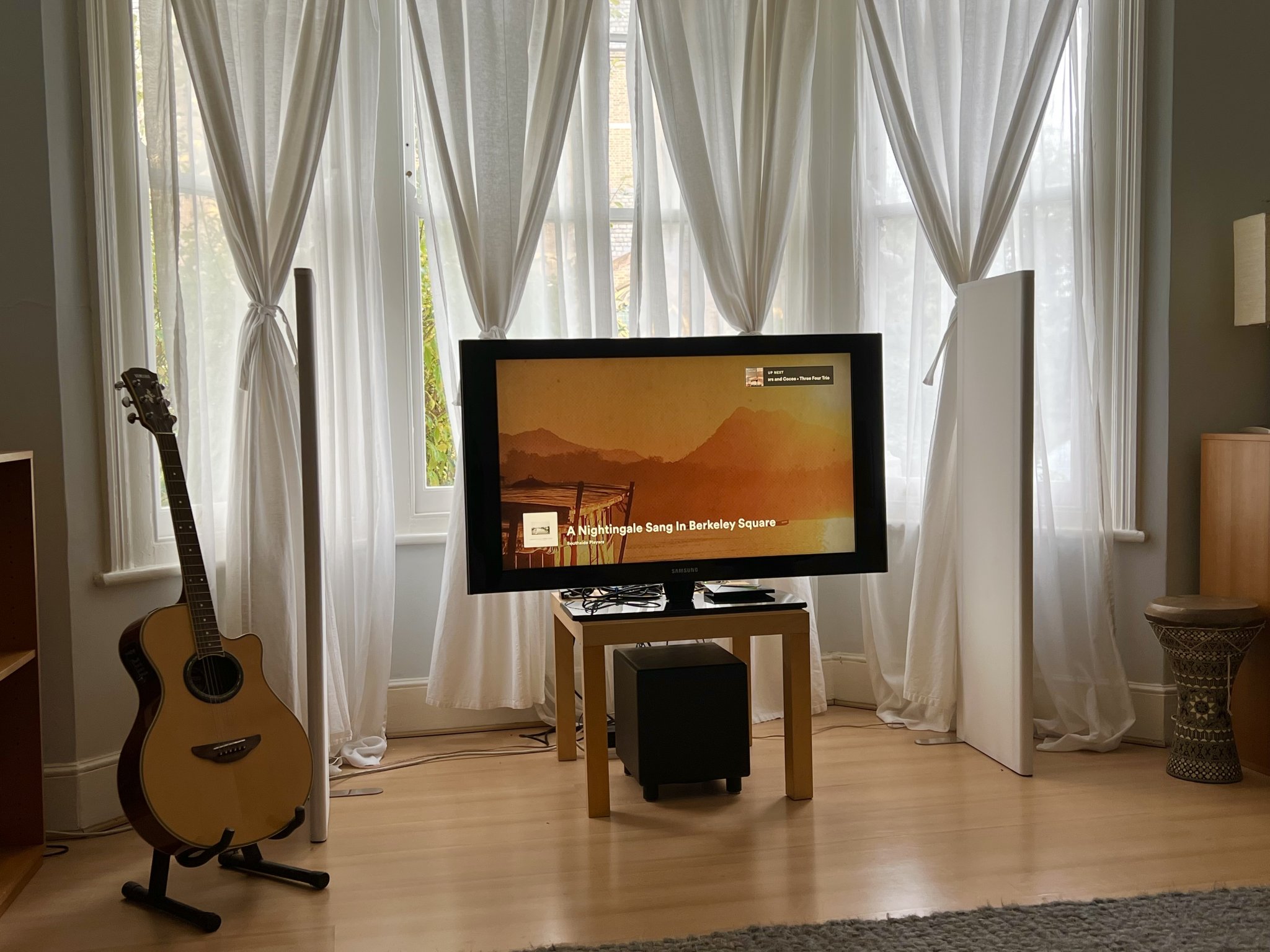

The other day when I was playing around with some panels, I started turning them around in different directions.
I thought if I had a TV near a wall it might be handy to toe the panels outwards instead of inwards, so that the panel could touch the wall on one side and be level withe the TV on the other.
It was a little awkward in my room what with all the rubbish in it at the moment.
But it worked quite well, widening the image a little because of the closeness of the side walls.
I just remembered that at the podium 1 launch, they actually picked up the panels and turned them around while playing music.
With very little difference in sound and imaging.

Steve regarding the Podium demonstration I did the same with the Blondes several times with the same result. I also lived with the Blondes edge on for a while before committing to the White design. I have never detected much effect from them being in a bay but there are a lot of drapes which probably helps.Burntcoil.

My Bay is a round bay ,so was probably giving a sort of dish effect messing up the image.
Move one speaker out of place and everything went haywire ,image wise.
Steve.

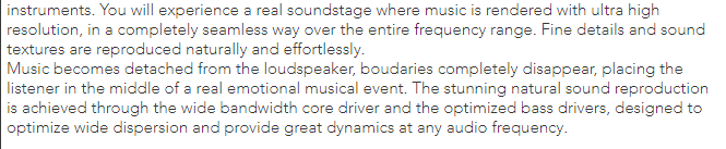

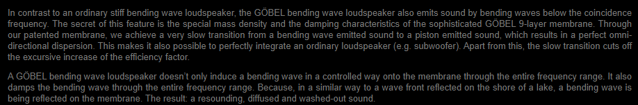

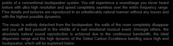

When I was looking on the web for how the term "bending wave" speaker is used, I came across this speaker, which I had never seen before:
https://www.ondacustica.com/carla-reference-nirvana
Two interesting points:
1. First they actually appear to use a round panel! I can't be absolutely sure it's round, but it sure looks like it is. It also appears to be carbon fiber, or (more probably) carbon fiber skins over some lightweight core.
2. Interestingly, their sales literature is is almost identical, like nearly word-for word identical to the Goebel literature, see the snips from the Onacustica website (white background) and Goebel website (black background) below for comparison.
I feel pretty sure that they must be licensing the Goebel patent (assuming it's still in force). Otherwise it's pretty blatant plagiarism!
As pway said, be wary of marketing terms or claims!
Compare for example:
Ondacustica:
Goebel:
Ondacustica:
Goebel:
Ondacustica:
Goebel:

Thanks, I linked to the other page because it had a picture of the round speaker. But all the quotes I posted came from the page in your link.
Did anything in particular catch your attention?
Eric
