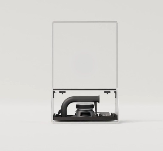

Here's an interesting concept of hybrid speaker, the winner of the James Dyson Award some years ago. How it works is interesting.
How about placing a transducer on the bottom of a 2mm glass panel, on the thinner side to check their claim? That the sound can be sent from the thinner side of the panel, glass or otherwise.

Here's an interesting concept of hybrid speaker, the winner of the James Dyson Award some years ago. How it works is interesting. View attachment 1111332
Instead of the two exciters, why not attach two tweeters just touching the glass panel? The rest is quite an interesting triangular down-firing subwoofer, with back sound moving out of the slight groove between the glass panels. There's a video in the James Dyson web page, which should be watched with multiple stoppages (to catch the idea).

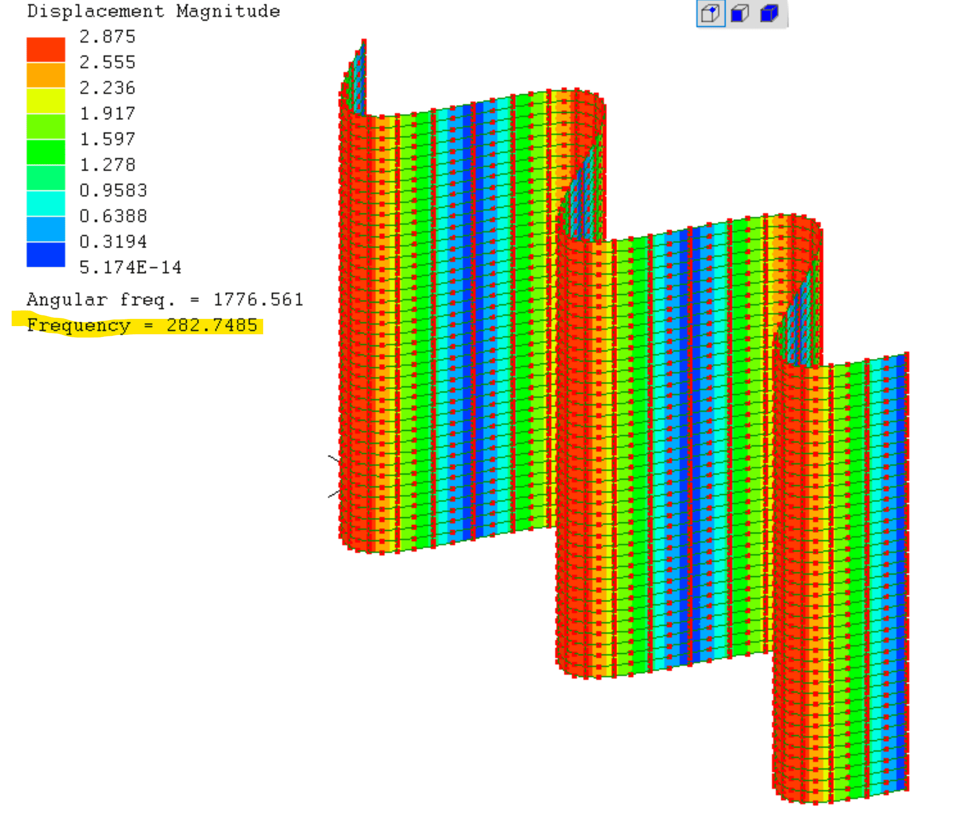

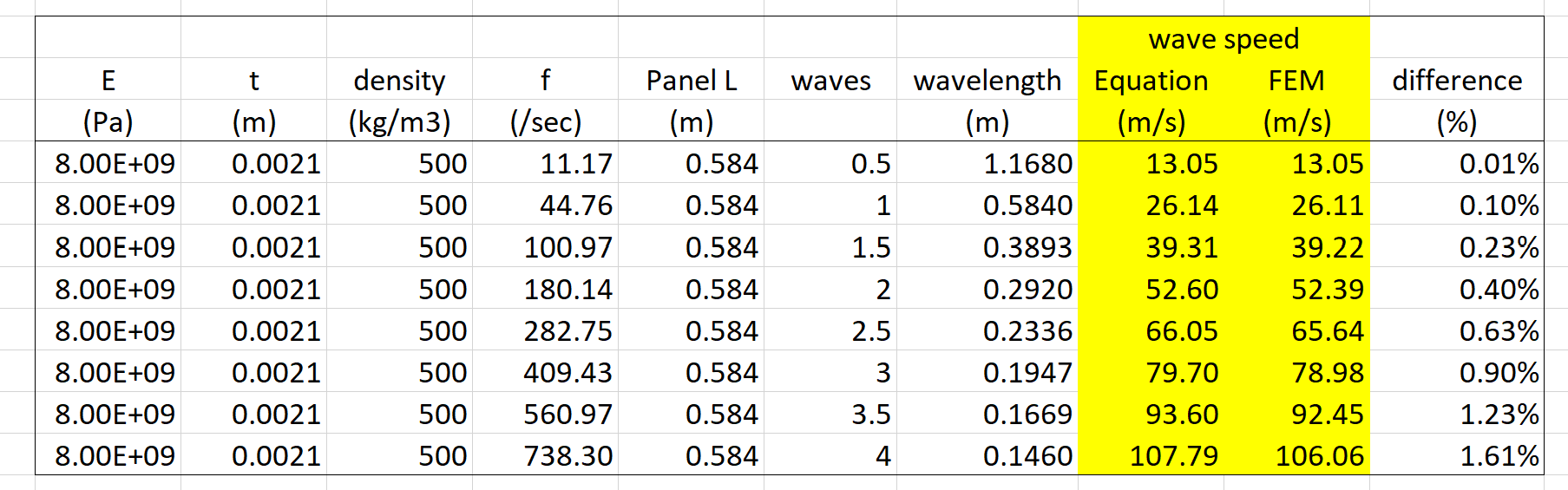

Hello Eric, hello Paul
.... Have you already think how to get some indication of that from the FEM simulations? Getting the SPL in far field might be a too big steps. Do we have intermediate possibility thanks too the options of FEM tools like getting some information of speed of the panel? Or in other words, what about the amplitude or speed aspect of the modes? The mode density is also possible candidate but i don't see for now the relation.
Christian
Christian,
Concerning your question in bold about the speed of the panel and FEM tools, I found the following results to be satisfying, though perhaps not exactly the answer to your question.
I used the LISA FEM to model a plate that is simply supported on two ends, and free on the other two sides, so it is effectively a simply supported beam. As such, many of the resonances have mode shapes like sine waves consisting of half integer multiples of wave lengths. For example, the mode below, with a frequency of 282.7 Hz, consists of 2.5 wavelengths.
For each of the resonances of this type, I calculated the wave speed two different ways:
First using the equations below for the wave speed of a plate (below), and second using wave speed = wavelength x frequency using the wavelengths inferred from the FEM model. The results are the highlighted columns in the table below.
It shouldn't be surprising that the results are in good agreement, but I do find it comforting, and some confirmation that the model is pretty good.
Eric

I see that they intend to bring out a better version of the hybrid speaker that does mot need a sub To go with it ?
I'm not sure that I would like the sound of this panel ,maybe the new version will be different.
I will keep an eye out because it is interesting.
So many ways to use this technology.
