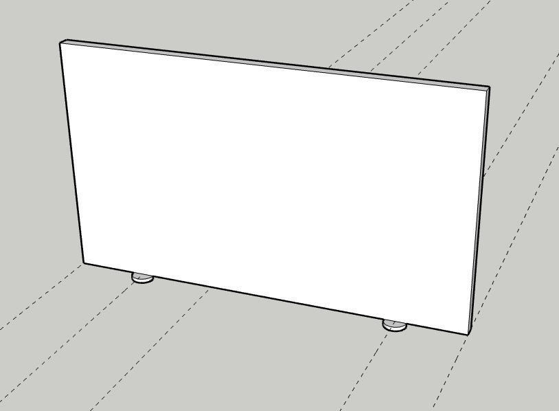

70cm x 40 cm x 2cm EPS sheet with 2 transducers placed at 12cm from edge facing up at the thinner (2cm) edge. Sound comes from front, back and in plane and gives stereo effect any place around it.

Yes, one exciter plays the left channel, the other the right. The exciters were placed on a glass table, but isolated from it with cloth and soft pads. The exciters have an aluminium cover around the magnet. These were bought a long time ago, just sitting in a drawer. They work without the plate too, just by touching the screwed-in spider.Does this play left channel to one exciter and right to the other?

I was sitting behind the sheet holding it tightly against the exciters. The she did the same thing and I walked around. It was hard to say which exciter gave which sound. The room was filled with sort of 3-d sound. My wife could place which instrument was playing and where the player was situated in front of her, while standing walking about 1.5 m in front of the sheet.
The idea is the fix the exciters onto a frame, and the sheet to the frame, and then hang it on the wall to see how it sounds, but that has to wait till late spring. It's too cold and windy to work outside. If you guys have a place to tinker and why not try this out?

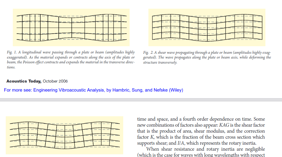

What I can bring in the topic is among the reading I had this one : STRUCTURAL ACOUSTICS TUTORIAL—PART 1: VIBRATIONS IN STRUCTURES by Stephen Hambric shows different modes of progations in a plate (see extract below). DML with exciter on the rear is based on the bending waves (fig 3). Your experiment looks like being in longitudinal waves (fig 1). Don't ask me more...
If true, a big difference would be (according to the drawing) front and rear waves are in phase in your experiment where they are out of phase in bending waves.

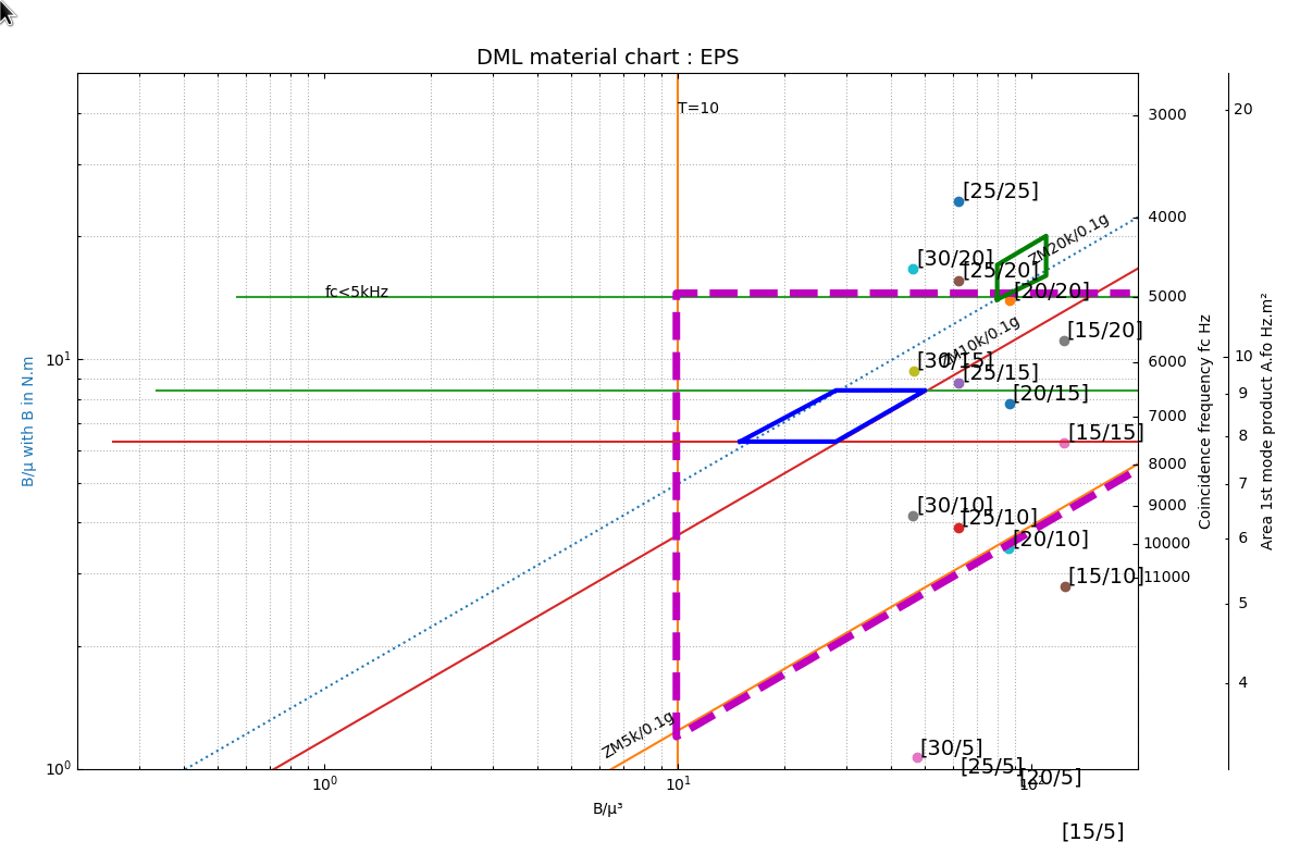

Here is a tentative of placing EPS in the material graph.
It is based on the following assumption :
From that, the candidates might be :
At this step, I think the chart is a good tool helping to see where is a material according to different criteria and targets.
The next steps might be to choose the EPS according to it, measure the density and the Young Modulus (tap test), place it in the chart, adjust the thickness for the compromise coincidence frequency / bandwidth.
Christian
Christian

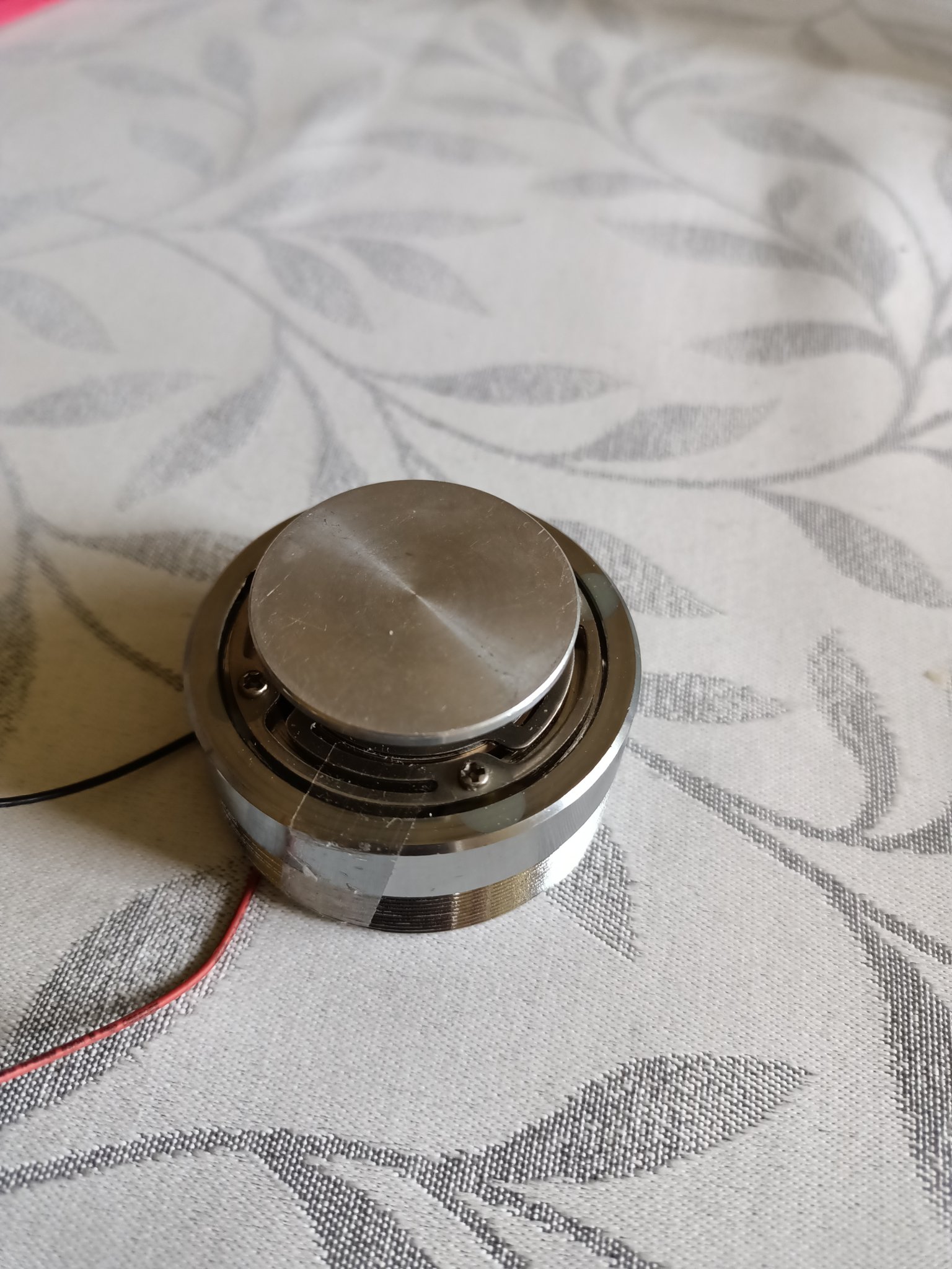

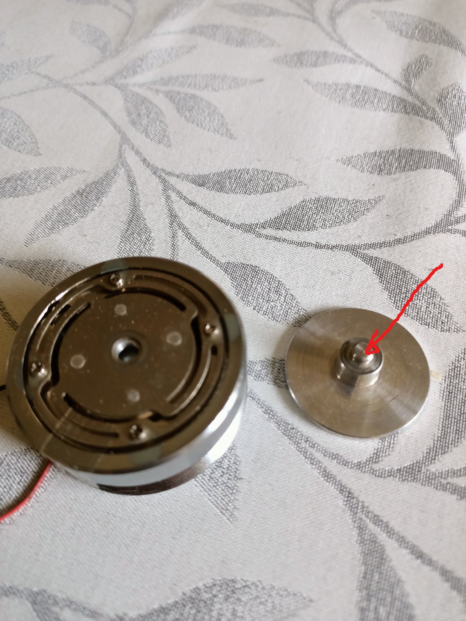

That edge-on excitation reported by chdsl is an interesting development. Foam is unusual stuff, relatively easily compressible but with Poisson ~0.3 for small stresses. Could it be that longitudinal waves have been observed, and the higher speed is giving better efficiency? I would not have expected much output though from longitudinal waves.

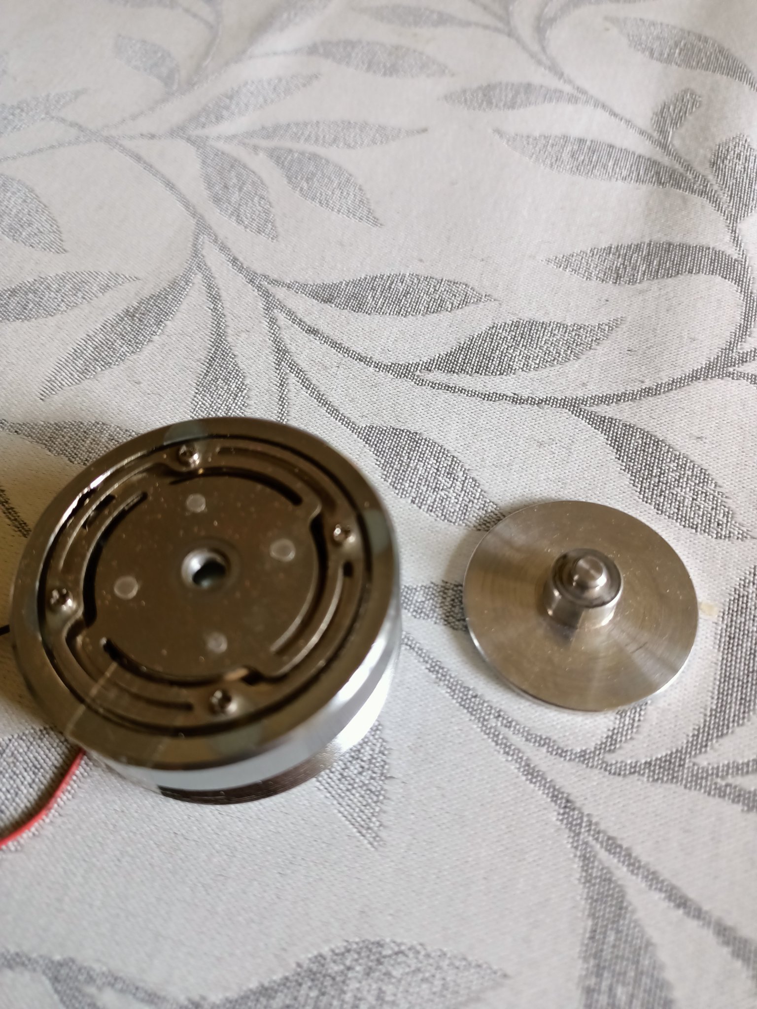

I think those who created the exciter for the flat panel, did so that the voice coil be flat as possible, its diameter is much wider than the voice coil of a normal cone speaker. The area touched by this kind of an exciter is bigger than, say of a dismantled cone speaker.
When touching the thinner edge of the sheet, the exciter I used actually transferred the vibration to the small plate through a small screw, then to a bit wider head, then to the plate. The screw diameter is 4mm, the head, 8mm and the plate 32mm, the plate itself being a small speaker. Even the fixed by tiny screws 'frog legs' acted as tiny sound speaker. The thing is the 4mm screw is the main element of transferring the voice coil vibrations to anything outside it. It didn't really change the sound coming from the 20mm thin EPS sheet edge, whether I kept it tight on the middle of the 32mm plate, or its edge.
Here's an idea to check on; if you have another type of an exciter, just paste a screw, thinnest possible, head down on the middle of the exciter, push the other end into the thin edge of the EPS sheet, or any sheet you have, check the sound it gives. The exciter must be fixed to some surface, or held unmoving by its own weight, and the sheet must be held tightly, or fixed to a frame. I won't be able to do these experiments until the weekend, maybe some of you can.
Paul, I think you are correct not to expect much output from longitudinal waves.That edge-on excitation reported by chdsl is an interesting development. Foam is unusual stuff, relatively easily compressible but with Poisson ~0.3 for small stresses. Could it be that longitudinal waves have been observed, and the higher speed is giving better efficiency? I would not have expected much output though from longitudinal waves.
The lateral deflection from compression/tension in longitudinal wave scales as 1/E, while lateral deflections from bending waves scale as (L/t)^3/E, where L is the plate length or width, and t is the plate thickness. So as soon as the plate length or width is 10 times its thickness, bending wave deflections will be on the order of 1000 times greater than deflections due to longitudinal waves.
So even if the exciter is oriented on the edge like Chdsl has done, there will be some component of the force that will end up being perpendicular to the plane of the panel, and which results in flexural waves.
The Hambric link Christian shared notes that most radiated sound from plates etc comes from flexural waves. It's entertaining to think that we have found an exception, but I find it highly unlikely.
Eric

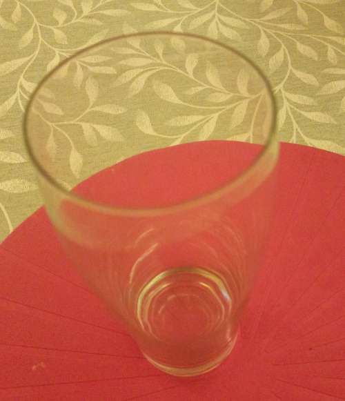

I can use an ordinary drinking glass to experiment with, just holding the exciter flat on the edge, even two of them. By the way, you guys can too.Hello chdsl,
