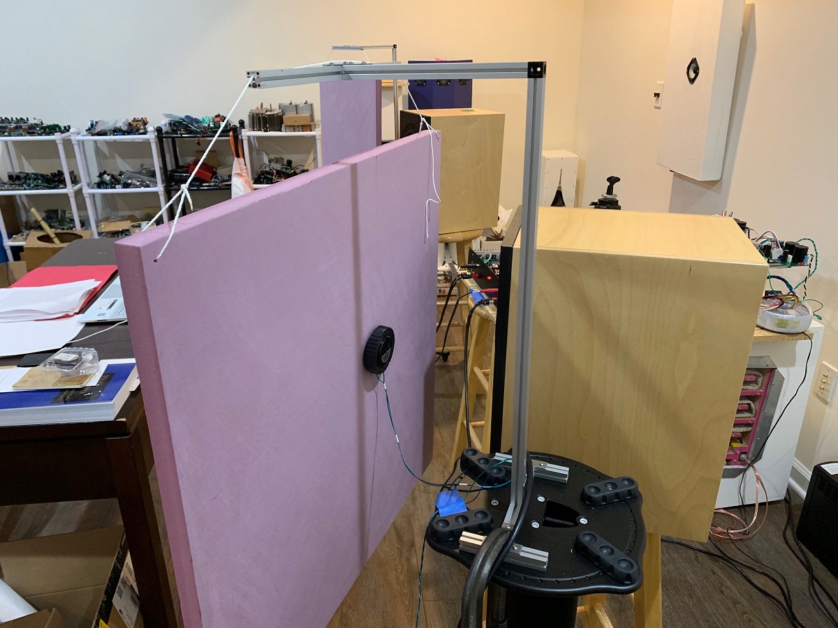

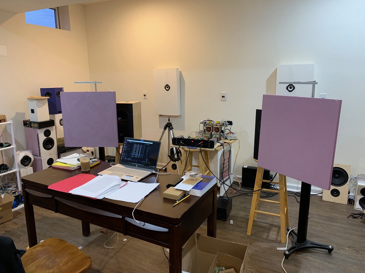

First thing I tried today was to make some MakerBeam cantilever stands to elevate the panels to ear height. That made a huge difference in sound stage. Very wide and spacious now - kind of nice "you are there" feeling. I might round the corners next - they definitely feel like the vibration aplitude at the corners is the highest and so rounding them might force more of the energy back to the center of the panel where it will do more good.
Shot of the lab with both DML's visible - height is about same as my reference 10F/RS225 speakers now. Cable moved off the panel and onto the stand:
Here is detail of the MakerBeam stands:
DML placement is similar to conventional cone speakers where they should be around ear level. Even toe ins can make a difference.

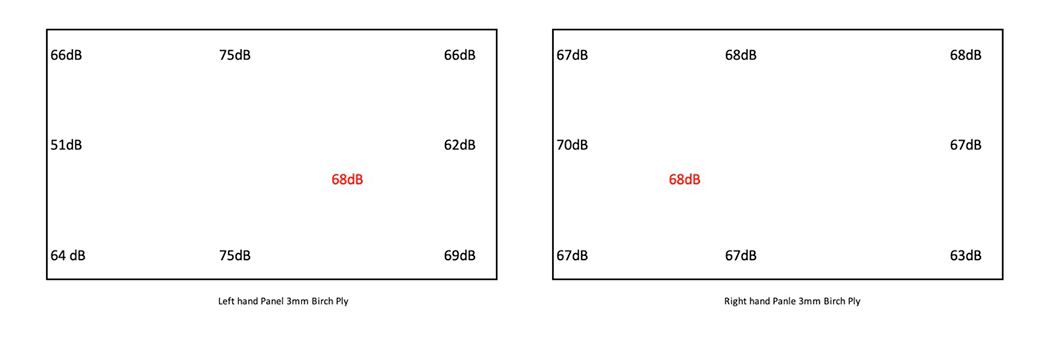

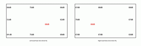

Just for the hell of it I measured my panels using an iPad App. I used a 1khz tone and held the iPad a consistent 50mm or 2inches from the panel surface. As you can see from the diagram attached I took measurements at the corners, edge midpoints and exciter centres. The panels are handed.
Thats interesting how the left panel has that spl dip on the middle/left side. I wonder if maybe there is some slight deviation in panel thickness/density at that area or maybe it got slightly less sanding or pva treatment?
Yes I suspect some anomaly shifting the modes around. The panels are untreated beech ply and there are 'filler' sections on the top ply. These are used when knots in the wood drop out during manufacture. They may be having an effect as well. Plus we don't know how consistent the gluing is between plys. Then there is the natural variability of wood density as its a natural material. Also, I was measuring by hand so I am also a variable although I tried to be as accurate as I could. : )
The peaking of output in the corners probably means I need to use a larger corner radius as energy does tend to get trapped in the corners due to edge reflection compounding locally.
