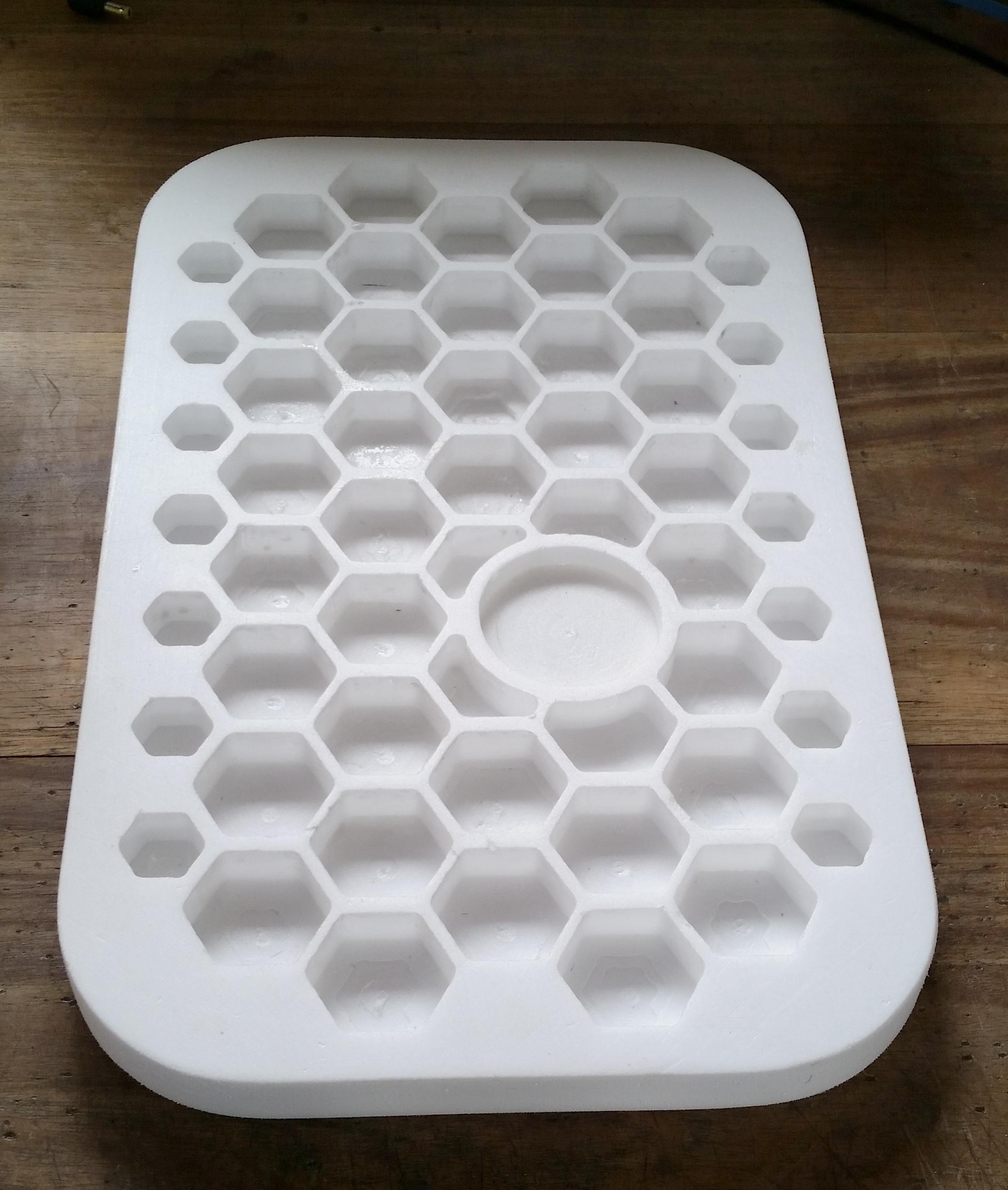

JMatt,
That’s beautiful work! Is that CNC or some other process?
The ribs remind me sort of ribs on a wood panel. I wonder if adding ribs to the thin ply used for model airplanes and art craft jigsaw puzzles could work.

Jmatt,
Very cool (both panels). But can you explain what you hope to achieve? Solid XPS is already the most efficient panel I've heard. Are you trying to make it even more efficient? Do you have another specific goal(s)? Or are you just seeing what happens? (I'm asking just to better understand what you have in mind, not to "challenge" your idea in any way!).
If you want to really maximize stiffness/weight (maybe you do, maybe you don't), you could make (mirror images) of your ribbed panels and glue them together back to back.

Thanks Veleric, I'm just experimenting a bit with what I have available. Originally I wanted to try a XPS honeycomb with wood veneer on both sides but it's just too difficult to source here.

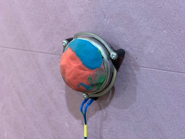

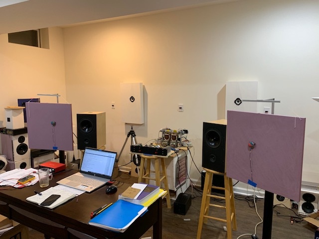

I flipped my panels around so that the exciters are front facing. I added some plastic modeling clay to the magnet to give it more mass in hopes of giving it more bass authority. The highs sound clearer now. Playing Bruce Springsteen 'Blood Brothers' - sounds fantastic. Then Ahmad Jamal's 'Ahmad's Blues' - very nice drums and pianos, and could hear ambience in night club very clearly (superb recording from 1955?), then next up was Lana DelRey's Summertime Sadness (Asadinho mix) - can actually hear some bass dance drums. What surprised me most is how well it played Metallica's 'Enter Sandman". Metal guitar and drums is usually hard to get right - not perfect, but very enjoyable. Patricia Barber's 'Manha de Carnaval' was refreshingly very lifelike - like you are there. Steely Dan's 'Hey Nineteen' sounded a bit too bright and forward. Buddy Guy's 'Five Long Years' was very good - nice visceral feel of his pain when he cries "You've got to know what I am talking about." These speakers really have some highs avaialble and great mid range. I measured about 3.5 vrms and that was about as loud as I could play it comfortably, about 85dB at listening position with my sound meter.

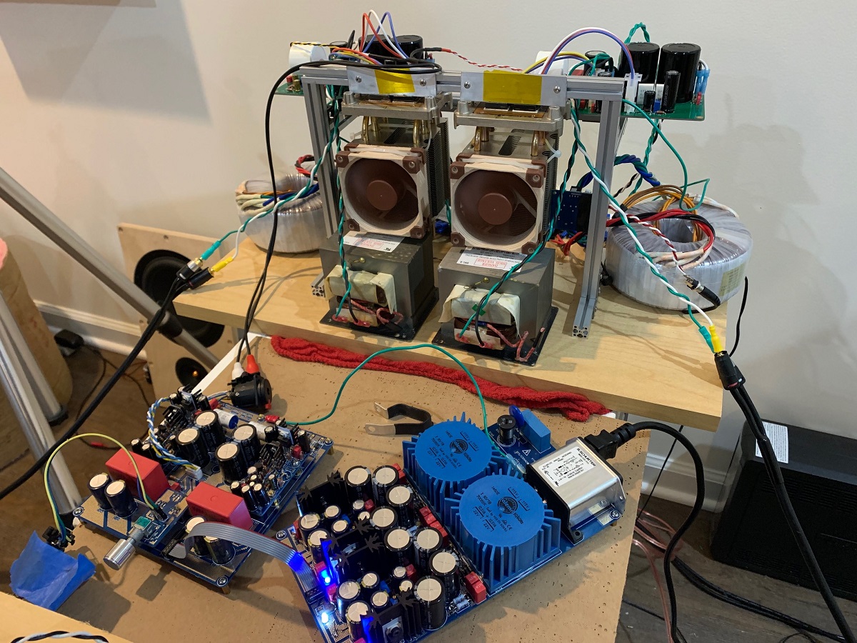

I almost forgot to mention, I am powering them with my very best reference amp and that seems to make a very nice difference. Source are FLAC or WAV files from Jriver on PC through Focusrite 2i4 DAC feeding a Yarra/Melbourne preamp, which drives a 50w SE Class A amp with microwave transformer 67mH 0.5DCR choke reactive load and SLB power supply with 37Vdc and 4.7A bias current (Hugh Dean's Glass Harmony). So, give it your best amp, you might be surprised how good it sounds!
