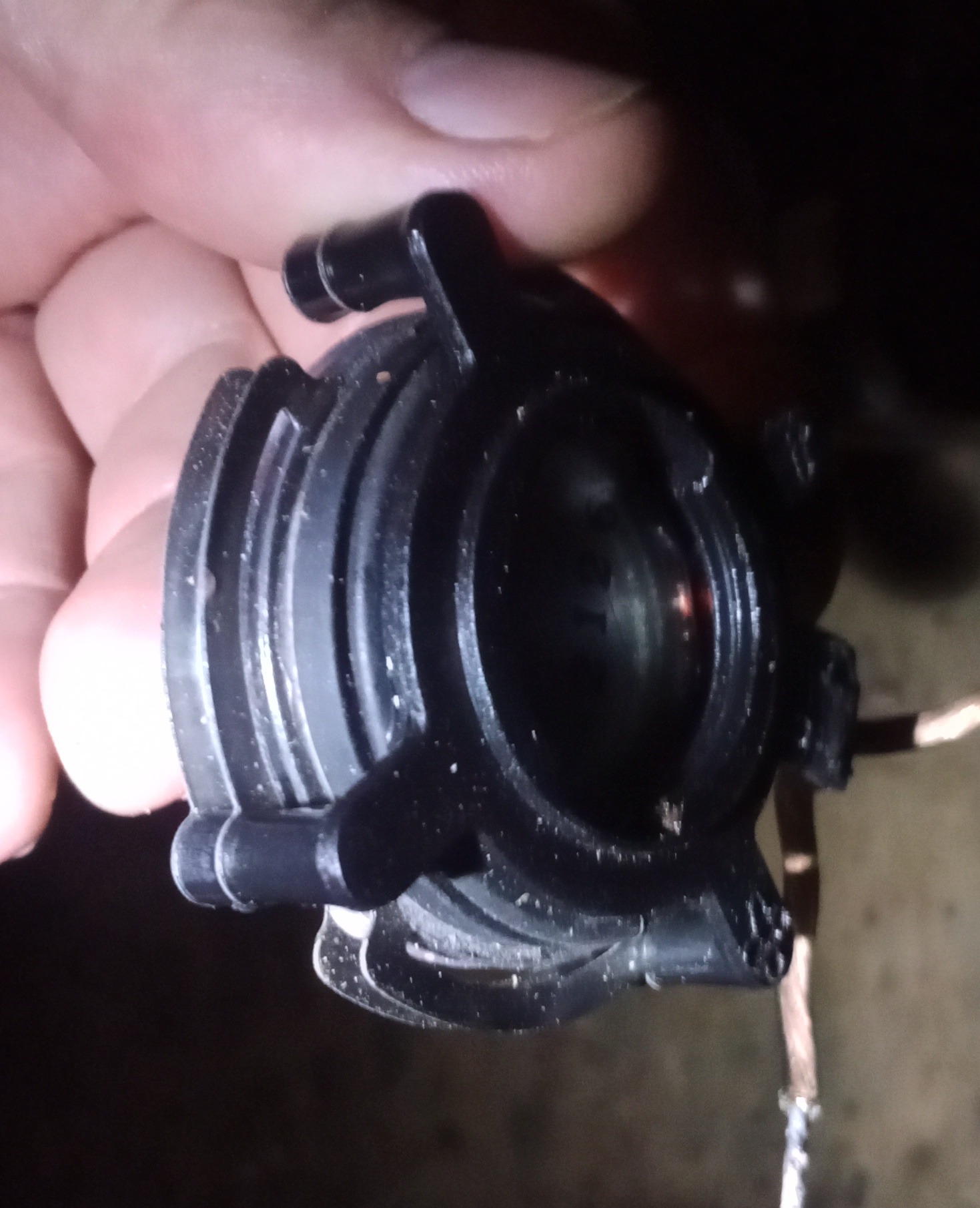

Just curious if anyone has used the DAEX32Q-8 to any good result. I revisited mine over the last couple of days and experimented on a glass panel, XPS, EPS, poly foam, and some hybrid thin ply/poly foam that sound really good with my 25FHE's.
It seems that the rubber boot on these are killing any sort of liveliness. They are as dull as repeating yourself and arguing with a box of rocks. I feel it's the boot because I unscrewed and bent those top springs back out of the way and re screwed using only the lower springs, but that's not all, I also mounted the exciter directly to the known nice ply/poly panels without using the screw in plastic "quick change plug". You get a full circle of direct as possible contact this way.
The result was the same dull output. I feel that was $40 down the drain and my only recourse is to cut off that boot and see if they are salvageable. Returning them is not an option. I'm just curious if that boot is holding back some nasty noise from the coil area as I don't see the purpose in it if not. (Waterproofing?) The springs are what keeps the coil aligned.
Open for suggestions as always, thanks.
The result was the same dull output. I feel that was $40 down the drain and my only recourse is to cut off that boot and see if they are salvageable. I'm just curious if that boot is holding back some nasty noise from the coil area as I don't see the purpose in it if not. (Waterproofing?) The spring are what keeps the coil aligned.
I have tried them before and they were one of the worst if not the worst sounding exciters I've heard which is why I dont reccommend that exciter. You can get better sound from the DAEX25 for $22.49 a pair.
If you can remove the front black part off without breaking the voice coil then it should work better.
Anything that hinders the voice coil or the panel material from vibrating freely is not a good thing. For example any exciters with these so called "Legs" should be cut off as the legs hinders the vibrations of the panel. Anything that hinders the voice coil like the DAEX32Q and DAEX32SQ or TAEX32C20
