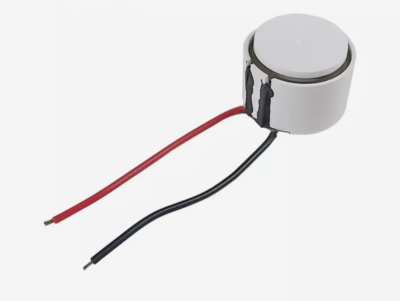

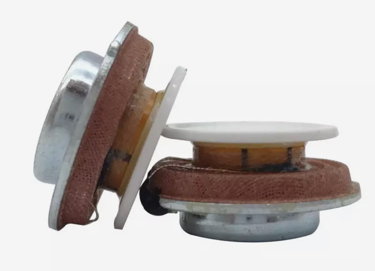

Different subject: have you guys ever tried looking at “bone conduction” audio transducers? They are similar but tend to be smaller but a lot less expensive. Might be useful for smaller nearfield desktop panels? I bought these and will try them out.
US $6.22 21% Off | AIYIMA 2Pcs 27MM Audio Portable Vibration Speakers Resonance Speaker 2W 4ohm DIY HiFi Full Range Speaker Stereo loudspeaker
https://a.aliexpress.com/_mtdqXH8
US $10.47 16% Off | SHEVCHENKO 25mm Mini Speaker Bone Conduction Loudspeaker 4OHM 3W Full Frequency Resonance Horn Waterproof For Audio Accessories
https://a.aliexpress.com/_mKv4xkw

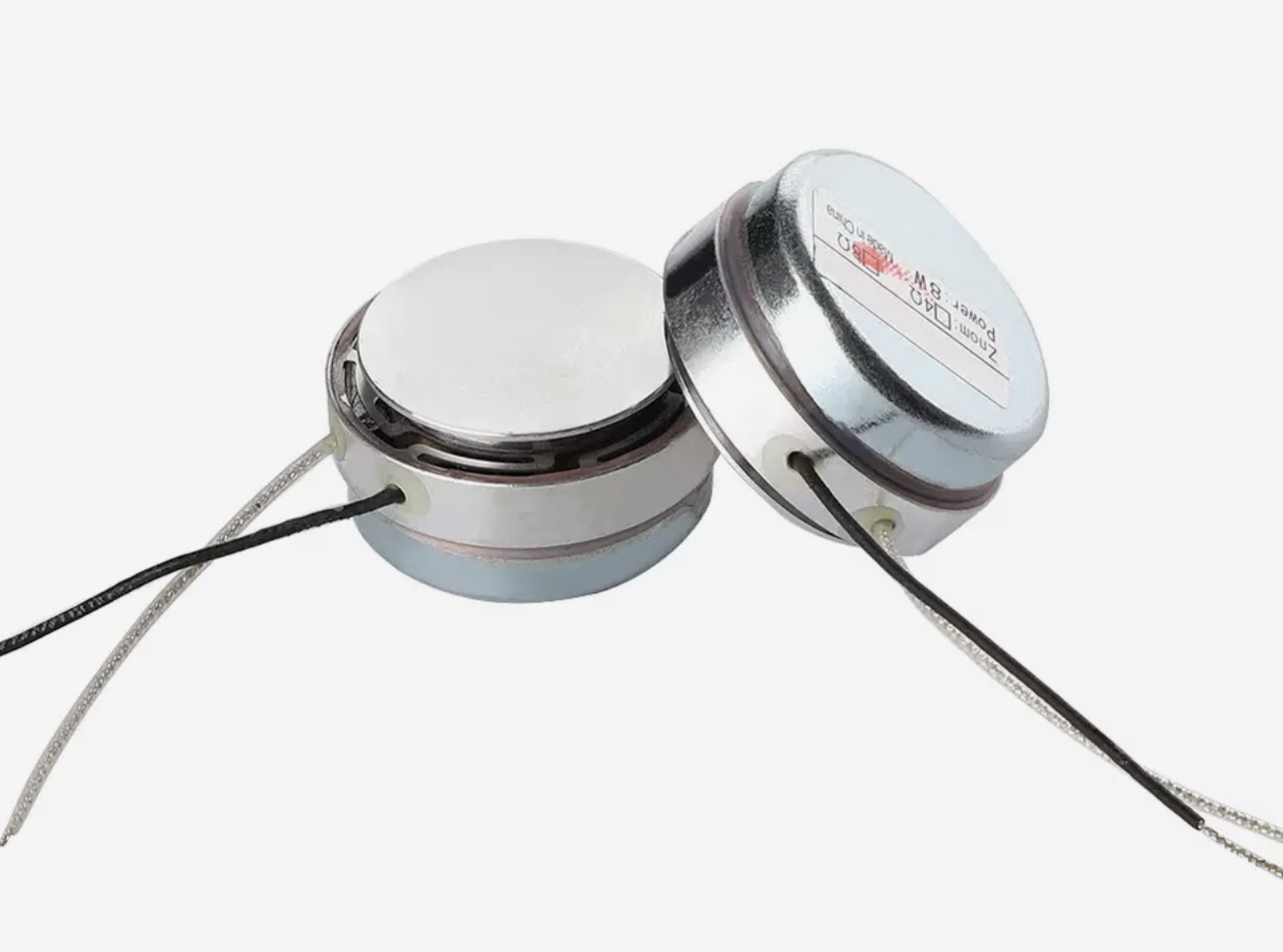

I have not bought this one but seems promising and looks quite powerful and designed for panel exciter. The prices are way better than Parts Express:
US $11.99 26% Off | AIYIMA 2Pcs 30MM Vibration Resonance Speaker 8 Ohm 8W Mini Full Range Speakers DIY Home Theater Sound System Driver
https://a.aliexpress.com/_msXS1Qq

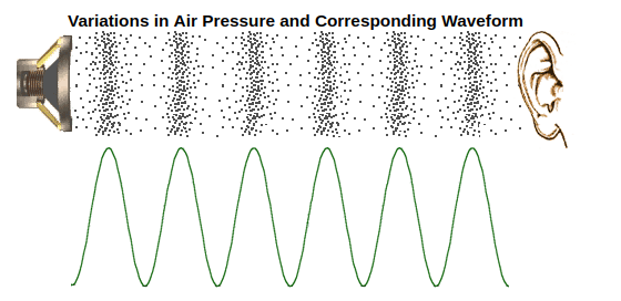

Does it explain how the sound that comes out of the cone speaker goes in the plane which is at 90 degrees to the to and fro motion of the bobbin?Morning all.

SourceDoes it explain how the sound that comes out of the cone speaker goes in the plane which is at 90 degrees to the to and fro motion of the bobbin?
Does it explain how the sound that comes out of the cone speaker goes in the plane which is at 90 degrees to the to and fro motion of the bobbin? That plane has 360 degrees around it. Turn that ear up and above the speaker's to and from motion. below the speaker's to and fro motion, and so on, in-plane with the speaker's opening.
In other words, when we stick an exciter on a flat panel, how does the sound comes from the edges, which is at 90 degrees to the movement of the voice coil. Consider the thickness the flat panel <1mm to understand the question.
You should rotate your curve 90 degrees Check this out

Depends it you're talking about displacement, velocity, or pressure. The graph Christian posted is showing pressure.You should rotate your curve 90 degrees Check this out

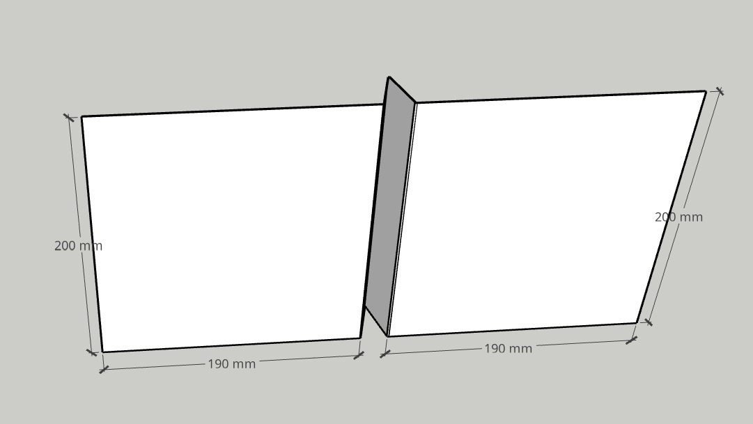

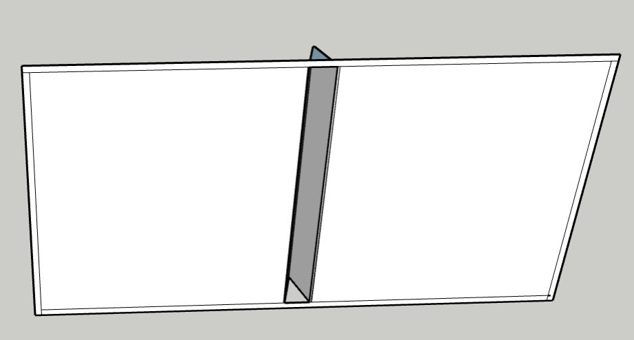

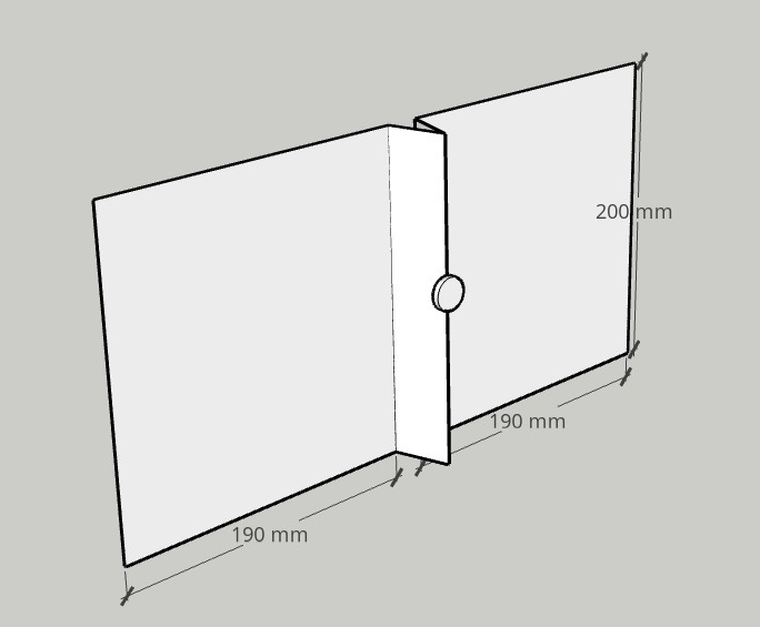

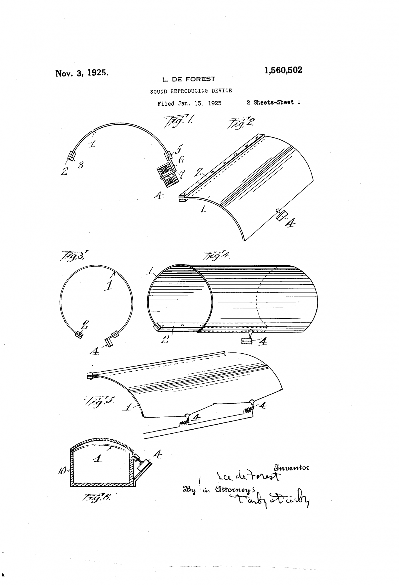

I've been doing lot of experiments with edge transfer of sound to panels, flat or curved, and found that sound coming out of the panels were much clearer and fuller than placing the exciter on face. Of course, that idea was nudged by Ammos and Sony. Later I found that Telefunken had been selling speakers between 1926-1932 with that kind of edge transfer of sound, that too through a spike. (I have given the links to that in earlier posts.) Yesterday, I found a US patent of January 12th, 1925 by Lee De Forest,
Patent was granted in November 1925.
A few days ago, I've been playing with the idea of bending the panel in the middle and placing the exciter/sound source to the edge of the bend in the middle, before I found this patent. Some sketches,
Measurements are indicative. I was thinking of making the triangle more curvy, but forgotten how to draw that in Sketchup.
A sound reproducing device comprising a membrane and a. sound reproducing member attached tangentially thereto to impart vibrations tangentially to the plane thereof.
