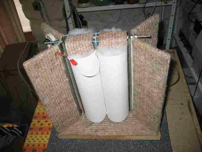

Reading the tutorial that Christian posted a while back, I find some support for chdsl statements about edge excitation of cylindrical objects:
"In most flat plates, bending and membrane (longitudinal) waves are uncoupled. Take a flat plate and bend it statically, and those waves become coupled. Take the flat plate and wrap it around a circle to form a cylinder, and the coupled bending membrane waves become continuous around the circle. This is a circular cylindrical shell—a structure that has received almost as much attention over the years as flat plates have.
When bending waves travel around a structure with curvature, they are coupled strongly to in-plane longitudinal waves, which travel at much higher speeds than the bending waves do (recall our discussions of wave speeds earlier). The coupling occurs because curvature causes the transverse displacement to be resisted not only by flexural stiffness, but also by the membrane, or ‘hoop’ stiffness. Bending waves sped up by membrane stiffness resonate at higher frequencies than they would in an equivalent flat plate.
Skimming a few papers, I find:
"Cylindrical shells exhibit a dense frequency spectrum, especially in the lowest frequency range. In addition, due to the circumferential symmetry, frequencies occur in pairs. So, in the vicinity of the lowest natural frequencies, several equal or nearly equal frequencies may occur, leading to multiple internal resonances."
"For cylindrical shells under harmonic external forcing, Chen and Babcock [9] observed that the modal solution must include not only the directly driven mode, but also the circumferentially symmetric companion mode. This additional mode has the same linear vibration frequency and the same wavenumbers as the directly driven mode; hence, the term companion mode to describe it [10]. The presence of the companion mode in the response of the shell may lead to the appearance of traveling waves
"Therefore, the radiation efficiency of an acoustically thick shell could reach unity at a frequency much lower than the critical frequency. Also, because the acoustic behaviour of each vibration mode would be affected by the boundary conditions at both ends of the shell, the radiation efficiency of the shell has been shown to depend strongly on the boundary conditions.
It does pique the interest...

Also,
Radiation from cylindrical shells driven by on‐surface forces​
The Journal of the Acoustical Society of America 95, 2014 (1994); https://doi.org/10.1121/1.408664
Asymptotic analysis is used to study sound radiation from cylindrical shells driven by on‐surface forces. The far‐field sound is analyzed in terms of radiations from helical waves in the shell excited by the forces, which are shear and compressional waves in frequency domains well below the coincidence frequency of the shell plating where thin shell theory is applicable. These shell‐borne waves are shown to be crucial contributors to the far‐field radiation; they dominate the frequency dependence of the radiated field, because they carry with them features of the elastic waves such as resonances, their radiation covers a wide spatial domain, unaffected by the shadowing effects of the shell, and they may overwhelm in amplitude the direct radiation from the forces in some directions, the latter following a direct fluid‐borne propagation path from the driving forces to the far field. It is found that tangential forces on the shell cause more acoustic radiation than normal forces, because the former excite radiating shell waves more easily than the latter.

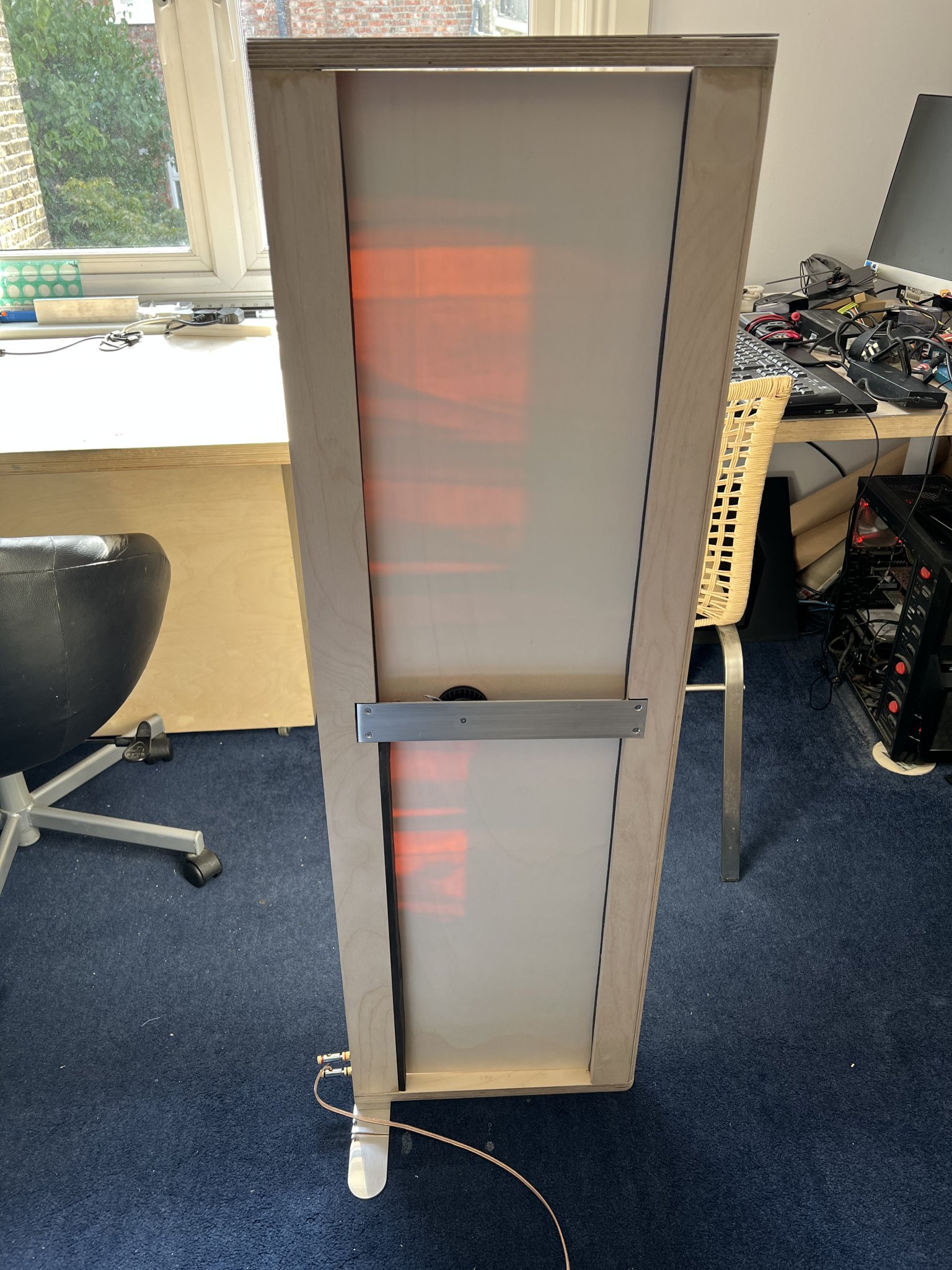

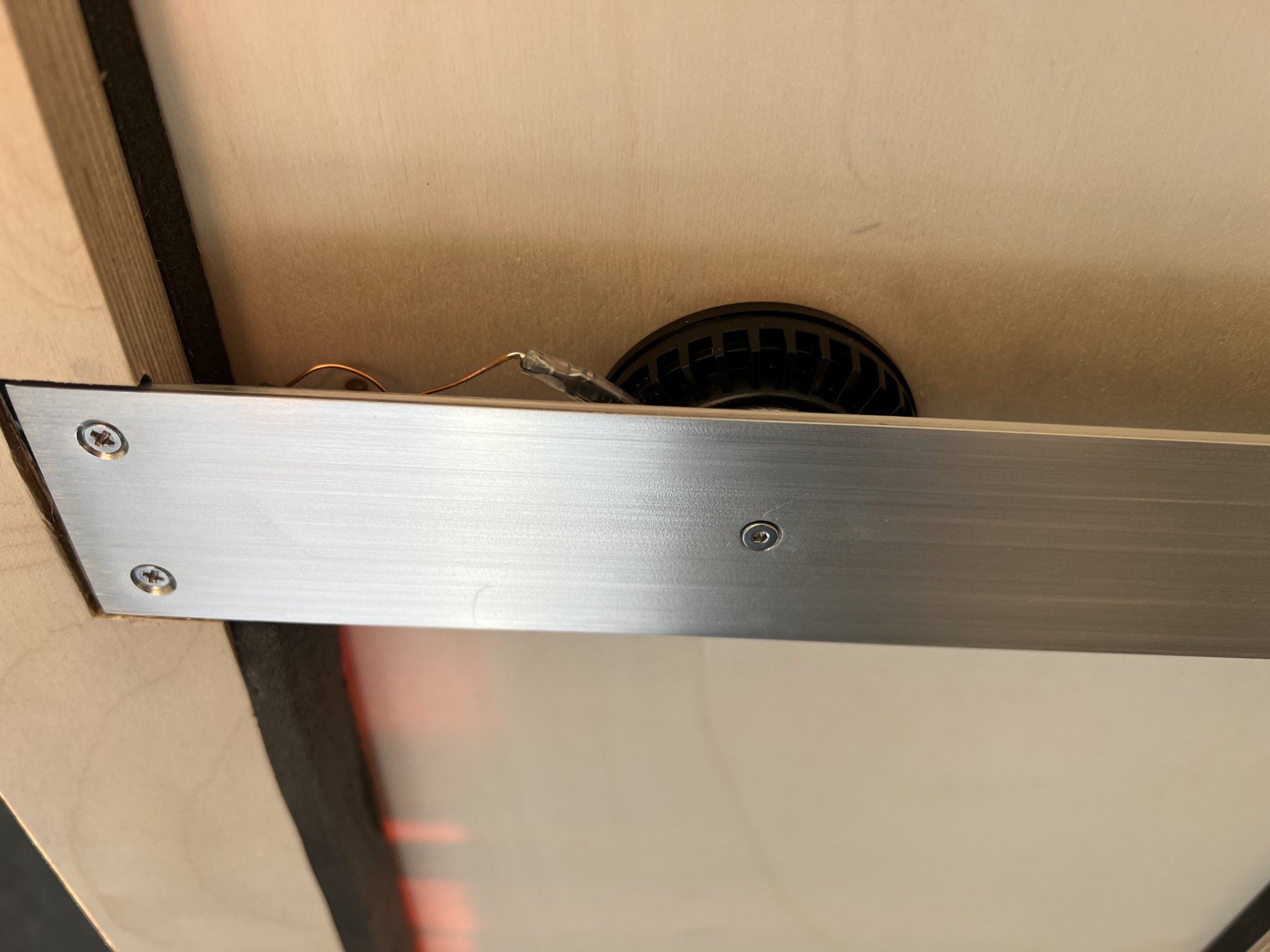

I wanted to kindly ask if from your experience the size in terms of thickness or type of material, in my case wood affects the tonal quality especially at low frequency or can I keep a thin frame to keep the weight light
Hi Pixel,
I use a solid frame with a soft mounting along the long edges that has worked well on a number of builds. I have included a couple of shots of my latest builds below. The foam is very soft but wide and has very good adhesive qualities so it acts as damping and suspension.
Another approach is a ‘clamped end’ which I used on my Tall Blondes where one short edge is attacked to an upright via thin ( 2mm) foam tape, five tapes strips at 30mm wide and 90mm long. This is not a ‘normal’ DML but sounds great and still plays in my dining room.
I suggest you stick with the frame approach for now as it has been tried and tested by more builders so you will get more input should you run into problems
