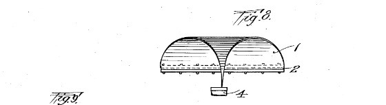

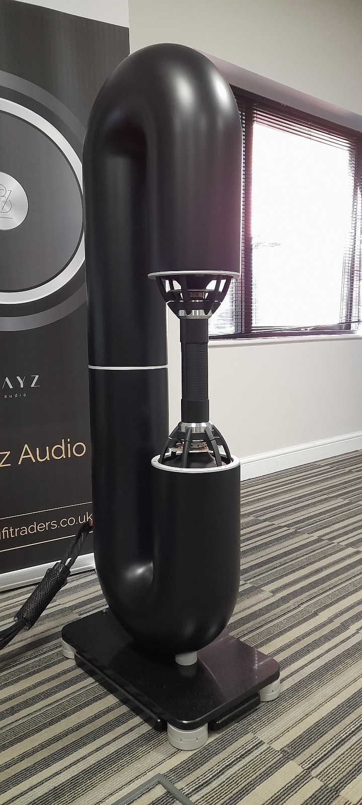

Have look at Lee De Forest's 1925 patent, and especially this figure,Did you see my posts 7941/2 which give support to your opinions on edge transfer in cylinders?
and, compare that with MBL Radialstrahler speakers. The MBL is using the full circumference of the bobbin to edge transfer the sound to 12 or so curved panels, fixed stiffly at the other end, that way sending sound in all directions. In a single MBL the voice coil bobbin is up-firing, and in a dual MBL one is up-firing, and the other is down firing. Lee De Forest had the correct idea in 1925, but didn't have the help of computers and such stuff. He writes in nice old fashioned way what he thought (20 points).

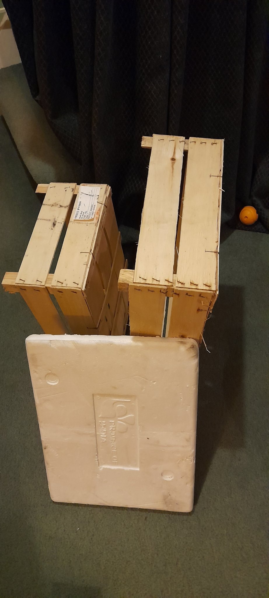

How easy is it to put videos on YouTube, do you have to sign your life away ?
Would it be better to see my panels being recorded?
The only thing that puts me off is everyone seeing the mess in my room and me falling all over the place climbing over said mess 😳
I have sent videos to friends over WhatsApp which I thought were very good, much better than me trying to describe what I am doing.
As it is on YouTube does it save space on this site?
Putting a video from my phone on this site would last only about 5 seconds .

This is very similar to the segmented cone driver I mentioned earlier.Have look at Lee De Forest's 1925 patent, and especially this figure,
Which could drive many such segments from one coil former.
This patent review shows the same linaem style driver but as an omnidirectional pulsating tube.

Zoltan Bay's "claim" is just multiple placing of Paddock's take on Telefunken's and Lee De Forest's ideas. I don't think Zoltan Bay ever sold a speaker. Lee De Forest's idea is toThis is very similar to the segmented cone driver I mentioned earlier.
Steve.
https://audioxpress.com/article/patent-review-the-zoltan-bay-loudspeaker-patent
And, that plane is curved. So, compare that with MBL Radialstrahler speakers.A sound reproducing device comprising a membrane and a sound reproducing member attached tangentially thereto to im part vibrations tangentially to the plane thereof.
Now, take a acrylic, plastic or even EPS/XPS (stiff) ball, cut a hole equal to the circumference of the exciter and paste to that hole. Make few vertical slits, 8, 10 or 12, fix the top of the ball, so it won't jump off, fill some cotton wool inside that slitted ball and run the exciter. You'd have your omnidirectional curved DML(?) speaker. Lee De Forest's idea.
