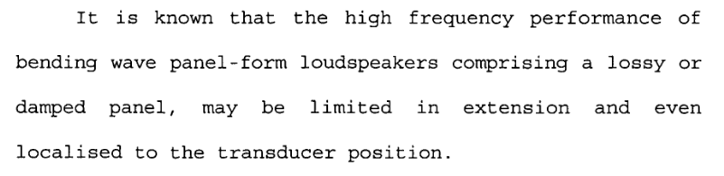

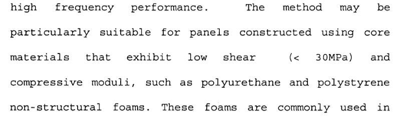

Intresting patent! I need to go back and check the measurements on my panels to see if they have these ”problems” and how big they are that is adressed in this patent. I like the idea of smothing the effect of the coincidence frequency by varying either the area mass or bending stiffness.Hello Thomas,
Interesting patent. thank you. In addition to the reinforcement of the voice coil area, it points to facts often reported here :
This patent refers to another interesting one (WO2000015000A1)for a variable thickness panel. In the advantages of non constant thickness:
So some smoothing effect is expected.
- spreading of the coincidence frequency over a range
- adaptation to the edges impedance
The material in the example is a Rohacell core with a variable thickness with glass mat skins.
Christian
But as with all NXT patent they try to cover everything by including all possible variants without stating which one is the best…for example in this patent: stiffer in the center, stiffer at the edges, stiffer non-centrical and many more variants...so there is a bit of guessing and experimentation needed.

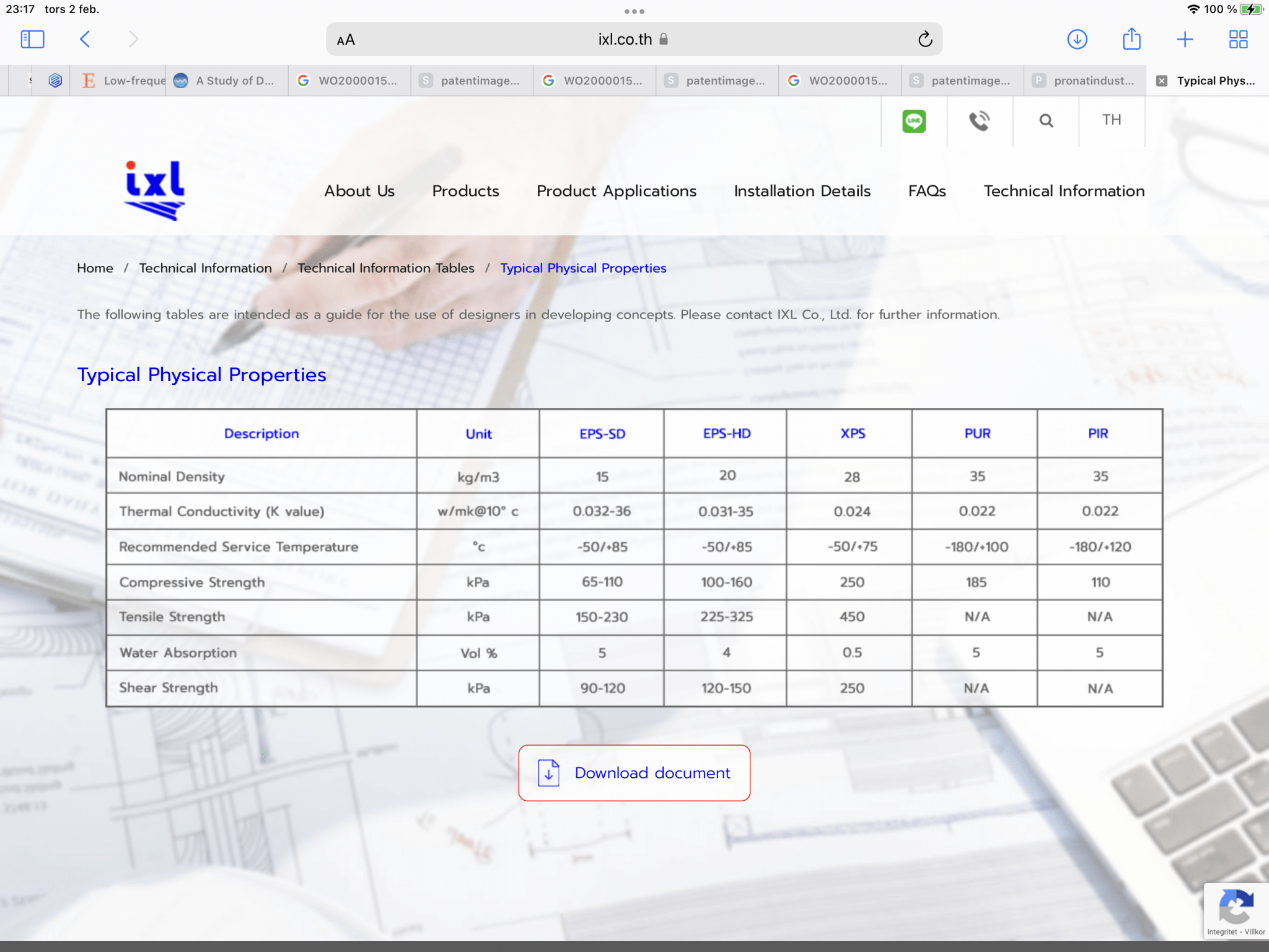

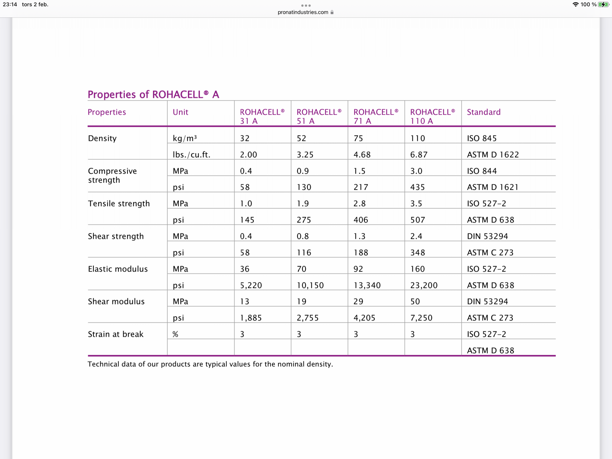

I have earlier noticed that nxt is using rohacell as core material. I’m contemplating evaluating this as an alternative to long grain balsa that I’m using today. Going forward I will test cross grained balsa, rohacell and 3d printed honeycomb (this will allow for variation in thickness and area density).
Rohacell compressive and shear strength compared to xps (I have no data for balsa…).
Thomas
![B3144171-7CED-4511-A786-0219B8ADBB22.png B3144171-7CED-4511-A786-0219B8ADBB22.png](https://www.diyaudio.com/community/data/attachments/1046/1046095-7cc00d175fe58f3bf8c4c7f63d21da6c.jpg)
![8CB1251D-8D49-47B7-9713-66C442A39928.png 8CB1251D-8D49-47B7-9713-66C442A39928.png](https://www.diyaudio.com/community/data/attachments/1046/1046094-29533a6e962fc9727e264a7b7efe8948.jpg)

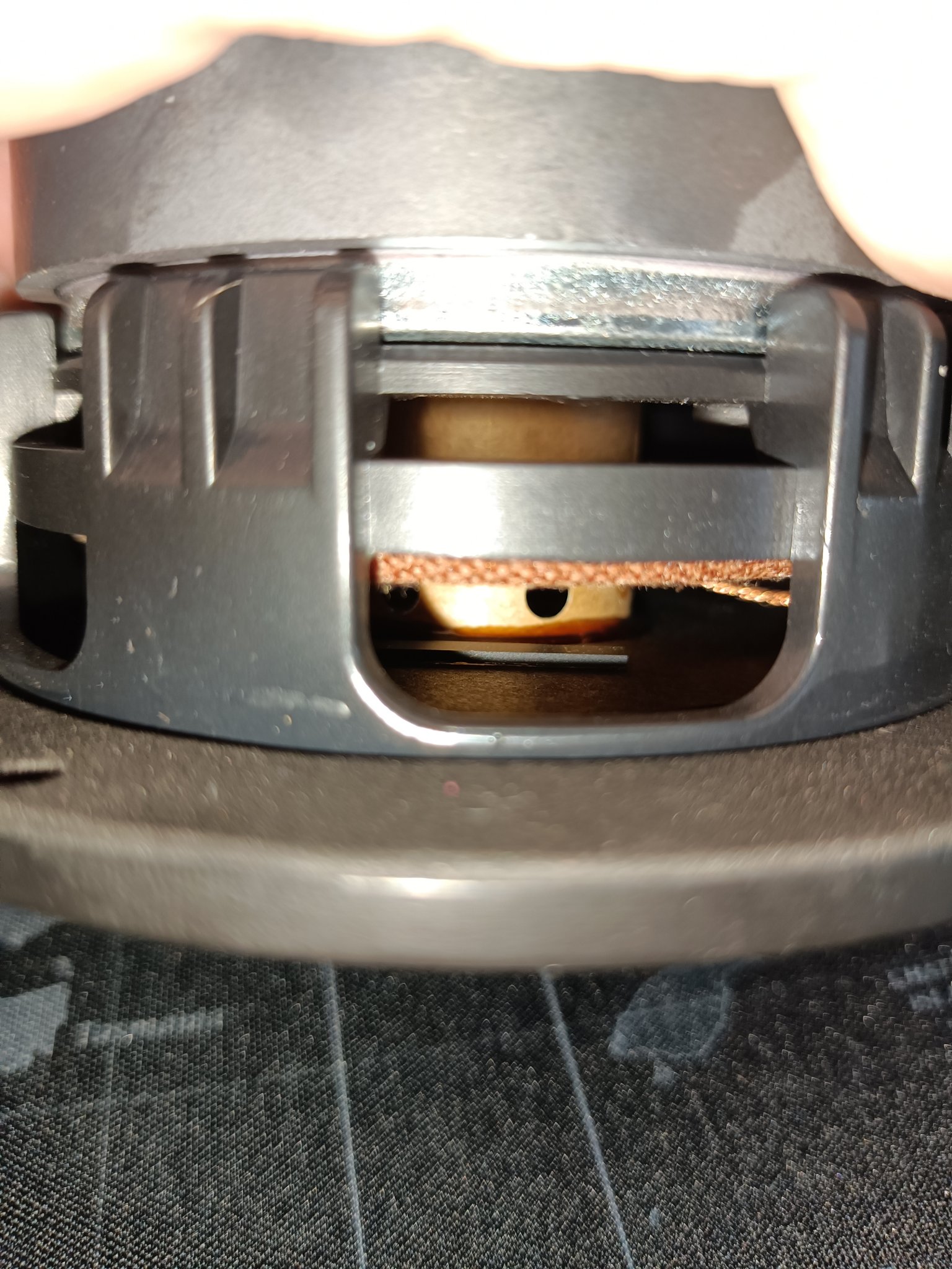

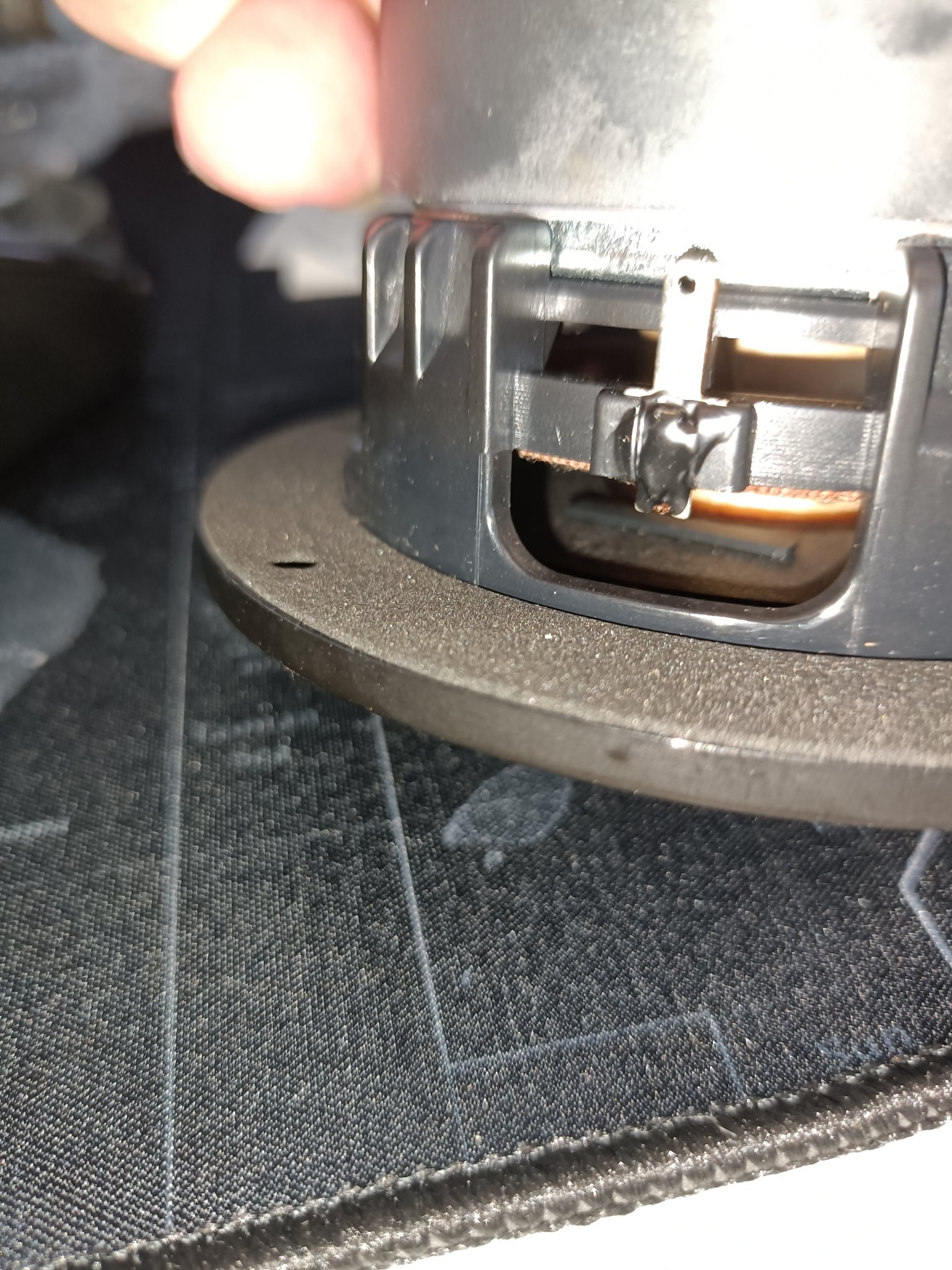

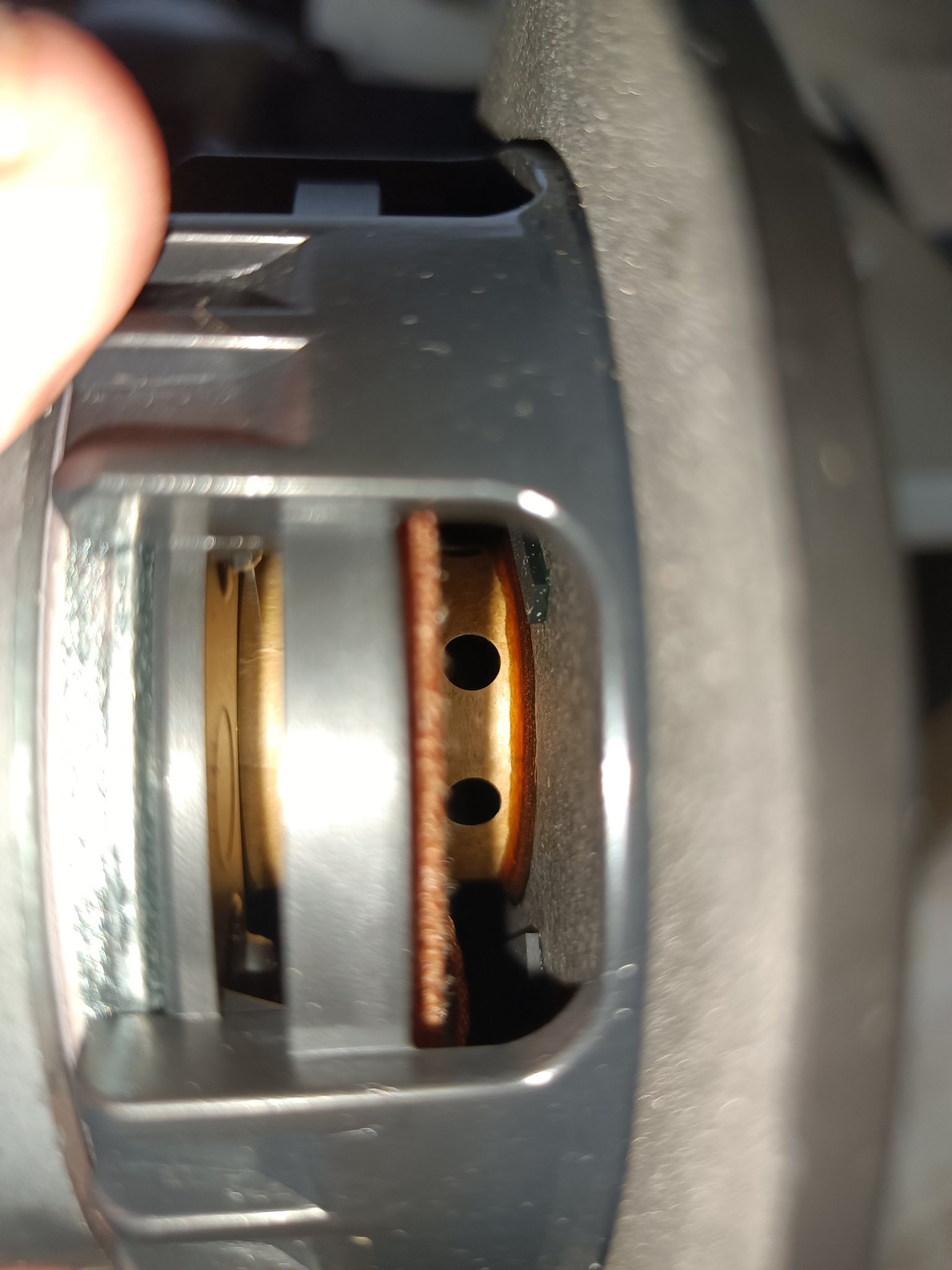

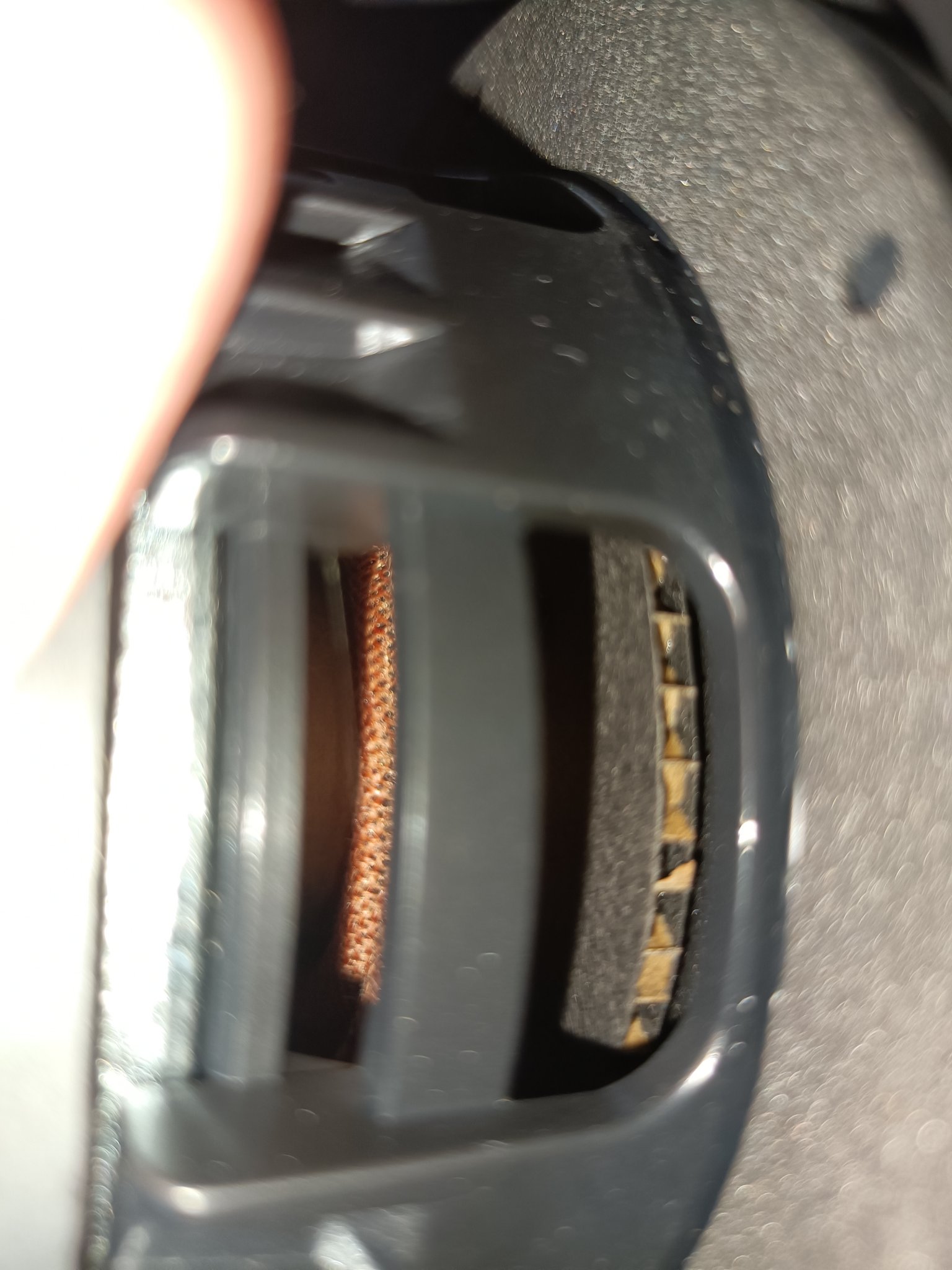

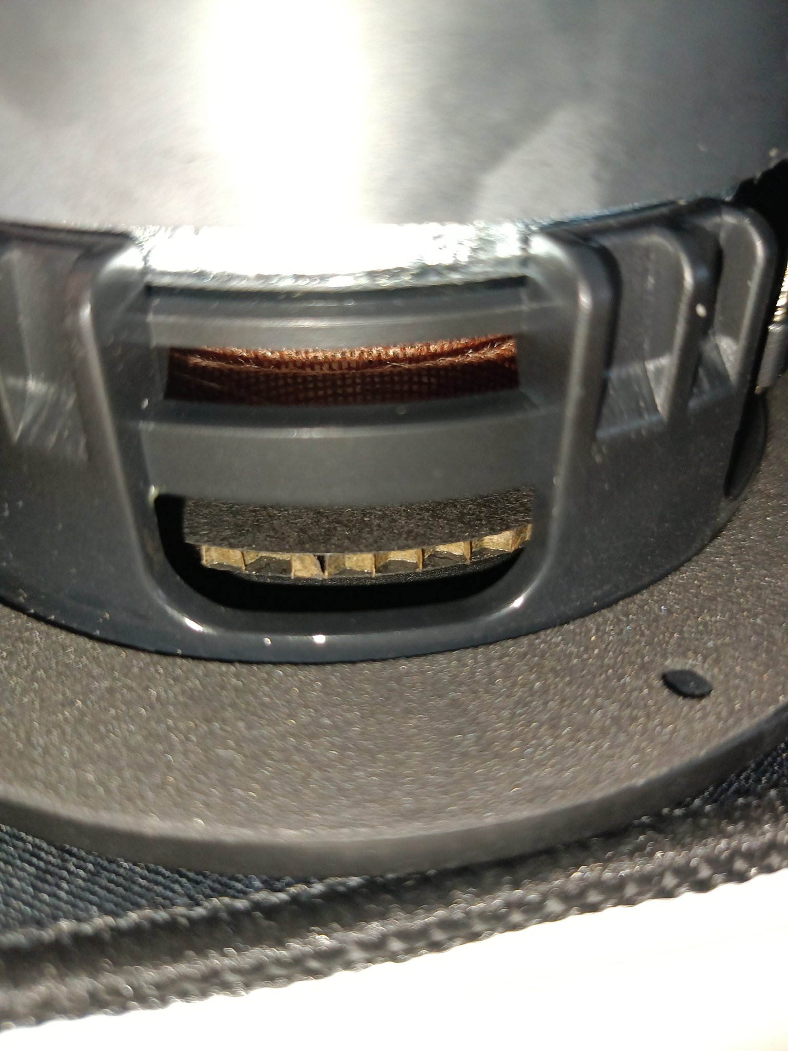

Some pics and details of the Dayton TEBM65C20F BMR
The diaphragm appears to be a paper/Nomex/paper sandwich about 2mm thick. In accordance with their BMR info sheet, the edge of the diaphragm does appear to extend approx to just shy of the centre of the roll of the surround. That matches the calculated piston diameter of just under 69mm.
What's not in accordance with their blurb are the ring masses. Instead of ring masses we have three straight pieces of added mass which I would assume must:
a) cross node boundaries
b) create unevenness in response
The exigencies of mass production I guess
The X max (p-p) figure of 10mm seems a bit optimistic? ... Maybe it means +/- 5 ??
The voice coil former extension length is about 18mm, vented between the diaphragm and spider, the diameter of which is about 70mm... Obviously designed for long throw.
