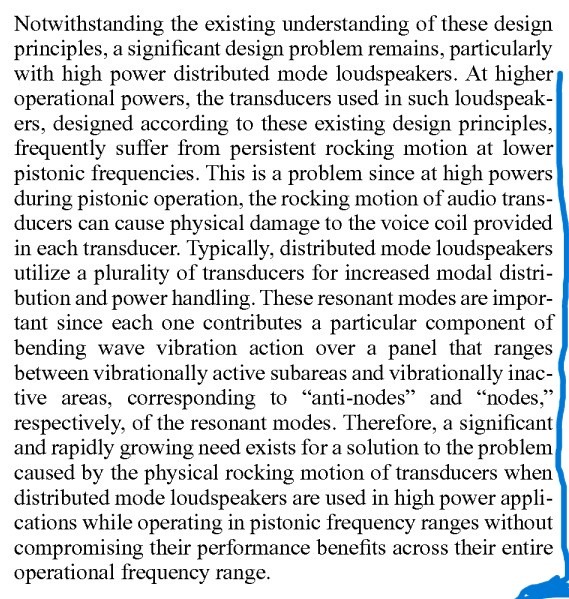

The thing is, the voice coil shouldn't move the panel, the exciter must only transfer the vibrations. This is the tricky part. Have a look at all those patents, I posted in the post #9,094. Might help.

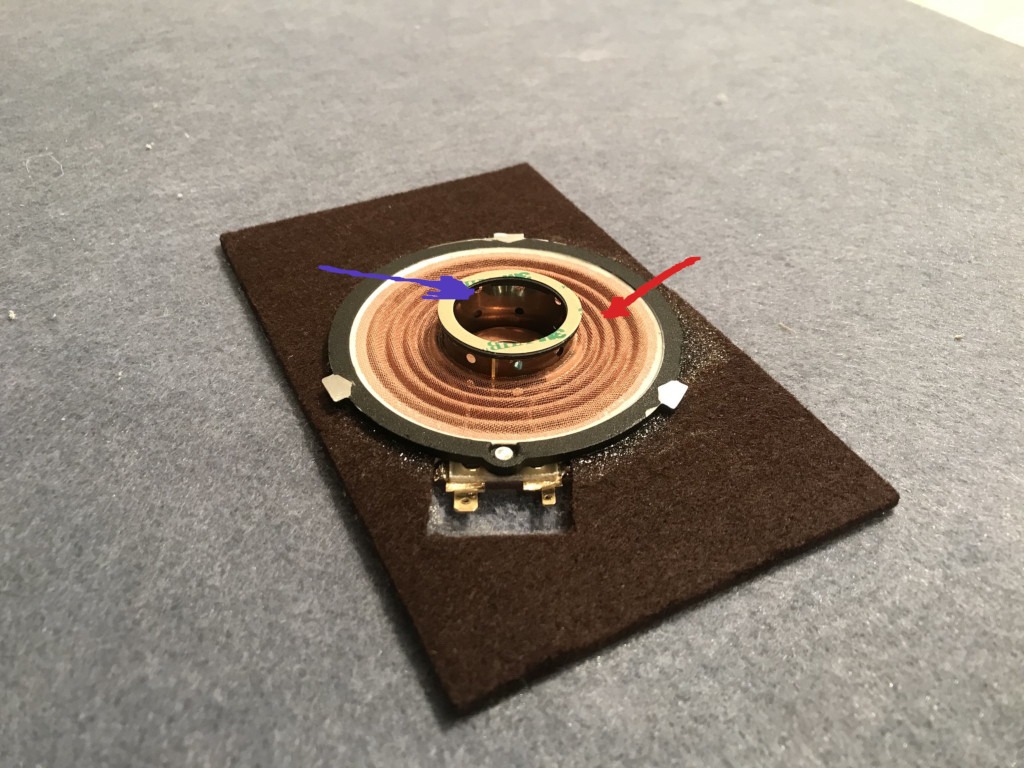

Best to make the spider(red) as stiff as possible, so that the coil former (blue) won't jump out, restricting the piston motion, if possible completely, so the coil former/bobbin won't be able to push the panel like a piston. If you look at the post #9,059, you'd notice that both AER bbx and Aiyima exciters have the spider fixed tight. They don't push the panel. The excitations/vibrations comes from the centre. The spider does not move. In Aiyima, for example, you screw the plate in the centre, or change the plate to a conical-headed screw. The whole idea of the DM exciter is not to let the coil former/bobbin move. The exciter ideas are here, #8,772 and here, #8,780 from one of those links I posted. For you too, @pixel1

Now I now what you mean, looked at your links and it reminds me of Tectonic Elements TEAX32C20-8. Have you tried it?
I used scan+speak motor for my fourth full range dml project specifically because of long linear stroke and short, lightweight coil. Longer stroke gives more flexibility to eq low frequencies.
Carbon fibre/Aramid Honeycomb-Sandwich sheet ended up being too stiff for given panel size of 550 x 700 x 3.5 mm. With 60w and after eq there was no visible excursion and motor was overheating. To increase pistonic motion I started to trim the foam surround around perimeter. Before cutting the 1100 x 700 mm plate in half I tested it with Dayton exciter and it sounded better even without eq.
RTA measurements I made for myself with Iphone to test and compare and guide me in right direction. As soon as I get usb measurement microphone I will start to learn and can publish the data.

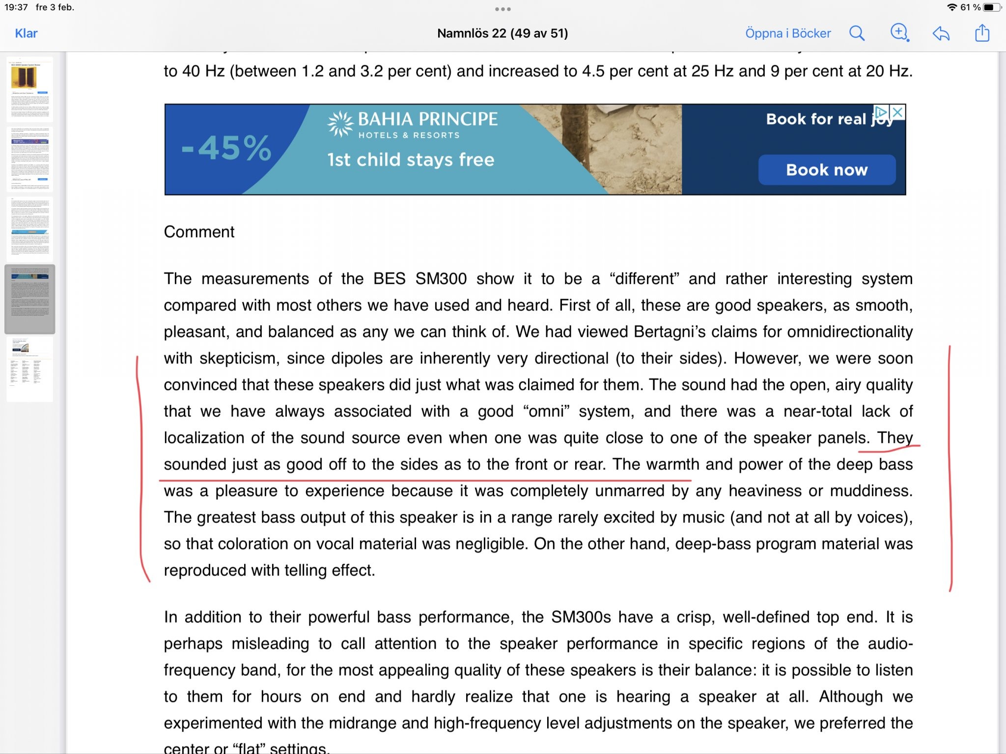

His was not a DM operation, but a pistonic operation with flat panels, Those were the days Yamaha's ear, Hitachi's HS-5000, Sony's APM, Technics X700s, All were pistonic with flat panels. Sony and Technics had honeycomb, Hitachi filled the cone with foam to make it flat, Bertagni and Yamaha used carved polystyrene. Nothing to do with DM oscillations.
Hmm,
I’m not convinced after reading the patent and review of the BES SM300 That it is a pistonic speaker. There are some comments on the dispersion of the sound from the speaker ”The sound had the open, airy quality that we have always associated with a good “omni” system, and there was a near-total lack of localization of the sound source even when one was quite close to one of the speaker panels. They sounded just as good off to the sides as to the front or rear.”
This is clear indication that this is a bending wave speaker not a pistonic. There is also some descriptions in the patent that suggest likewise.
An intresting aspect of the patent is that he has adressed a lot of the challenges with a bendingwave speaker with quite innovative solutions.

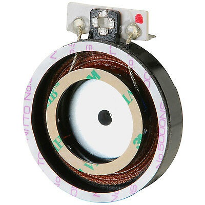

Again could you clearly write it is your understanding or assumptions? There is no demonstration, test or experiment here. I can agree on the fact that the relation between the panel stiffness and the exciter stiffness has not been highlighted enough but not on a spider as stiff as possible. A minimum of physics is needed with this kind of assertion. You even don't speak of the resulting bandwidth (here in LF).
The voice coil is a force generator, force coming from the current in the magnetic field (M Lorentz or Laplace). This force acts against the voice coil mass, the spider stiffness, the panel stiffness.
If the spider is stiff, the force is simply wasted against it. The first mode will increase. The extreme being a fully blocked voice coil.
Is a glued voice coil a "stiff as possible" spider?
The voice coil doesn't jump by itself independently of the panel.
A too stiff panel leads to the same : no low frequency.

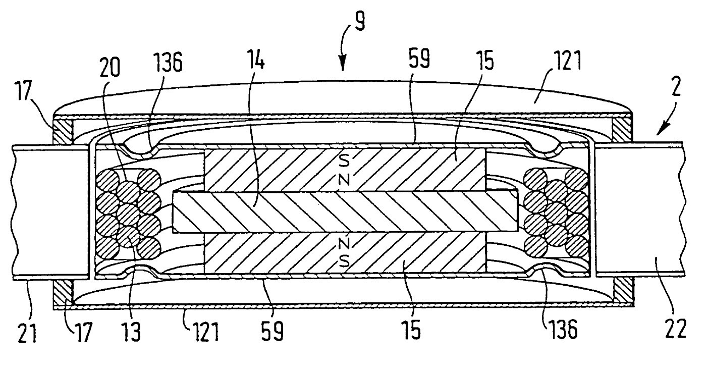

I found this exciter, but there's no description in the patent. I suppose you will be able to understand how its made. Looks like it's supposed work on both skins, placed in a hole in the composite panel. It must be using very thin neodymium magnets, considering the panel should be around 3-5mm thick. It would be nice if someone can give any advice on this. Thanks.
I won't use it : no bandwidth, no efficiency

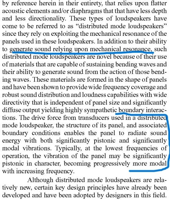

Again you only think that DML's are modal and not pistonic when in FACT THEY ARE BOTH. To play low frequencies (around 150hz and under) the tranducer must be pistonic but to play mid to high frequencies the transducer must also be modal.
