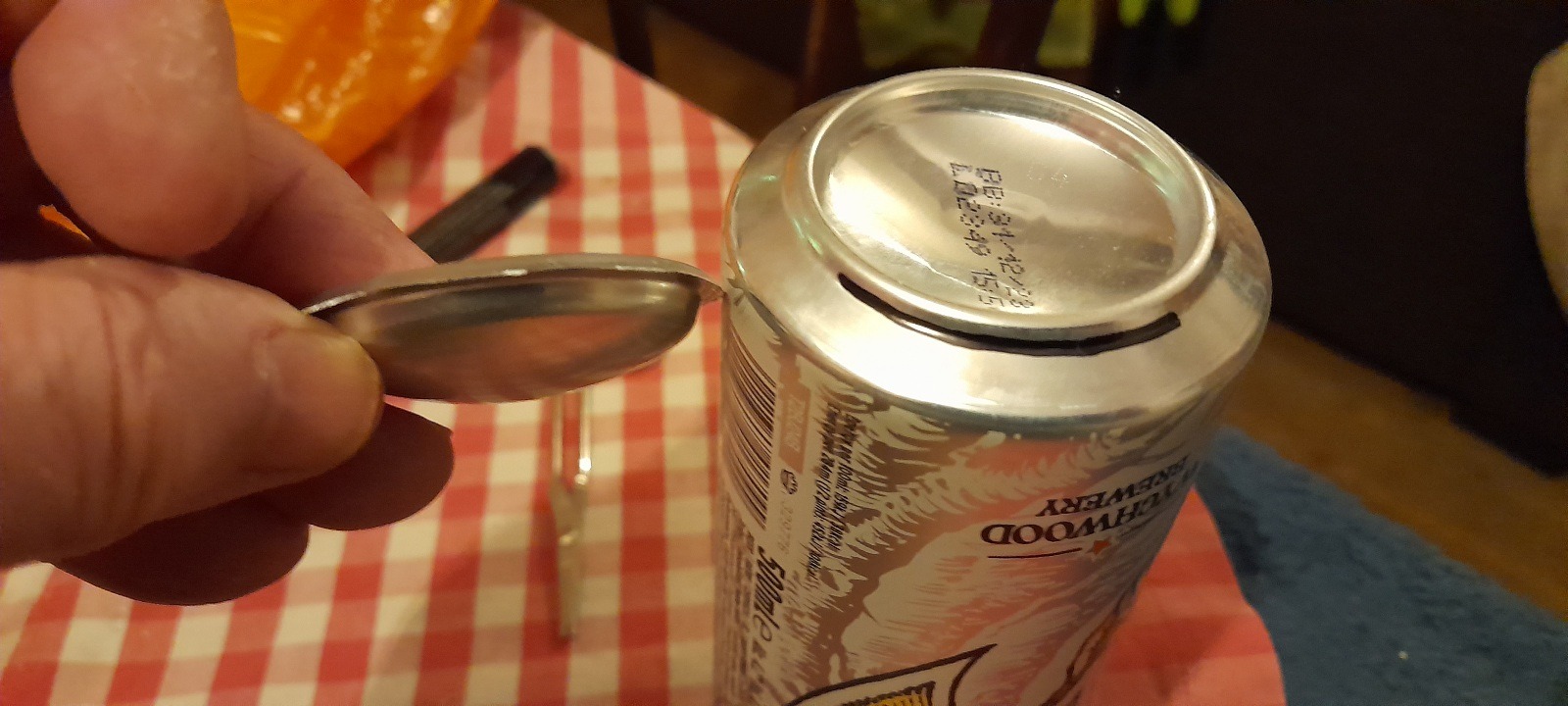

This is the first cut I made and that is the whizzer in the measurement.
Watch out for the sharp aluminium offcuts 😫

Steve, So it looks like you are only using the foot of the can. I hadn't even thought of just that as being the whizzer. Thanks for the great picture, and for your kind help. So the inside of the can foot is glued to the canvas, correct? I don't drink soda, and I haven't had a beer in a long time.
jaxboy.
just for you ,this is a recording of two art panels one with the whizzers and one without.
i would recommend listening to the recording without first as this recording will sound rather dull after listening to the one with the whizzer.
making the whizzer smaller might lower the output or not mounting the whizzer in the central area of the dome might help damp it a little ?
have a listen and tell me how it sounds to you.
steve.

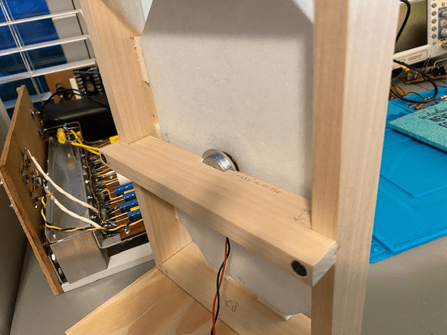

how much does the thickness of the frame affect the sound,
given that at the moment it is all in wood and to make no mistake I used a very dense and very hard high quality wood to avoid vibrations of any kind, what I would like to know if it were much thinner or even made of plastic material, remaining zero spurious vibrations Do you think the timbre would change?
There are many variables.
I agree with Andre. There are too many variable for a definitive answer. I know that for my current favorite design (a panel with an aspect ratio approaching 4:1, and with the plate attached to the frame around nearly the entire perimeter) it's critical to have a very stiff frame. In fact, I have found some bracing to be needed. But that may not be true of every design.

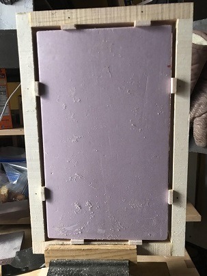

Okay, I built a 7 x 11ish in a frame. right now, the foam is tight. Does it need to just barely touch? or how much friction? I have enough 60 grit sandpaper to dial it in.
The next question is, what Dayton (or other) exciter do you recommend for this? I have 6 watters now, more 40 watters are on the way. The 40s just seem awfully big for this small piece of foam but I'll go with it if that's what you tell me.
And then, does it go dead center, not 2/5s? (I assume it needs to be center for this application, just making sure)
Next, is it best to stick the exciter directly to the pad, or do I need to stick it to a thin piece of wood, and the wood to the foam? I can resaw a wood plate to whatever dimension you say it needs to be.
from there i'll try to find a non-destructive way to connect to the spine but glue if I have to.
