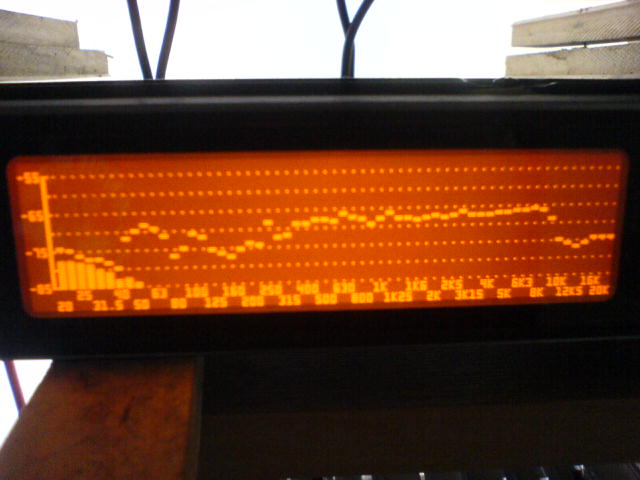

If you want an EPS panel that radiates HF above 10k from all over the panel surface , you will need to use a higher grade EPS .
The lower grades only radiate the hf above 10k from the central area about two or three inches max.
I took these pictures on NXT Rubbish forum in about 2014.

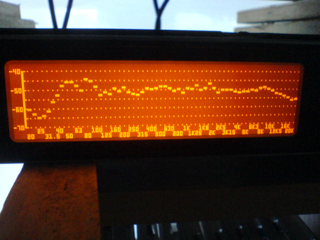

The first picture shows the response of a 5ftx2ft x 25mm panel 12inches in front of the exciter area.
The second picture shows the panel response at 12ft distance.
Notice the response drops sharply a good 6db or so after 10k but stays constant up to 10k.
This is the in room response including the dip below 300hz.
Picture three shows the in room response with my TLs subs running below 300hz.
The comment below this picture says although the hf flat lines above 10k it radiates this all over the room, which sounded natural, so I do not bother to EQ or add a tweeter.
Although I do now days increase the hf output from the centre without too much effort .

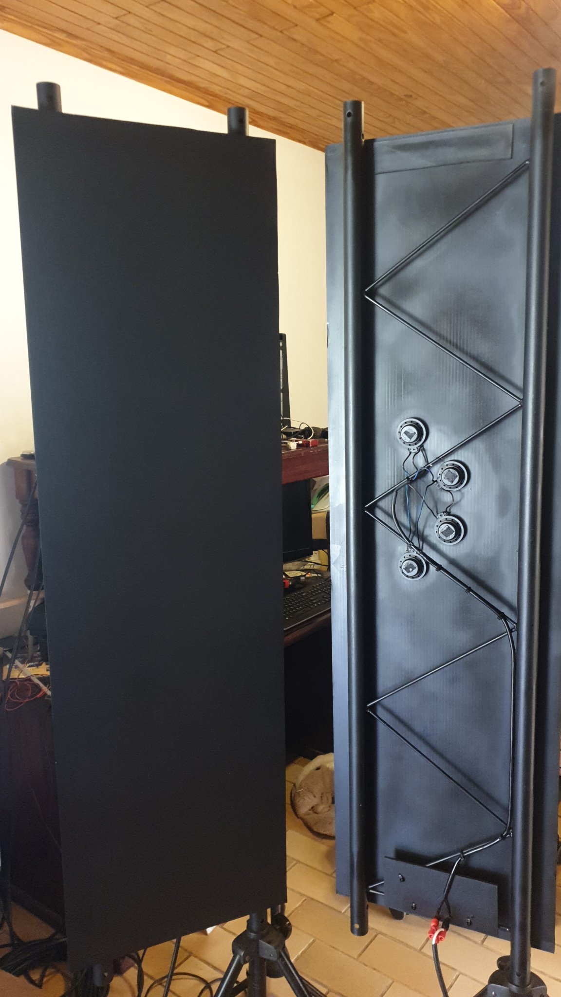

Here's what I'm using at gigs. That's 4x20w drivers per side. I've taken off the bracing that supports the drivers since this is a temporary setup.
I drove them very hard last night, red-lining 150w per side, and I noticed that the drivers do not heat up the same. Some get really hot, while others just get a bit warm.
I suspect that the drivers sitting on panel modes at low frequencies get a lot of voice coil movement, and hence cooling, while those on nodes don't move so much, and over-heat.

Could the exciter heating be caused by the different length wires vibrating and putting the exciters out of balance.
Causing the exciters to wobble at different frequencies.
Do they still overheat differently when they are properly braced ?
Steve.
Steve.
The wires are not heavy enough nor short enough to distort the positions of the VC's and especially not to influence the Mms. I specifically cut the wires to length and suspended them in such a way as to not interfere with the VC/gap positions, nor to rattle at high SPLs.Could the exciter heating be caused by the different length wires vibrating and putting the exciters out of balance.
I don't think they would. While they were nicely braced a week or two ago, I did not have the opportunity to drive them really hard for 4 hours at a time like I did last night. But common sense seems to suggest that the magnets, if fixed to the same brace, would force the drivers and the panel to all move similarly.Do they still overheat differently when they are properly braced ?
When I say 'over-heat', I mean that they heated up, I mean some got hot. But they did not reeely over-heat as-in blow up. I did not burn any voice coils... they all still smell quite fine.
