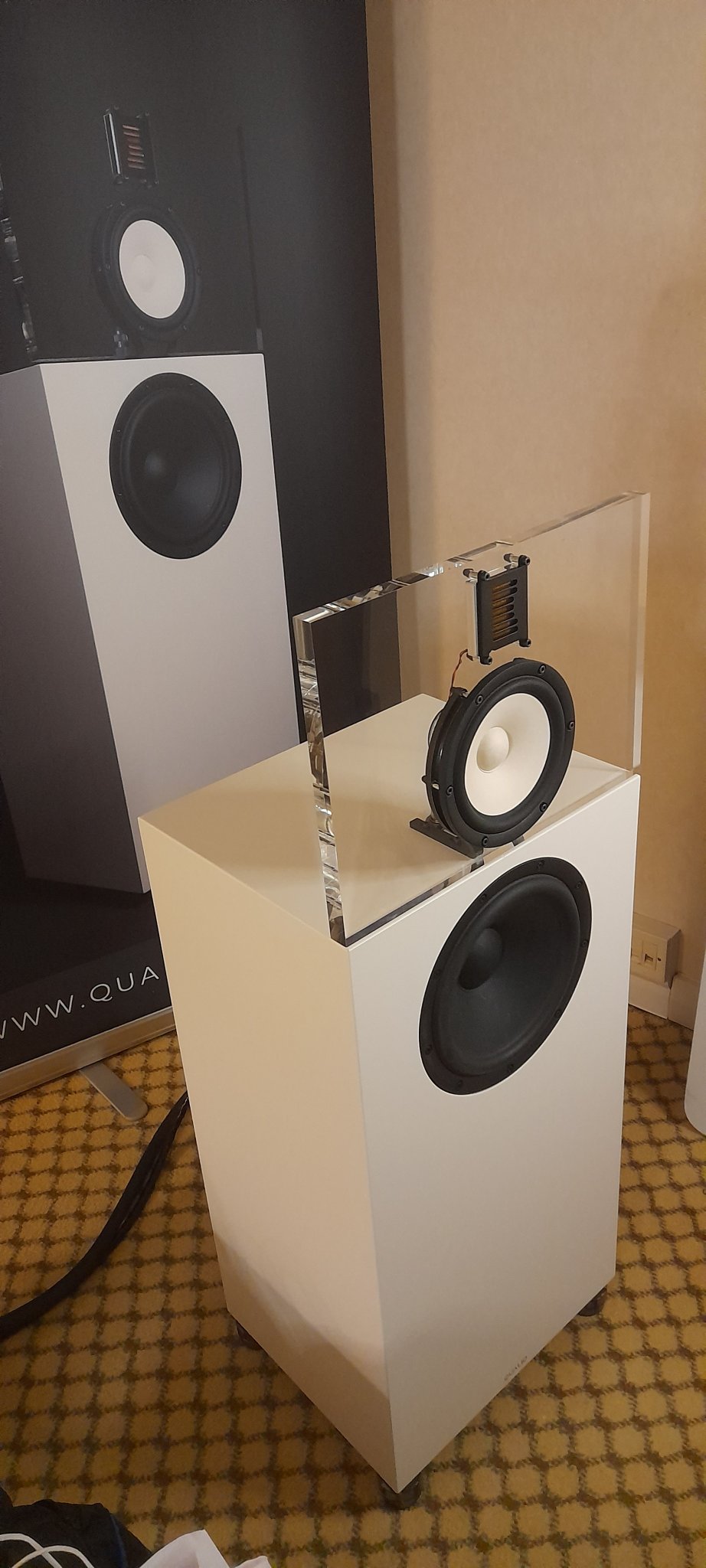

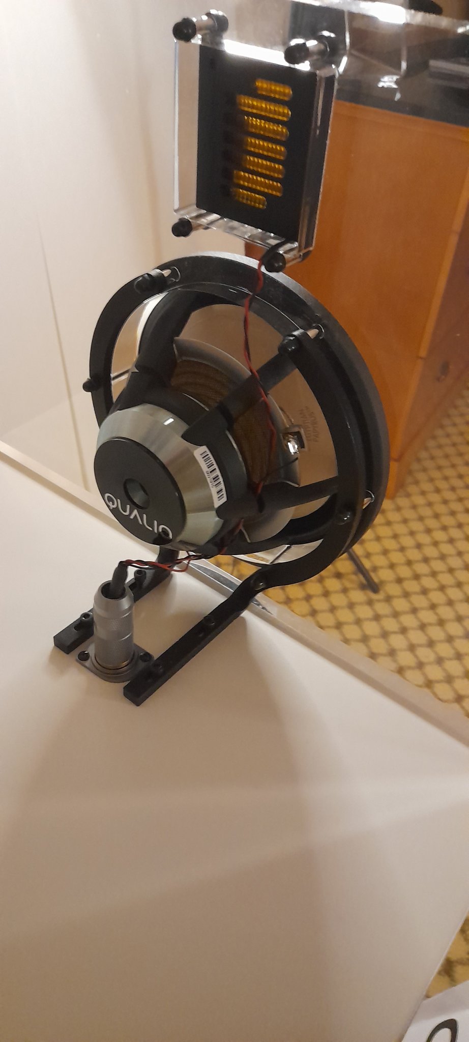

I went to the Bristol hifi show at the weekend.
The only speaker that stood out to me was this open baffle speaker.
But as I was looking at it and listening, I thought, it could be so much better if the baffle was replaced with a DML panel.
Steve.

I was talking about the baffle on top of the box ,and replacing it with a dml panel.
Some panels can get down to 40hz with my exciter as long as you do not want to listen to loud pounding electronic low frequencies.
There are design ideas for flat panel low frequency panels, but I don't know how much dml activity is going on below 40hz unless the panel is very massive, like a wall.
Steve.

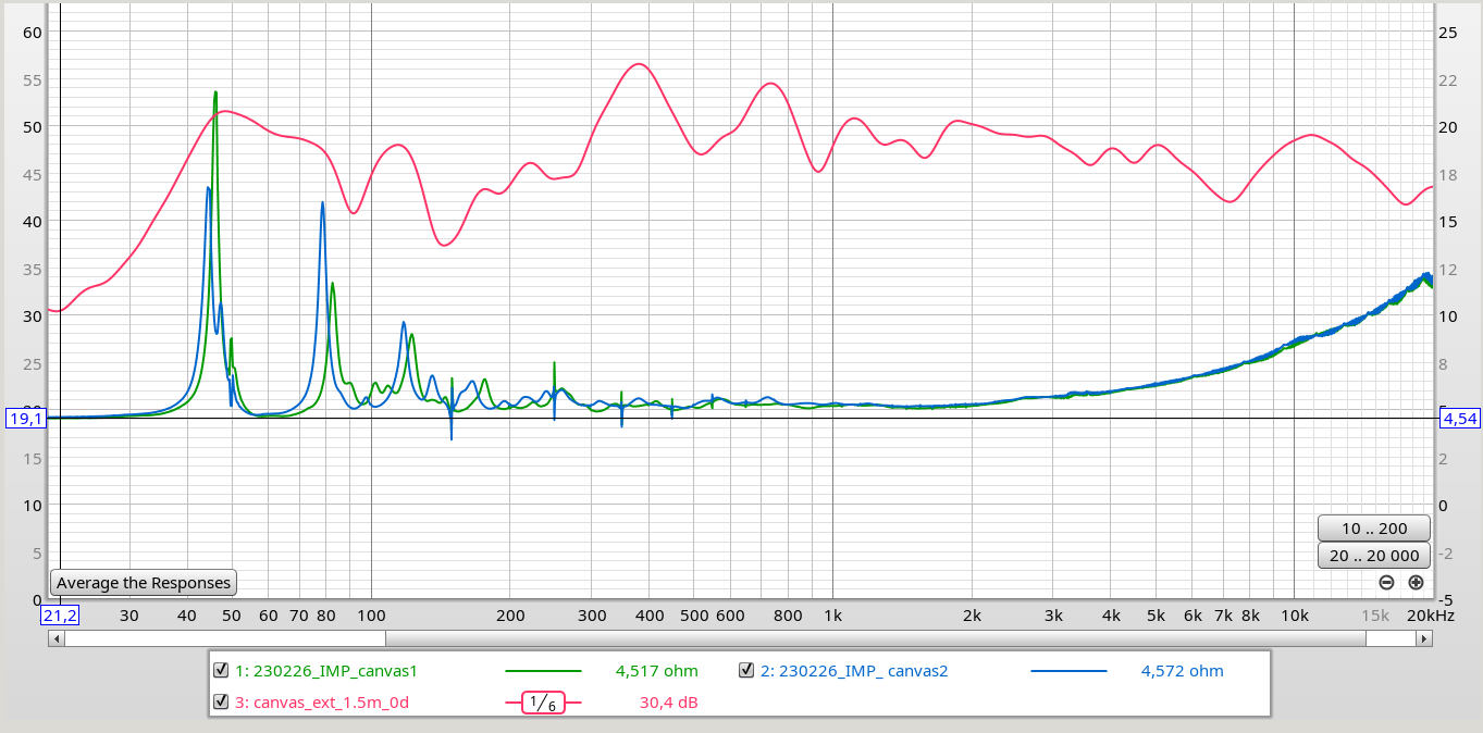

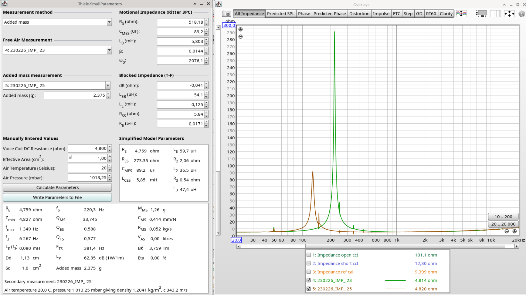

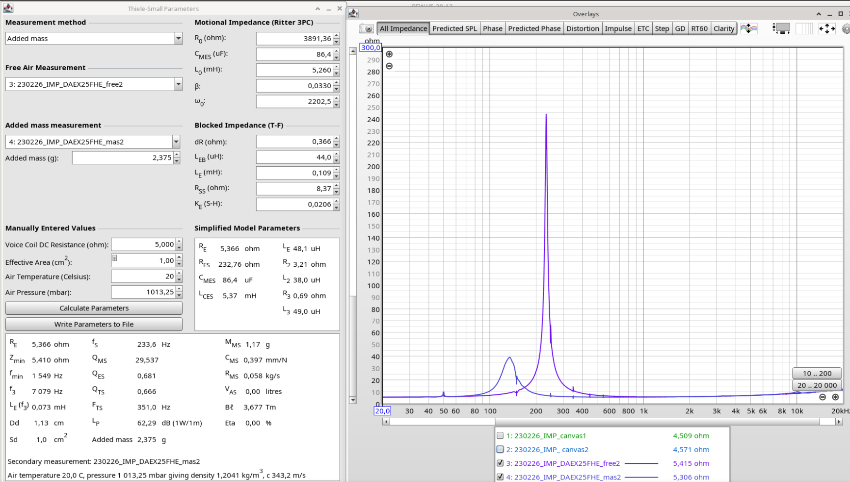

I made some additional impedance measurements
1/ The second exciter I have shows about the same characteristics as its brother. Not far from the specifications
2/ As it is what I have currently, I measured the impedance of my canvas panels and added a FR measured outdoor about one year ago.
The impedance scale is on the right, SPL on the left. Both impedance curves are similar (don't consider the sharp spikes which are a problem in the test set up, 50Hz harmonics). The peaks in the impedance curves reflect the damping of the membrane. There is probably unused information behind.
When I will be back in the location I have plywood panel, I'll post the impedance curve.

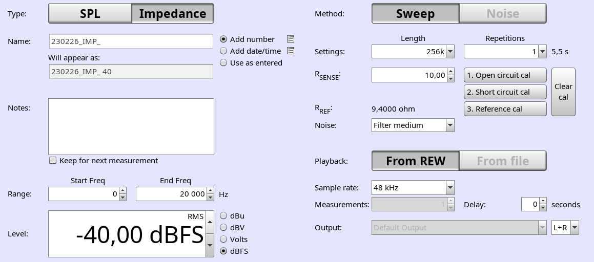

Hello André,
To give a follow-up to your impedance measurement, I did some impedance measurements today with REW and the sound card I have (an old Audigy2NX). Not too bad. I did it with one DAEX25FHE-4. It confirms the data sheet (voice coil mass, inductance, compliance). What is unexpected it is the spikes on the measurements. To be investigated. If somebody has a clue..?
Hi Christian,
Even with a bit of interference, those measurements are very nice. Do you know if your sound card is DC-coupled? (it certainly looks like it is!)
Those spikes seem to line up with 50Hz mains hums and their harmonics. Silly question, but are you using shielded cables? A single common earth through the whole system? Are you measuring the devices on your table-top, and is there a fan or a computer on the table-top which vibrates it slightly? umm... l lights...some kinds of lights cause all kinds of mains interference.
Long time ago that I haven't considered the performance of this card. It is an old soundblaster Audigy 2NX. The RMAA tests I found say -0.6dB @40hz. Where I am sure is that I ran the 3 calibrations steps of REW (no load, short circuit, known resistance)
Yes spikes are mains related by some way. The quality of the cables might be a question as I use those jack to RCA cables available in any supermarket. A circulation of current through the parasitic or physical capacitors of the mains to DC power supplies is a possibility.
The only possible fan is the one from the laptop. All the devices are on a wood table.
I will run additional tests tomorrow to sort among all those possibilities.
Thank you
Christian
Christian the cheap shielded RCA cables are fine as long as they are shielded.
In any case, looking closer, those harmonics go too deep for it to be caused by straight mains interference. And there are no even-order spikes, they're odd -order, which implies 50Hz square-waves, or badly-smoothed power supplies?
I also found that mounting my drivers (with sticky stuff) on the work-table with the computer on it definitely picked up fan vibrations, as well as any other loud noises in the background when doing impedance measurements. I was surprised.

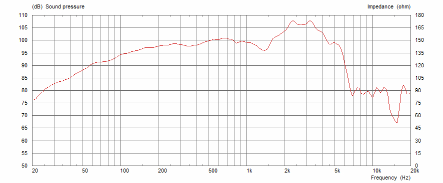

I was thinking of building something like this guitar speaker for my friend.
What sort of frequencies would a guitar speaker have to cover ?
Steve.
Hi Steve,
Interesting question. The easy answer is 100Hz - 4khz or so. Of course that's only a fraction of the answer. If you've ever heard a guitar, electric or acoustic, playing through any wide-band, flat-response speakers, then you know it sounds bad. Very bad.
Basically acoustic and electrics both have audible information below 100hz and well over 5kHz, but their aural fingerprints have completely different 'shapes.'
The nitty-gritty... Electric and acoustic guitars are generally tuned the same, and they play the same notes, and they generally have the same length fretboards, and the same number of frets. Generally. But they sound vastly different, they have different spectra, and are played differently to each other. A Gibson will not sound the same as a Fender Strat will not sound the same as a Telecaster. And they're all electric. And they all "like" different amplifiers—A Vox AC30 sounds completely different to a Fender Twin Reverb sounds different to a Marshall stack even if you stick (the holy-frail) Celestion GK12 speakers into all of them.
Say nothing of acoustic guitars where a steel-string acoustic is as different to an electric guitar as it is to a nylon-string guitar.
I was surprised when I saw the DML guitar speaker.
The problem is that a DML panel has no break-up nodes. Or maybe it's ALL break-up below co-incidence. I dunno. If one uses DML for acoustic guitar, then that should be fine because one does not normally over-drive an acoustic guitar amplifier (the guitar itself feeds back too easily and too low in frequency.)
But electric guitar speakers are made to over-drive. Classic rock guitar speakers, like the Celestion GK12-100, have cones which are designed to break up progressively under high wattage drive.
But maybe a DML can be used for electric guitar IF all of the over-drive comes from the pedals or from the amp itself (if it has a carefully-designed output stage that delivers the correct type of distortion.)
Having said all that, maybe there is a place for DML guitar speakers. The DML limited-bandwidth issue is not a problem, and actually fits nicely with acoustic OR electric guitars. You don't need flat response, and in fact, different types of colour in the speaker sound might make it attractive to different styles and players. The only thing a DML might need is a smooth, low-Q presence peak in the response say, 6db up between 1,5khz - 3.5khz or so. Electric and acoustic will both benefit from this.
Other than that, the amp has to have decent tone controls -- bass, mid & treble -- for the player to get his own sound easily. I'm not sure how DML panels will respond to being over-driven. Maybe that's something worth checking.
Here's the Celestion G-12K guitar speaker response. They are mostly in open-backed cabinets, so that's probably what you would hear firing at you from the stage.
