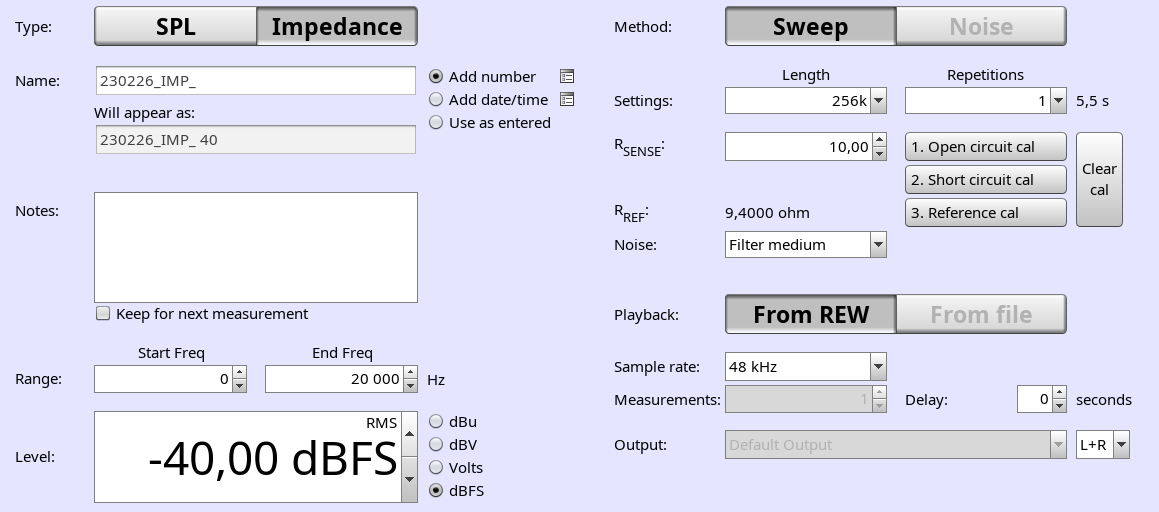

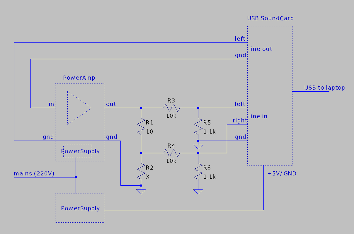

Christian, Those resistor values are very high. I think you might be picking up noise from there. I would try keeping resistor values to below 1k, preferably below 100r if you can, and drive them from the headphone output for a better drive voltages (the headphone output should be able to drive 32ohms.) The higher your measuring system impedances are, the more susceptible they are to interference.Thanks André. Paul pointed the same square waves possibility. Next step is to have a look with the spectrum analyzer.
About the mechanichal coupling, REW help warns also about it. Good to know it is a reallity. There is a filter available to make a noise reduction (see below)
Having said that, I think I've just realised why I was getting weird readings below 10hz on my system!! 🤦♂️ I suspect it's because the headphone output must be high-pass filtered, and my resistor values might be too low! (I have not investigated yet.)
If you do test lower value resistors on your test rig, and then get the same low-frequency wobbles on the impedance curves as I did, then we will know for sure what the problem is.
It looks like there has to be a trade-off between noise compatibility and low frequency capability.

André,Christian, Those resistor values are very high. I think you might be picking up noise from there. I would try keeping resistor values to below 1k, preferably below 100r if you can, and drive them from the headphone output for a better drive voltages (the headphone output should be able to drive 32ohms.) The higher your measuring system impedances are, the more susceptible they are to interference.
Is there a misunderstanding because of the coma in the screen shot? The set up of my laptop being "French" the decimal separator is a coma instead of a dote but strangely, the language is English. Confusing? Below a schematic of my set up. The serial resistor is 10Ohms. I have voltage dividers to protect the line input. The power amp internal supply is a classical transformer, the 5V power supply for the soundcard is a switching one.
The today investigations shown the RCA to jack cord connecting the line in is probably badly shielded. I replaced it by a better one but it is not the main cause. More investigations needed.
The SoundCard having an headphone output, I could simplify the circuit... if this output is accessible to REW under linux! Or use an extra USB supplied DAC that I use generally for FR measurements as source with an USB mic.
