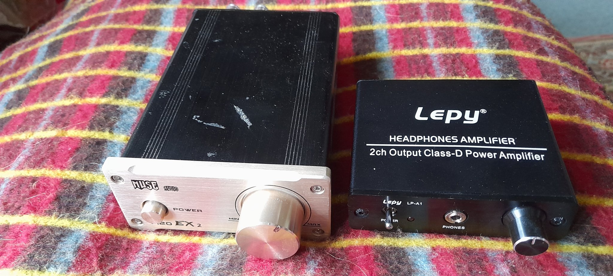

I thought that my muse digital amp was small 😄

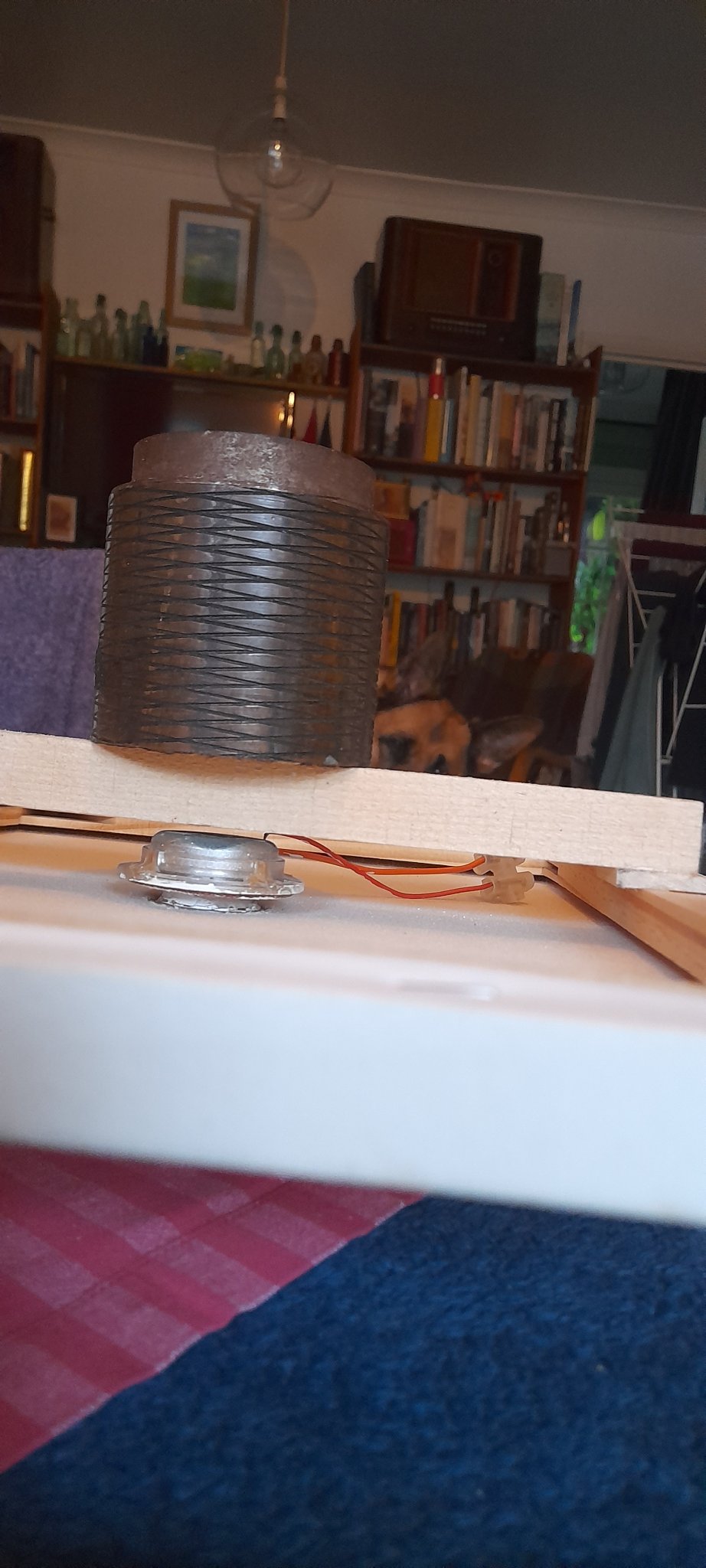

in the meantime i did a recording of my canvas panels with cling film on the front surface.
they have plenty of detail and sound very nice.
the exciters are not braced at the back yet, so hopefully i will be able to turn them up a bit more, but i think they are good enough to let my friend have a listen to them and see what he thinks.
if he likes them i can build him something more to his needs, he has not a clue what to expect as yet.
steve.

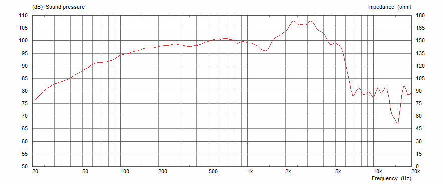

Here's the Celestion G-12K guitar speaker response. They are mostly in open-backed cabinets, so that's probably what you would hear firing at you from the stage.

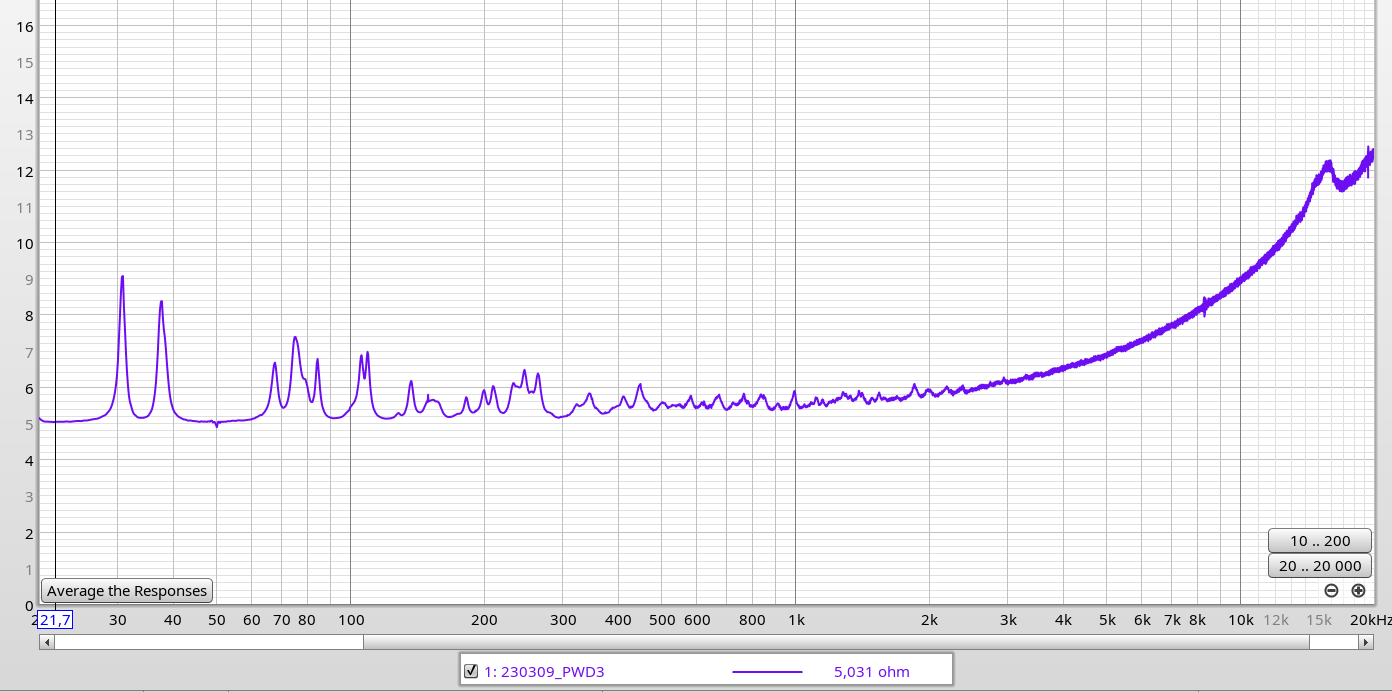

Hello
Just to share a new impedance measurement.
The quality of the measurement was improved compare to the previous one. Here the source is an USB DAC able to drive low impedance headphone (USB Audiophonics Sabre) that feeds a 100 Ohm resistor (see REW doc). The measures are sent to the line inputs of my old Audigy 2NX with a short shielded cable. The result in noise is just acceptable probably because of the 5V switching supply of the Audigy. The laptop is on its battery.
Below the impedance of one of my 3mm poplar plywood panels. No conclusion from the measurement for now. The goal was to have a set up with less noise and to have a first view of a panel impedance.
Even if the plywood is relatively heavy and damped (not so sure!), there are many "spikes" on the impedance curve where resonances are.
