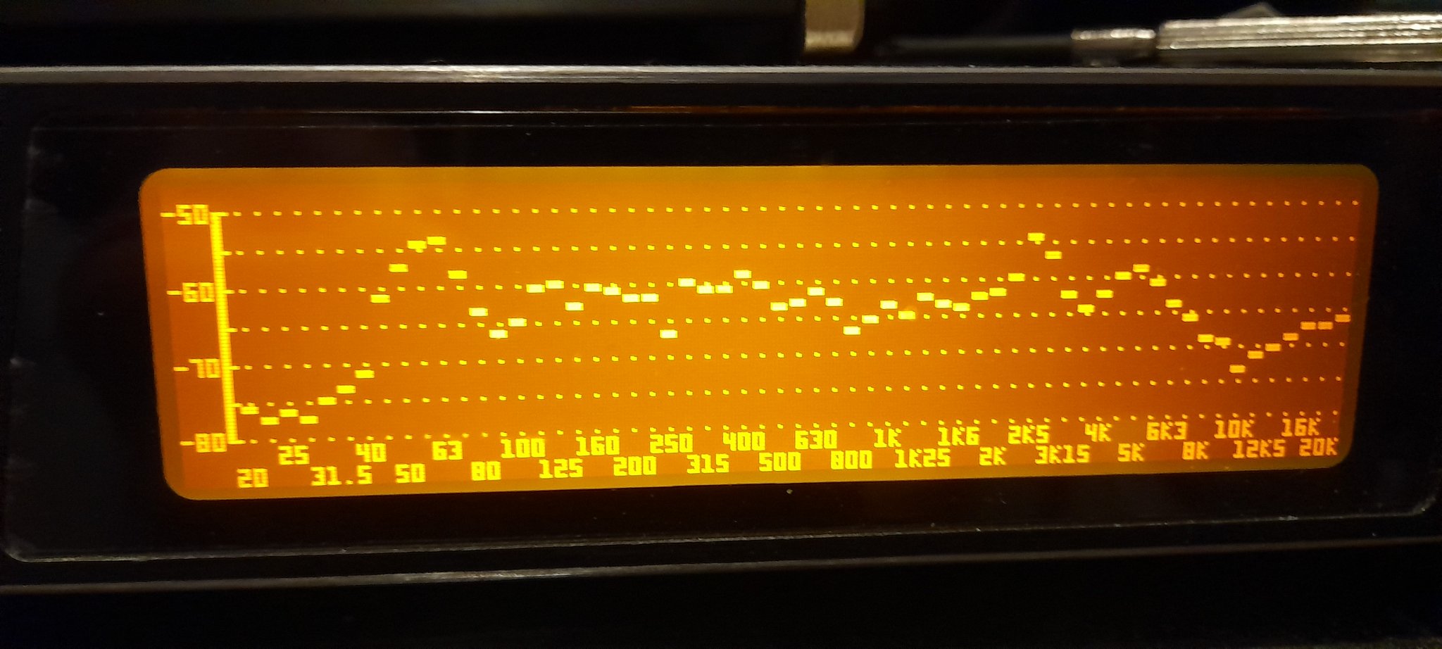

I have removed the second exciter and have placed it on the front of the panel so that the two exciters are in push pull mode and are acting as one exiter.There is no 'comb effect' when multiple drivers are placed on the same DML panel. These are not pistonic drivers in a fixed baffle. Multiple drivers properly spaced on a DML panel should simply activate more modes and might give a smoother response.
The comb filtering has now disappeared !!!
with cone speakers on a baffle, the comb filtering only travels through the air.
with two exciters attached to a dml panel ,the comb filtering travels through the panel itself and also in the air.
My exciters are pistonic in motion ( push pull) this drives the area of the exciter in pistonic motion ,tectonic call this the primary drive area.
For the cleanest sound and spatiality I find a single exciter on a panel sounds best for me.
steve.
This is a plot of the two exciters in push pull mode .
As you can see the frequency response goes a bit awry above about 2.5k , this is because of the exciter body in front of the drive area.
But below the 2.5k point the response seems fine.
I was playing some loud music last night and it look a lot to get the exciter warm.
This worked far better than the two exciters side by side as they are now working together as one.
They also don't seem to get so hot, but I need more listening to be sure.
The down side is there is now a harshness to the sound above 2.5k which I would not be able to put up with.
To do this properly I would have to join the two exciters together for low frequency use somewhere Below 2k, sub use probably ?
Hopefully a more powerful driver of some sort could drive the low end below the 40hz point ?
