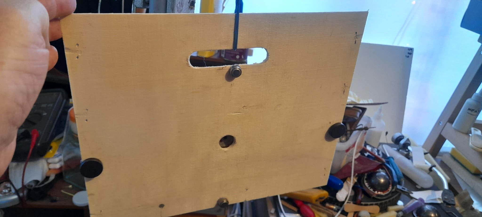

sorry for the delay i have been having problems with my phone and the computer as usual did an update and crashed.
this panel is 11inches x 9inches ,i used a brick wall OX at 100hz to block any low frequencies .
i would use the points i have placed the weights to mount the spine ,probably just the two large weights(areas) will do.
this would be the cheapest and easiest to build for testing and probably more robust than the canvas panel suggested by jaxboy.
but you could always glue it to a panel if more LF is needed t a later date ?
the dog started barking ,but i decided to leave it in as it gives more of an idea as to the volume.
