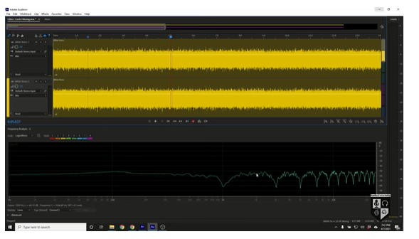

Leob.Nice link. The part starting at about 9:10 is the best part, as it shows what comb filtering would look like with white noise, or with a sine sweep in REW. That is, like the figure below, with sharp nulls at regular intervals.
I've done a fair amount of measurments with single exciters and with pairs of exciters, but I've never seen a frequency response that looks anything like that, with either single or multiple exciters.
If two exciters really cause comb filtering, such a response should appear when two exciters are used, then disappear when either is removed, right? Seems easy enough to test:
1. mount a single exciter, set the mic at a reasonable distance from the panel (1 meter or the like), and capture a frequency response.
2. mount a second exciter, and capture a second frequency response.
3. See if the second measurement looks like the figure below, while the first does not.
Right?
Whoever is willing, please try it. I'd especially be interested to see measurements that shows comb filtering with 2 exciters, as I've never noticed it myself. That said, I never really looked for it before, so I could possibly have missed it, though it seems it would have been obvious.
In the past, I think Steve has said that if he brings the mic close to the panel and moves it around, he sees "the waves move around", and cited that as evidence of comb filtering. But actually, that is only evidence that the panel is modal, not evidence of comb filtering. When micing close to the panel, there will be peaks in the frequency response at modal frequencies which have antinodes closest to the mic. As you move the mic around the panel, you move the mic closer to other antinodes (corresponding to different modal frequencies) and farther from the original ones, hence the peaks in the frequency response move to new frequencies. Hence, such "waves" are to be expected for any DML, regardless of how many exciters it has, and not evidence of comb filtering.
Eric
once again you are miss understand and miss quoting me.
these are not random peaks and troughs throughout the panel , but are a pattern of waves that move up and down in frequency as you move the microphone between the exciters and away from the exciters.
This does not happen with a single exciter panel.
It is easily seen using a microphone and pink noise.
This you can do yourself .
I do not really want to have to glue on another exciter again and do a three second video just to prove this.
Or set up a YouTube account for a longer video.
If I did show this response, I am still not sure you would actually believe my results?
Steve.
