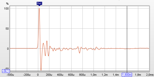

@Veleric. Eric in the papers I have read I get two perspectives on impulse. Azima claims a very fast rise time and a low level but extended decay. From memory he claimed the decay signal was random and therefore did not have a significant impact on reproduction. Again from memory he was claiming circa 25 us for the impulse rise time.
A second paper from the Acoustical Engineering Society claimed a much longer decay time and claimed this carried a significant distortion component. Sorry I know this doesn’t help but it suggests to me that the test examples used were probably quite different. What this suggests to me is that a good performance is possible but not automatic or garunteed.
Yes in Azima's widely circulated paper that was printed in Audio magazine he stated: "[FONT=Verdana, Arial, Helvetica, sans-serif][SIZE=-1]But the panel itself operates wholly in resonance of course, which is one of the features of NXT that most concerns audio people raised to regard resonance as anathema. Doesn't all this resonance in the panel colour the sound unacceptably? The surprising answer is no, it doesn't, because of the highly complex nature of the panel's vibration. The impulse response of an NXT panel (Figure 4) displays a long resonant `tail' which would damn any conventional loudspeaker, but in fact the sound quality has extraordinary clarity and transparency confirming the measured flat frequency response (Figure 5). [/SIZE][/FONT]
geo,

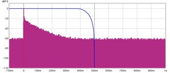

Thanks, I did not recall that part of the Azima paper.
It just reinforces my feeling that my own impulse measurement is somehow flawed or different.
Here's the REW impulse response I measured for one version of my DML, and it's typical or virtually every DML measurement I've made, regardless of the panel material, boundary conditions, exciter position, etc:

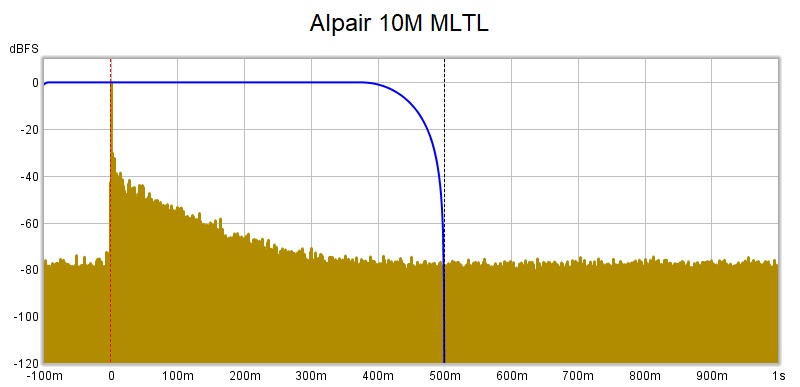

And for comparison, below is the impulse response of my Alpair 10.3M MLTL. A bit different but still nothing like what Azima or XRK is showing. Is it my speakers? My room? My measurement settings?
![Alpair MLTL Impulse Response.jpg Alpair MLTL Impulse Response.jpg](https://www.diyaudio.com/community/data/attachments/739/739272-b8182eb82168e08841198959072fb1a1.jpg)

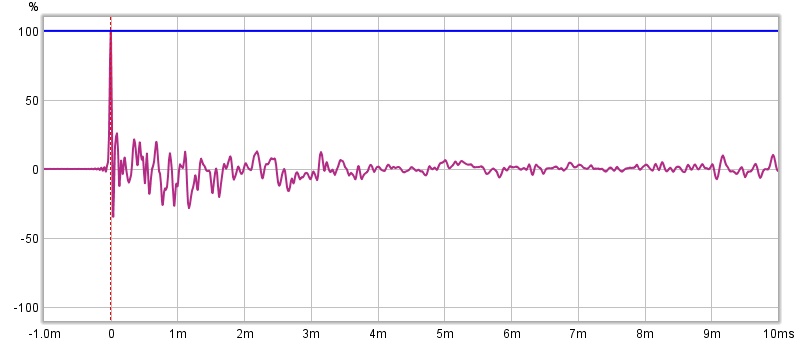

![sureply impulse response.jpg sureply impulse response.jpg](https://www.diyaudio.com/community/data/attachments/739/739268-a29958037a77c99714a6aec2a9c81e14.jpg)

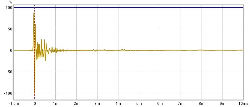

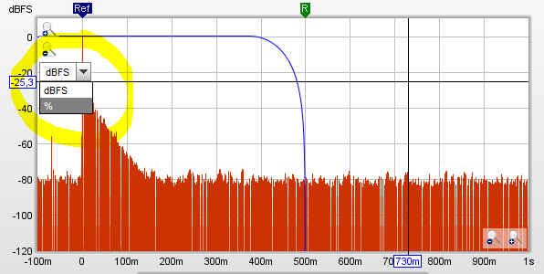

.....My measurement settings?.....
Hover mouse pointer into the yellow marker area as first visual below and pick "%" sign, then adjust vertical and horizontal scales to something usefull coverage, BTW the two IR below is accurate the same session but use a different setting for presentation : )
