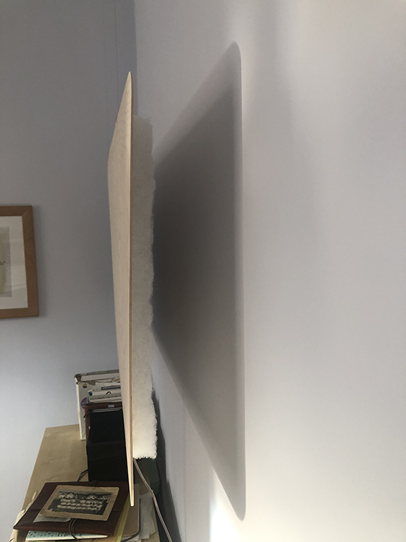

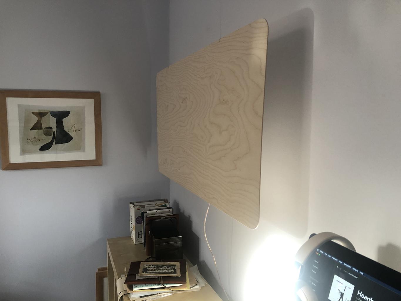

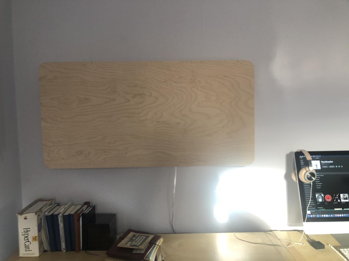

Thanks for the photos Burnt. I did not realize the panels were that close to the wall and still work their magic!@twocents
These are the pics of the London panels
Burnt
