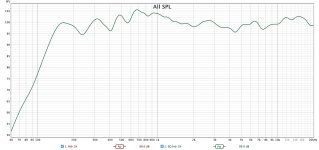

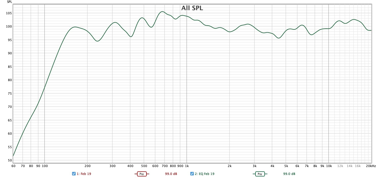

On FR sweeps I don't know if this will help but this is an REW FR sweep of my latest build. 3mm Poplar ply 300 by 1200 with foam supports on the long sides only.Yes indeed...a more systemised listing would be great... Christian has contributed a lot in this regard.
Above 10k...I was searching for some of my sweep tests just now to show you what can be achieved, but I realised that they were lost when I had a Windows 10 failure and I had to do a clean install... I'll have to do some repeat testing, but I'm achieving solid results up to about 16-18k
Steve will/could also attest to that
That's some decent top end Burnt.my latest build
