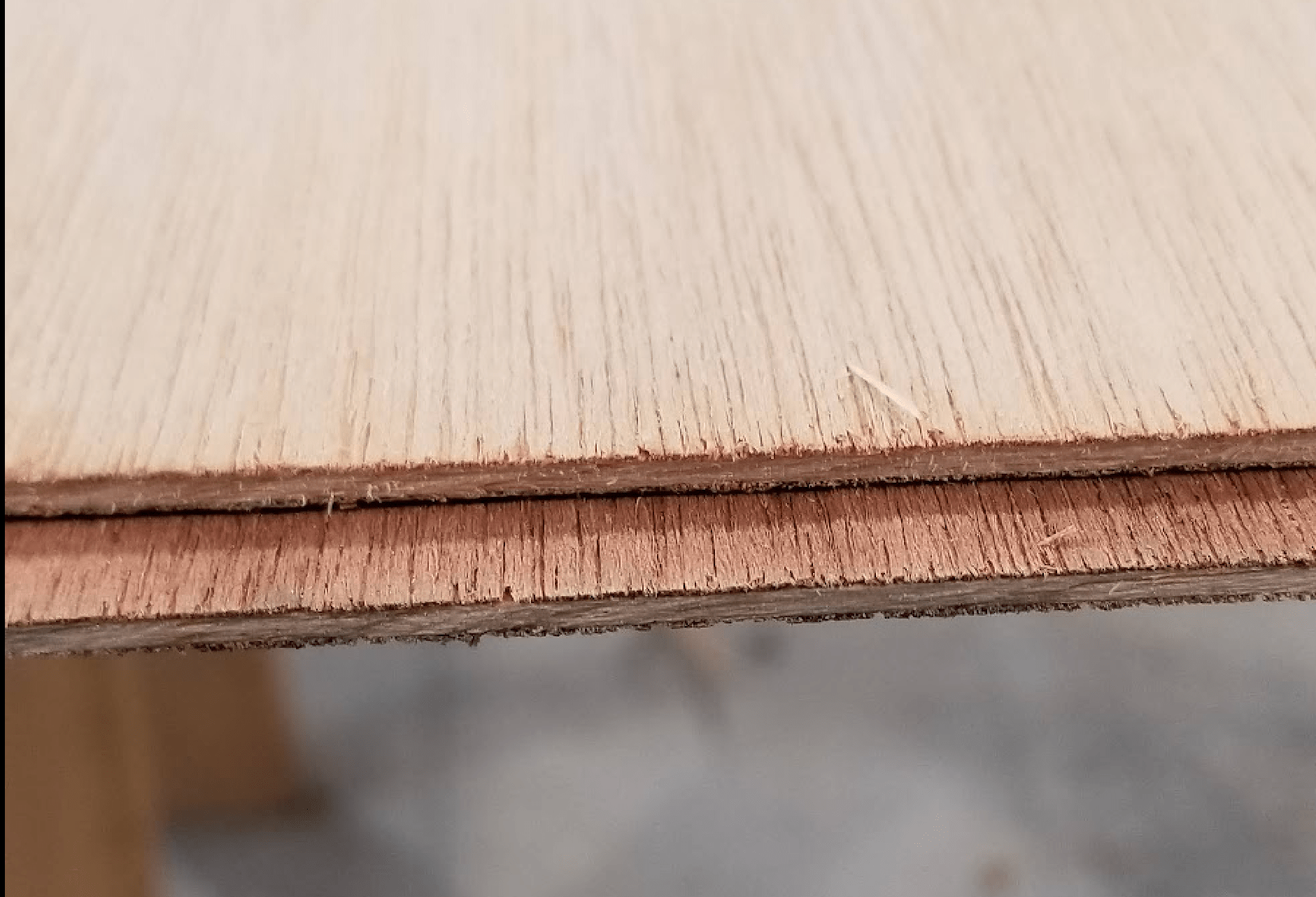

Uh oh... That sounds a lot like what I purchased for the 24"x96" DML build. It is 'hardwood' three-ply plywood, 1/8" thick (1/8" = ~3.2mm), bought from a U.S. chain store (Home Depot); it is from Indonesia according to the label and is definitely not quite heirloom furniture quality. I have been unable to identify the wood species.
This is the edge/end of two stacked pieces. Does this look familiar? At any rate I'll 'tap test' it tomorrow and see what it sounds like.

Hmm... It doesn't look great does it.. On first sight I wouldn't be holding high hopes for that material.
Looks to me like it could be what is termed 'overlay grade' ply meant to be a surfaced with a paper or vinyl facing and used in the RV industry etc as lining. Lightweight, cheap, and definitely non-structural
The faces could be Meranti which is a soft hardwood, and the core is likely to be Falcata. I believe the core will control the performance of this panel. I don't know if anyone's tested this material but it's very light and will be soft..
Only time and testing will tell... If possible I'd buy a real Poplar piece and compare with this material through testing before the final build.

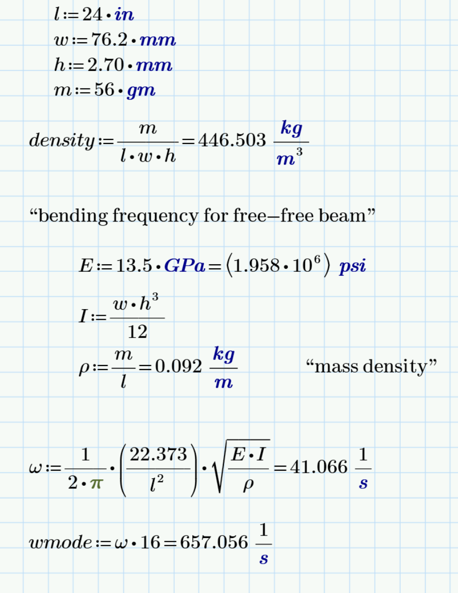

Yep Luan, familiar with that. This is not how it was sold but that could be it. At any rate I cut a sample (76mm wide x 610mm long x 2.70mm thick), suspended it vertically, and I get a definite ring. I am going to run a few calcs and see if I get reasonable properties.
Luan is another name for Meranti, or vice versa ... That'd be the face material with the Falcata (Albasia) core... Pretty certain but....not 100%Dude,
That is what we've always called Luan, or cheap paneling or door facing. I think the wood is whatever is available to the manufacturer at the time.

So here is what I came up with...
density = 447 kg/m^3 (on the light side but reasonable - falcata is very low density, like balsa, and the center layer is most of the volume)
E = 13.5 GPa (on the higher side for woods, something like 10% moisture content birch?)
Density should be fairly accurate. E is estimated (crudely) using a free-free beam frequency equation and then looking for a mode (octave multiple of the calculated fundamental) that matches what I measured. The fact this is a composite of different woods throws off the property estimations versus actuals of course. But, overall, this looks like it has good effective stiffness for its effective density. Damping is another question but I am not set up to measure that.
MathCAD worksheet
MathCAD worksheet
Ok... Luan has a density of around 705 kg/m3. If the faces are about 0.4mm each as suggested previously, then the faces contribute 0.56kg/m2.So here is what I came up with...
density = 447 kg/m^3 (on the light side but reasonable)
Working backwards leads to a core mass of 1.43 kg/m2 , and for a 2.4mm thickness gives a density of 361 kg/m3, very close to the Falcata density of around 320 kg/m3.
QED...?? maybe

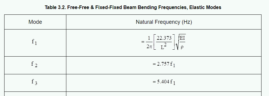

Deude,E is estimated (crudely) using a free-free beam frequency equation and then looking for a mode (octave multiple of the calculated fundamental) that matches what I measured.
Using the natural frequencies of the beam or panel is a great way to determine the elastic modulus (or moduli). But how did you measure the natural frequency you measured and how did you determine that it was the 16th mode? You may have seen in the other thread that it is not to hard to measure the natural frequencies with a frequency analyzer and a microphone. But, be careful in your calculation of elastic modulus. unlike the natural frequencies of tensioned strings, the natural frequencies are not integer multiples of the fundamental. Rather, they are a rather inharmonic series of overtones, as in the table below. You can actually use the irregular spacing to help figure out which modes you are observing, since adjacent modes should have a ratio that is unique to their mode orders.
Eric
I used a cell phone app RTA and multiple measurements with a peak hold to check repeatability. The pitfall then would be the integer multiple harmonics.
I am taking additional measurements using a cantilever mode (and equation), and plucking the unsupported end, using the same RTA, but so far the results are not reasonable. So there is some measurement uncertainty here.
I also tried simply supported beam deflection measurements but the problem is my Mitutoyo runout indicator has a lot of stiction force compared to the beam deflection load and thus I cannot get a good measurement.
So, I am at the point where I am inclined to build and test since I do not want to get mired down in characterization testing. It seems like others have reported good results with 3mm Luan type ply so I do not think I am doomed necessarily.
