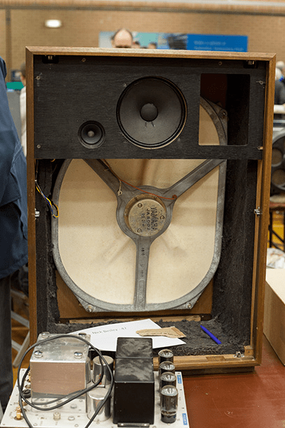

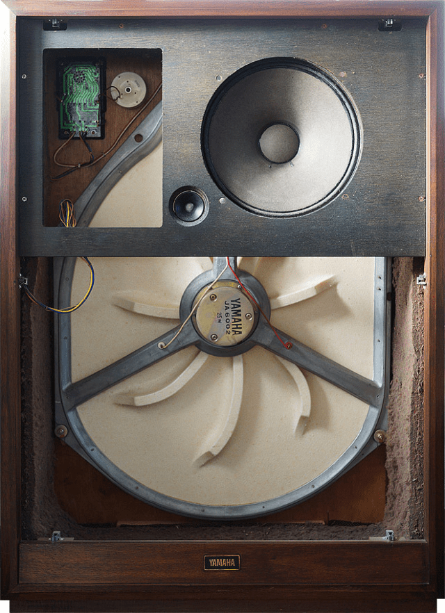

I provide YAMAHA information for your reference
I don't know if this can help you
Because about a while ago I found out about OB's information
I just heard about the YAMAHA NS series from my friend
Let me be more amazing about non-directional speakers like OB and DML
The link below has many pictures of YAMAHA NS20, NS30...etc.
I saw it at a friend once and it was just a big foam board
Then it has very small XMAX
Now I think YAHAMA seems to be the forerunner of DML
But YAMAHA does not seem to continue to study this area
They seem to spend more time on cone speakers
Hope this information is helpful to you

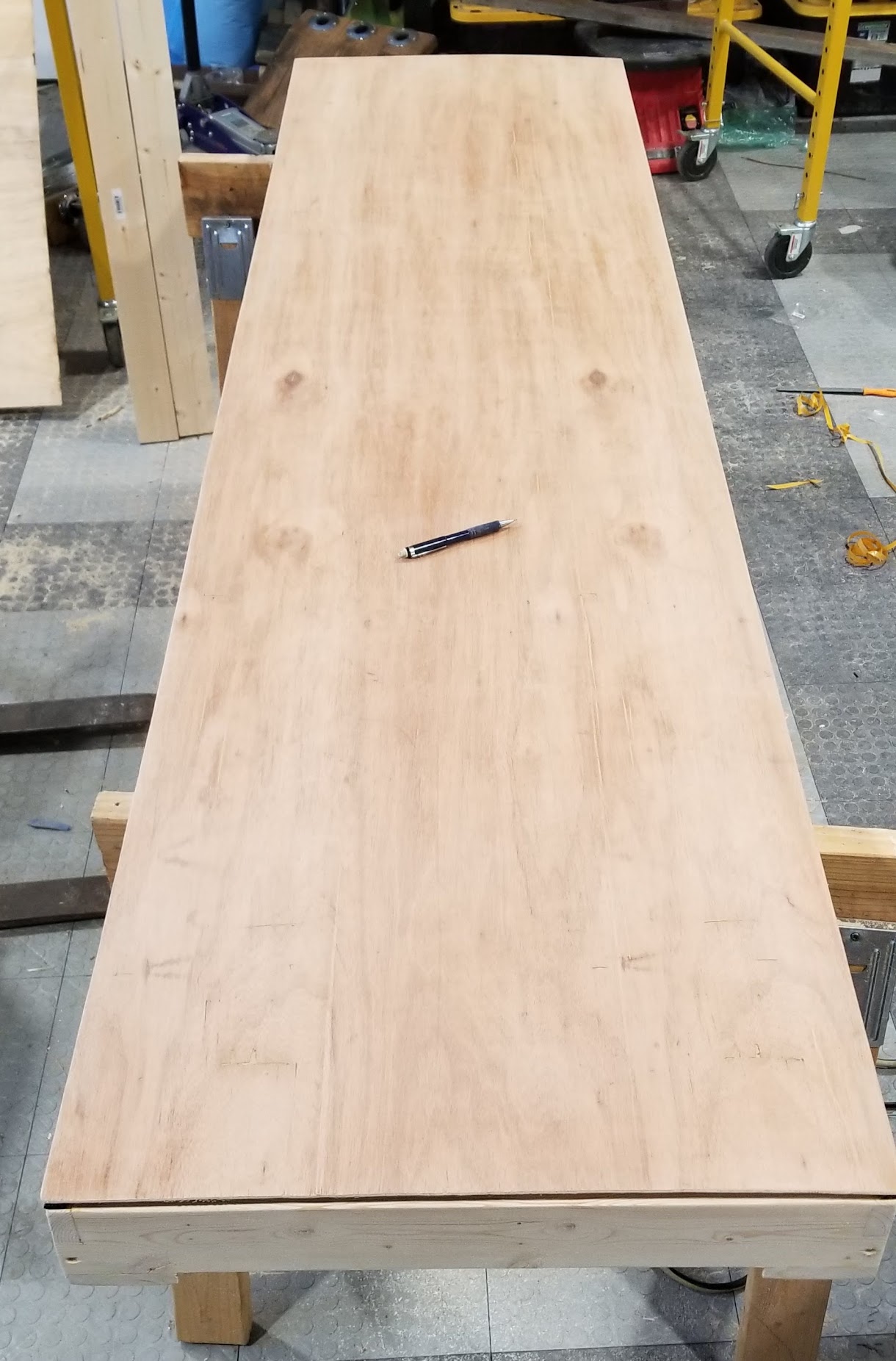

Speaking of which, here is the first panel on the frame with the EPDM foam surround. The exciters will be arriving this evening so I'll be testing soon. The mechanical pencil is included for scale. Dimensions are 24" x 92"
Building my plywood panel, I made also the choice of the grain in the direction of the long side. The 3 ply has an important difference of stiffness according to the direction. The high geometric ratio seems to be a factor to smooth the FR but in this case, the difference of stiffness will reduce the effective ratio.
Any opinion?

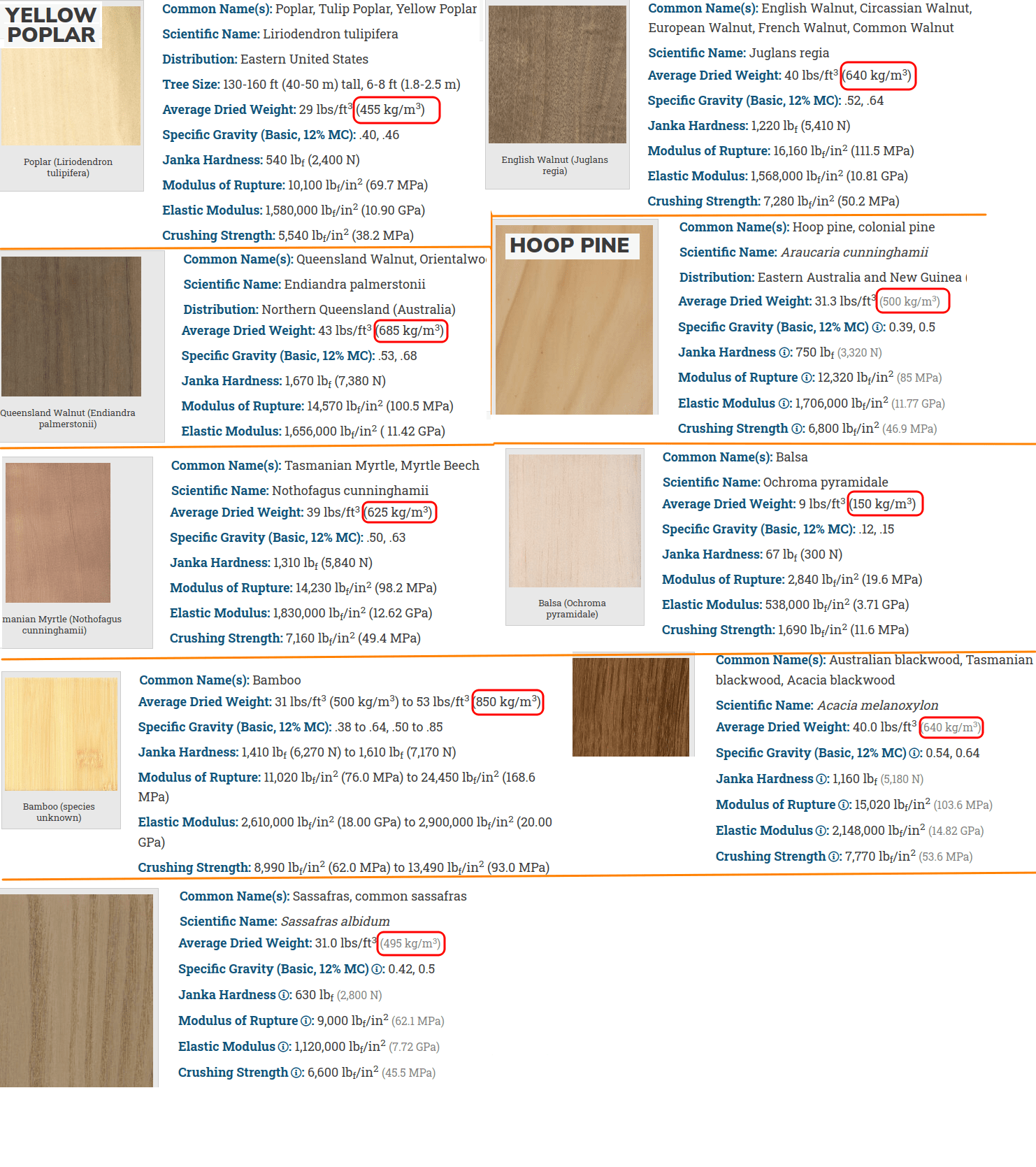

Eucy , Was the Tasmanian Blackwood panel you used in a 3 mm ?My answer to the good hf extension is Poplar vs Birch. Poplar SG is around 0.4, and Birch can be between 0.55 to over 0.7, assuming the ply core is also Birch (may easily/commonly not be).
Lighter is better for hf.
Perhaps interestingly, some while ago I tested 3mm Tasmanian Blackwood panels which are harder and denser than Poplar by some margin, and as expected, the efficiency was down compared to Poplar, but it produced perhaps the most even frequency response I've seen so far, maybe because of the damping factor of the material.
When I get time I intend to revisit those panels.
Eucy
I recall it was available in a 1.5 mm thickness so that could offset the density / efficiency loss.
Plyco also have a Tasmanian Sassafras in 1.8 and 3.0 mm , Sassafras has a SG of 0.4 - 0.5 and density of 495 kg3M versus Poplar being 450 kg3M.
The Sassafras has better grain aesthetics than Poplar unless you happen to be living in Sveden or Norway where white bleached timber is the fashion.
TBD... I am still building these but I have four of the Dayton DAEX32U-4 ready to go. I plan to use two per panel.Which exciters did you choose and how many per panel ?
What thickness EPDM ?
I walked around our big box store last night trying to find EPDM foam in a ~ 8 mm thickness with adhesive both sides but they had nil , thats my "theory for the day" to have more compliance / less damping from a thick softer foam compared to VHB tape.
I used this EPDM foam on the surround. It is far thicker than the VHB tape (which I also have) and more compliant so it should allow much more movement at the edges and provide a lot of damping.
Frost King E/O 9/16 in. x 5/16 in. x 10 ft. Black EPDM Cellular Rubber
OK... so...
After some quick experimentation with pink noise and music I am noticing a few things...
- I am using the 3/5 2/5 position as a baseline with the 3/5 along the long edge. In this position the sound is highly localized and does not spread across the panel. I need to flip this around and try the 3/5 along the short edge I suppose.
- As mentioned in previous posts, small movements make a big difference. I can hear changes in phase and frequency almost continuously as the exciter moves, as well as changes in how broadly the response is spread (or not spread) across the length of the panel.
- There is a huge difference in audible response depending on whether I am listening on the exciter side of the panel or the opposite side; the frequency range is much broader on the opposite side in a big way to the point where listening on the exciter side while moving its position might be pointless. This is, umm, an interesting problem since ultimately the listening position will be on the opposite side, but I want to be on the exciter side to move it around. I might need to use an assistant to move it around while I listen.
- Trying to keep the panel horizontal while moving the exciter basically means I am lying on my back with the DML frame sitting on sawhorses above me. This adds the effect of the space between the floor and the panel which will color the sound somewhat. I do not see a way around this however until the exciter is mounted, and then it cannot be moved easily of course.
- I am wondering if the panel might have too much damping. Right now it has 5/16" EPDM foam along both of the long edges. I think I may try removing sections of it, distributed of course (not all in one spot), and see what happens. This may be at least part of the reason why sound is localized around the exciter position since total damping will increase with distance along the long axis. I am guessing mode shapes are another part of this if not a big part.
- Starting off with a lot of damping while looking for the ideal spot might be like tuning a TL design in a simulator (Martin's work sheets or Hornresp); the damping is not added until the very end so that the effects of geometry changes while optimizing the design are much more obvious. In other words the damping may mask the changes in response with the movement of the exciter. The obvious problem though is that removing damping (edge foam) also changes the stiffness of the suspension and thus damping and edge stiffness are not mutually exclusive. With a TL adding damping does not alter the tuning (much); it just flattens the resonant peaks (and lowers the port response, killing low end extension).
