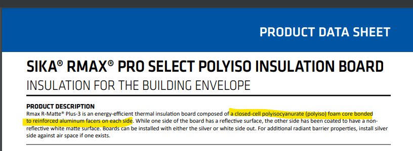

I've never tried (or even seen) R-Max before, but based on the description I found on the Home Depot site, it is not EPS (nor XPS) but rather "Polyiso(cyanurate)". See here the datasheet from the manufacturer. I'm not saying it's good or bad, just that it appears not to be EPS.So I made a side stop at the hardware store this afternoon, specifically Home Depot, who carries 4'x8' sheets of 3mm and 5mm Luan type ply, as well as Foamular (XPS) and R-Max (EPS) both in several different thicknesses (1/4" 1/2" 3/4" 1")

I do think there might be some potential for a wood/foam/wood sandwich. I have tried it myself at least once. It wasn't great but that could have been more due to my poor excecution rather than the idea itself. But a sandwich as thick as you are proposing would be way too stiff. If you want to try something like that, I would suggest something more like a 3 to 5 mm foam core with 0.5 mm veneer for skins.It seems like a 3mm-0.5"-3mm sandwich of carefully bonded ply-foam-ply would work at least acceptably and would definitely be less expensive than a more exotic ply like carbon fiber/nomex honeycomb core/carbon fiber.
I think you should give the 1/2" XPS (foamular) a shot. Not because I think it's so great, but rather because it's really cheap and anybody who's investigating DML's needs to have tried EPS and/or XPS at least once. It's like a rite of passage. The difference in efficiency between PS foam (either type) and almost any other common panel material is so huge. You need to hear what "crazy-efficient" PS foam sounds like to put every thing else into perspective. The 1/2" foamular in my area comes with a plastic skin on both sides that I normally peel off. But you can tried it with and without if you like.I was not tempted to get EPS or XPS.
I'm suggesting XPS (Foamular) over EPS only because I know you can get it easily at Home Depot. Decent EPS is much harder to find in the US, at least in my area/experience. I think HD (or Lowes) carries some, but it was very low density and very soft and not close to what (I think) people have reported good succss with.
