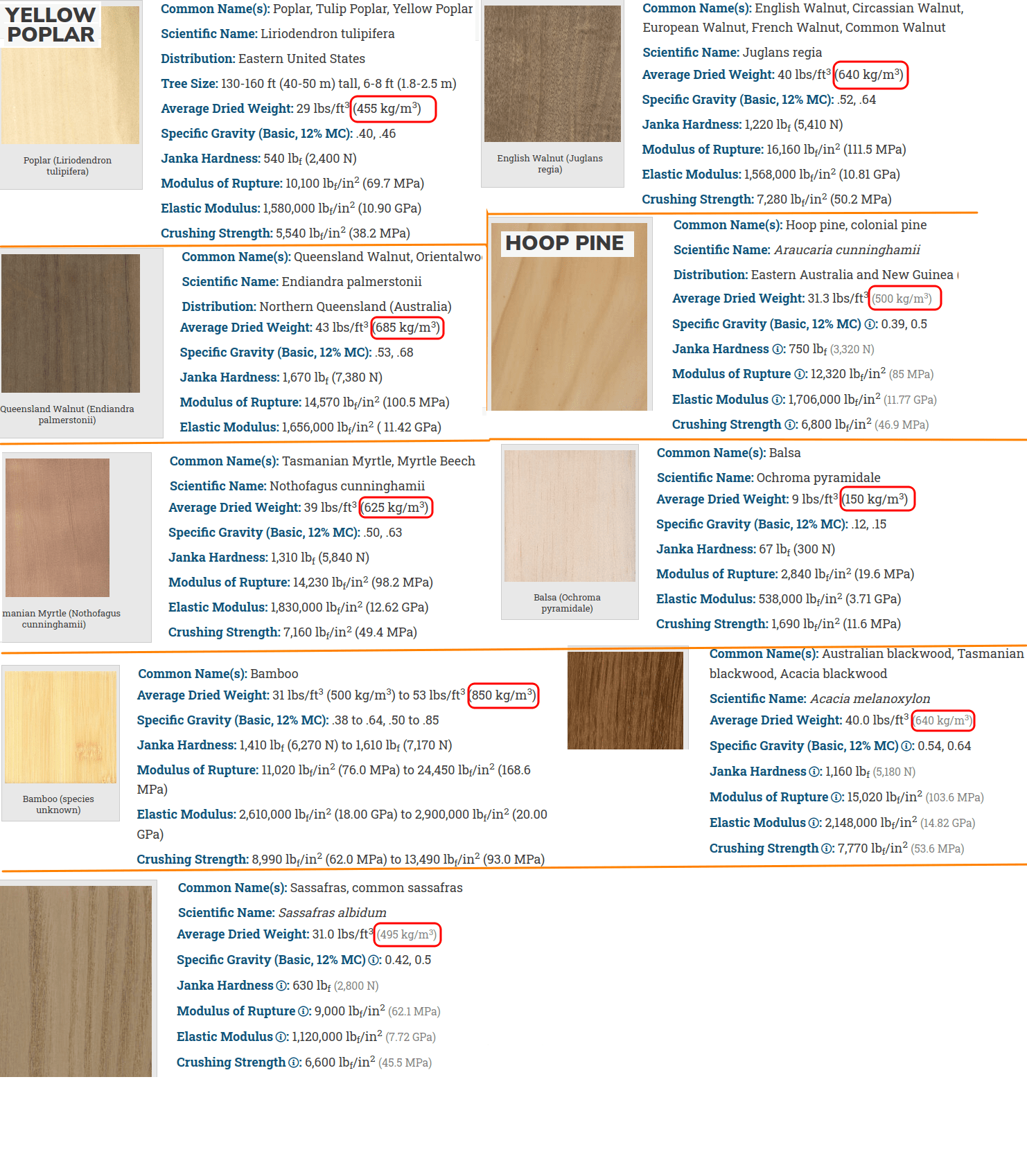

YesEucy , Was the Tasmanian Blackwood panel you used in a 3 mm ?
I doubt 1.5 mm would be stable under vibration at normal panel dimensions but it's worth a try .. May need to be treated more like a membrane in terms of mountingI recall it was available in a 1.5 mm thickness so that could offset the density / efficiency loss.
I tested Sassafras...I tested most of their samples. I also ranked them... Just have to find it all again 😖☹️Plyco also have a Tasmanian Sassafras in 1.8 and 3.0 mm , Sassafras has a SG of 0.4 - 0.5 and density of 495 kg3M versus Poplar being 450 kg3M.
The Sassafras has better grain aesthetics than Poplar unless you happen to be living in Sveden or Norway where white bleached timber is the fashion.

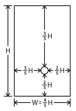

- I am using the 3/5 2/5 position as a baseline with the 3/5 along the long edge. In this position the sound is highly localized and does not spread across the panel. I need to flip this around and try the 3/5 along the short edge I suppose.

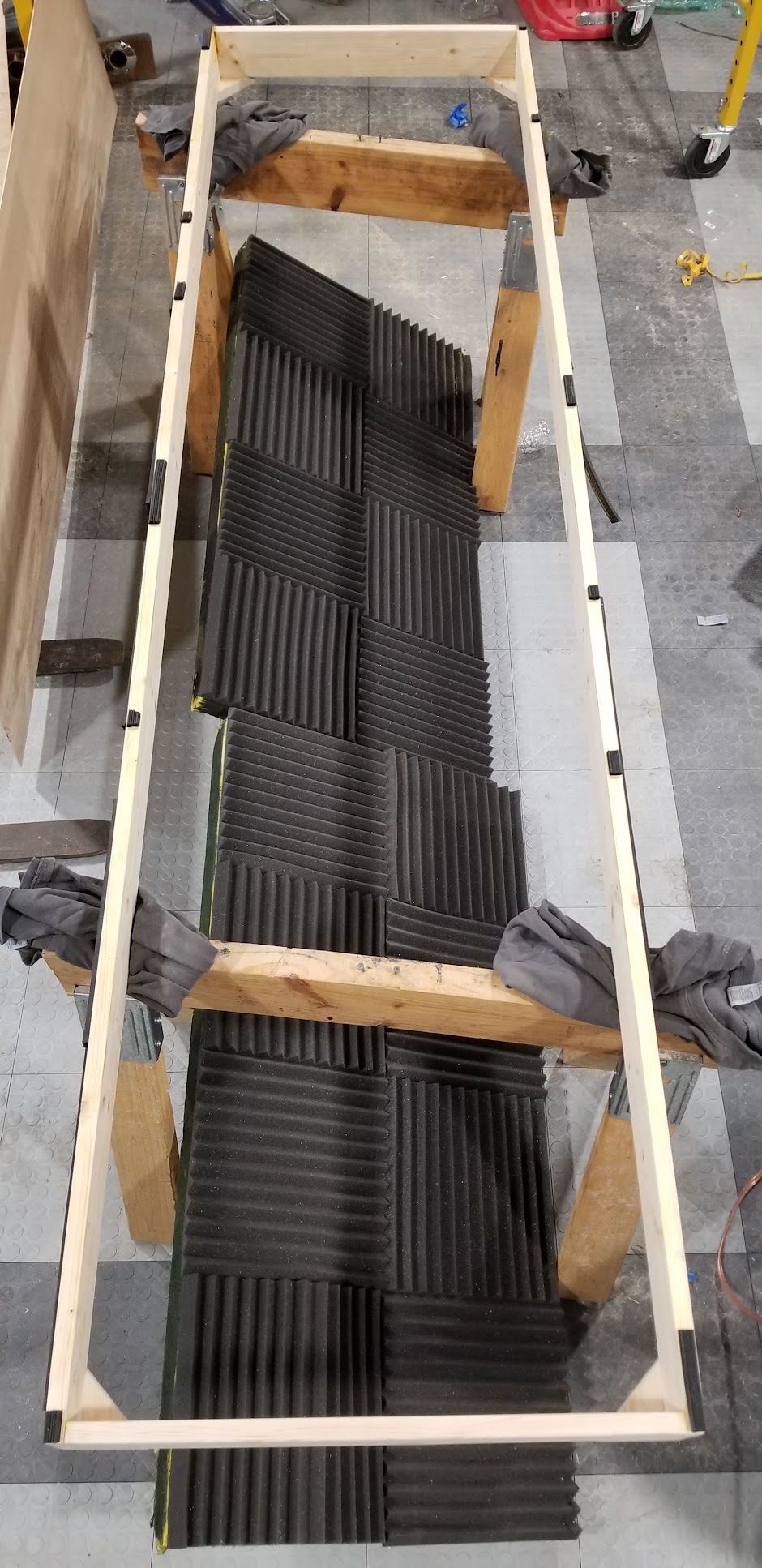

Why aren't you trying the exciter on the top of the horizontal panel??- There is a huge difference in audible response depending on whether I am listening on the exciter side of the panel or the opposite side; the frequency range is much broader on the opposite side in a big way to the point where listening on the exciter side while moving its position might be pointless. This is, umm, an interesting problem since ultimately the listening position will be on the opposite side, but I want to be on the exciter side to move it around. I might need to use an assistant to move it around while I listen.
- Trying to keep the panel horizontal while moving the exciter basically means I am lying on my back with the DML frame sitting on sawhorses above me. This adds the effect of the space between the floor and the panel which will color the sound somewhat. I do not see a way around this however until the exciter is mounted, and then it cannot be moved easily of course.

So the panel is about 15ft^2. Has anybody looked at using the same panel area with different aspect ratios? Dayton suggest taller aspect ratios can be used but suggest this arrangement. They don't mention a max.Speaking of which, here is the first panel on the frame with the EPDM foam surround. The exciters will be arriving this evening so I'll be testing soon. The mechanical pencil is included for scale. Dimensions are 24" x 92"
A ratio of 1,25 against your 3,8, Good, bad or doesn't matter?
That is what I am doing (of course) as it is the easiest way. Exciter on top, moving around the panel listening/measuring for changes. However, the SQ UNDER the panel, with the exciter ON TOP of the panel, is significantly different.Why aren't you trying the exciter on the top of the horizontal panel??
Fair question. There are a few here who deviated from that ratio, and in one of the papers and/or one of the participants here tested multiple ratios and found that the higher aspect ratios tend to work at least as well if not better. BurntCoil's 'Tall Blondes' are high aspect for example at ~3.8 IIRC.A ratio of 1,25 against your 3,8, Good, bad or doesn't matter?

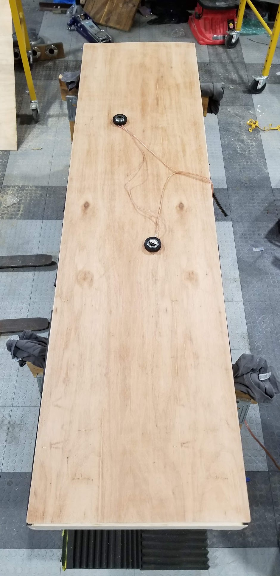

So a bit more quick testing this morning...
At first l gave everything a listen before starting modifications so my memorized basis of comparison was fresh. Distribution throughout the panel was better than I remembered. I started by removing almost all of the full edge damping with a few pieces left of random lengths in random locations (see below). This as expected increased the SPL considerably and the sound was distributed more throughout the panel. I also added the sound absorbing panels shown in both images which seemed to improve the aforementioned discrepancy of above vs. below response. The panels are 2" x 24" x 48" Corning 703 covered with foam triangle baffles.
Then I added a second exciter wired in series. The bottom exciter in the image is in the 2/5 position in length and width. The upper exciter started in the 2/5 position (opposite side) and then was shifted to a position that gave a bit more low end extension. This as one would expect increased the spread of the sound across the panel. The placements look strange in the photo just because of the perspective.
