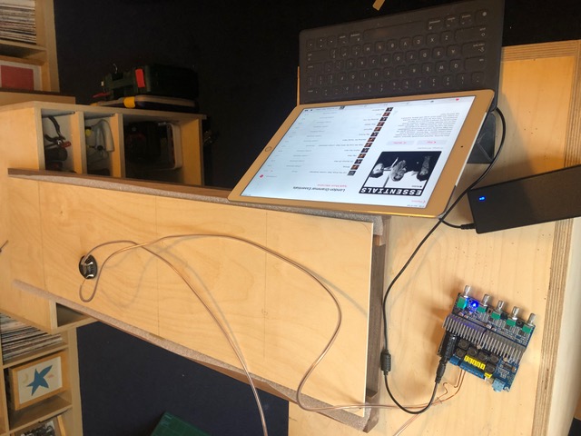

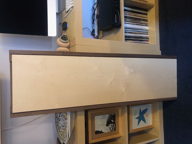

So my brother came round a few weeks back and was blown away by my DMLs. He was so impressed he asked me if I could build him a pair, the only snag being his front room is long and narrow with a lot of windows so there is now space for free hanging panels.
So I have spent some time building floor standers for him and it has been a very interesting experiment. The pictures attached show the first test panel and frame. The panel is long and thin, 1160 by 300, which breaks all the rules. The panel is 4mm ply and the frame is walnut. The panel is attached to the frame using industrial double sided foam tape.
Here are my key learns.
1. A long and thin panel works very well. Despite deviating from the recommended 1:1.618 ratio they have a fine sound with all the normal DML virtues and one surprise…
2. Bass! I get a good output down to 40hz, big fat meaty dollops of bass. Weird!
3. The best exciter position is very different to more conventional panels. I discovered the sweet spot using Veleric’s recommended method supporting the panel horizontally and moving the exciter about until you get the best sound ( Post #645). Thank you Eric, the method works very well!
4. I didn’t bother rounding the panel corners this time. It didn’t seem to matter.
Please engage your numpty detector at this point, what follows is highly speculative

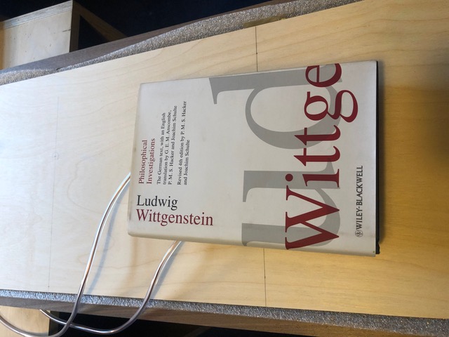

I think the major variable for the better bass output is probably the mounting but it’s not straight forward.
If you read the literature you should get a lower fo for a panel with no edge damping or clamping. A corner clamped panel has a higher fo, and an edge clamped panel has the highest fo.
But, as others have already discovered ( DMLBES, Veleric etc etc) some edge damping increases bass output on DML panels.
I found greater output when the panel was lightly coupled to the frame, literally its own mass plus the exciter. I had to damp the exciter with my finger to stop it moving, but, when I Ioaded it with a book as a reaction mass ( Heavy book in all senses! ) the overall output dropped somewhat. There is obviously a balance to be struck. I am guessing that the ideal is an edge loading that gives very good rotational freedom but also good damping. I still don’t know why this arrangement gives a better result that free edges, but it does on this panel.
The other obvious factor is the unusual panel ratio. Maybe the length allows recreating the bass notes , 1.16 meters is still small for bass, its the wavelength for 295.68hz and even allowing for 1/4 wave that’s still only 74hz. I was definitely getting 40hz and could get output at 30hz using a tone generator.
Adding to the puzzle is that both my free hanging panels are also just over a meter on their longest axis, but bass output is BBC polite rather than JBL large, so that suggests its the frame and damping again. I will try adding some damping to the edges of the free hanging panels, but I believe this has been covered and was rejected before. It might have been the Tech Ingredients crew? Puzzling.
I am still going to use a sub for this build as it will allow a higher SPL, my brother likes stadium rock, and they will still go deeper, he also like Joy Division. But for those who want to try a tall thin DML I am pretty certain you won’t be disappointed.
Hope this helps someone

Hi X, hope you are good.
The bass came as a bit of a surprise I must admit! As you know I have experimented with several panels now but this one has been the best bass performance to date. I like your description as a possible reason, it makes great sense, and also think the edge damping method might be helping by making the panel seem larger than it actually is by reducing the reflection you get from the edges. There is a lot in the literature about creating an infinite panel, thats the reason for the variable angle slots on the DML panels by Gobel. This is highly speculative on my part.
On exciter position I got there by experimenting using Veleric's method. The final position is 155mm from the longest edge and 677 from the smallest. On a 1160mm tall by 300mm wide panel this gives a weird and not very helpful factor of O.516 on the width and 0.583 on the longest which is not particularly rational. Move the exciter towards the edge and the sound loses bass and gains midrange, move the exciter away from the centerish position towards the top or bottom and again you lose bass and the sound becomes brighter. The conventional 2/5th spots which is where I started sounded great to begin with but it became very obvious they were not the best for this design.
At the moment I would use light damping. I used some thick foamed double sided tape. I think hanging from the corners without damping will make the panels 'buzz' if they contact the frame so you will probably need some.
Burnt

Hi X
OK so I could not settle until I tried something. I took the second panel which I have not mounted, attached an exciter and 'suspended' it by holding it by my finger. No frame, no damping. I still got great bass. It's something to do with the ratio. Even more weird but easy for anyone to check out if they think, quite reasonably, that I am losing the plot.
Yrs ( entering ever deeper levels of confusion) Burnt

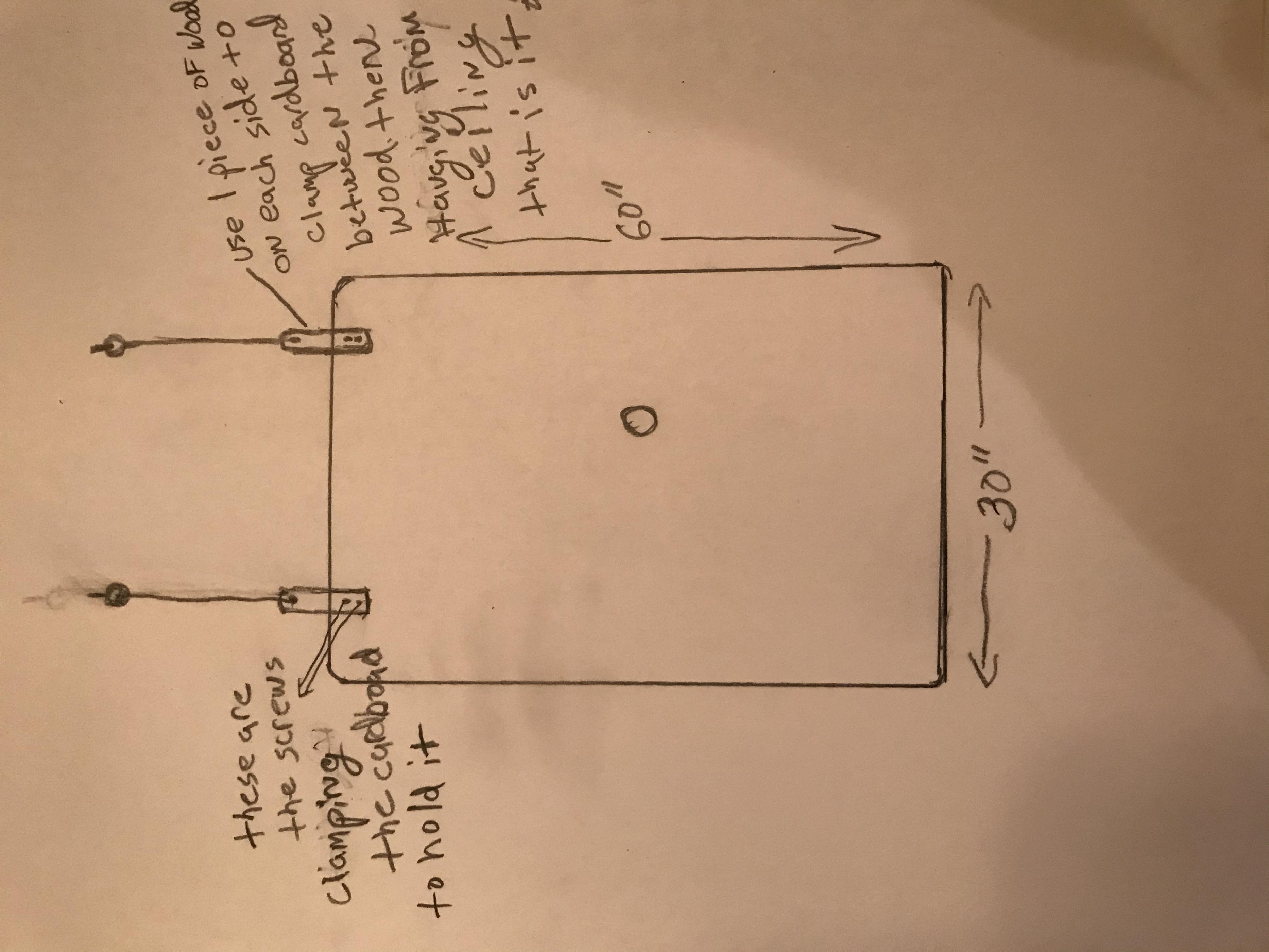

I played with most exciters and tried all kind of materials for the panels
And the most natural sounding by far and away was 3mm cardboard with
A coat of 50/50 mixed titebond wood glue and water applied 1 coat to both sides
Rolled on with 1/4 inch nap.
As for size that I settled with was 30 inches wide by 5 feet long
With the corners rounded over that really helps tame the highs,
The best sounding exciter I used was the Dayton Ultra,
They had great sound I feel I had really good bass down to at least 40hz
The do not need a frame I just used a few pieces of 1/2 inch thick poplar
About 1 inch wide by 4 inches long a these are put used like a clamp on upper left and
Right of the panel to suspend them just bring the wood pieces about a 1 1/2
Down over front and back of panel and then screw right thru the
Front piece of wood thru the cardboard grabbing and pulling the 2nd piece of wood tight
Against cardboard panel. Then put a small hole at top of wood and run some coated solid
14 gauge wire thru and then attach that to some eyebolts screwed into the ceiling.
I used a baffle step compensation it makes a huge difference in Bass output I settled on 1.5 MH 16 gauge iron core inductor with 5 ohm parallel.
Also there is a ratio for optimal mounting the Exciter
I think I have it in my files somewhere it is a Monacor article on it.
Here is the build I found to work best.
