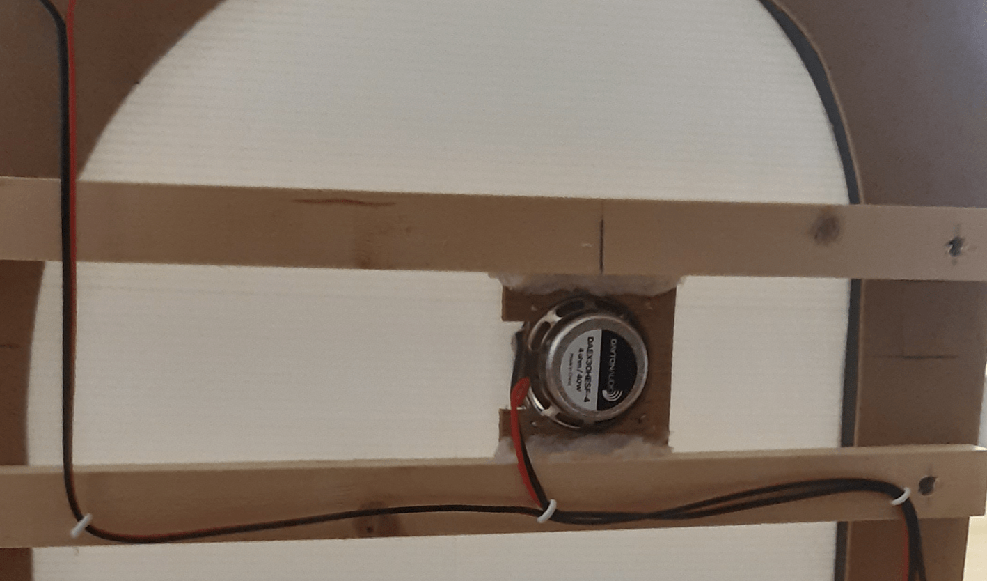

Hi jaxboy.I noticed this problem with the low frequencies.
The exciter in the centre is rock solid but the one next to it is jumping around All over the place.
Steve.
I noticed on my next post to the one that you quoted ,showed two exciters closely mounted.
As you can see they are definitely not working in tandem 🫣
Even though they are operating in the same phase.
Positioning is very important.
I only used Evo-stik as my joint gun filler had gone off 🤗

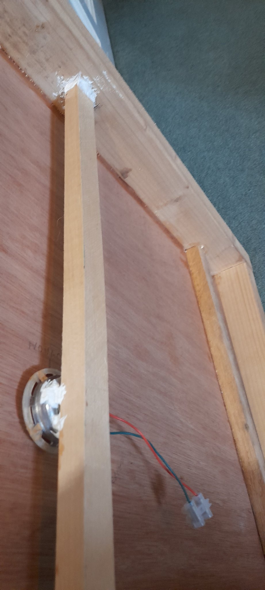

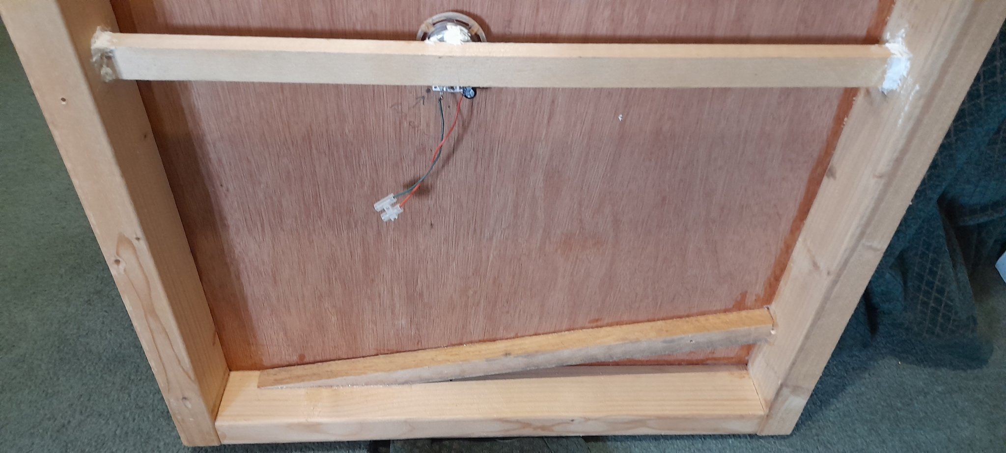

For the life of me , I could not remember which panel I had the caulk on.
Just remembered it was on my rigidly mounted ply panel.
See pics.
This is not such a great idea on 3mm ply panels as they tend to bend over time.
But the rigid mounting seems to have prevented this panel from bending too much ?

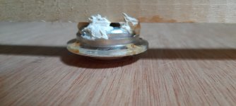

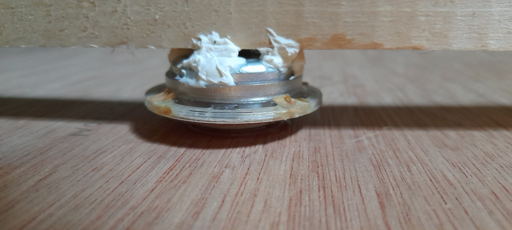

I stuck this on years ago, rather quickly, so it doesn't look that great, but it has worked perfectly for all these years.
As you can see from this photo I left gaps in the glue to allow The exciter to vent out.
if you place the canvas on a flat surface when interesting the glue filler the exciter will be fixed in the correct position when dry.
the canvas also has quite a bit of play in it, so the coil will be in its ideal place.
It will be difficult to adjust and setup if you use the bolt hole.
Hope this helps.
Steve.

If it can give ideas, here is a picture of my last panels (rear view)
The exciter (DAEX25FHE) is mounted on a square plywood with its 4 peripheral holes and screws (model for wood).
Then this assembly is glued (original 3M tape) to the membrane (be careful here to keep the right orientation for the square piece, the next step allows some error)
Then screw the 2 spines on the frame (see one of the screws on the picture, bottom right)
Then put silicon on the sides of the square (upper, lower side) in contact with the spines. Do to that, the panel was horizontal on my bench (the membrane facing down) with some blocks between the membrane and the bench to keep the exciter at its natural position.
Christian
PS : risk of that = to have some noise from loose screws. In my plywood panels, it is about same principle but with bolts. I glued 3mm diameter nuts on the exciter (same 4 holes) to get threads. The advantage is then the screw comes from the rear direction (not from the membrane like in the picture) so you can screw them again if necessary.
