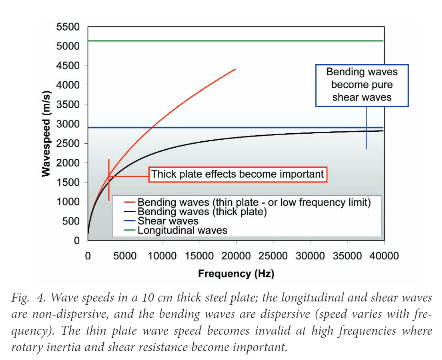

But I fear some are confused about which "speed of sound" they should be thinking about in this case. The most common meaning of "speed of sound" in a solid, is the speed of longitudinal waves.
This speed is a constant for a material, independent of the panel thickness and wave frequency, and largely irrelevant, because these wave produce virtually no significant displacement of the air and hence produce no significant sound.
The relevant waves, on the other hand, are transverse bending/shear waves which are the waves that actually produce lateral/transverse displacement of the panel and hence produce sound. The speed of these waves are given by these relations:
This speed is different from the longitudinal wave speed in that it depends on the panel thickness (h) and frequency of the wave. Further, as shown in this graph below by Hambric, this speed is bounded at high frequencies by the speed of shear waves and is hence always less than the speed of longitudinal waves, especially at lower frequencies. Further, due to the thickness effect in the equation above, for thin panels (like most DMLs) the speed of the transverse waves is typically far, far below that of the longitudinal waves.
So we should all be careful of which "speed" we are referring to when we are talking about the speed of waves on a panel. It's the speed of bending/shear waves that is relevant, and not the commonly referred to "speed of sound" that applies only to the irrelevant longitudinal waves.
Eric

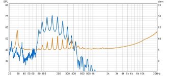

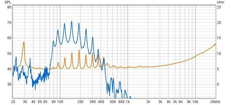

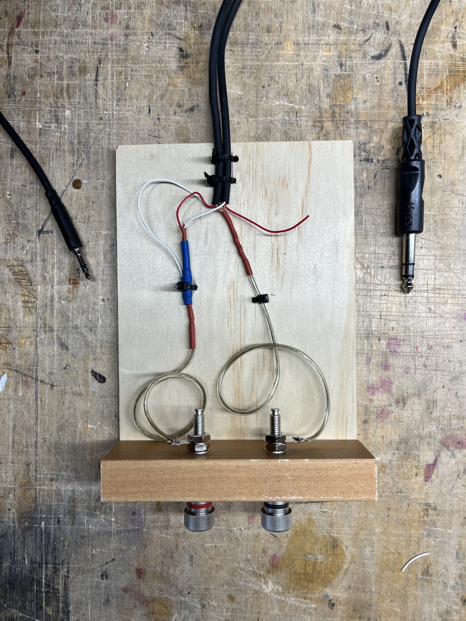

I finally got around to building my rig for impedance testing using REW. It's little crude but seems to work great.
One thing I was very interested in was whether or not the peaks in the impedance curve would correspond to the natural frequencies of the panel. The results of some of my very first tests confirm that they absolutely do.
The panel I used in the tests below was an 8" x 37" balsa core with fiberglass skins, attached to a frame using small pieces of 3M indoor mounting tape around the entire perimeter, spaced about 2-3 inches apart. I chose this panel for the test because I know it has very little damping, so the resonance frequencies would be well defined, and because I knew the high aspect ratio panel with a fixed perimeter would have a nice series of roughly evenly spaced natural frequencies.
The curve in blue below is the result of an impulse excitation test (i.e. tap test), which is a method I have described before, and have been using for some time now to evaluate the natural frequencies of my panels. In a "tap test" I strike the panel with a small rubber mallet and monitor the response with a mic placed as close as possible to the surface of the panel. Peaks in the frequency response measured by the mic indicate natural frequencies of the panel. Striking (and mic-ing) different locations on the panel excites different sets of natural frequencies (or modes), so usually it requires a series of several taps at different locations to determine, say, the first 10-20 natural frequencies of the panel. But for high aspect ratio panels like the one I'm using here, the situation is particularly simple, and a single "end tap" reveals nine very clearly defined natural frequencies between about 80 and 450 Hz. (The one frequency not revealed by the "end tap" is the fundamental, which is easily revealed by a "center tap" to be at about 70 Hz)
The curve in orange below is the impedance curve I measured for the same panel, using my new rig. For this test, I used a DA EX25VT-4 exciter. In order to try to excite the same frequencies as I had in the tap test, I placed the exciter close to one end of the panel. (Of course, I wouldn't normally put the exciter there, but for the purposes of this test, it made the most sense). As you can clearly see, the peaks in the impedance curve match exactly with the natural frequencies observed in the tap test. Interestingly, the impedance test shows two additional peaks (500 and 616 Hz) which were not clearly resolved in the tap test, but are in the impedance curve.
The single peak at 30 Hz in the impedance curve (but not the tap test) is apparently related to the natural frequency of the exciter itself (magnet mass and suspension stiffness). The plot below shows the impedance curve for the same exciter, attached instead to a heavy block of metal. That result shows a single impedance peak at a similar frequency. Presumably the slight shift is due to the compliance of the panel and mounting, relative to the fixed metal block.
Eric
