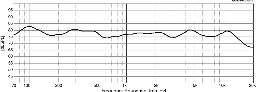

This is the DAEX25 shared some posts ago

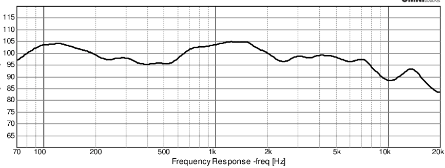

This is the DAEX25SHF-4
Can we conclude the DAEX25SHF-4 has a better efficiency (higher BL even if 20db difference in the charts is strange), a better Xmax (not specified) but a lower HF capability? The difference in the mids are strange, this area being more driven by the material and the geometry than the exciter. In the LF, the roll off comes most probably from the panel material and dimensions.
That 20db better sensitivity is very strange indeed. But I am tempted to get one to confirm for myself.

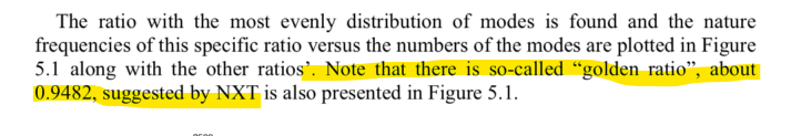

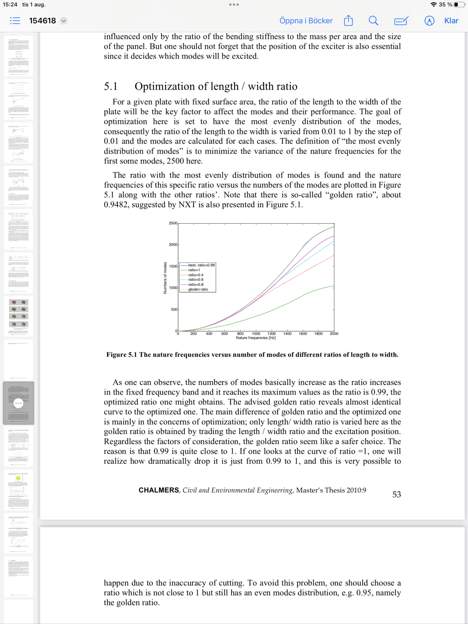

At least not according to this study. It’s from the Chalmers thesis.
A critical review of bending wave loudspeaker technology and implementation
Master’s Thesis in the Master’s programme in Sound and Vibration KUONAN LI
Thomas
Concerning this quote, from the Kuonon Li thesis:
Does anyone know where the 0.9482 ratio that he refers to actually comes from? The NXT patents I know of mention 1.134 and 1.37 ( their reciprocals, 0.882 and 0.73), but I don't recall ever seeing 0.9482 anywhere other than the Li thesis.
Also, I recall other references to NXT's "gold" and "silver" ratios (which I presumed to refer to the 1.134 and 1.37, but perhaps not). Is anybody aware of any NXT/Azima, etc published literature that talks about the gold and/or silver ratios? I'm wondering where that terminology originated. Was it NXT papers or patents? Or someone else's papers? Or made up on one of the forums?
Eric
Eric

I have seen from NXT several times in different places.
Thanks. Does anyone have a copy or link to any of the publications in which the 0.9482 ratio is actually mentioned (other than the Li thesis)? That's actually what I was hoping for, if it exists.
Eric
I thought it was in this one which may be of interest anyway
https://web.archive.org/web/2013031...6/files/290707 Final Report - Final Draft.pdf
You could try one I posted a link to earlier concerning wide field dml
The number I remember is 0.95. However where NXT info is found it's one that they do not appear to have used.

I'm not sure exactly what you mean by that. Perhaps you mean that you can get good results from many other aspect ratios, and I would agree with you about that for sure.I think ratio must relate to tuning but not that sure NXT info is that relevant.
But what I'm looking for is evidence of whether or not NXT ever actually recommended the aspect ratio 0.9482 (regardless of whether or not it is actually a good recommendation). I've read a lot of the NXT patents and publications, and thought that I was aware of their recommended aspect ratios, and understood their logic behind those recommendations. But the 0.9482 (or 0.95) is not one I remember from any NXT publication, and I'm frankly somewhat doubtful that they ever actually recommended it (despite the assertion in the Li thesis). I was just hoping that if I'm wrong about that, someone could show me proof of that!
