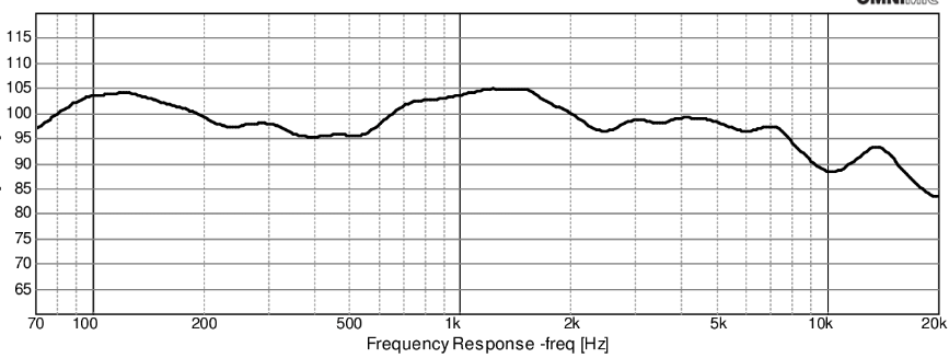

Yes this oneBecause I can't find the model number
I searched carefully and found that the model number is "30HESF"
DAEX30HESF-4 High Efficiency Steered Flux Exciter with Shielding 30 mm Exciter 40W 4 Ohm
From the specifications, the high-frequency extension is not bad

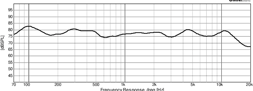

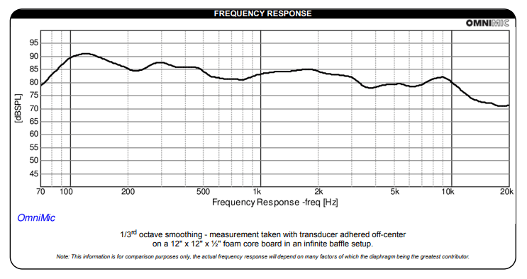

Don't pay too much attention to those curves on the Dayton specifications. The 1/2" foam-core board that they use for their tests shows similar peaks and dips for all of their drivers. And they all have a drop-off at higher frequencies.Because I can't find the model number

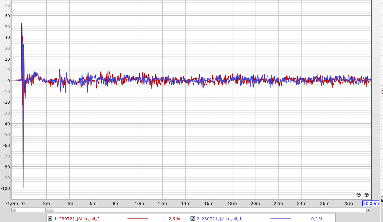

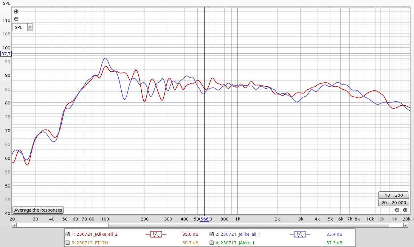

Hello

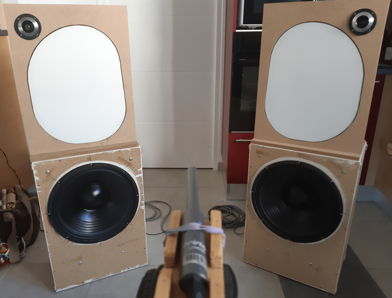

New step: the 2 channels are wired with the crossovers including the tweeters (FT17H). 1st tests were today. Amazing. Even after more than 2 years (3?), DML continue to surprise me...in a good way, even if the test was in my kitchen.
The most important is the listening :
So this pair is better than expected for its purpose.
I understand @Leob how was the surprise for your party!
Next step is it to work around some EQ to get a cleaner sound.
In the mean time, I got my wife's approval for the use of this pair and to continue for a pair for home.

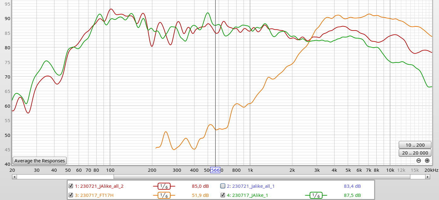

From design point of view :
Here are the FR
And the IR
Last the FR to show what the tweeter adds
- The bass are to "boomy", not dry enough. It was expected due to the compact design of the bass cabinet. Part of the balance was corrected with the simple EQ of the audio player which in my computer. A more sophisticated is needed.
- The energy, the "slam effect", the energy and clarity is great.
- The canvas panels have the spaciousness of the DML, the wide range
- The large plywood have more energy, life. A good balance, more life. A good scene.
- This pair adds punch.
- the installation today was not good enough to appreciate the sound scene but the DML working with a tweeter seems a good option
- in the good option, the large relative area of the DML (similar to the 15" below) gives a great impulse to the air.
Here are the FR
And the IR
Hello Audiofrenzy,Dayton Vs. Tectonic. Its not about which brand is better as it comes down to each individual exciter. Its also not about if 4ohms has better HF then 8ohms or vice versa as once again it comes down to each individual exciter.
Good sounding 8ohm exciter believe it or not is the DAEX25. Only down fall is lower power handling. Just looking at the Dayton frequency graph I knew this exciter would sound good because of its fairly flat frequency response.
https://www.parts-express.com/pedocs/specs/300-375--dayton-audio-daex25-specifications.pdf
A good sounding 4ohm exciter is the DAEX19CT-4 Which once again has a fairly flat frequency response.
https://www.parts-express.com/pedocs/specs/295-218--dayton-audio-daex19ct-4-specifications.pdf
When you start out with a exciter with a fairly flat frequency response half the battle is already won as less EQ/DSP will be needed.
But if you believe Andre Bellwood that Dayton graphs dont have much merit by all means dont listen to my advice and stay away from those 2 exciters that I listed above.
Interesting and good findings.
Those exciters are low mass and low inductance.
If DaytonAudio use the same material for all the specifications, which it is written, then as you do, the FR can be compared. The humps pointing by André being here in all the cases. Those FR don't say what will be the result with an other material but the potential of the exciter.
Reverse side of the coin, those exciters seem to be low force factor and low power handling so limitation in efficiency and power.
For a home use it shouldn't be a problem as we have already the experience from Steve with 10W exciters.
Are they the exciters in your DMLs?
Christian
It is a shame that Drayton use such an inferior material ( unless used with a fairly rigid skin,like epoxy) to use for their frequency measurements.Don't pay too much attention to those curves on the Dayton specifications. The 1/2" foam-core board that they use for their tests shows similar peaks and dips for all of their drivers. And they all have a drop-off at higher frequencies.
I just had a quick look at various exciter measurements and found the measurements vastly different?
Some had a good frequency up to 10k and some have a very poor response, some rolling off at 1k and down 15db at 2k 😱 and 25db at 20k 😱😱
If all the conditions are supposed to be the same ? Why are the frequency responses so different .
I would definitely pay attention to this ?
Wouldn't you ?
Steve.

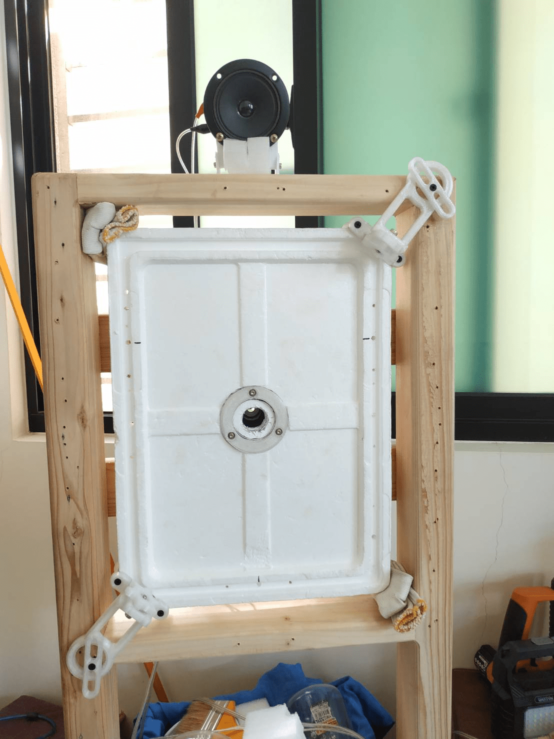

Here they say that only the short sides of the panel need to be fixed:https://patents.google.com/patent/US20090028368A1/en?oq=US4480155Producing updated plates for party this weekend, getting ready to pack everything up

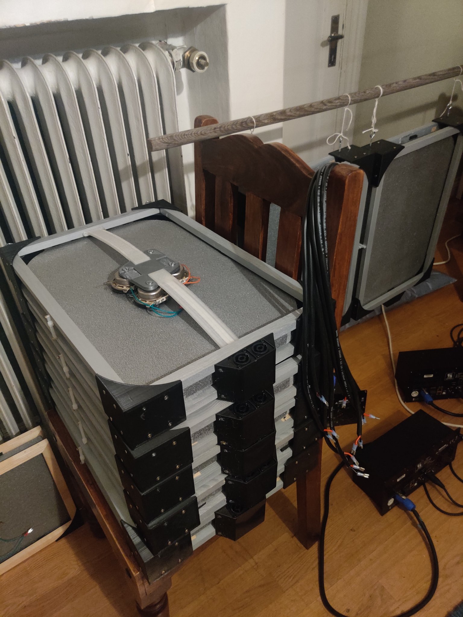

Been both a bit exhausted and busy after the party, and is preparing for road trip to Hungary with the family for a festival gig next month, so just a quick report for now...
Party was a big success this year as well! We had a fair bit or rain the second night during my set, but dancefloor kept going and nothing got damaged
Plates had to work hard though....this time I was running one plate per amp channel with 900w @ 4 ohm instead of the rated 160w
According to some quick tests comparing 2 plates in 8 ohm and 500w with single plate at 900w, output seemed similar, but at the party I found that ideally I wanted to push the amps close to max to keep up with only one plate per 18" sub (Yamaha DSX18). I upped the XO from 100hz to 120hz to take some load of them, and was mainly nervous about the exciters becoming unglued since I did not notice any heat buildup.
Unfortunately some of the plates used a little bit different preparation with a larger area covered by glue, and a couple had extra shellac to fortify the mounting area. One exciter unmounted from one of those plates early on, but I could get it out of the way so it didn't cause any distortion.
They blasted on nicely during the night and I constantly checked temp, but after changing DJ in the morning I suddenly noticed some exciters was getting very warm. I pulled down the volume, but damage was already done to the panels using the extra shellac fortification where now several exciters had become loose.
By the end it was running with 5 panels instead of 8...I would have liked it a bit louder, but they kept up fine and everyone was happy with the sound.
Two plates per sub would be a more sensible setup to leave some margin, but can't make an omelette without breaking some eggs
What I found very interesting was how the extra shellac fortification affected the heat buildup. It did reduce efficiency a bit, hence I decided against it, and obviously the energy has to go somewhere so it results in not only less output for the panel, but also means that the exciter can handle less power. I guess that a panel that is 3dB less efficient would not only need double the power for the same output, but would also be able to handle something like half the power before exciter overheats, resulting in a 6dB actual difference in what it can produce.
It does seem like the last batch of plates I made have a good balance between secure mounting, good HF reproduction and efficiency. I do hope to get some time this year to experiment with composites and see if that can make an improvement, but at least now I feel I have a decent idea about the limits of EPS/GPS plates.
Will get back next month with some clips of the dancefloor and pics of melted GPS

How to suspend the plate really depends on plate dimensions, compliance of the clamping mechanism, plate material, etc.Here they say that only the short sides of the panel need to be fixed:https://patents.google.com/patent/US20090028368A1/en?oq=US4480155
I guess that for a reasonably sized plate slightly clamping short sides is ideal from efficiency perspective since a completely free plate will cancel itself a bit from residual vibrations. Usually the plates are very strong around the first modes in the low mid and I suspect that might become an issue if I would reduce clamping even more, but will give it a try to clamp short sides only.

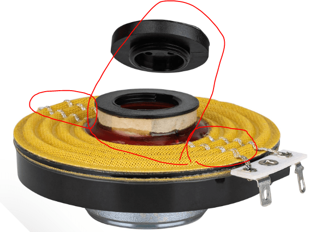

Hi Audiofrenzy.
I could only access the first link in your last post and I could not access any of your posted links on this page ?
Sorry I should have mentioned this earlier.
The exciter in you last post says it is a mid bass, but the bass seems to roll off heavily below 100hz?
It says that it has dual suspension for low frequency excursions?
It also has the large puck for removable mounting.
I did not look at this one when looking at frequency responses.
Others seem to have a far better performance in the low end ,if the tests are identical , as they say ?
I agree with you that it would be good idea to design an exciter to operate over certain frequencies, rather than try to cover from 20hz to 20k.
My exciters are certainly not designed to go down to 20hz , although they can on certain materials, as long as you do not push them too hard.
I prefer to keep all frequencies below 100hz ,well away from my exciters, on most panel materials.
Steve.

Connect the voice coil with screws like in my previous test
But my voice coil is just a spider web
So the board needs to be balanced
Dear DML players, don’t just play DAYTON anymore
Any voice coil can play DML

That's my choice of exciter 👍👌Only a few exciters like the 25DAEX25SHF-4 can beat it at 95db at 70hz
HelloAll exciters start dropping at 100hz as that is when the exciter starts to go into pistonic mode.
Most exciters output at 70hz are at around 70-80db while the midbass exciter is 85db at 70hz. Only a few exciters like the 25DAEX25SHF-4 can beat it at 95db at 70hz. Plus most of Daytons graphs cut off at 70hz, while this midbass exciter graph goes down to 20hz
This is the DAEX25 shared some posts ago
This is the DAEX25SHF-4
Can we conclude the DAEX25SHF-4 has a better efficiency (higher BL even if 20db difference in the charts is strange), a better Xmax (not specified) but a lower HF capability? The difference in the mids are strange, this area being more driven by the material and the geometry than the exciter. In the LF, the roll off comes most probably from the panel material and dimensions.
