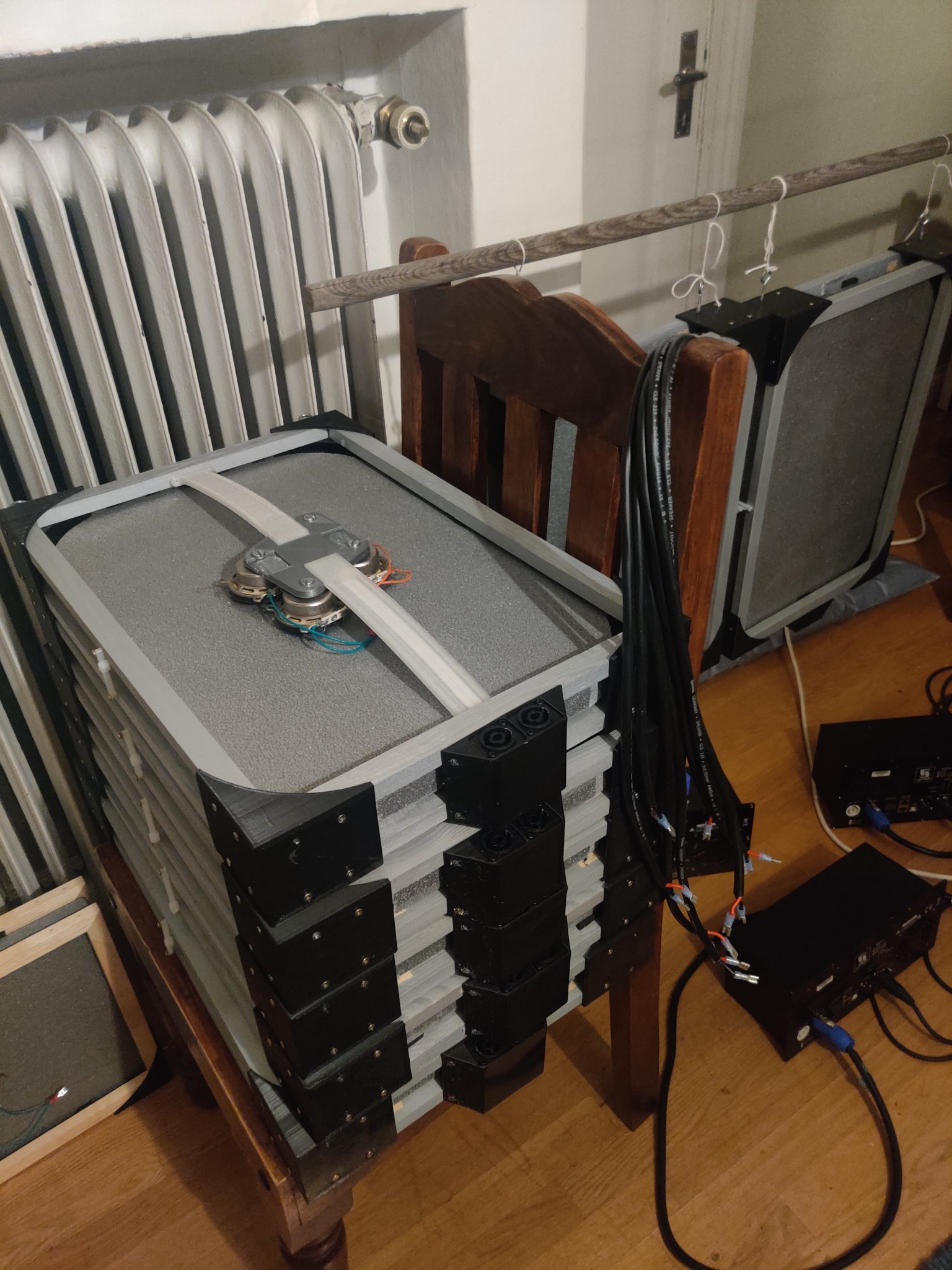

The exciter mounting looks much better now, more robust.
Is there any chance that you could post some more videos of them in action?
I liked the ones you have already posted,it felt and sounded like I was there, maybe walking around the setup and the listening, dance area?
To get an idea of how they perform.
How about playing some jazz 🤣😂
Seriously though, they sounded very powerful and gave a good sound coverage, even in the distance.
Steve.
Steve.
