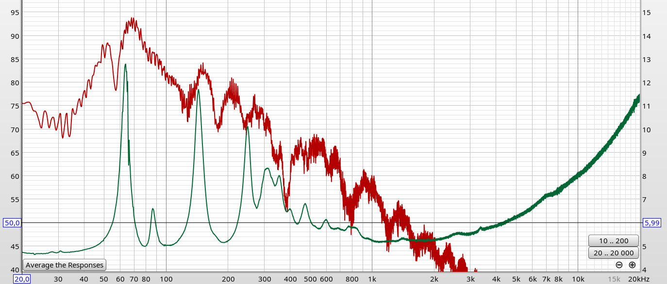

I'm curious if the impedance peaks correlate with panel natural frequencies. Did you (or would you) do some tap tasting to find the natural frequencies?
Eric
I have had your question in mind but not the time to make a test. I made one today. On the graph, the impedance curve of the original post and the tap test from today (not the material to make an impedance test today). The exciter was removed from the membrane since the impedance curve.
Due to the height of the impedance peaks, I would have expected sharper peaks on the tap tests.

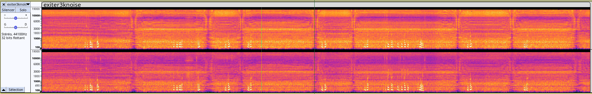

I have already made a recording on this forum somewhere of the noise differences from the back and front of the panels.
Steve
Here it is no? #6681
And here is the spectrum where the 3k bump on one side is visible #6682

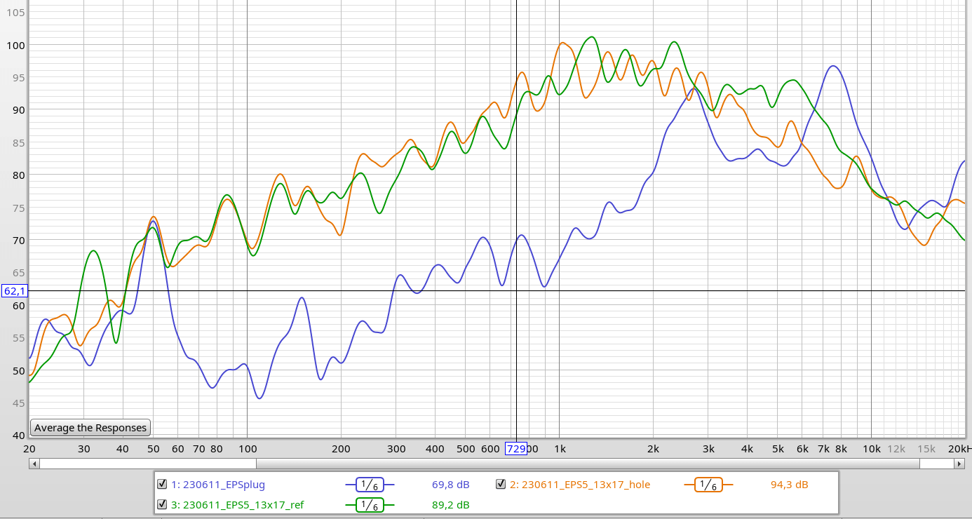

I would split those "noises" in 2 categories :
- The noises for which the source is by somehow external to exciter : wires, extra strength on the exciter due to weight, loose nuts... All those things are quite easy to detect and correct (spine, wire routing, tighten screws...) even if ennoying at the beginning (I remember spending some times after a noise to find at the end a loose nut).
- The noises linked to the exciter design by itself (cavity, vent effect). By nature, they are more like resonators as they emit sound at a specific frequency (or small range) when excited.
- Green : The small piece of EPS as a reference. On it, the cavity noise at 2.3k is visible (the spectrogam shows it is not coming from the front side)
- Orange : A piece of the same dimension but with a hole in regard of the voice coil area.. No more cavity noise but no more HF reinforcement coming from the central area
- Blue : The third curve is a piece of the same EPS, about 25mm diameter just covering the voice coil. The cavity noise and the emission of the central area if visible. Even if it not exactly the same frequencies because the conditions are not exactly the same (boundary conditions), it could be a not too bad test to visualize those noises.
So avoiding the cavity noise by a hole modify also the HF.
If I remember, Steve, you have also tested that then searching solution to get back HF (tea bag dome?)
Against or to control the central area emission, some blue tack added at the center.
We could also list the workaround from @Eucyblues99 : the Eucy's dome and the felt on the exciter.
Just estimated but the roll off rate in HF of the orange curve seems 6dB/oct. Interesting because it opens to the possibility to find the cause, to compensate, or why not to add a tweeter (even if for this material it happens too early).

Christian,Hello Eric,
Interesting. Typically, the tap test peaks are sharper.
What is the panel material, dimensions, and suspension details? Where was the exciter placed? Is it a material for which you have estimated the elastic moduli?
Have you tried any impedance measurements with the exciter in other positions?

Hello EricChristian,
Eric
It is the panel described in the pdf of #10187
3mm corrugated polypropylene. Have a look to the pictures for the shape "JAlike".
For that tap test, the exciter was placed.
I should have somewhere results of tap tests done to evaluate the material characteristics.

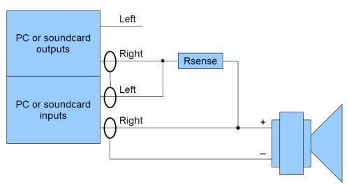

I was thinking about doing a simulation yes. But that shape and material just make it a little too complex for now. It would probably be better if I learned how to do my own impedance measurements. Then I could make my own comparisons between tap test resonances and impedance peaks.
Eric
Hello Eric,It would probably be better if I learned how to do my own impedance measurements.
Years ago when I built standard loudspeakers, impedance measurement was among my tools for the crossover design. Starting with DML, as it operates mainly in full range I was not seeing the interest. But digging the theoretical approach, I see it informative for the DML too. With REW it is accessible (see the extract below from : REW impedance measurement)
I just followed it. Rsense = 100Ohms. The signal comes from a headphone output of a cheap USB DAC (headphone output for its capability to drive low impedance). The signals are measured by the line input (R&L) of an other USB card. You just need an additional resistor of a known value (ie 10Ohm) for calibration.
I wired all that in a small platic box with speaker type terminals for robustness and easy connections.
