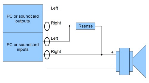

Years ago when I built standard loudspeakers, impedance measurement was among my tools for the crossover design. Starting with DML, as it operates mainly in full range I was not seeing the interest. But digging the theoretical approach, I see it informative for the DML too. With REW it is accessible (see the extract below from : REW impedance measurement)

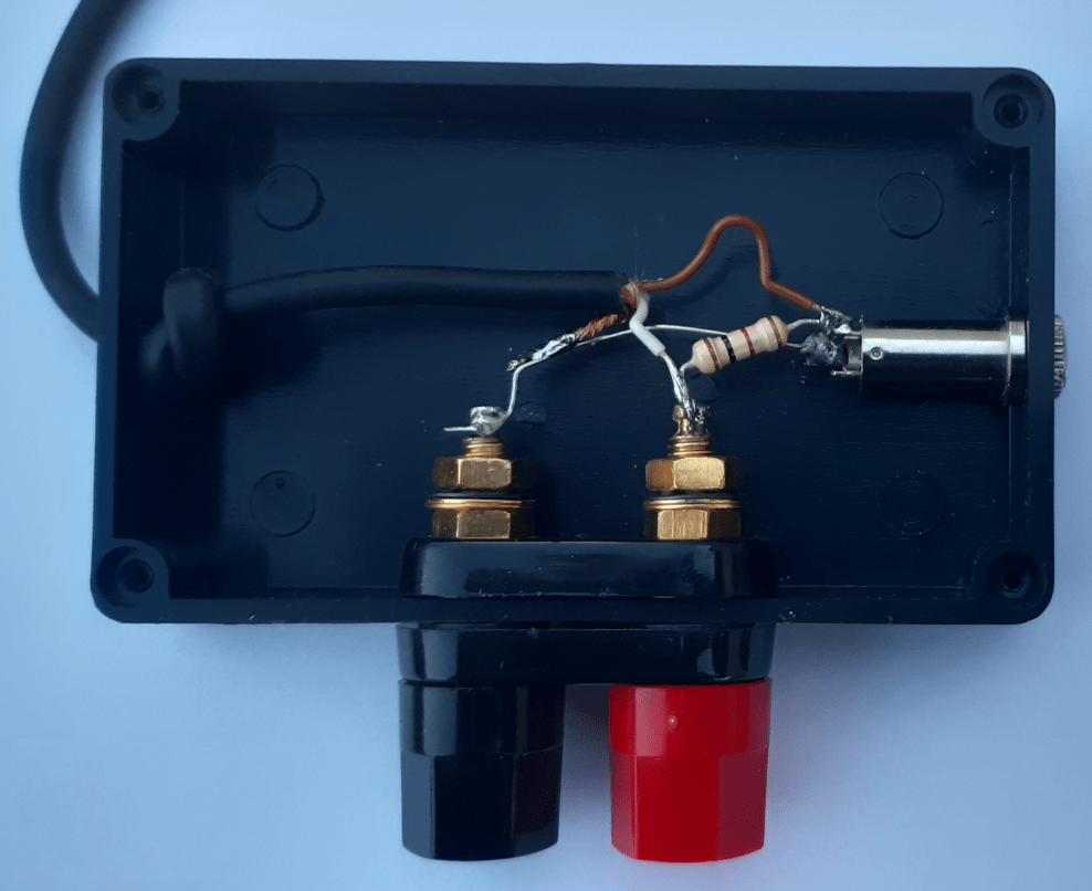

I just followed it. Rsense = 100Ohms. The signal comes from a headphone output of a cheap USB DAC (headphone output for its capability to drive low impedance). The signals are measured by the line input (R&L) of an other USB card. You just need an additional resistor of a known value (ie 10Ohm) for calibration.
I wired all that in a small platic box with speaker type terminals for robustness and easy connections.

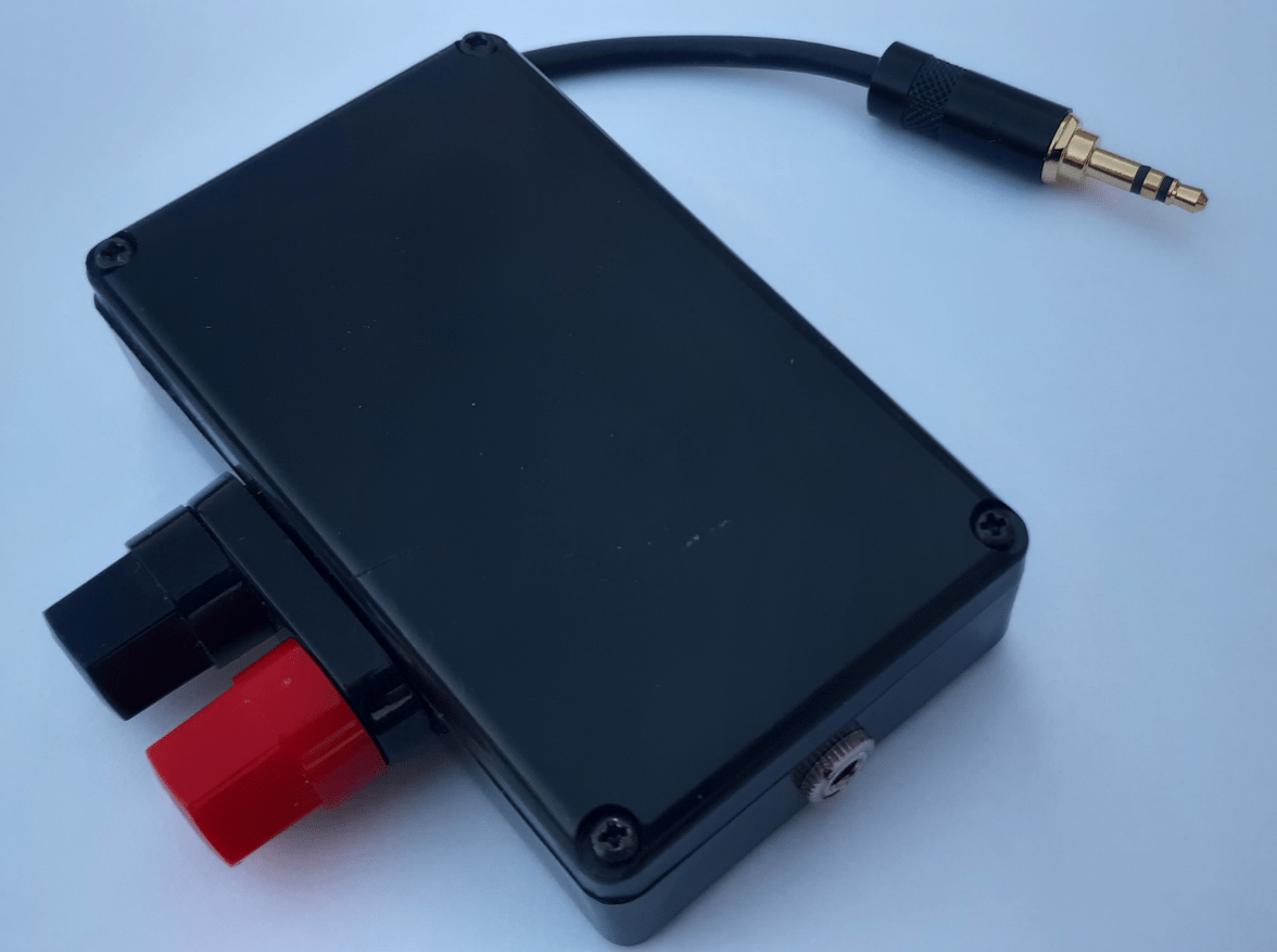

Here are 2 pictures of my implementation of the impedance measurement circuit.
Short explanations :
- chassis female jack on the left = to be connected to a headphone output (one channel used) = PC or soundcard outputs in the schematics above
- black and red bananas = speaker connections (+ = red, black = ground)
- male jack with shielded cable = connection to line in = PC or soundcard inputs in the schematic above
- Rsense = 100Ohms
- All the ground are connected together
Christian,Here are 2 pictures of my implementation of the impedance measurement circuit.
Nice. So clean and compact!
Mine won't look like that, haha.
Eric

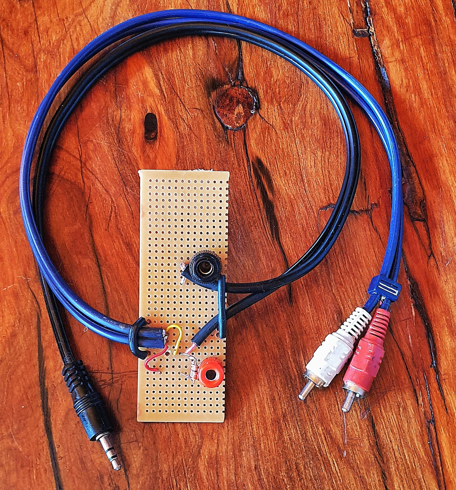

Anything like mine?
