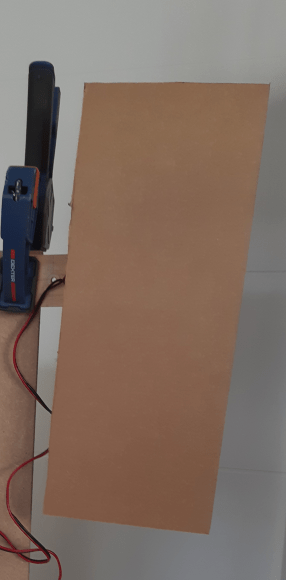

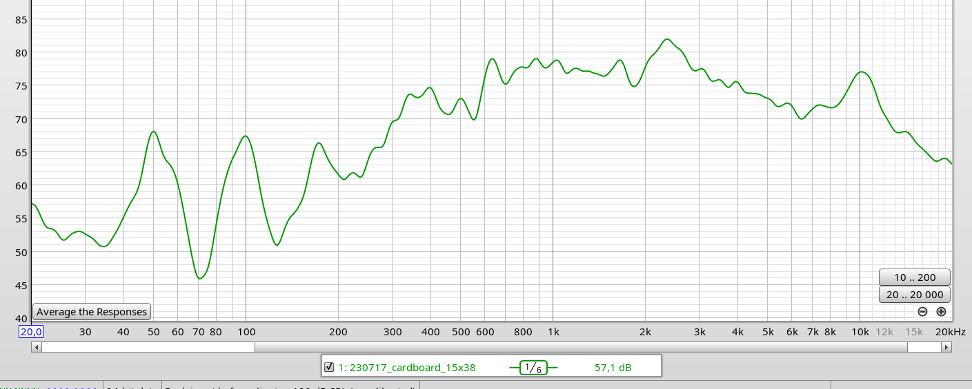

Hello,
Here is a quick measurement of a 15x38cm piece of cardboard (about 2mm thick made of 2 flute layers).
I'd say the low frequency roll off start around 500Hz (don't take into account the 50 and 100Hz which are I think electrical noise in my system).
For now, I haven't tried to link this high pass effect with the panel dimensions but i think it should be possible.
With a bit of EQ, it would be possible to go lower. Similar to OB application?

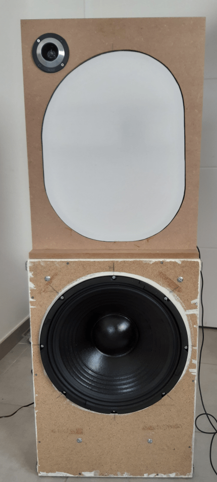

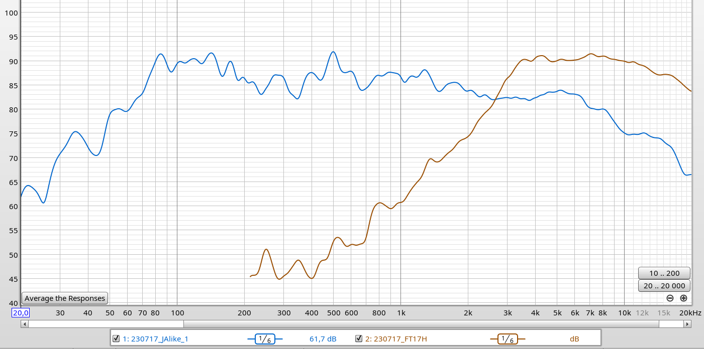

Hello,
If it can have an interest for somebody, here are the next steps of the DML posted in #10187.
Compare to the previous post, the exciter is now a 30mm and I wired a passive crossover to work with the woofer. The tweeter is not wired for now. The position of the exciter was also change compare to previous post to limit the hump which was at 300Hz.
The crossover is probably not optimized, made of parts I already have.
I just had some listening tests with one channel (second channel not wired for now). The results are encouraging.
Here is a measurement. The curve of the tweeter FT17H is here as a "reference" (HF and efficiency).

Hi Christian.
I am thinking of buying the 25HFE for testing heavier panels.
Referring to your two new plots, the hf on your last plot shows an early roll off above about 6k.
What is the material and its dimensions and thickness?
Your previous plot shows the usual peek at 10k ,which I have previously shown how to correct.
Hopefully this exciter will give a full frequency response on my panels under test?

Hi again Christian.+ @clevor1
Hello,
I have mentioned before the two humps in the low frequency area which is quite normal depending on panel materials and exciter.
Also depending on if the panel can actually go that low.
I have shown many plots with these humps in place.
You also mentioned MDF , which I have tested many years ago using the same 6ftx2ftx 3mm size rigidly framed panel as the ply panels .
The performance was very similar to the ply panel , but I felt it had less colouration than the ply.
But it still suffered the same problems as all heavier panels.
Steve.

With the 25HFE, I have quite good HF extension with my canvas panels and also with the plywood ones.
Those last FR are with a 30HEFS but I think this is not the origin of the roll off. the origin is probably in the material : a 3mm corrugated polypropylene with square flutes. I described the first test of this panel in #10187.
For this application, first intention was to use the 25HFE but due to the low HF extension of the material, I changed to the 30HEFS with a better power handling; those panels should be used in a (very) large room. They are also a pretext for testing new things.
Christian
I remember about those humps and also exchanges with Eric : the density of the first modes or let say the distance between them is too high so some valleys appear (mode 1,1, mode 1,3). After the density is better so the valleys are no more visible. In that case, I have doubt because the panel is small. I have had such humps at 50 and 100Hz in other measurements. I should think to a measurement with an other mic to be sure.Hi again Christian.
MDF seems to be in the range 600 to 800kg/m³ even 1000kg/m³ for what is called Isorel (don't know in English). I have in my notes 530kg/m³ for the poplar plywood. In addition the 3 layer plywood has different stiffness according to the direction which is described in some papers as an advantage to spread the coincidence frequency.You also mentioned MDF , which I have tested many years ago using the same 6ftx2ftx 3mm size rigidly framed panel as the ply panels .
Steve.
