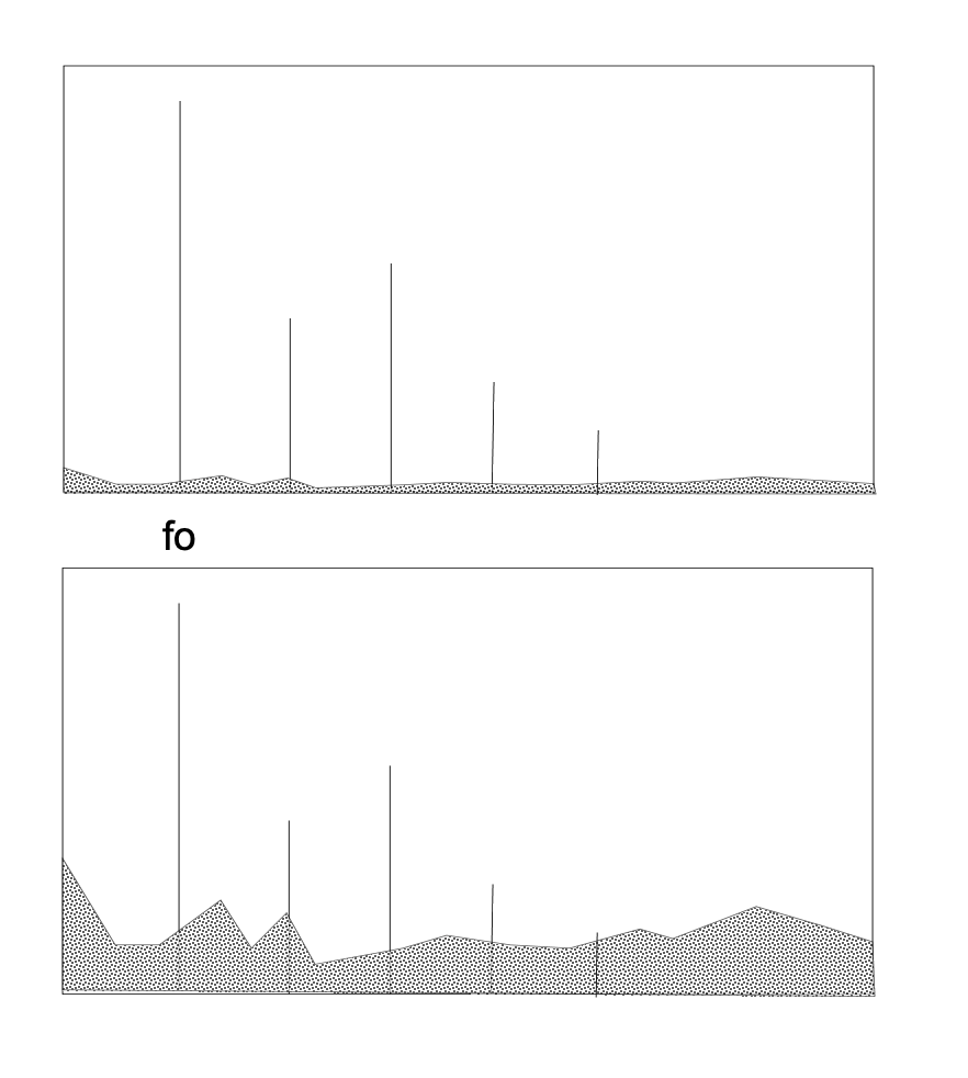

There is a catch with standard swept distortion measures and that is that the harmonica are filtered out. So anything non-harmonic is not displayed. There is a production measurement for loudspeakers that is called "rub & buzz" - thats to catch off driver faults... I have a hunch based on my experiments with DML that there might be going on more of rub&buzz in these than ordinary drivers - something to consider perhaps and measure for. One way I suppose is to do RTA with high resolution and check for the general noise floor... perhaps with a multi tone (32?) stimuli?
These would measure the same THD in a standard sweep distortion measurement...

Hello TNTThere is a catch with standard swept distortion measures and that is that the harmonica are filtered out. So anything non-harmonic is not displayed. There is a production measurement for loudspeakers that is called "rub & buzz" - thats to catch off driver faults... I have a hunch based on my experiments with DML that there might be going on more of rub&buzz in these than ordinary drivers - something to consider perhaps and measure for. One way I suppose is to do RTA with high resolution and check for the general noise floor... perhaps with a multi tone (32?) stimuli?
Have you had a look to #4656, about spectral contamination? I read somewhere a suggestion to adjust the level at for example 90db. This kind of signal is not very pleasant to the hears!
Is it similar to what you describes in this post?
If you are aware of post treatment to extract some figures, let us know.
By their principle based on modes, the DML might be more sensitive to such intermodulation distortion. In a patent I linked in #4651, what it is called "self noise" it is a criteria for selecting the material.

Yes, I think it's the same territory. A way of measuring it would be to play a multitone stimuli and the filter out all tones and look whats left minus background. This is added noise and very unwelcome. But I dint know of a standardised measure or unit.
