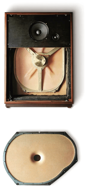

What is the reason of the additional tweeter? Is its band limted because of the optimisation of the bass/mid despite the high density EPS?
We often see the back of the speaker to show what is inside. Is it a true open back speaker or is there some damping/attenuation material?

You may not have noticed old postsSeems additional weights are in most of the commercial DML. One of their role is to modify the modes and smooth the FR.
Audiofrenzy,
You have deeply studied the Bertagny and used their solutions.

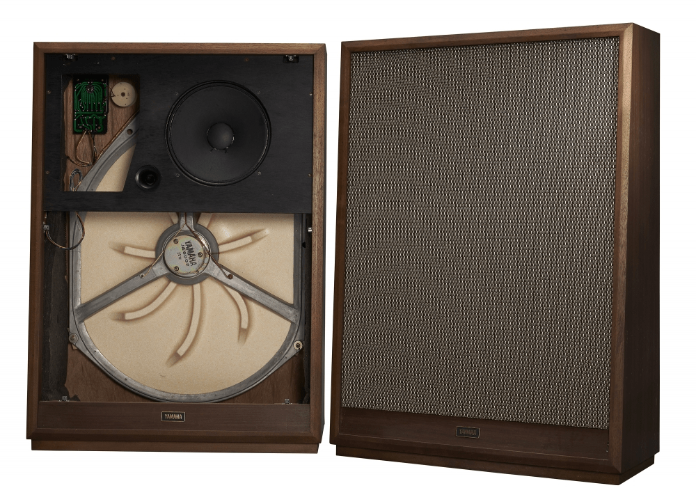

Which Yamaha model is this loudspeaker? Seems the "DML" and the tweeter are firing in same direction (not the case of other models being 3 ways as other Yamaha models with such "natural sound" or ear speakers).
NS full series introduction PDF Download
NS-10(1 Way)
NS-15、NS-18(2 Way)
NS-20、NS-30(3 Way)

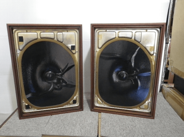

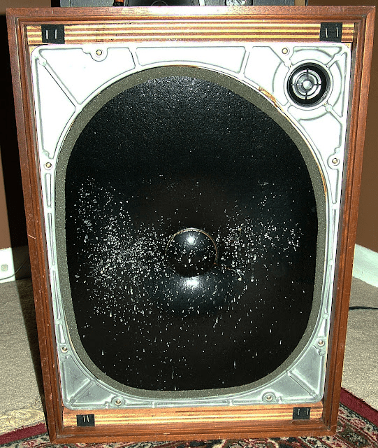

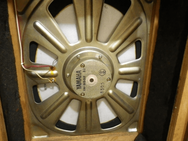

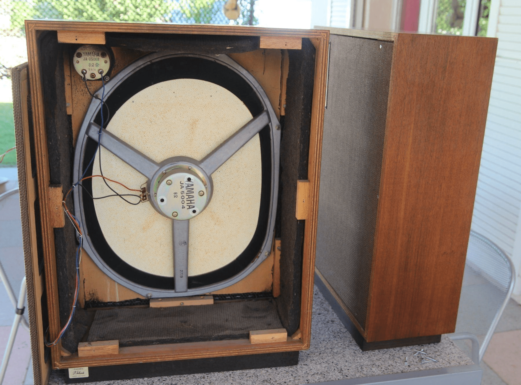

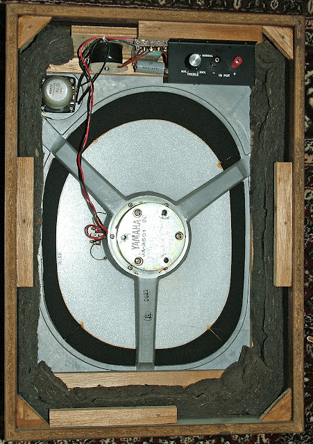

I don't think these are DML. Are they open baffle?NS full series introduction PDF Download
NS-10(1 Way)
View attachment 1181753 View attachment 1181754
NS-15、NS-18(2 Way)
NS-20、NS-30(3 Way)
View attachment 1181750 View attachment 1181751
I had a pair of Leak speakers like this, with a polystyrene cone, many years ago.
I see that they mention NS10's in that brochure...
Yamaha NS10's are probably the most widely used professional studio monitors. They are industry standards. But those on your attachment must be the original concept as I don't recognize them. They must have changed and evolved to the standard that eventually became so popular.
NS-10's
