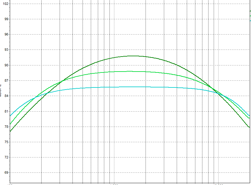

Just putting this idea out there for comment:
I think this is what's happening with the whole bandwidth vs efficiency problem.
The simulation below represents different system Q's (Quality factor) for the same cut-off frequencies. I think the Q is analogous primarily to the density and weight of the panel. The highest efficiency and narrowest bandwidth seems to correspond to very lightweight panels—EPS, XPS etc— and the seemingly widest bandwidth corresponds to heavier panels such as plywood, glass and acrylic.
The top end of the response can be extended by using harder panel materials, and the lower end can be extended by larger panel size and the correct edge damping. But of course the harder materials are generally heavier too, and so the general principle seems to stay the same.
This somewhat matches my experience.. Using thin but relatively heavy 5 ply Blackwood resulted in a reasonably flat and extended response over that of Poplar, particularly at the LF end, but at the expense of lowered output levels, to the point where I put it aside.

Agreed. The model I presented is simply a combined HPF/LPF, with the passband Q's adjusted from around 0.7 to 1.2 (just to make the curves look nice.)
The background to the example comes from designing double manifold sub-woofers. I noticed that the efficiency/bandwidth product in double manifold subs seemed to reflect exactly the same problem as with DML panels.

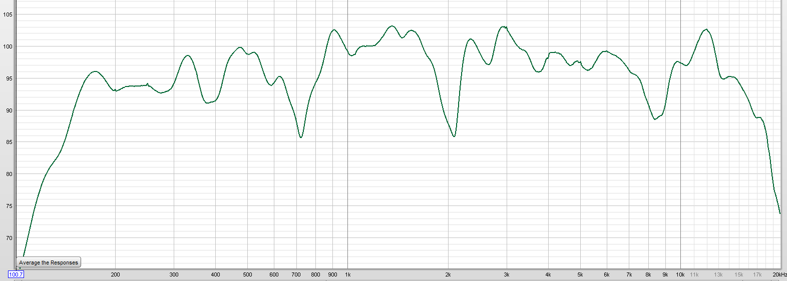

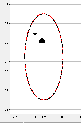

I used the spring-steel spider Tectonic TEAX32C30 drivers for both of the panels below. They are expensive drivers, and seem to have a better HF than all of the Daytons I've tried so far (0.1mH inductance!) but I was not impressed with their buzzing and rattling that I had to deal with.

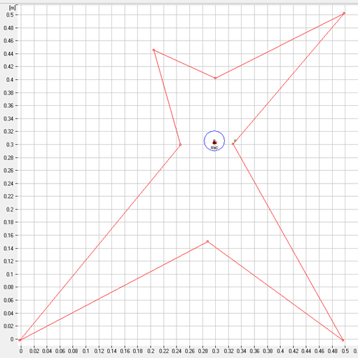

I've tried several different shapes. This star shape was okayish. I had been working on baffle diffraction simulations for the tweeters on an open baffle system for a customer, and this shape was very good for a baffle. So I thought I'd see what the results would be as a DML panel of the same dimensions. This was a foam-core paper panel.

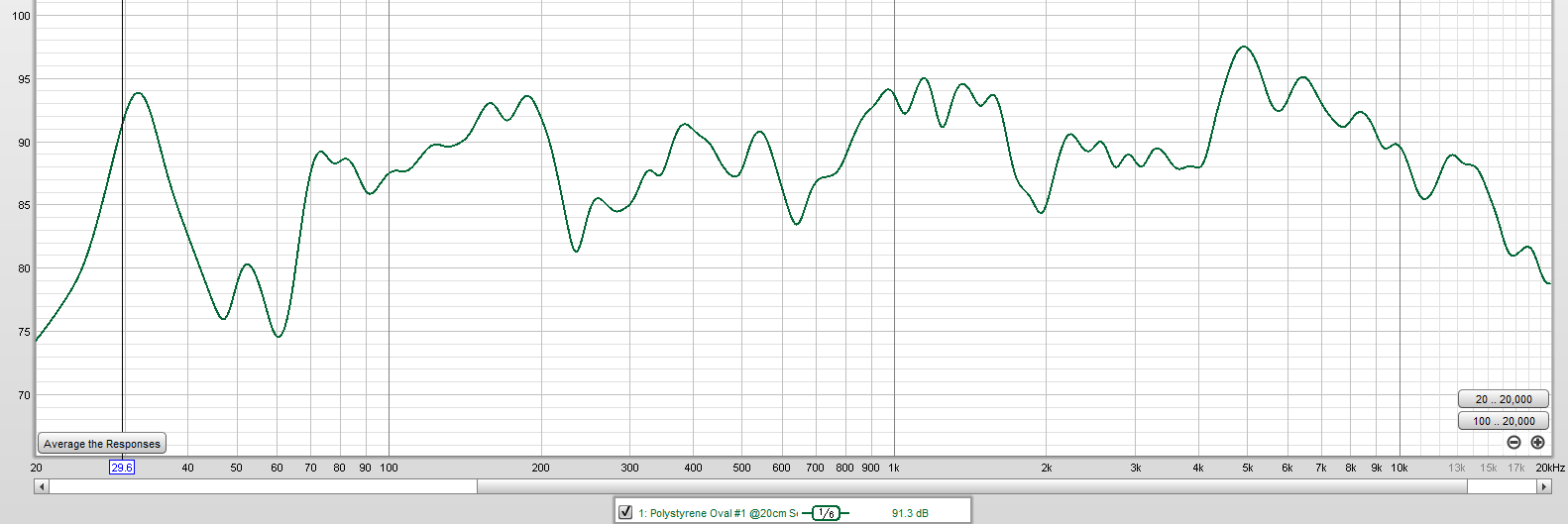

Ovals are also quite good, but driver positioning is more critical than for rectangular panels.
This one was a single sheet of polycarb TwinWall, 900mm x 400mm, glued to a single sheet of 10mm EPS of same shape and size. Of course 2nd-harmonic distortion was too high because it's all unbalanced due to the elasticity/compressions of the front and back faces being asymmetrical.
These are both rabbit trails worth further investigaton. The oval needs to be put into a symmetrical construction and re-tested and optimised if the FR is good enough.
Looking at these old files, maybe I should test Tectonic drivers again. Maybe I got duds the first time.
Reactions: 1 users
