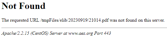

I found that @Andre Bellwood cannot be opened either.
Is there anyone else who can upload it?
Because I can't open it either...XD

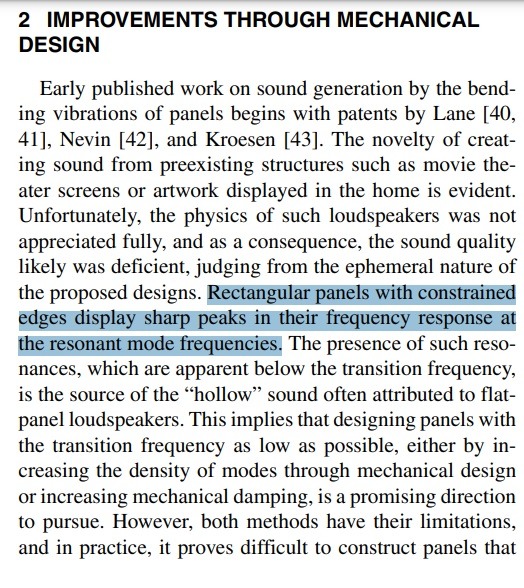

Christian,The recommendation in the paper you linked (not this last one, the one before) is to have this transition frequency as low as possible.
As it is directly linked to how the modes are located over the frequency range, the drivers (design parameters) are the panel dimensions, the panel ratio, the material choice, the boundary conditions (suspension).
For a room, there is a relation between the reverberation time which is quite easy to mesure and the Schroeder frequency. For a panel, I don't know...

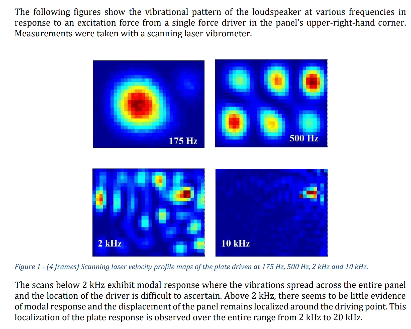

Yes, that's what I understood their idea to be, that is, that the transition frequency should be as low as possible, most ideally below the audible range (or at least below the frequency range of application). That's actually quite consistent with what I have been trying to achieve with high aspect ratio panels combined with strong perimeter damping.
I too would be interested in a method to measure the transition frequency. A scanning laser vibrometer would help but I don't have access to one! I've been giving a little thought to what measurement(s) I could make using the tools I have (FEM, tap testing, close-micing, impedance testing) that might provide an elegant alternative to the laser vibrometer but I don't have the answer yet. If you have any ideas let me know.

Eric,Thanks for providing a working link Christian.
That paper led me to this one by the same authors:
https://pubs.aip.org/asa/poma/artic...Measures-of-vibrational-localization-on-point

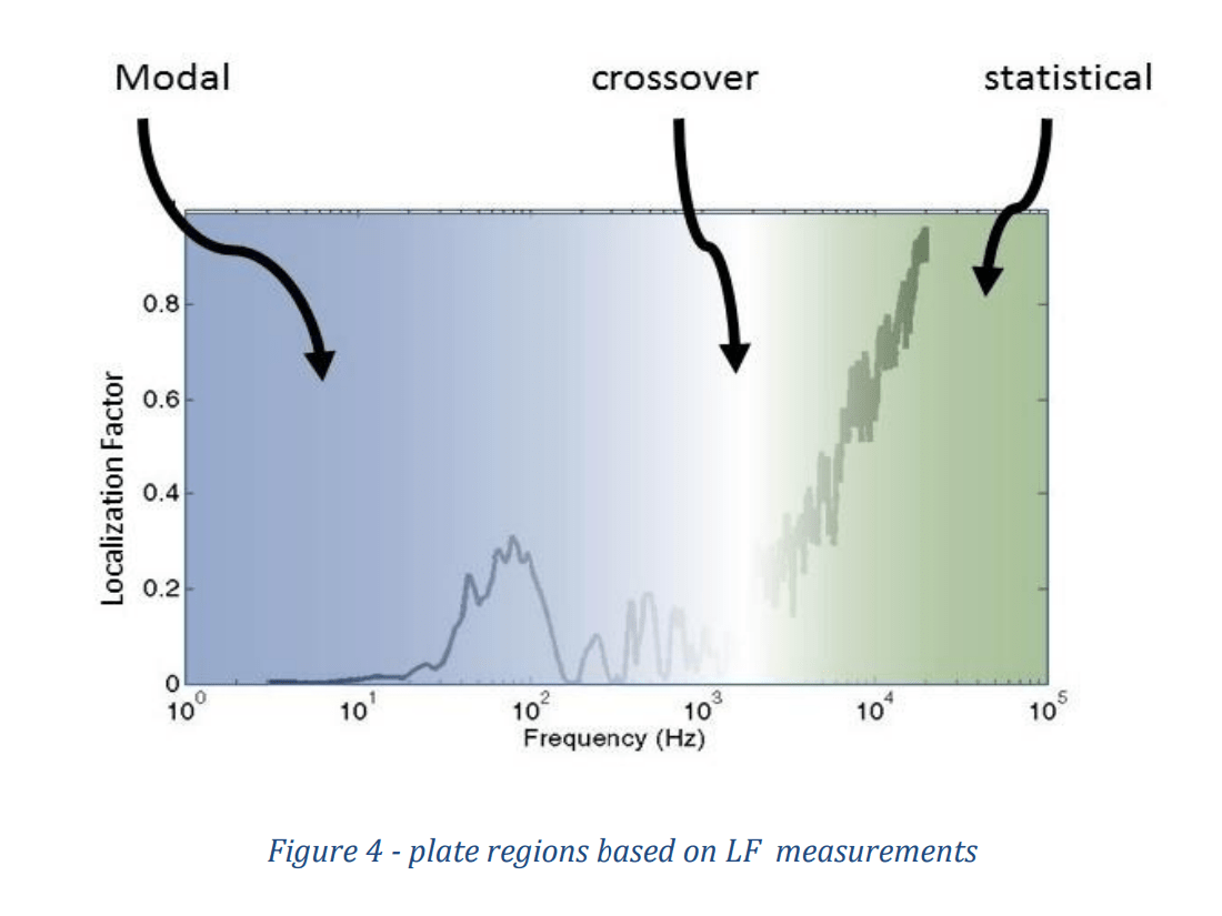

This paper is one of the most intriguing (and mercifully short!) papers I've come across in a long time. This figure is central to the paper:
And they end up splitting the frequency response into two regions (figure below), "modal" below a crossover frequency and "statistical" above the crossover frequency.
It reminds me of a discussion we had on this thread some time back concerning the different frequency regimes of a DML. I wanted to look back at that but couldn't figure out how to find it. Any body think they can? (Christian??).
I enjoyed that the paper is so short, but one thing I wish the authors wrote more about was the implications of this crossover frequency on the characteristics of the sound produced in each regime, say in terms of directionality, phase (correlated/uncorrelated), etc.

I read the paper...
The explanation about the Modal Overlap, the comparison to the Schroeder frequency makes sense to me.
The paper seems too limited in the relation between the membrane material and the named transition frequency. At least with not enough evidence (in my opinion of a person with limited knowledge in such topic) Only results for acrylic are shown; what about others? It was shared here that HF, in some materials (plywood?) can go far no? OK the only sensor we have is a mic...

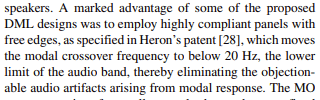

^ this reminds me of:
from a PDF you posted here:
https://www.diyaudio.com/community/...s-as-a-full-range-speaker.272576/post-7458376
deanznz,

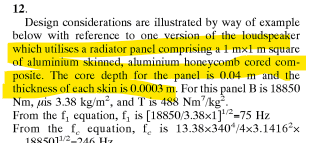

I read that too and thought it a bit curious. I am frankly a bit confused about what they are trying to say there. They single out "rectangular panels with constrained edges" but as far as I can tell, panels of any shape and unconstrained edges also display sharp peaks in their frequency response. And often sharper peaks, as there is less opportunity for introducing damping with free edges.
Later in the same section they add to my confusion when they cite Heron's patent as an example of a "highly compliant panel with free edges". Heron's patent indeed describes a panel with free edges, but the panel itself is a 40 mm thick (!) panel with aluminum honeycomb core and skins, and hence is about as far from "highly compliant" as I can imagine!
From Heron's patent:
That's probably the least compliant panel I've ever heard of used for a "DML"!
All that said, I do see how there could be merit to using truly compliant panels, as such would shift all the natural frequencies down, and thereby increase the density of natural frequencies in the audible range.
Eric
