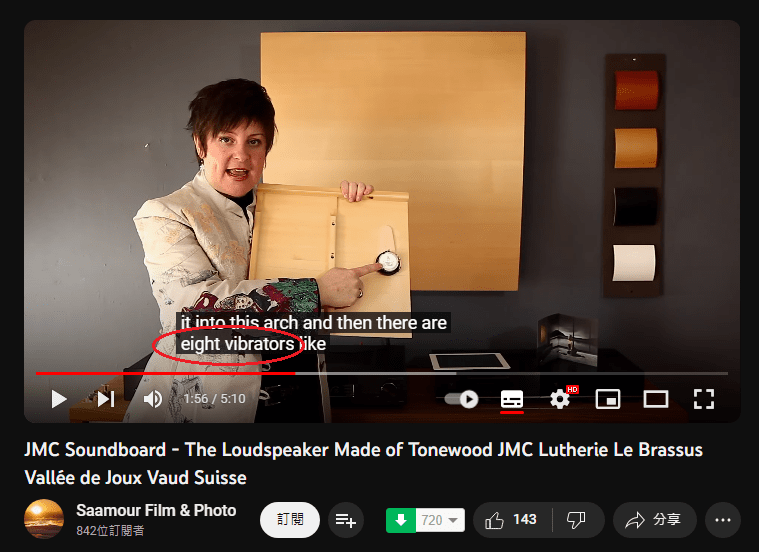

That design looks similar to the JMC sound board.
One panel has 8 exciters...wow

The main driver of efficiency is the density of the material. JMC board is made of spruce used for piano sound board (390 to 460kg/m³). The thickness drives the lowest frequency reachable (1s mode).JMC sound board uses only a single panel. So its probably 4 exciters for right channel and 4 exciters for the left.
The board is 1/4 inch thick so it needs a lot of exciters.

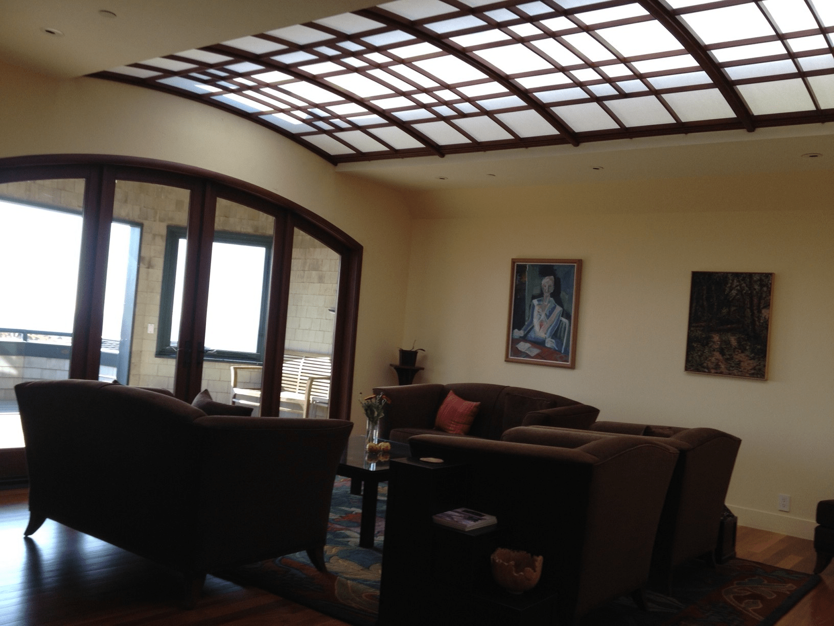

I designed, fabricated, and installed a 16' X 9' curved steam bent wooden shoji screen light diffusor for under a 4' X 16' skylight in my home in 2009. I want to put speakers that have wide horizontal diffusion pattern hidden behind them. I have been studying the work of Carlsson and Larson of Larson speakers where sound is deliberately non-focused but detailed and stereo. BMRs seemed excellent but DMLs might be even better with some DSP. I will replace my fiberglass shoji "paper" with sound transmitting cloth.You mean sincere? Alright. What is your application for DML's?
Please forgive my dyslexic typing, it's been a problem all my life.
Speaker cloth for the shoji 48" wide. Plenty of candidates here as it needs to transmit light as well.Also you mentioned sound transmitting cloth? That sounds intriguing.
https://www.sailrite.com/
Yes I know BMRs are inexpensive and can supplemented with conventional HF and LF drivers, as in the Philharmonic BMR speaker I posted. I may start there for the house because wiring, amplification, DSP and cloth can be installed and used for them with very good sound. Still I am intrigued that the dispersion of of the DML will sound better and looks are not important in this hidden location. Also, full range one panel is not my goal so hybrids are okay. I have a complete shop in a separate garage/shop building and can build almost anything.With DML's you are starting from scratch as you will need a make a diaphragm material with a frame or spine or something to hold the panel all together then there comes the question of if it will sound good as a DML's sound is based on ones design.
