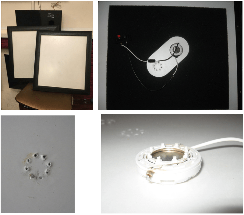

I've had Warfdale loudpanels on our AR receiver for several months now. The backs are enclosed and panel semi rigidly mount along all edges. Exciters 2 and just supported by the panel. The panel is backed with ~25mm of fairly stiff foam. I'd guess just touching the panel but not freely floating. The foam has an oval cut out to clear the exciters. There are also a couple of pieces of light wadding, They are intended to be wall mounted and supplied with light weight stick on picture, not that any suite my tastes. Also the panels and frame are not far off a square - rather odd shape for picture frames. When used as fronts they have a subwoofer but they say they can be used alone for rears as heavy bass content will be lacking - I'd assume av receiver set for small speakers - the default or no choice on some. I'm currently using 2.5 anyway.There are papers suggesting to build a flat closed box as for a cone speaker in a closed box but I don't remember it was experimented here.
Christian

Thank you AjohnLI've had Warfdale loudpanels .../
Below some pictures browsing on the net with "Warfdale loudpanel" search
The internal pictures are from oldschoolVlad posted in AudioCircle. I remember now the view of the crimping method of the exciter on the membrane.

When I bought them they were branded Warfedale PPS 1 Active Flat Panel Loudspeaker System. Same thing as Loud Panels effectively. It was relatively early on - press mentioning how they had been developed.
Not checked really but I'd suspect the panels are some mms thick, not really a membrane.. Panels on their own said to have an F6 of 80Hz. Crossover with the woofer 160hz. 20kHz stated as F6 as well.
I will try measuring the FR at some point but suspect that it wont work out well due to how they radiate. A cone speaker to some extent radiates like a point source, The "depth" of that is used in phasing calculations. or a time delay due to the same thing.
