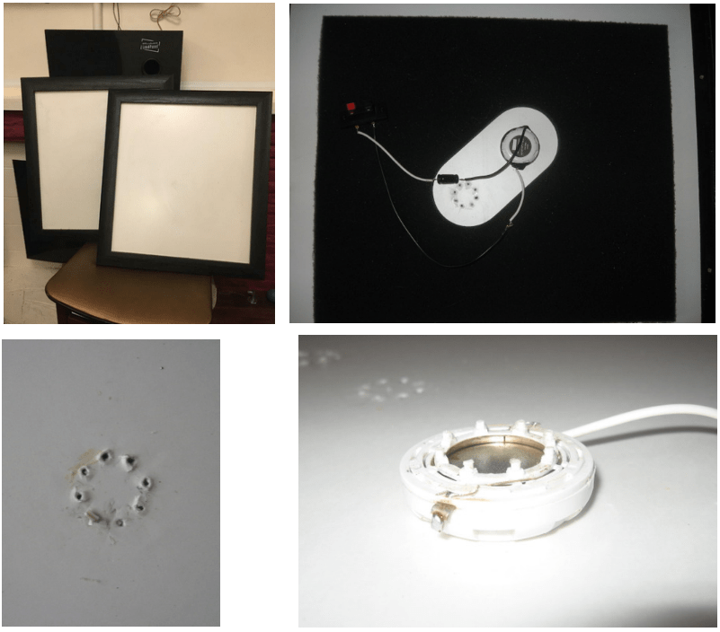

I was in the middle of experimenting with this type of mounting.Thank you AjohnL
Below some pictures browsing on the net with "Warfdale loudpanel" search
The internal pictures are from oldschoolVlad posted in AudioCircle. I remember now the view of the crimping method of the exciter on the membrane.

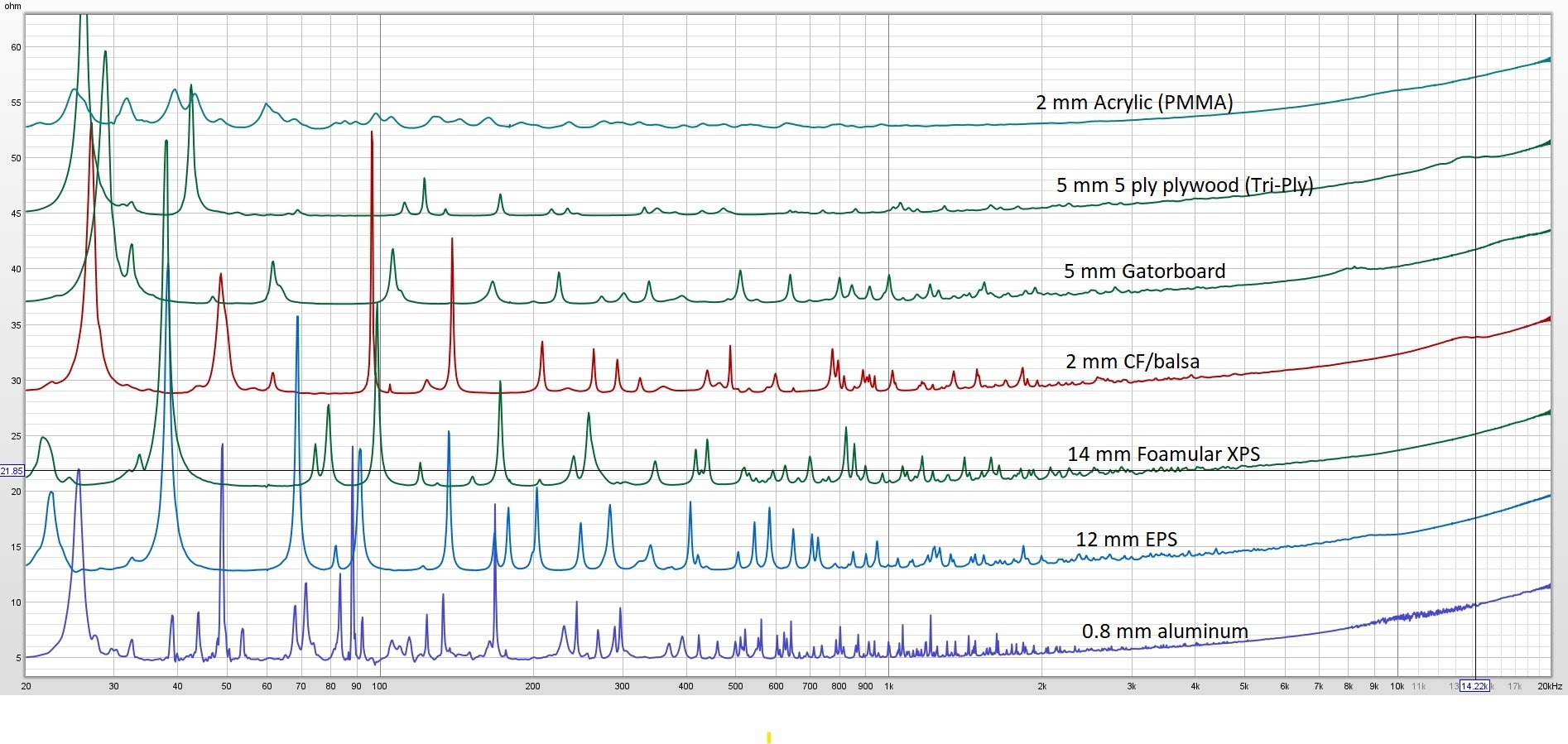

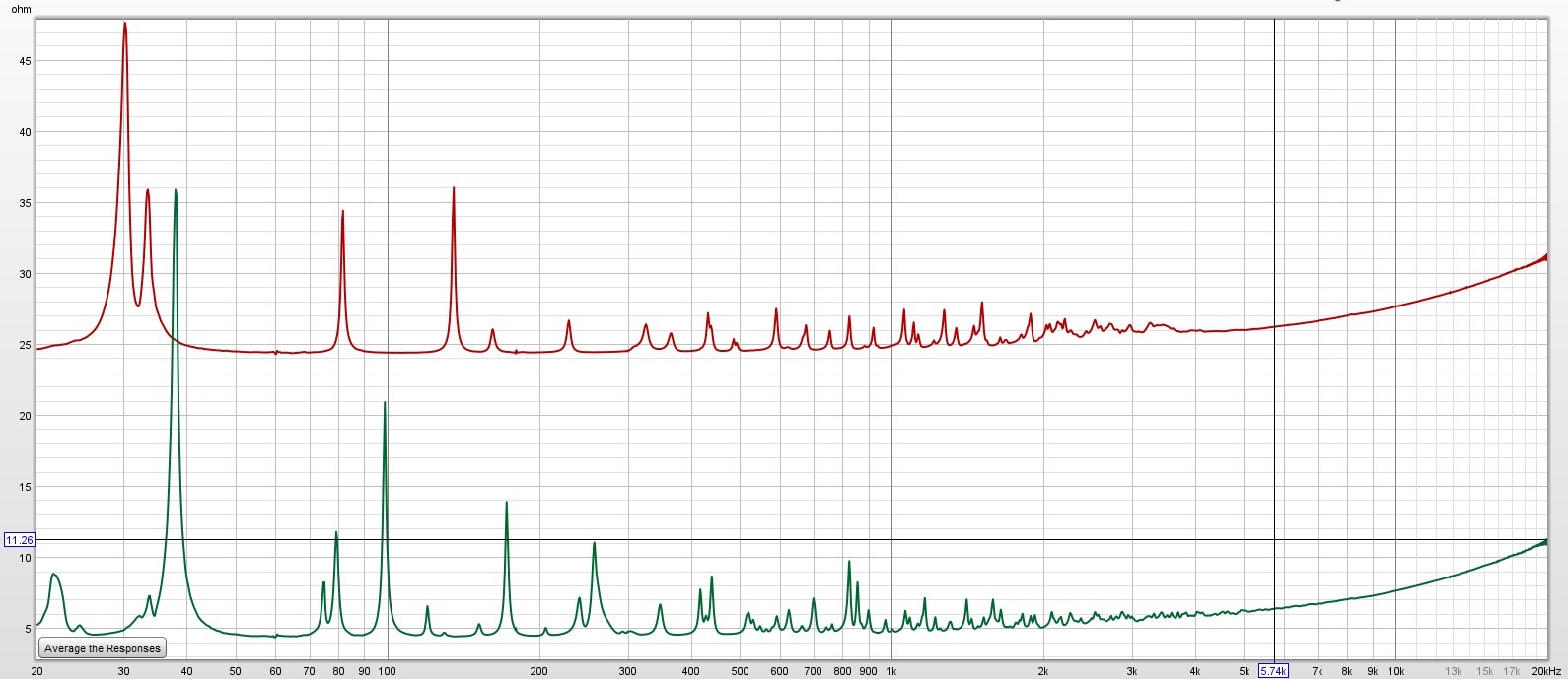

As I mentioned in a previous post, I recently built an impedance rig to allow me to make impedance measurements using REW. In that post I showed that the frequencies of the peaks in the impedance curve correspond to the natural frequencies (resonance frequencies) of the panel.
The results of another set of tests are shown below. Here I measured the impedance curves for various panel materials. All the panels tested were approximately 400 mm x 580 mm, with the same exciter (DA-25FHE) attached near the 40%/40% position. The panels were hung freely from two wires (or tape strips). I would not normally make a "speaker" this way (hanging from strings, without any frame), but the purpose of the test was to examine the materials themselves, without any other influence.
I stacked them in order based on the height and sharpness of the resonance peaks. I think it's pretty reasonable to assume that the sharper and taller the peaks are, the lower the panel material's internal damping is. On that basis, these results seem to show that the acrylic panel has pretty strong damping, followed by the plywood. Interestingly, my CF balsa composite appears to have quite low damping, similar to XPS and EPS. Aluminum, unsurprisingly, appears to have the least damping.

Thank you Eric for sharing you results. First time we have a material comparison by the impedance measurement.As I mentioned in a previous post, I recently built an impedance rig to allow me to make impedance measurements using REW. In that post I showed that the frequencies of the peaks in the impedance curve correspond to the natural frequencies (resonance frequencies) of the panel.

For XPS, EPS : are thy row or coated as usually recommended for DML use?
For the aluminum, the peaks seem smaller then the EPS, XPS or CF/balsa one. Is it a reading effect?
Christian

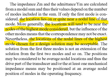

This was the part of this patent that I was most interested in, at the time.
He found that the mass loading the panel roughly half way between the exciter point and the edge of the panel, filled in the bad dip in the response at 200hz .
This is basically the same method i use to find these points on my small panels, but i use my fingers while watching the response change ,in real time.
it is very simple.
The first part also describes the bowing in the centre of the panel , which i regard as the direct radiating part of the DML panel ( pistonic in nature 😀).
This is where most of the hf above 10k comes from on an EPS panel.
steve.

True, the three you mentioned all have one or two peaks that are higher than any of the peaks in the aluminum. I'm not sure I'd put much weight on individual peaks, but still, it is indeed surprising to me that the they are not more differentiated from the aluminum.
The PS foam results I included where uncoated. But I did also test another XPS panel that was coated with several coats (four as I recall) of PVA/water. Unfortunately, it is not a perfect comparison with any other panels as the coated panel was much thicker (25 mm vs 14 mm) and the corners were rounded. Results are shown below with the 25 mm coated/rounded XPS panel in red, and the 14 mm uncoated panel in green.
For the thicker panel, the peaks are fewer within any given frequency band, but that would be expected as the thicker panel is much stiffer, and hence all the natural frequencies are more spread out. But as far as the sharpness of the peaks, the effect of the coating (if any) is not dramatic.
Eric

This patent is a treasure. Thank you for the guidance (reading a patent in English is not my favorite task!).
This extract matches fully with what is explained by Tectonic in its paper introducing the BMR principle. The weights are added at antinodes.
What is funny putting the 2 papers together is the patent propose a practical method :
- Find in the FR the dip
- Play this frequency and find the antinode (place with minimum of emission). Tool : a mic close ot the membrane... or a pipe as just read yesterday as you suggested in a post to detect the source of parasitic noise in an axciter
- Add a mass there (value to be determined by several test)
All of that fill the hole in my understanding : "commercial DML have additional mass, not mine... why?"

I'm not so sure that is correct. From the Graham Bank BMR patent (https://patentimages.storage.googleapis.com/1d/e6/29/d4bdc6e58aff65/US7916878.pdf):
Here, I understand the "locations" mentioned above to be referring to the locations at which to place weights (or drive means). But here in the patent Bank appears to be saying they should be added at (or near) the nodal lines of the highest mode to be balanced, rather than at antinodes. Or am I missing something?
